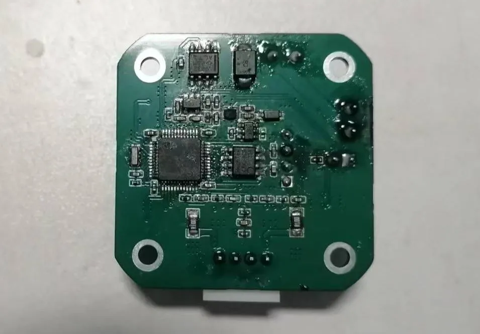

This project is
a closed-loop stepper motor driver board based on the STM32F103CBT6.
Features include support for closed-loop control of
stepper motors in position, torque, and speed modes ; STLINK programming of project parameters ; UART serial port debugging; CAN communication; and support for a 0.42-inch OLED display via IIC communication. Position feedback is obtained through the MT6816 magnetic encoder chip, and communication uses SPI. Software address : https://gitee.com/lilaoba_888/step_motor
