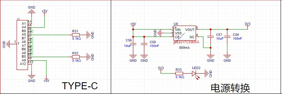

The power supply uses a TYPE-C-16P interface and connects to the corresponding serial port pin of the MCU via a USB data pin, directly using USB for downloading and debugging. 5.1K pull-down resistors are added to the CC1 and CC2 pins for easy identification and configuration by different host machines.
The ME6217C33M5G chip is used to convert the 5V input from USB to 3.3V for the main controller.

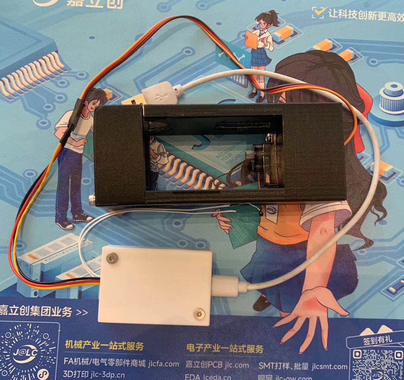

Initially
, gear transmission was planned, but the large size of the faucet valve frame caused gear meshing issues. A direct drive method was eventually adopted.
During the trial and error process, various printed parts were designed, using MG90S servos. Initially, the MG90S worked fine without water flow, but with water, the resistance was too high, and the servos lacked power, resulting in two burnt-out units. Later, the

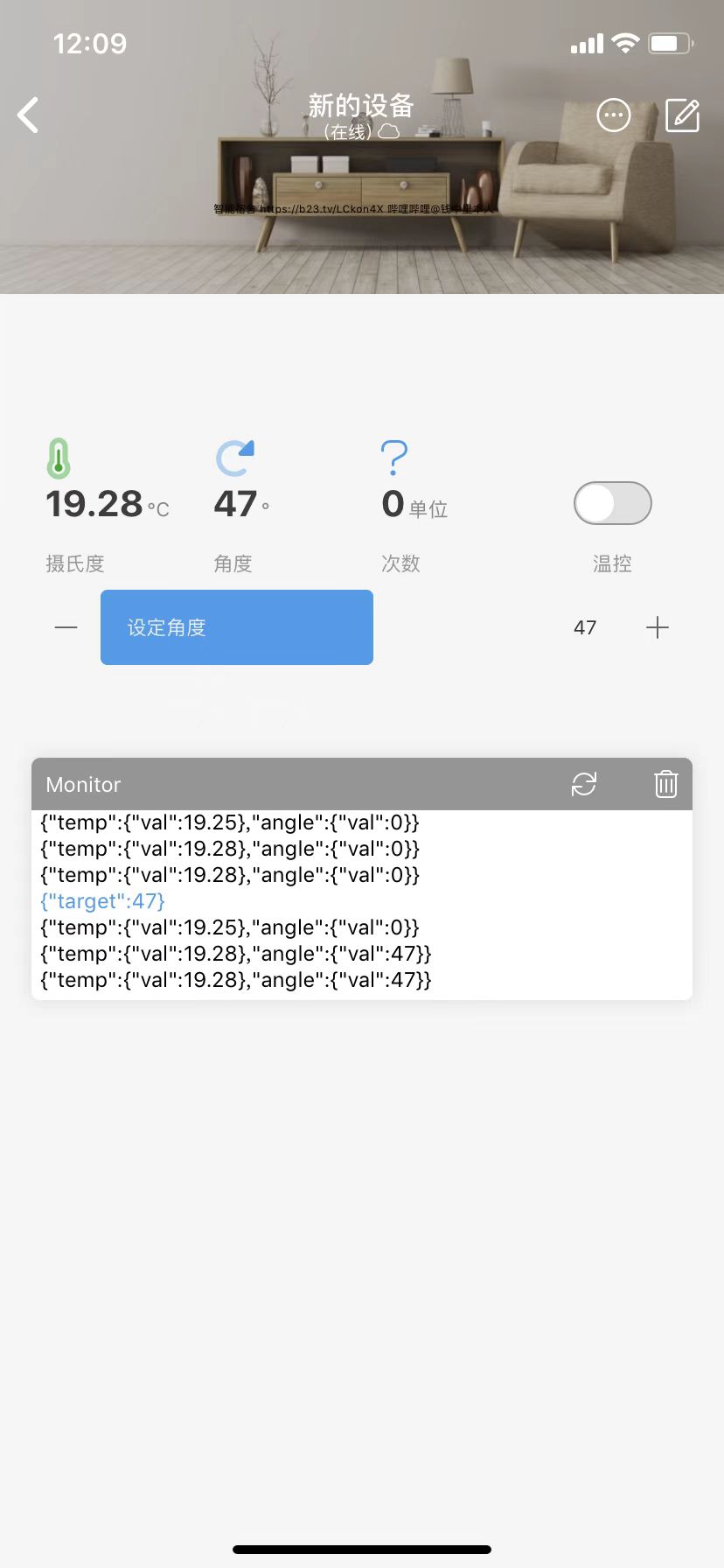

MG995 is planned. The code was written using VS Code, PlatformIO, and AI, and integrated with a lighting platform for convenient control via mobile phone.

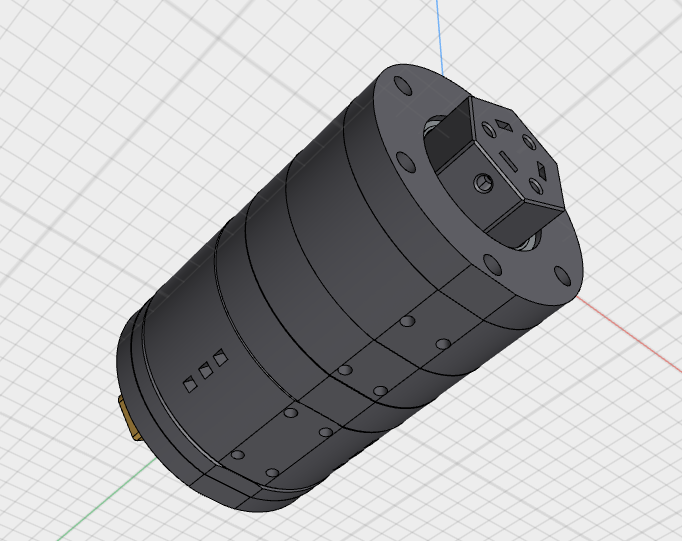

I. Final Product

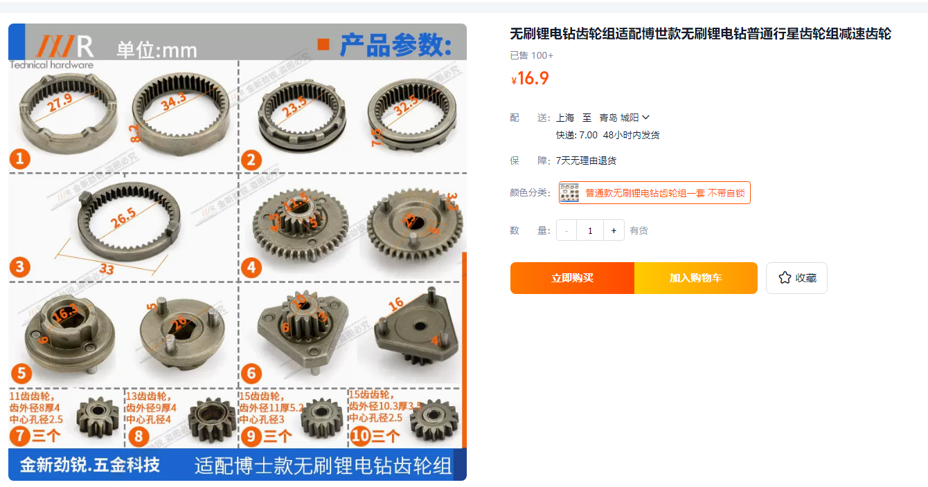

2) Gear Set:
This gear set has a reduction ratio of 65. (Not calculated, so it may not be accurate) A reduction ratio of 15 can be achieved by removing gears. The clearance is a bit large, but it's acceptable for DIY, mainly because it's cheap.
https://item.taobao.com/item.htm?spm=a1z09.2.0.0.77ab2e8dC4MEGH&id=731331023966&_u=e37u5r42fe3c&skuId=5234350022380

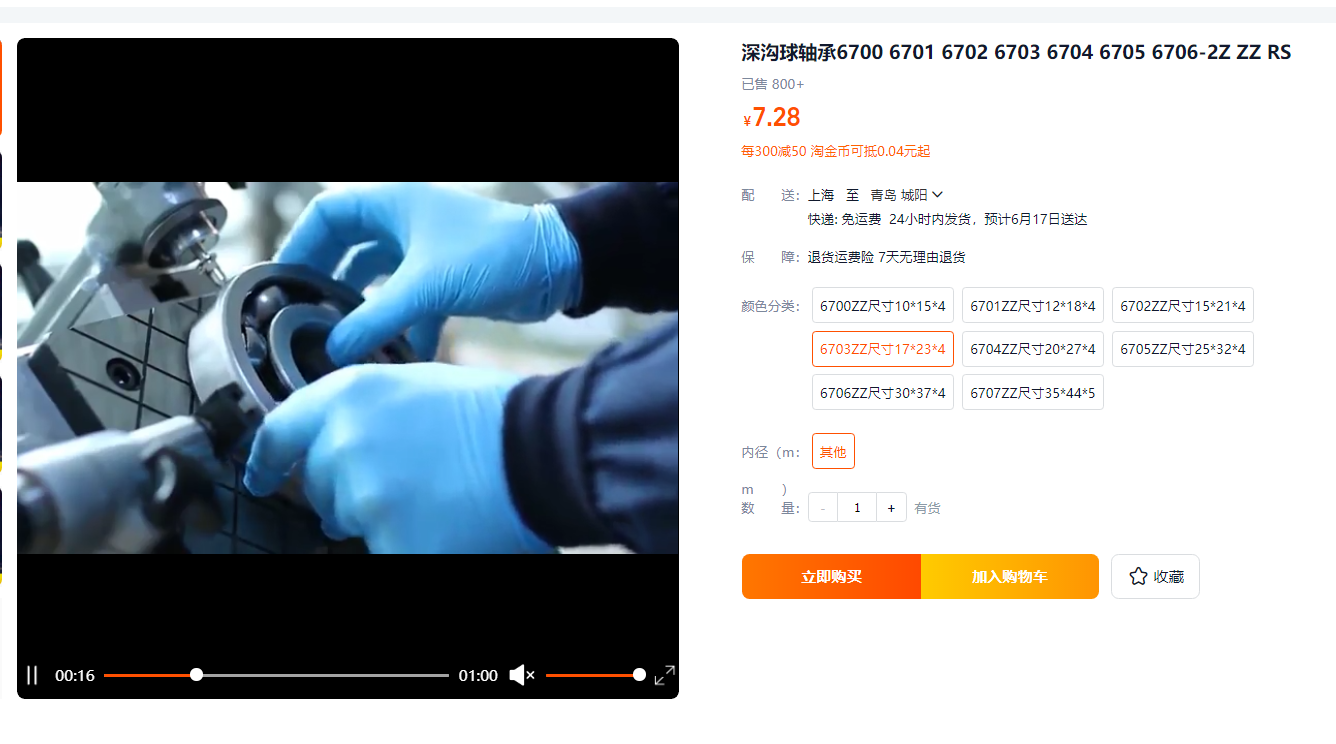

) 4) Bearings 6703ZZ, dimensions (17, 23, 4), quantity x2

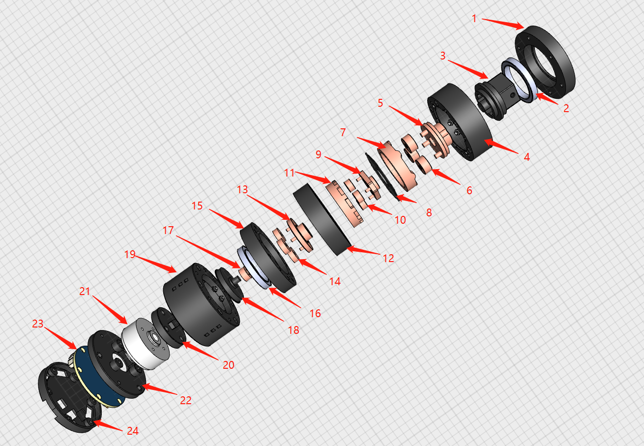

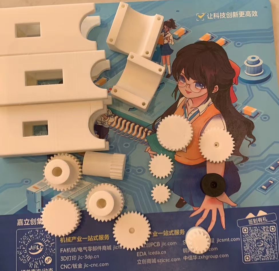

2. 3D printed parts
see attachments
: 1. Output connector cover plate 2. Bearing 3. Output adapter 4. Large size secondary output side housing 5. Gear set - secondary output planetary carrier 6. Gear set - tertiary planetary gear 7. Gear set - secondary fixed gear 8. Baffle 9. Gear set - primary planetary carrier 10. Gear set - secondary planetary gear 11. Gear set - primary fixed gear 12. Primary input side housing 13. Gear set - First stage input sun gear 14. Gear set - First stage planetary gears 15. First stage input side housing 1 16. Bearing 17. Gear set - Input gear 18. Input end fixed to the input gear 19. Motor housing 20. Reducer and motor connection 21. 3205B motor 22. Motor bracket 23. Motor drive board 24. Rear cover

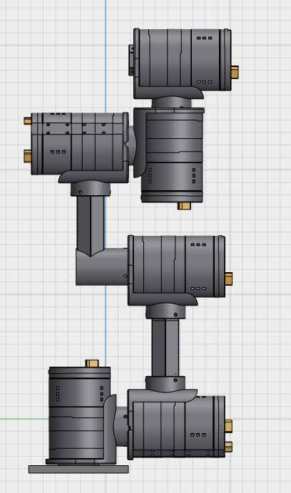

The entire digging process uses a 65 reduction ratio joint to make a robotic arm, but the end effector can only drive 0.5KG. I plan to try using a ready-made 139 reduction ratio joint for the 1 and 2 axis joints.

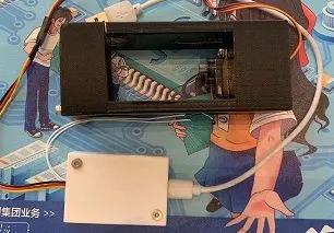

Lüliang flow meter housing
Lüliang flow meter housing, adapter board + TP4056 module charging and discharging.
The Lüliang flow meter casing, powered by a lithium battery,
has been improved based on the following:
1. A mezzanine PCB has been added
. 2. An ultra-thin encoder has been installed
. 3. A TP4056 lithium battery charging and discharging integrated module has been added, powered by the lithium battery.
4. A lithium battery switch has been added.
5. An AB casing has been installed, with a 1.5mm PCB with a window .
* Ultra-thin design, mezzanine output
. Copying is welcome.
* 1.5mm PCB, cut by yourself
