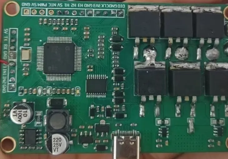

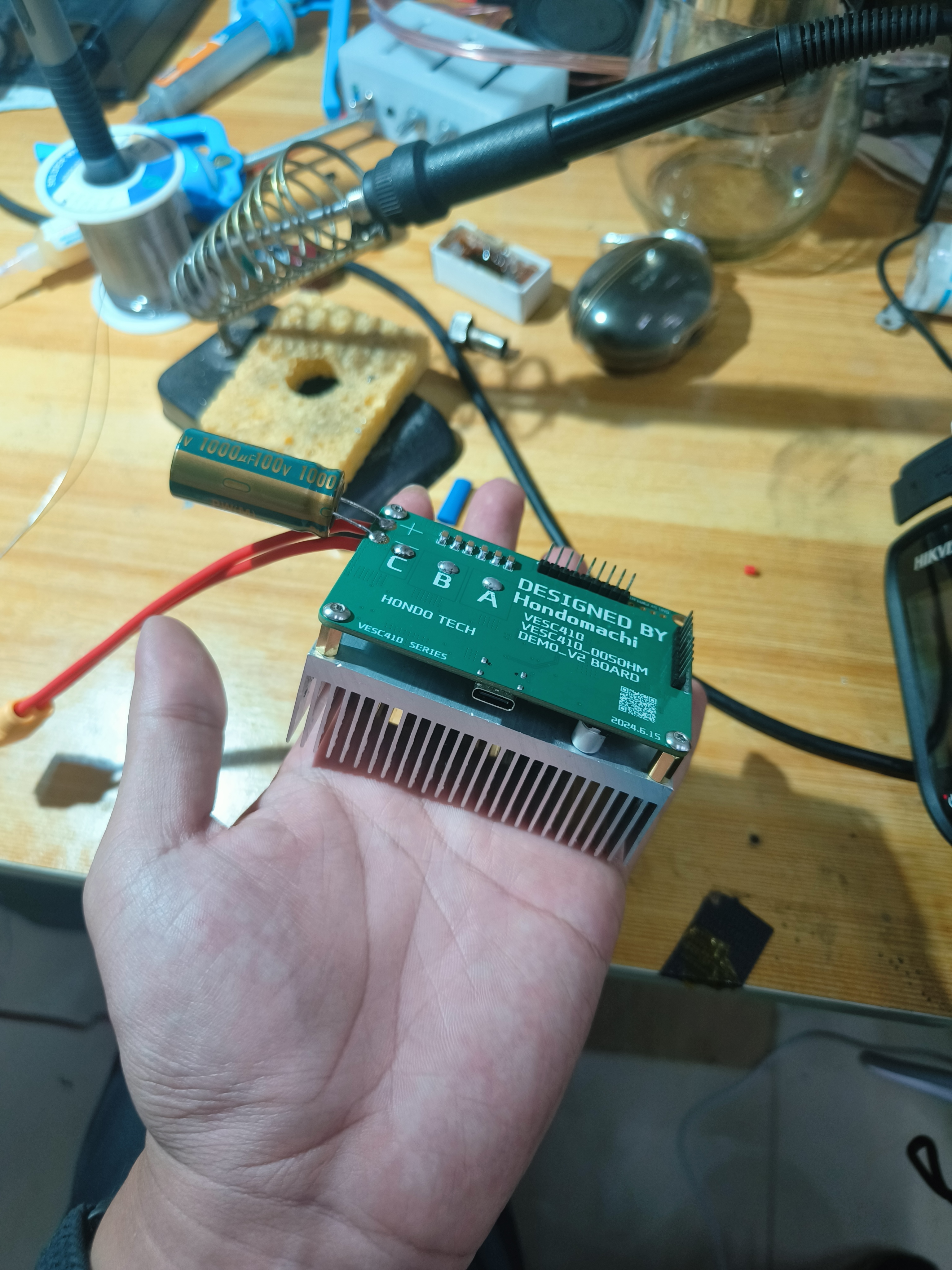

srox7QkRmf
VESC4-DemoV2-Verified
This can be used as an experimental board, but please be careful when getting on the bus. This thing once left me stranded on the road, haha.
