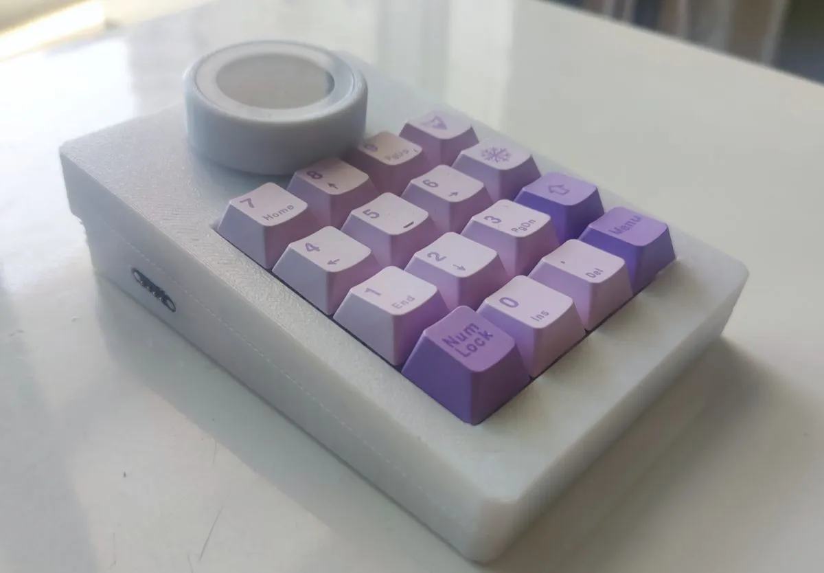

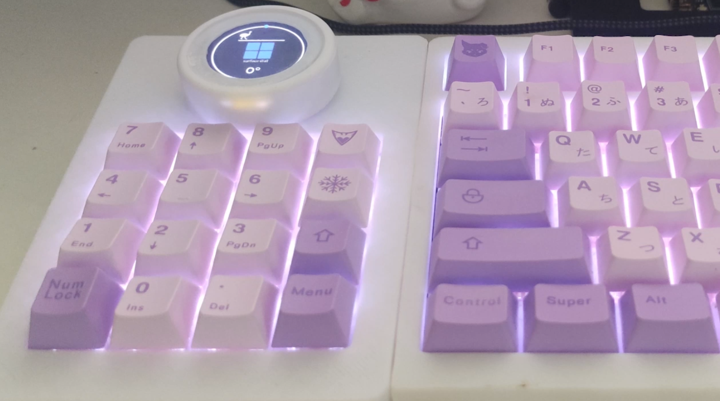

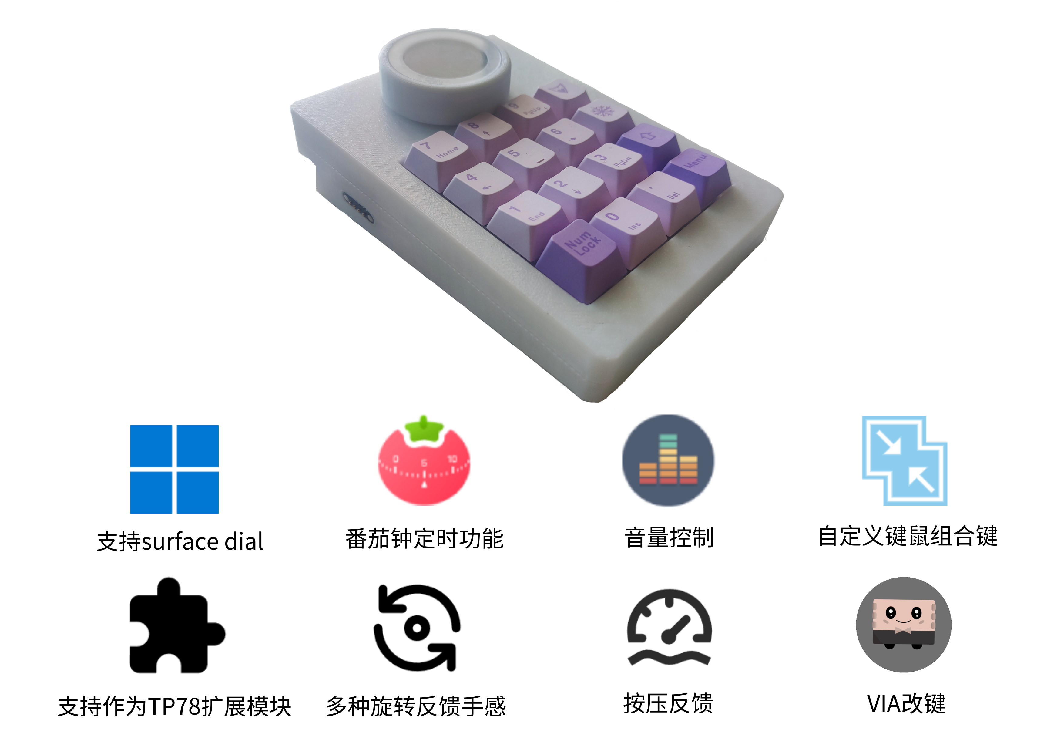

The TP78_FOC is an expansion module for an FOC-controlled brushless motor rotary keypad.
It supports use as a TP78 slave module, synchronizing lighting effects and sleep/wake functionality with the TP78. It
supports VIA key remapping, Aura Sync in USB mode, volume control, Surface Dial control, Pomodoro timer, and free keyboard/mouse key mapping.
Hardware compatibility includes both magnetic and mechanical switches.
Firmware upgrades support USB online updates.
(Note the open-source license, GPL 3.0. Please respect open source. Welcome to discuss. Discussion group: 678606780)

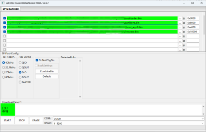

Use Espressif's official ESP32 tool to upgrade (not recommended for beginners), tool name: flash_download_tool_3.9.7.exe (version number can be new or old) and esptool.exe.
Usage steps:
(1) Connect the USB Type-C interface and enter the tool directory on your computer;
(2) Open the command prompt window, enter: .esptool.exe run, and the following prompt will appear;
(3) Double-click to open flash_download_tool_3.9.7.exe;
(4) Configure according to the options in the picture;
(5) After clicking OK, load the bin files of the 4 partitions according to the options in the picture;
(6) Note that you should select the corresponding COM port. After entering the bootloader, a new COM port will be added;
(7) Click START until the download is complete and then restart.

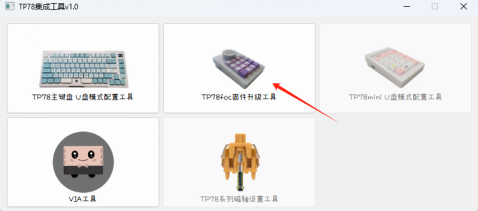

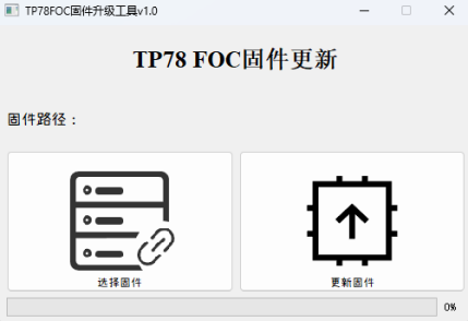

Upgrade firmware using TP78 integrated tool.
TP78 integrated tool is a universal host computer tool for TP78 series keyboards. Compared with method 1, it is simpler to upgrade firmware. Power loss during the upgrade process will not damage the current firmware, making it safer.
Tool download address:
https://github.com/ChnMasterOG/TP78-Integrated-Tools/releases/download/V1.0.0/TP78.Integrated.Tools.zip
(1) Connect the USB Type-C interface, open the tool on the computer, and select TP78foc firmware upgrade tool;
(2) Click to select firmware and then click update firmware. Note: Here, you only need to select the main partition of the firmware - firmware.bin.

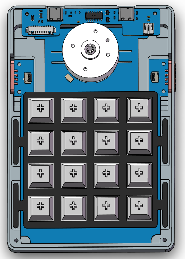

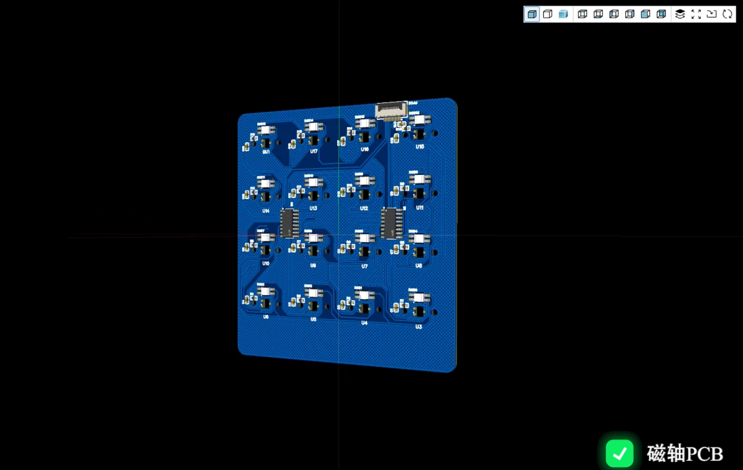

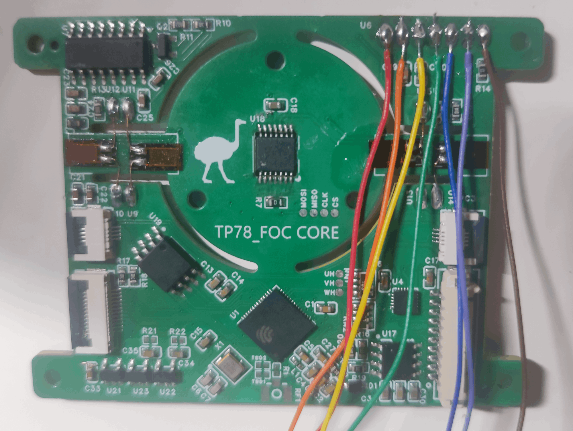

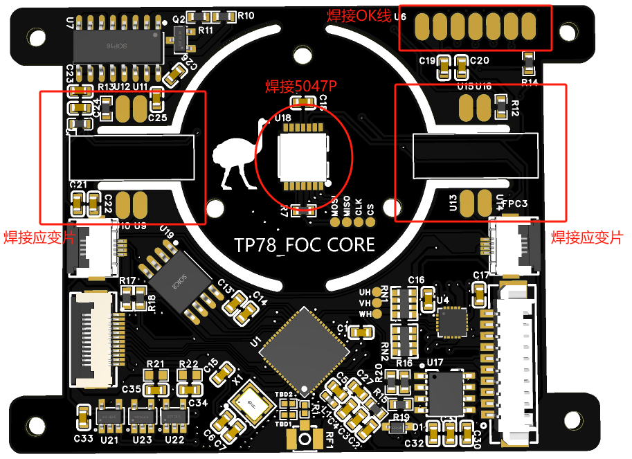

Soldering core board PCB
Soldering completed image:
Note: Remember the color order of the OK line, from left to right, they correspond to VCC/BLK/DC/SCL/SDA/RES/GND respectively. The red circle part of
the recessed knurled nut
needs to be hot-pressed into the M2×3×3 knurled nut .

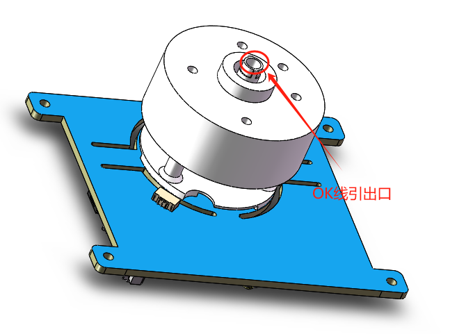

Install the motor
Connect the motor to the core board with the LCD support base printout, pull out 7 OK lines, and insert the motor ribbon cable into the terminal on the top surface of the PCB. Finally, use 3 M2×12 screws to tighten the back.

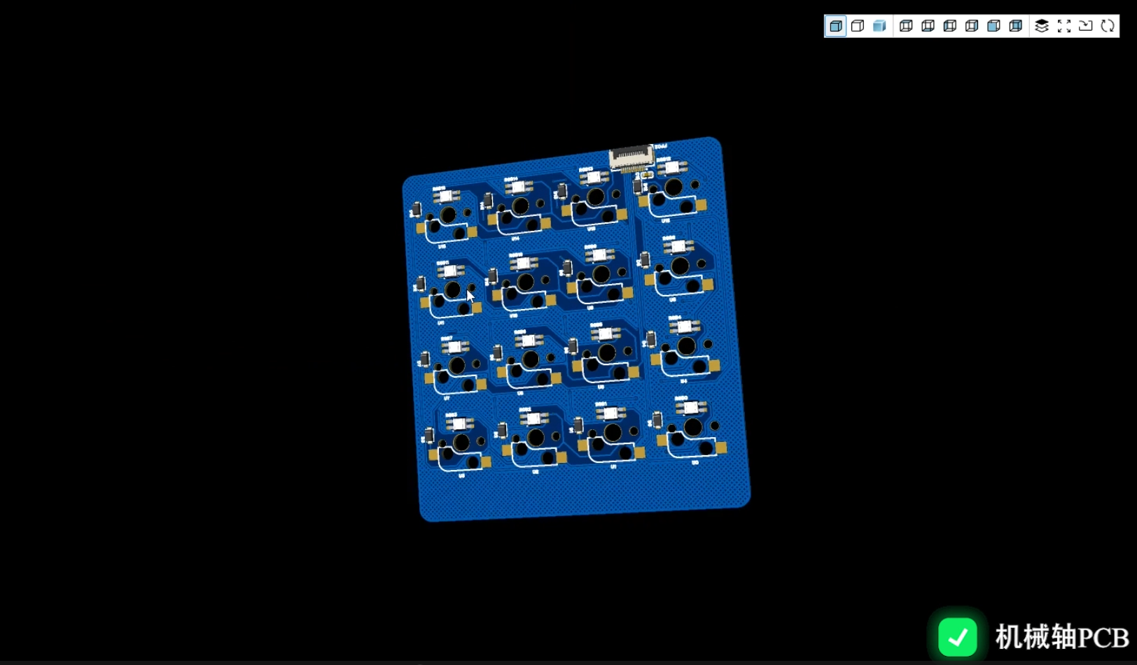

Install the switch plate

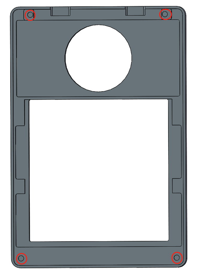

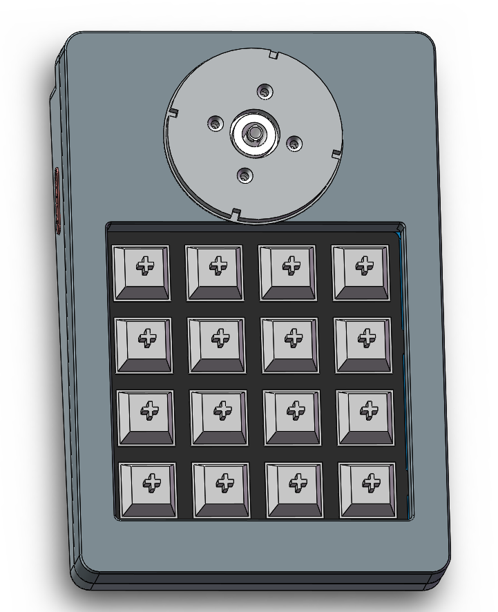

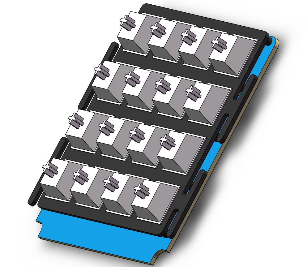

Install the switch and keycap, and install the silicone pellets of the positioning plate. First,
install the

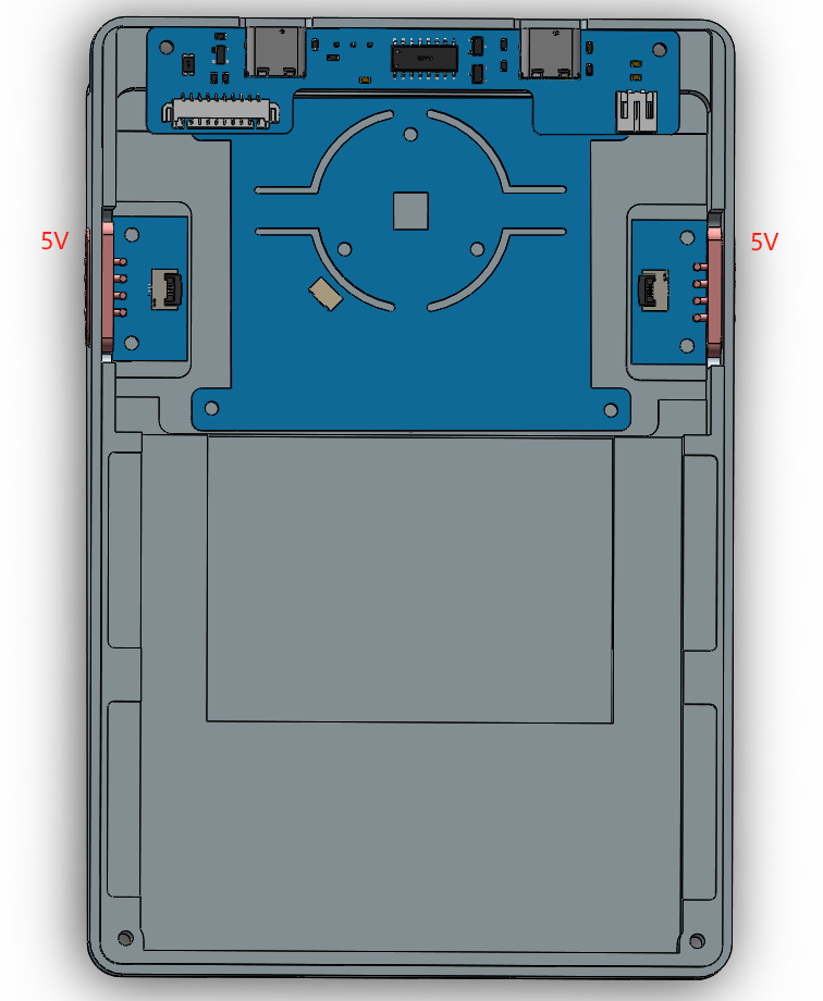

left and right magnetic charging boards using four M2×3 screws. Then, connect all the ribbon cables on the core board, using a 4-pin FPC ribbon cable to connect the left and right magnetic charging boards, ensuring 5V is available near the switch. Finally, tighten the four surrounding screws.
Next, secure the core board with the motor installed using four M2×3 screws.
Connect the power supply board and core board using a 1.25mm reverse 10-pin ribbon cable.
Connect the shaft board and core board using a 12-pin reverse FPC cable.
Attach the battery to the bottom cover with double-sided tape, then connect the battery and power supply board.

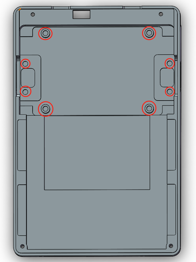

Install the top cover
using two M2×7 screws, tightening them to the holes on the power supply board side.
Tighten the remaining two holes with two M2×12 screws.

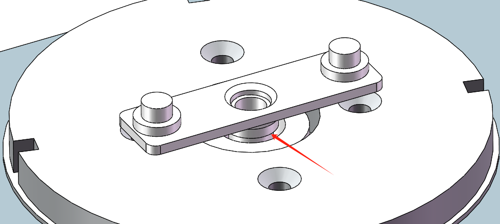

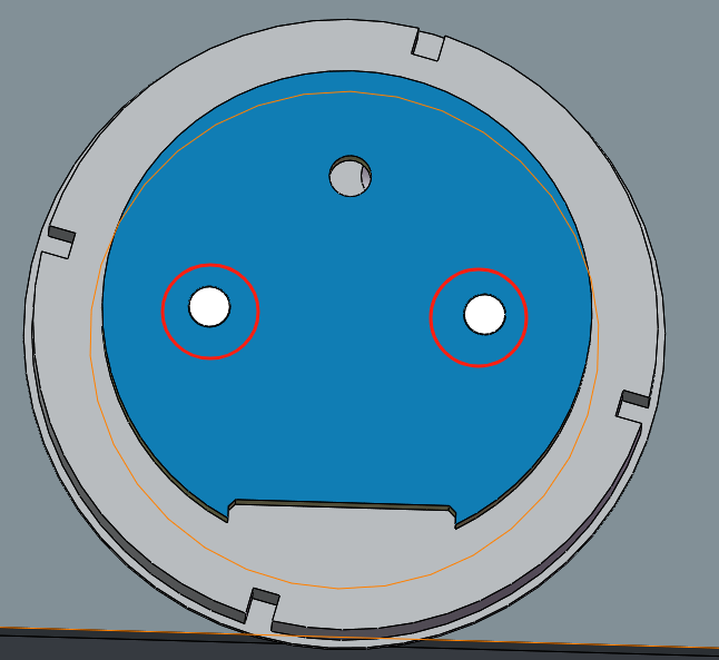

Secure the 3D printed part and motor to the underside of the knob housing
using four M2×5 screws. Ensure
the upper surface of the LCD support
is firmly secured; if it easily comes loose, use super glue to help it adhere.

by connecting the LCD and LCD adapter board.
Then solder the LCD adapter board and the seven OK wires, following the previously remembered order and corresponding PCB silkscreen markings.
Next, place the LCD adapter board on the upper surface of the LCD support and secure it with a suitable amount of super glue.

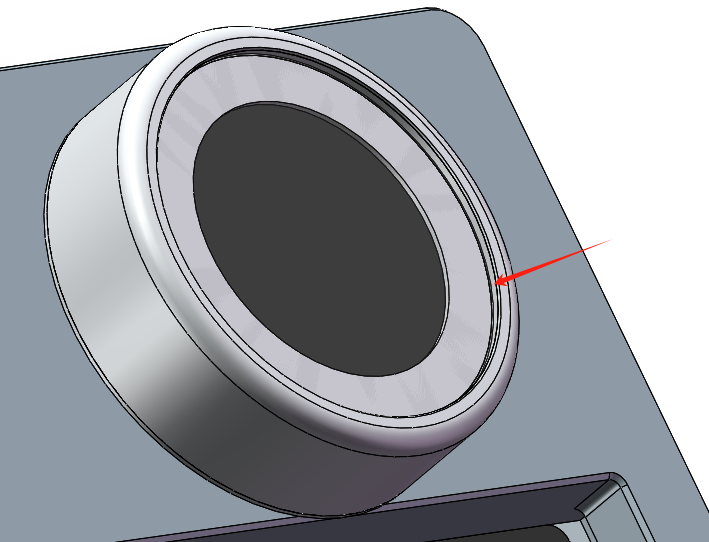

Finally, attach the LCD screen and LCD panel using double-sided tape, ensuring the LCD is upright and not crooked. Finally
replace the knob cover and use acrylic glue to secure the round acrylic piece to the knob cover.
