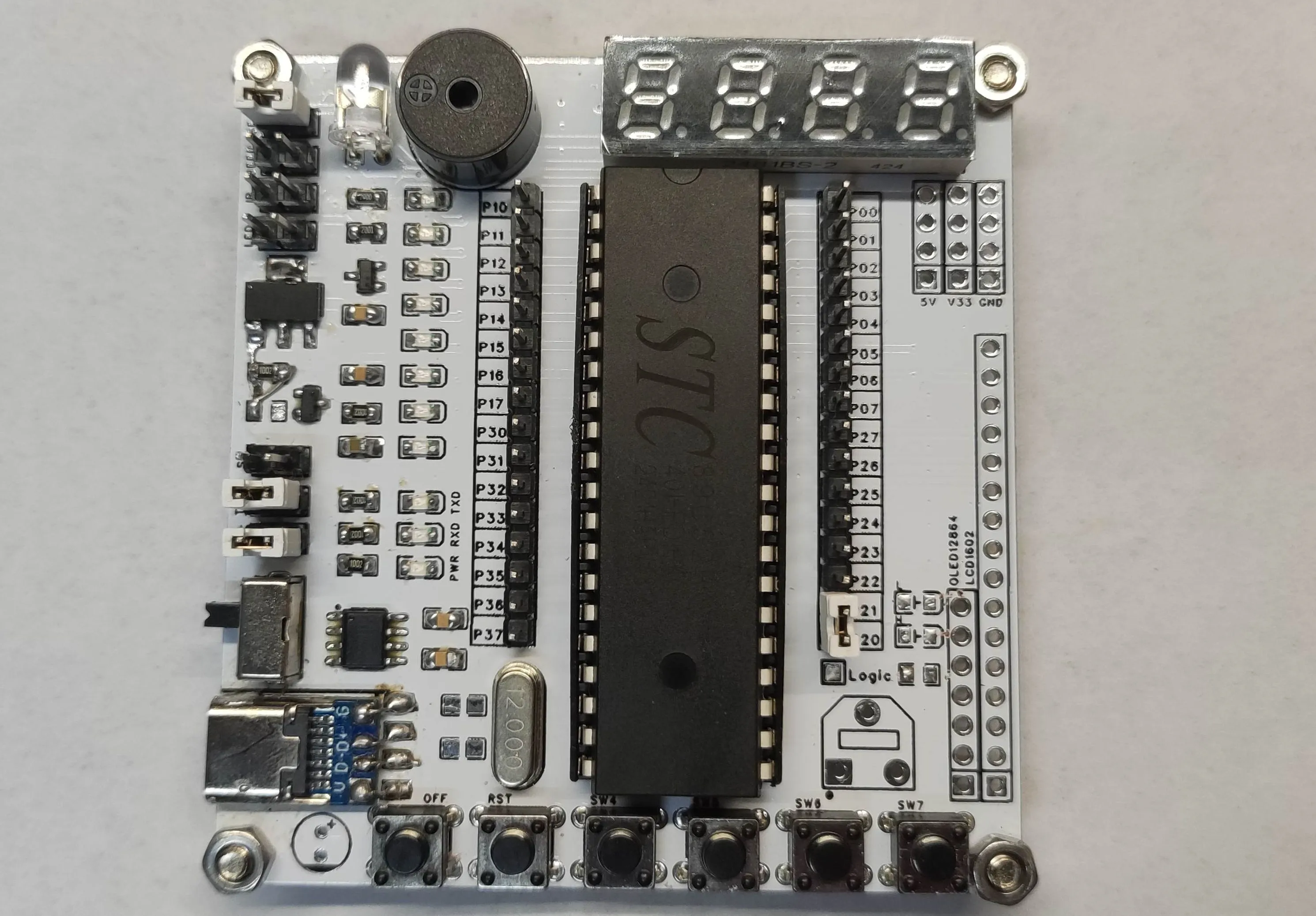

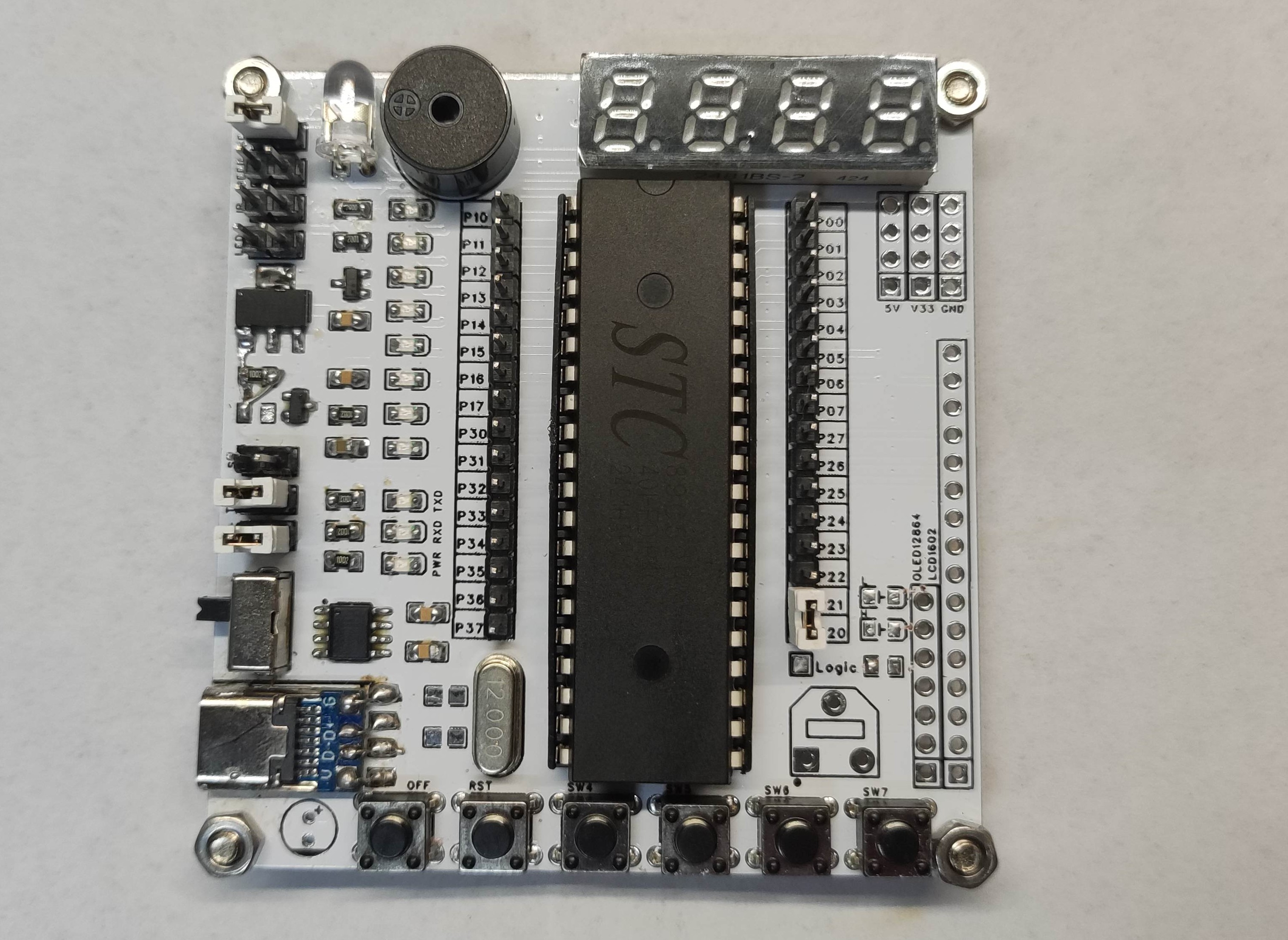

I designed a simple 51 microcontroller development board by drawing the circuit diagram of commercially available development boards.
Features:
- 7×7.3cm size, easy to carry
- Onboard running lights, digital tubes, independent buttons, buzzers, etc., suitable for learning I/O and peripheral use
- The microcontroller is in a DIP-40 package, compatible with 40-pin IC sockets or chip test sockets, facilitating chip replacement
- Designed a programming button (lower left corner), a short press of this button during programming will automatically power off and power on the chip
- Resistors and capacitors use 0805 packages, Type-C interface uses a female connector with board, easy for beginners to solder
Front view (initial design), the female connector and crystal oscillator capacitors have not yet arrived, so they are not soldered yet

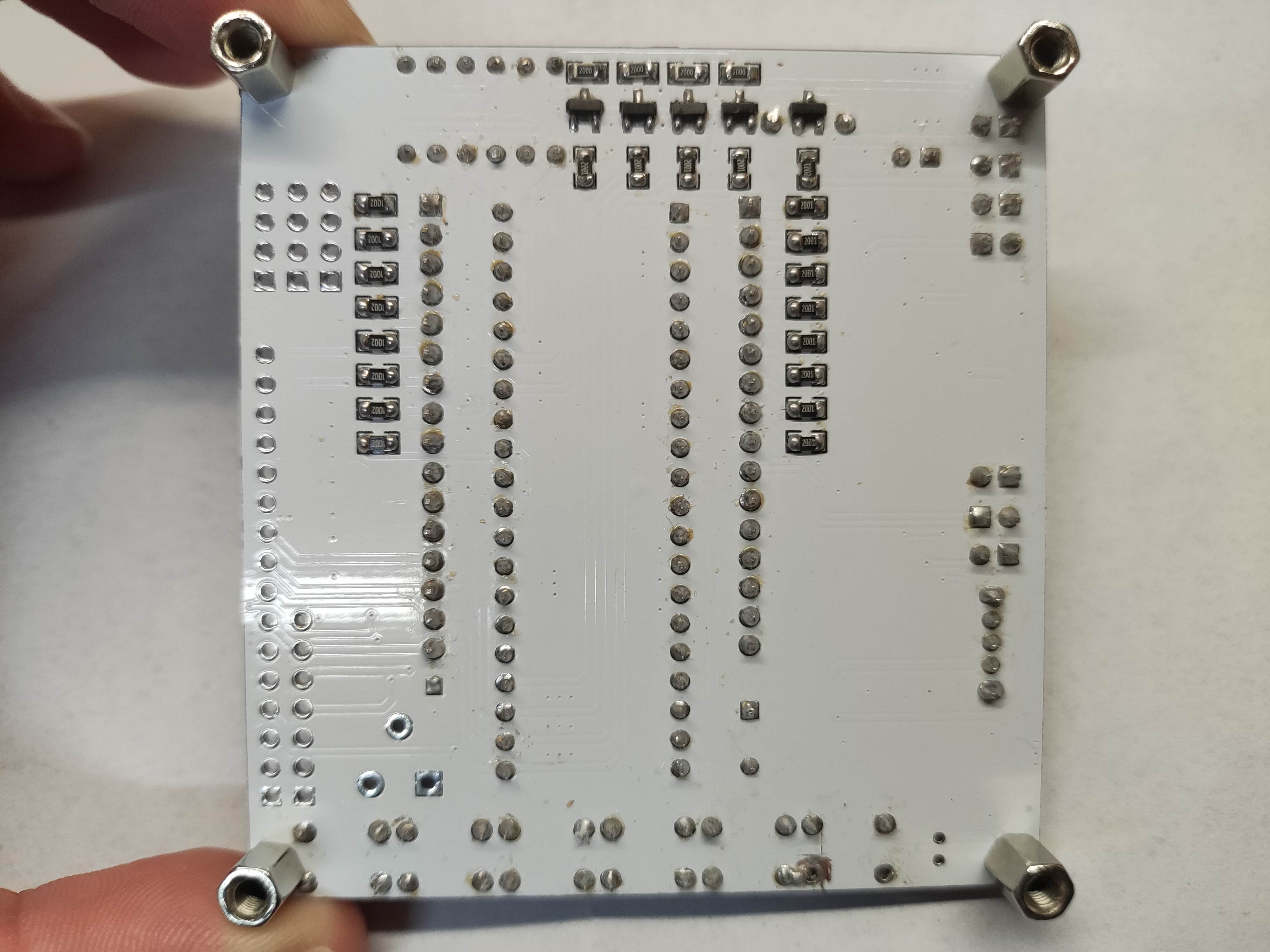

Back view
![IMG_20240918_182424.jpg]

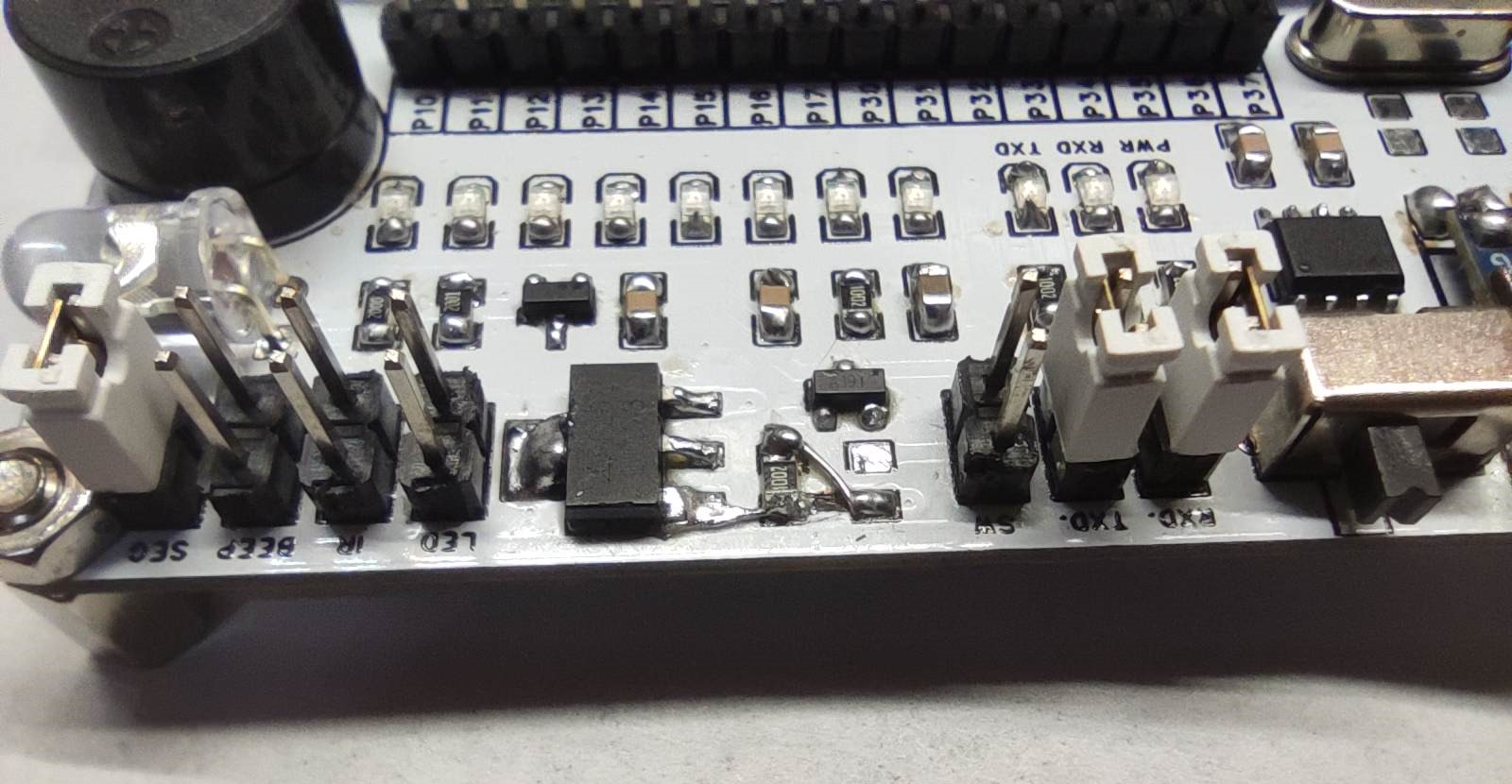

An error occurred during the design process, the conduction condition of the MOSFET was incorrect, and as a result, the automatic power-on button did not work during testing, so I had to scrape the board and add jumper wires to solve the problem. The project has been modified before release and can be used directly
! ![IMG_20240918_182343.jpg]
