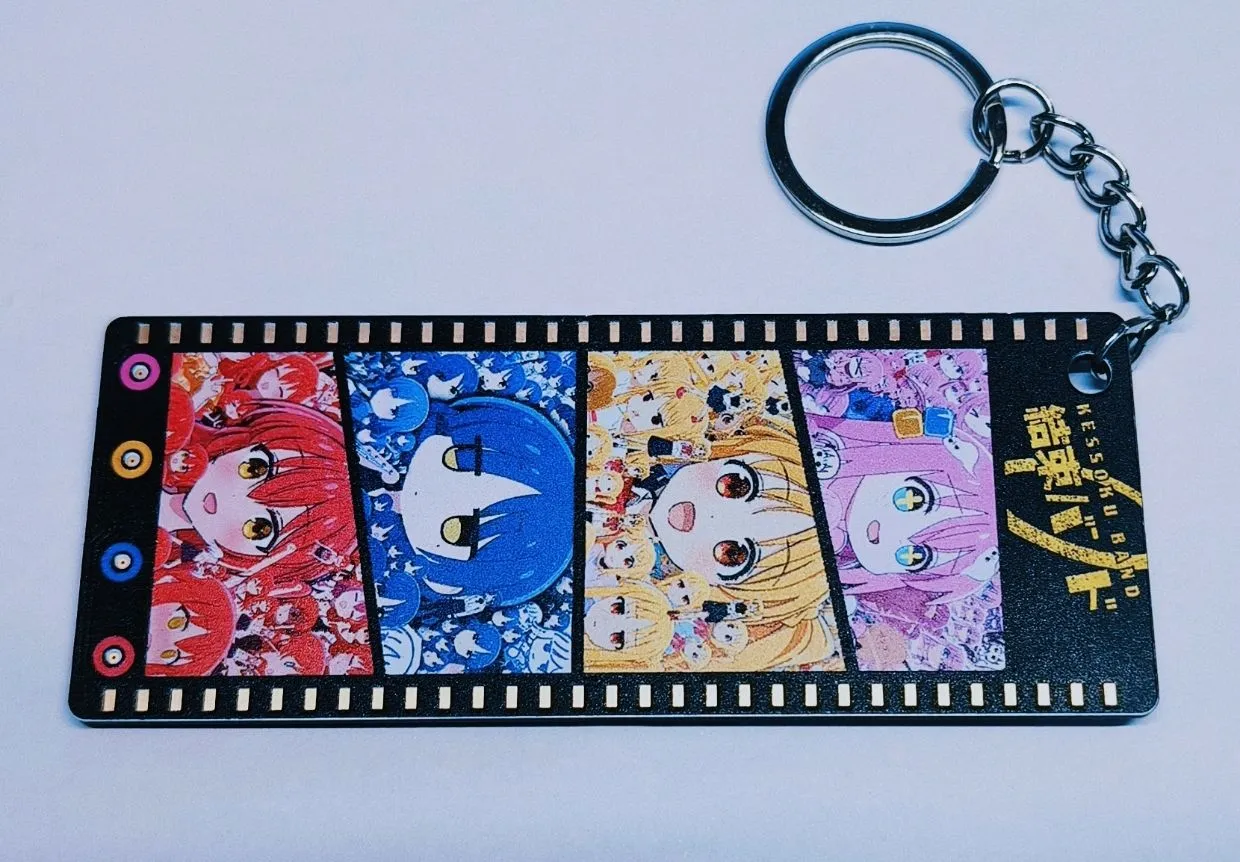

The overall design
mimics the effect of film reel, with immersion gold filling and solder mask openings on both sides. Another approach is slotting, but I didn't try that (actually, I ran out of color silkscreen printing coupons).
The silkscreen printing on both sides was drawn in Photoshop. The four images of "Lonely Rock" are from the internet; I couldn't find the artist's information, but I'd like to express my gratitude here. (This open-source project is non-profit; please contact me if there are any copyright infringements.) The first four

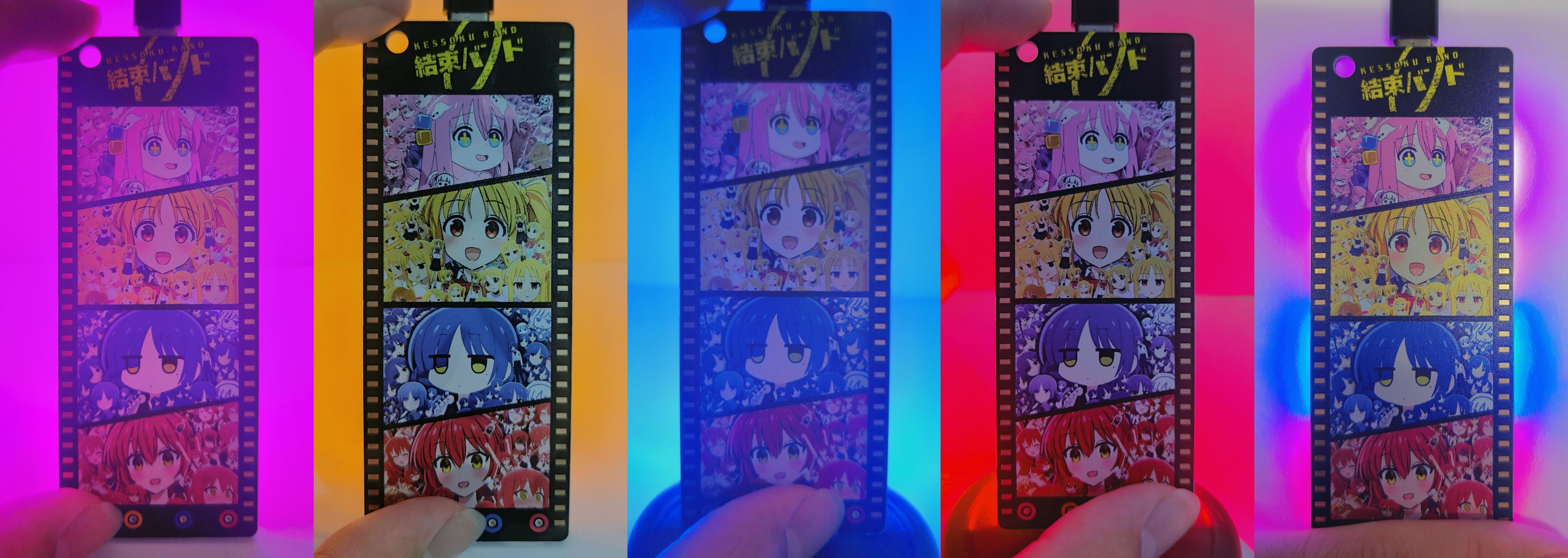

images show
the PCB with no obstruction and individual LEDs lit; the fifth image shows the PCB with obstruction (A4 paper) and all LEDs lit.
Implementation principle
: Touch buttons: A capacitive touch switch solution is used, with the touch IC being TTP223E-BA6.
LED on/off: An NMOS is used, with the gate connected to the touch IC's output, and the source and drain connected to the LED and GND.
