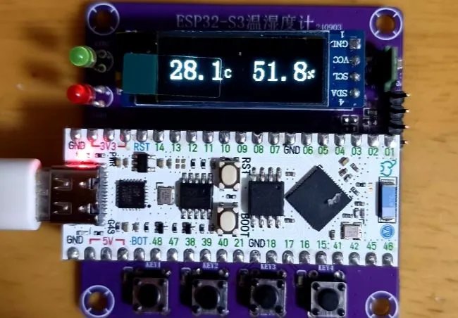

Project Introduction:
This project is a temperature and humidity meter based on the LCSC ESP32-S3 development board. It has temperature and humidity detection and alarm functions, as well as voltage measurement functions.
Project Functions
: This design is a temperature and humidity alarm system based on the LCSC ESP32-S3 development board; it has
4 independent buttons;
3 independent indicator lights;
1 voltage measurement interface;
alarm sound and corresponding alarm light indication.
Project Parameters:
This design uses the ESP32-S3 chip, a dual-core processor with a main frequency of up to 240MHz;
it uses an OLED LCD display to show the current temperature and humidity;
it selects the SHT40 fully digital temperature and humidity sensor, which has a wide temperature measurement range and can meet general needs;
when the temperature or humidity exceeds the threshold range, a buzzer alarm will sound and a corresponding LED alarm light will illuminate;
voltage can be measured via buttons, with a measurement range of (0-20V).

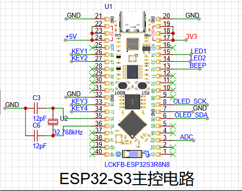

This project consists of the following parts: main control unit, button unit, buzzer unit, and LED indicator unit.
Main Control Unit Description:
The LCSC ESP32-S3 development board is a high-performance development board based on the ESP32-S3 chip, with rich functions and features, making it very suitable for applications in the fields of IoT and embedded development.

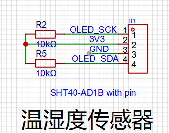

is a high-precision, low-power digital temperature and humidity sensor launched by Sensirion, Switzerland, belonging to the Sensirion SHT4x series.

This design uses a small module of the SHT40, as follows:
The voltage measurement interface
uses the AD interface of the ESP32-S3.
Through voltage divider measurement, the measurement range is displayed here as 0-5V.
The measurement range can be adjusted by adjusting the values ​​of R4 and R1.
The maximum measurement range is 0-3.3*(1+R4/R1).
When R4=50K and R1=10K, the measurement range is 0-19.8V.
This can be adjusted as needed.
Note that the voltage divider resistors should ideally have high accuracy.
The buzzer
is used for various alarms and requires frequency matching.
The button circuit
is used for interaction and input .
The LED circuit
is pulled up to 3.3V and connected in series with a current-limiting resistor. It is used for prompts or warnings.

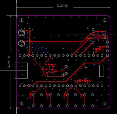

The PCB design
uses LCSC EDA.
It is a two-layer board, FR-4 material, 1.6mm thick. Dimensions: 55X55mm.

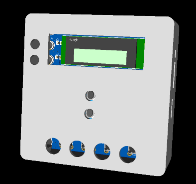

The 3D shell B design
also uses LCSC EDA,
as shown below .

sht40 driver
header file is shown below. Here, IIC simulation is used, sharing pins with the OLED.
