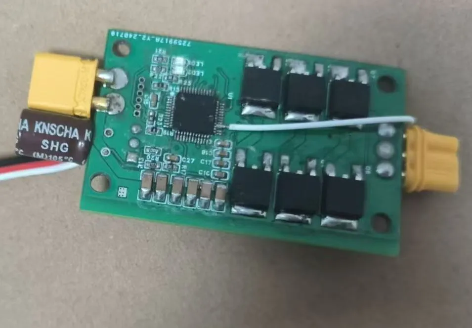

CH32V203C8T6 ESC
The power supply voltage is 12V, and the current is over 50A. This solution uses the official open-source solution from Zhufei. The components in this solution have larger packages, making it more suitable for novice soldering.
During testing, troubleshooting revealed that a missing neutral line caused the initial verification failure. After adding a jumper wire, the verification succeeded. The MOSFET actually used is the LR7843, which performed very well in testing, exhibiting no overheating even at full speed.
The issue has been fixed in the new PCB version.
