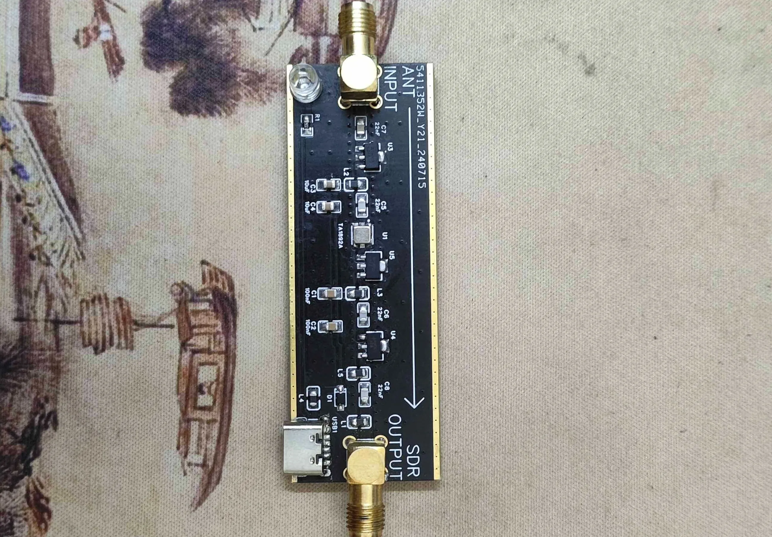

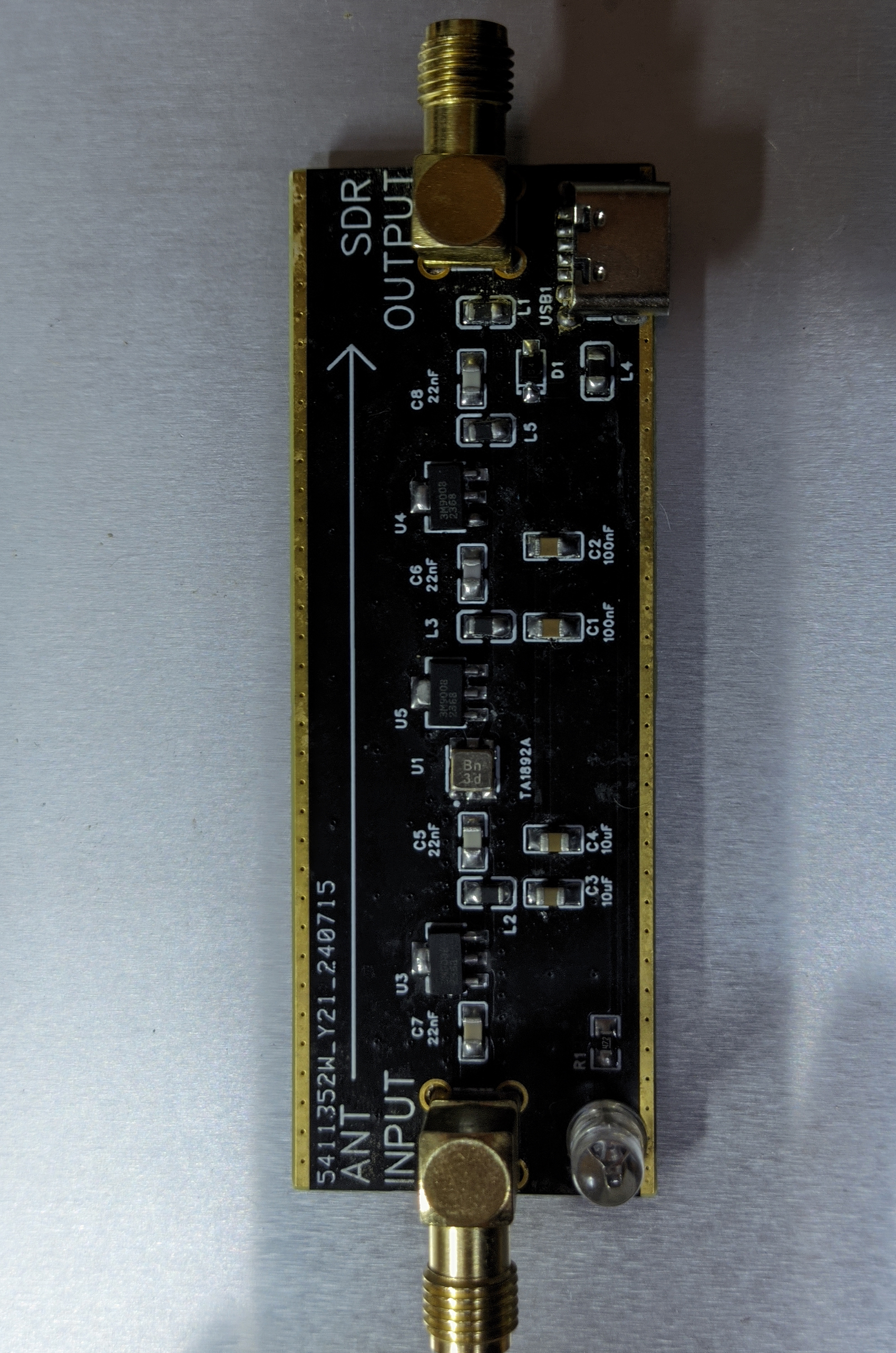

1625-1725MHz amplifier, used for L-band meteorological satellites
A TA1892A surface acoustic wave filter is used as the bandpass, and three TQP3M9008 amplifier chips are cascaded for amplification. It uses a Type-C power supply interface and supports Bias-T power supply.
The TQP3M9008 can be replaced with any low-NF value SOT-89 packaged low-noise amplifier such as the SPF5189Z (total gain is controlled by the three amplifiers).

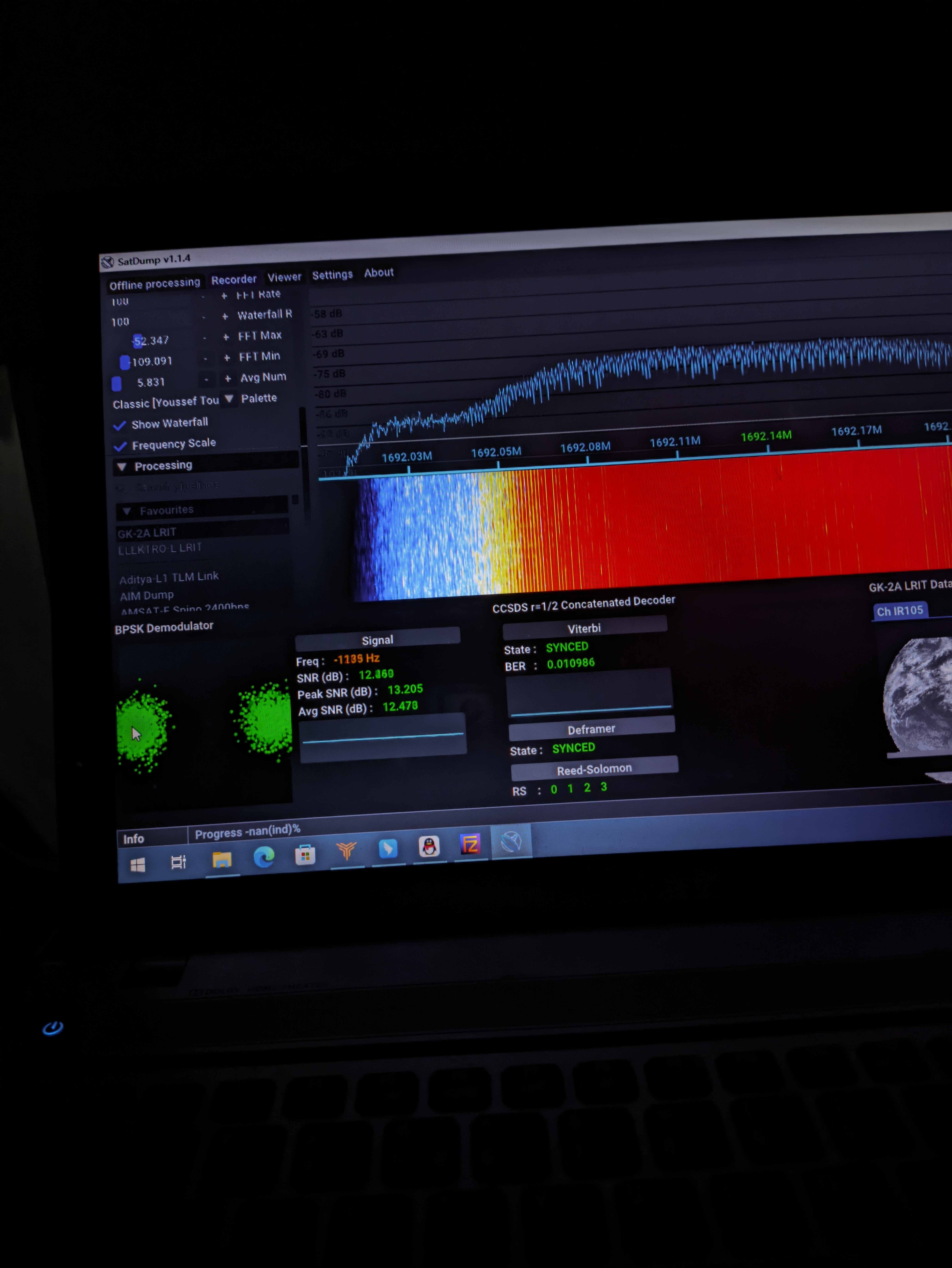

{[Easiest to Receive] GK-2A [Norad 43823] LRIT (1692.14MHz) HRIT (1695.4MHz)}
