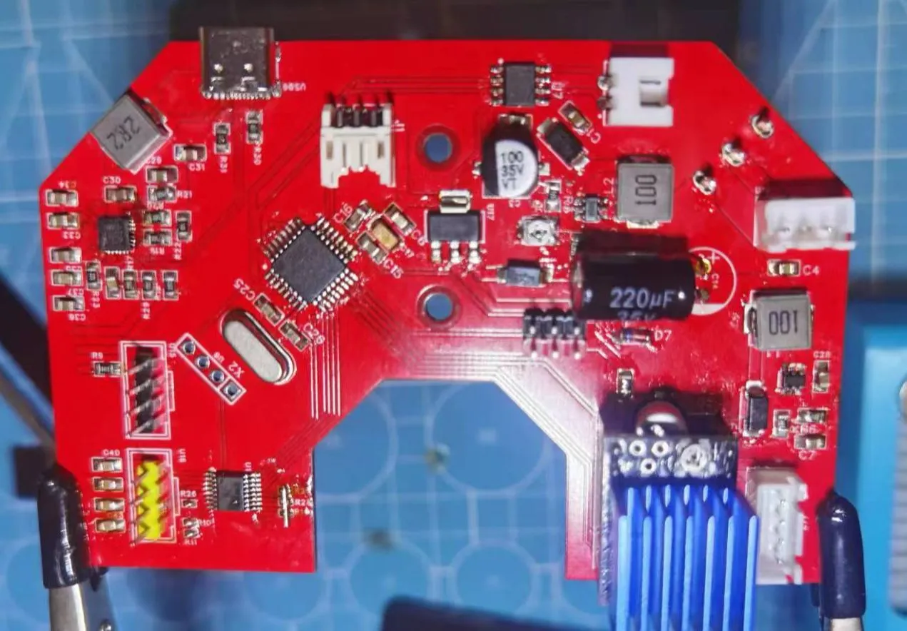

A card dealing machine
Fast, lightweight, no-shuffle, and I believe it's better than those on the market. The hardware and software are almost complete; it's open source, so let's all play together.
The main controller is a 328P; pins and storage space are almost used up. If new features are needed, I'll consider porting them to an ESP32.
Related videos are on Bilibili. Files and BOM are being organized. Code and print files are at https://github.com/heute666/smart-poker-dealer.
Related videos on Bilibili: https://space.bilibili.com/554504409. For now,
the images look like V1.1. I initially wanted to put the touch chip on the motherboard, but it didn't work well, including the indicator lights. It has been updated to V1.2.
The attachments include STL files, BOM, and PCB layout files for the card-dispensing sensor (necessary); PCB layout files are also available in the repository (not necessary; a tracking sensor can be used instead, but other wiring needs to be done manually).
