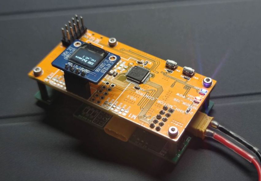

The main control uses a cw32 microcontroller. The libraries and routines released on the official website are relatively complete and basically sufficient. The main control board and driver adopt a layered design, mainly because of the fear of insufficient resources, which makes it easy to expand and write programs. Interested friends can also Directly drive the driver board and use other microcontrollers or Linux boards to control it.
The driver IC uses EG2133, and interested students can also choose other models. I won’t talk nonsense about the specific parameters. Friends, you can read the data sheet by yourself.
Physical picture of the main control board:
I didn't solder the crystal oscillator to save money and laziness, and there are currently no such high requirements.
But I can do without it, but I can’t live without it! !
The program only writes a display program, which will be perfected and released later. Because there is no 0.96-inch screen, I used a 0.42-inch one, which is barely visible.
The splicing effect looks pretty good, just a bit high.
