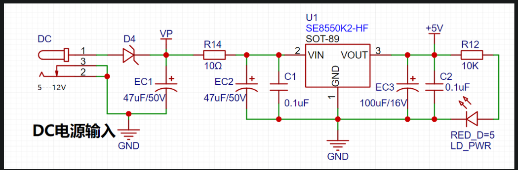

For the hardware design of
the step-down module, the LDO selection is as follows:
This project uses an LDO as the power supply. Considering that most voltmeter products are used in industrial scenarios with 24V or 36V power supplies, the SE8550K2 with a maximum input voltage of up to 40V was chosen. The main reason for not using a DC-DC step-down circuit to handle large voltage drops is to avoid introducing DC-DC ripple interference during the design process; a secondary reason is to reduce project costs. For

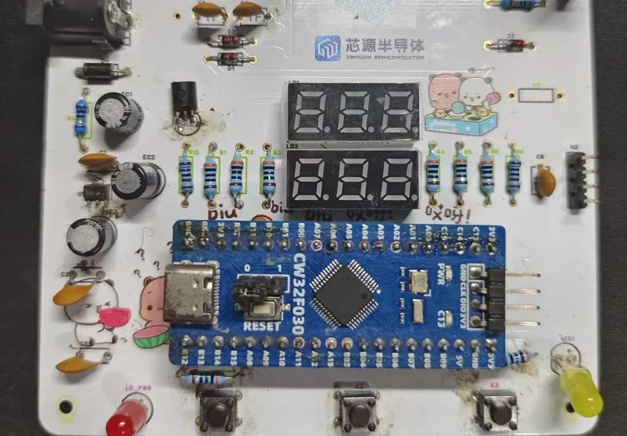

the MCU selection
, to reduce the learning curve, this project uses the LCSC CW32F030C8Tx development board (core board) as the main controller. However, this does not mean we will discuss this section less. From the perspective of training engineers, the correct selection of the main controller is crucial, as it relates to the overall advantage of the project.
Regarding the voltmeter and current meter, some debugging and testing were performed using STM32/CW32 and some other 32-bit microcontrollers. Here, only a comparison with the STM32F103C8T6 is made as a reference for learning device selection, mainly to provide ideas and improve understanding.

Some problems were encountered when replicating this project.
1. The TL431 component was purchased incorrectly; it was intended to be a through-hole component, but due to not checking the package, it was purchased as a surface-mount component.
2. During the process of learning and using CW32, I encountered some issues related to using chips I was unfamiliar with. Previously, I had only worked with STM32 chips, which could be configured using CubumX (and I also learned the standard library). CW32 uses a standard porting library, which differs somewhat from the STM32 standard library.
