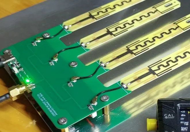

A Buy-One-Get-Five-Free Attempt at a 5.8G Antenna Array V2.0
Disclaimer:
This design is for tinkering and technical learning purposes only, and is not recommended for use in a production environment.
The author will not be responsible for any losses incurred as a result.
It is not recommended to build this without any VNA.
Using a two-layer JLC board offers no impedance guarantee, so your measured results may deviate from the expected performance; this is normal.
Chip inconsistency may be poor. It's amazing to find four LNAs salvaged from all over the country on the same board (not really).
Due to the poor high-frequency loss of the free materials, I still recommend purchasing proven antennas from reputable brands. (Advertisement space for rent (x
antenna belongs to the religious field, I respect and tolerate your beliefs, and I also hope you can tolerate others who are different from you, thank you.
Open source license: CC BY-NC-SA 4.0
What is this mess?
First you need to read the mess of version V1.0:
https://oshwhub.com/libc0607/5g8_cheap_antenna_4to1_v1p0_rel
I won't repeat it, I will continue from V1.0 here.
In order to minimize the impact of board loss on the received signal, I tried to push it with LNA as close as possible to the antenna port. It
is roughly the idea of ​​active antenna array, but since this version does not have transmit and receive switching, it can only be used for receiving.
This version only supports the receiving
design
LNA. Here I chose SKY65981, mainly because 1. small footprint, 2. acceptable NF, 3. 2.4~2.5GHz gain is not greater than 0dB - at least it will not make things worse, 4. fried version only 2 yuan per piece
1.4 cents) The microstrip line structure and reflector structure are completely identical to V1.0.
An EC190708 is used with a button for LNA enable switching. This allows manual switching to bypass mode at close range to prevent your homemade amplifier from overpowering the LNA.
Type-C power is used, but it seems I made a mistake. You can modify the interface or use a jumper wire
to connect the LNA power supply on the back of the board with a 1.25mm jumper, as shown in the picture.

Using a deep-fried LNA (unit price about 2 yuan), the total cost comes to about 20 yuan. In
addition to common electronic building tools, you will also need the following tools:
electric drill/hand drill,
1.0mm/3.0mm drill bit that can drill aluminum plates
, sandpaper or other similar materials . It was too hot outside (?), so I
tested
it indoors. A6 network card + app reception, MCS1. In short, it is several dB stronger than V1.0 in the same location, and much stronger than a single original antenna.
