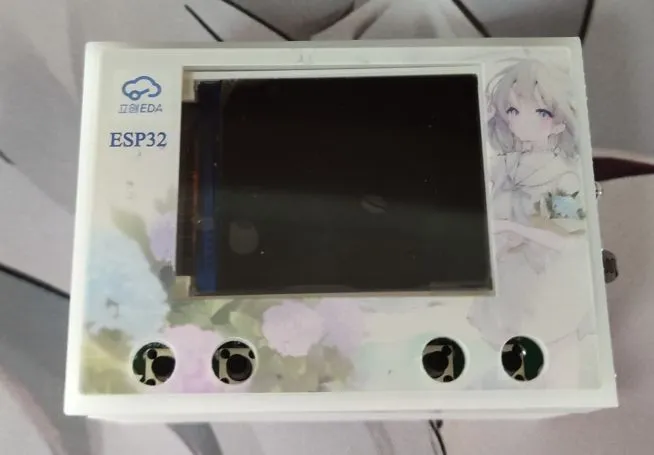

Based on the LCSC ESP32 S3 development board and using the ESP IDF as the development environment, a simple desktop assistant was created to achieve WiFi connectivity, remote air conditioner on/off control, temperature and humidity monitoring and uploading, and time display functions.
1. Function Introduction
This project was designed and built using the LCSC ESP32 S3 development board. Currently, it has achieved WiFi connectivity, remote air conditioner on/off control, temperature and humidity monitoring and uploading, time display, and cloud-based intelligent APP interface display and control functions.

6. Assembly Instructions:
All resistors and capacitors in this project use 0603 packages. Only the chip soldering is relatively difficult; with a few attempts, you can complete the soldering. After the code is burned, install the product into the casing. Note that there are four 1.8mm diameter posts for positioning at the screen; do not break them.
