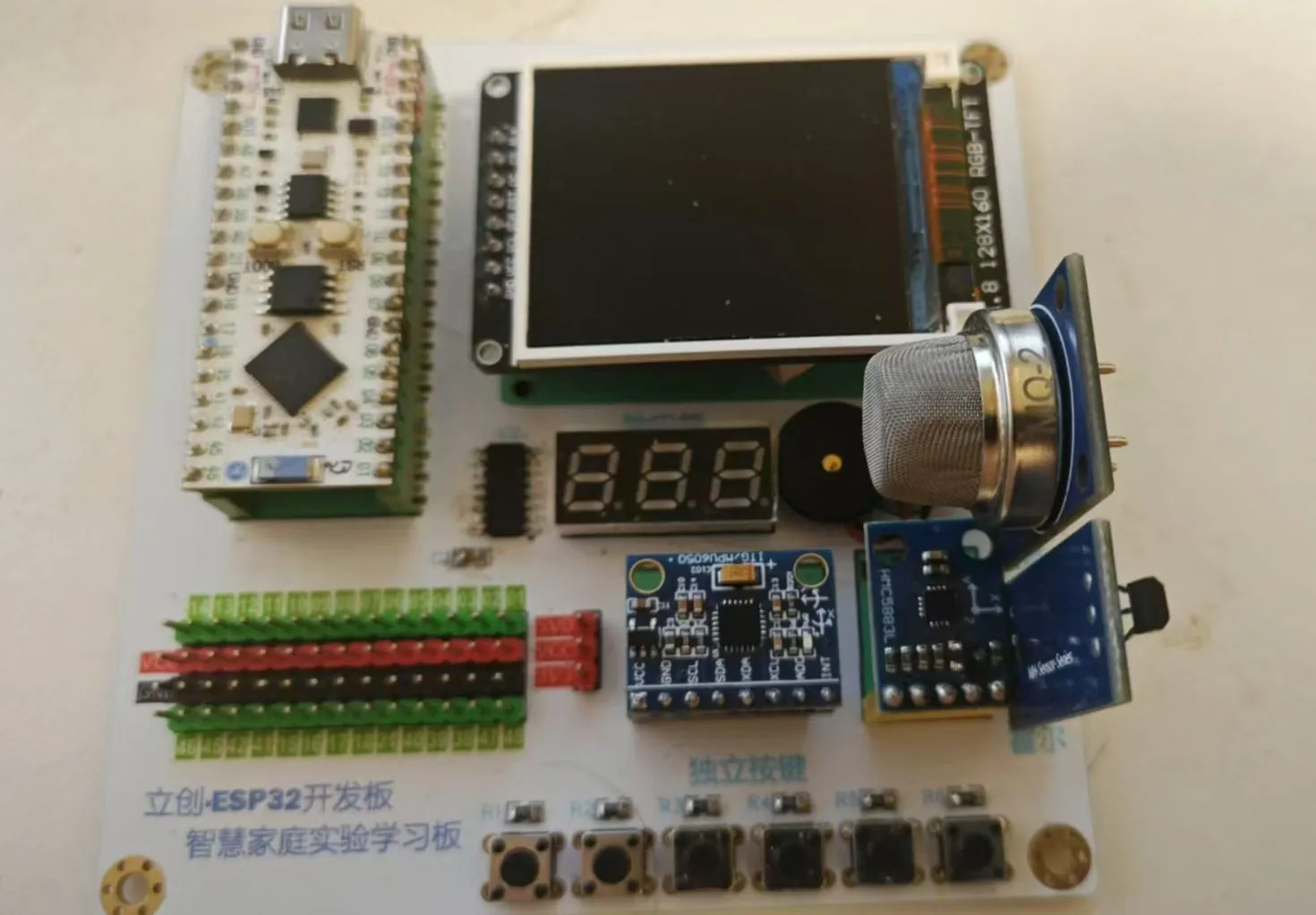

This project introduces a smart home experimental board based on the LCSC ESP32 development board
. It integrates switches (micro-buttons), lights (LEDs), alarms (buzzers), door and window indicators (Hall sensors), smoke alarms, digital tubes, screens, and expansion interfaces.

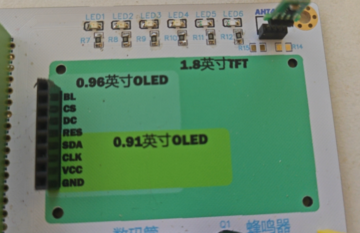

Regarding the screen,
various screen sizes are available, including 0.91, 0.96 (I²C, ISP), and 1.8-inch TFT.

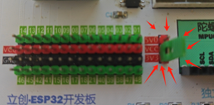

Regarding the expansion interface
, since different sensors have different voltages, the voltage can be selected via jumpers when using the sensor.

Smoke Alarm Experiment
Hardware:
This experiment
uses a LCSC ESP32 development board ,
an MQ-2 sensor, and
a 1.8-inch TFT screen (ST7735).
