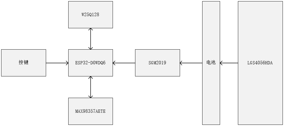

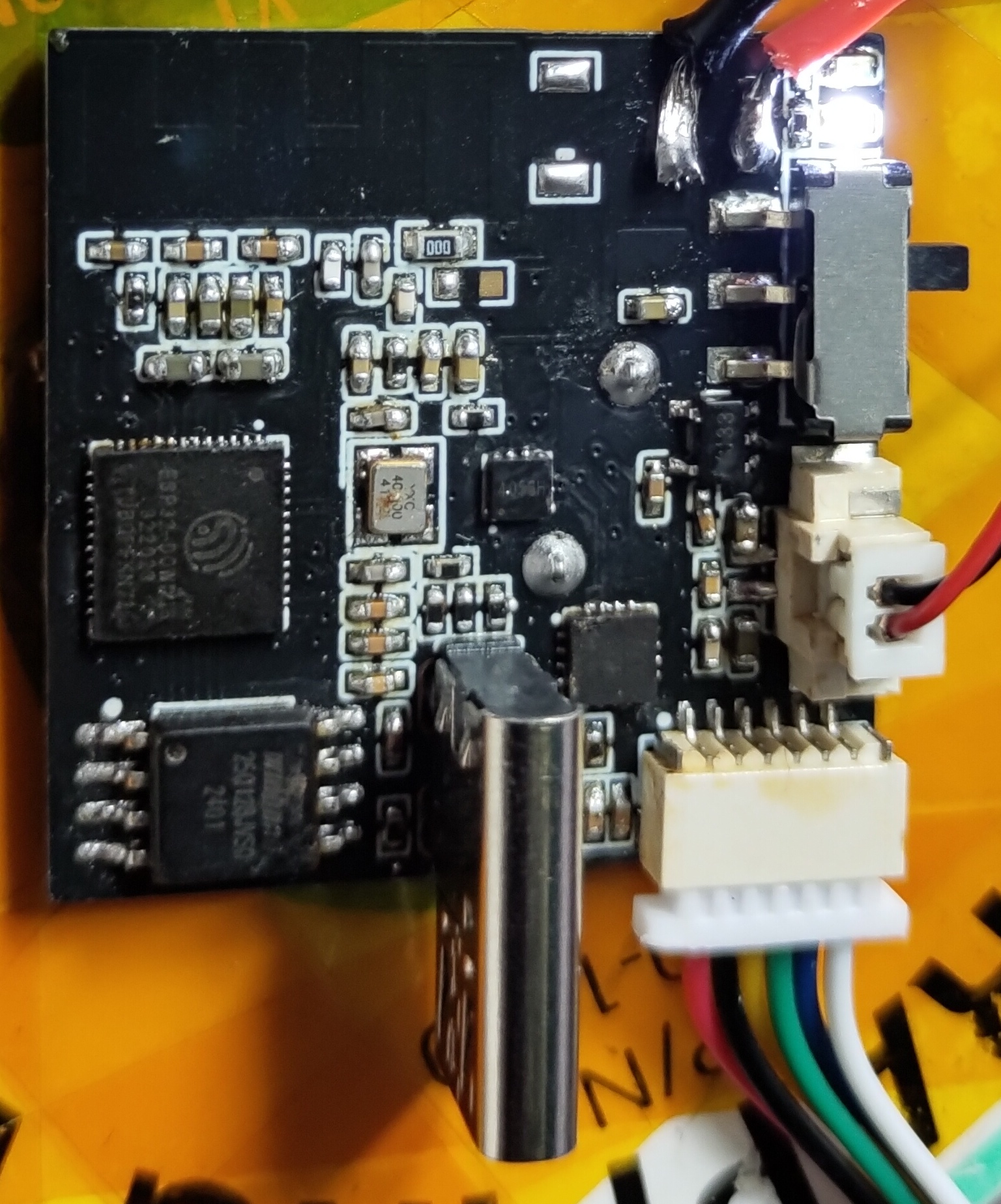

The hardware consists of
an ESP32-D0WDQ6 microcontroller, a MAX98357AETE microcontroller, and an LGS4056HDA microcontroller.

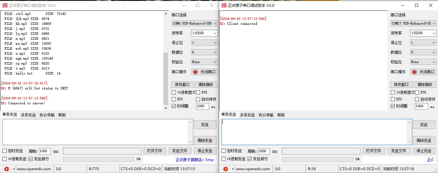

establish a local area network TCP connection between the host and slave devices
. After power-on, the device will attempt to connect to the pre-configured network. The device checks its WiFi connection status every 5 seconds. If no network is found, the device will scan for nearby WiFi hotspots. In the scanned hotspot list, if a known, pre-configured hotspot exists, the device will attempt to connect to it. Once connected to the WiFi network, the device will start a TCP server, listening on port 8080 for TCP communication.

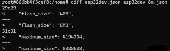

PlatformIO + Arduino. The PIO board
configuration was modified
, and an ESP32 was chosen. The default ESP32 FLASH size is 4MB, but this is too small, causing insufficient space before many functions are added to the program.

The configuration
file is typically located in {userProfile}.platformioplatformsespressif32 oards. The content to be modified is as follows; you can directly modify the original file or create a new one.
An 8MB configuration file and
a 16MB configuration file are
needed to modify the project configuration file,
including platformio.ini.

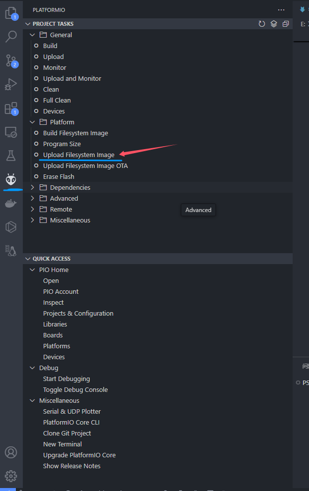

Upload files
to the SPIFFS partition. Create a data folder in the project. Clicking the download option will synchronously upload the files in the data folder to the ESP32. Deleting or removing data files will also update the SPIFFS partition.
