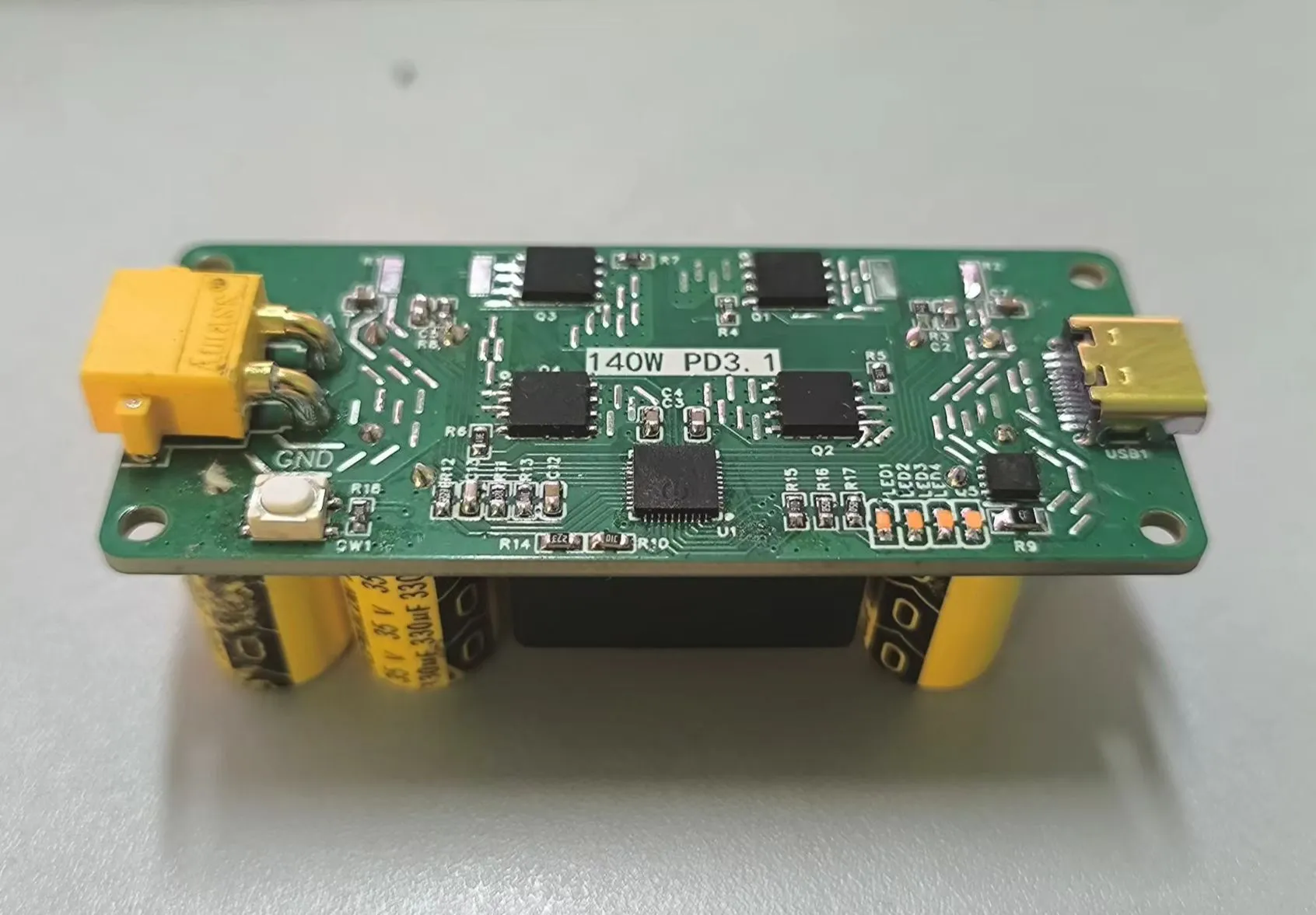

Note that the XT30 interface used in this project is a reverse definition. Please carefully confirm before inserting the battery!

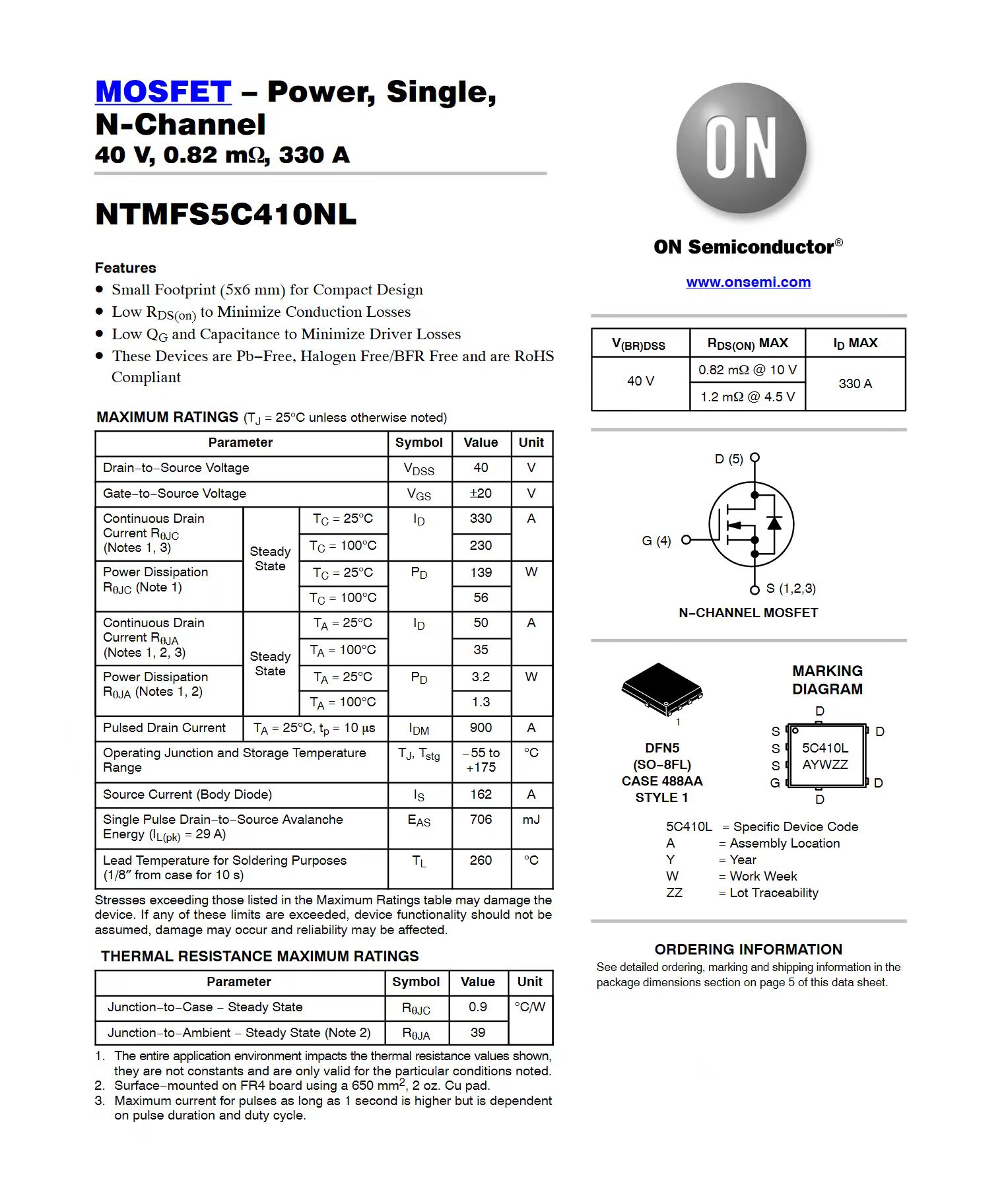

The configuration uses a 5S battery with a power output of 140W. The default power receiving
MOSFET should not be the TPH1R403NL shown in the schematic. It generates significant heat during 65W charging;
the ON Semiconductor NTMFS5C410NL is recommended. At 65W charging/discharging, a heatsink is not required. At 100W charging, the upper MOSFET temperature rises to over 80℃ after 3 minutes. At 140W charging, it lasted only 1 minute before short-circuiting and burning out the heatsink.

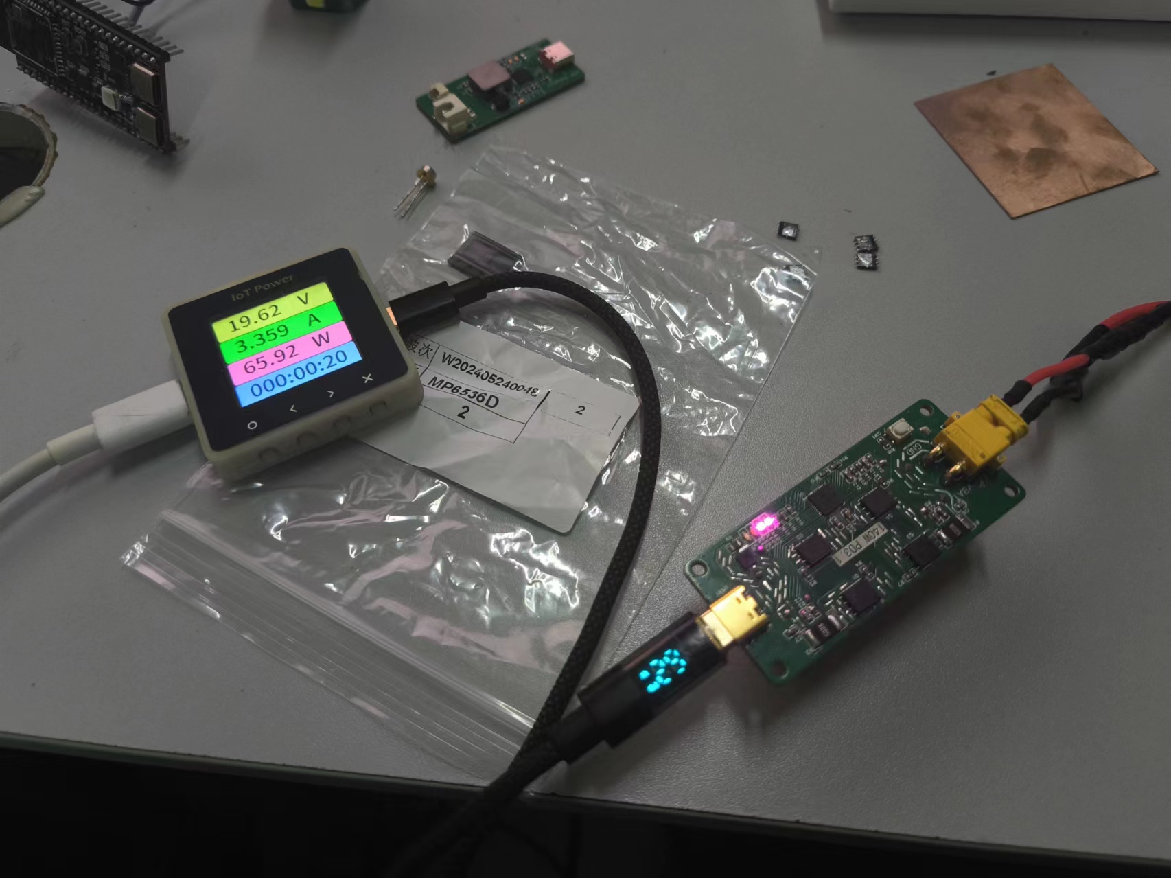

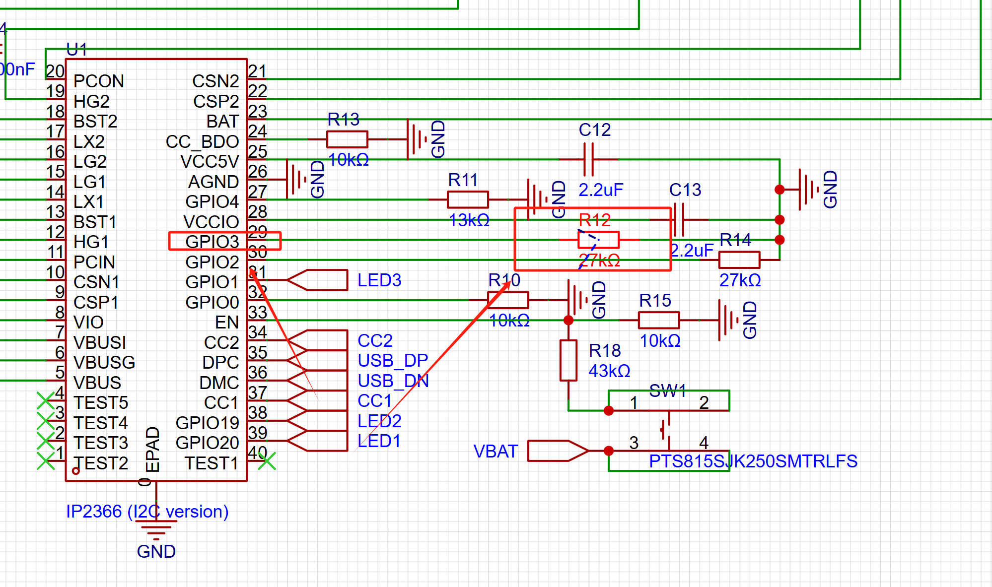

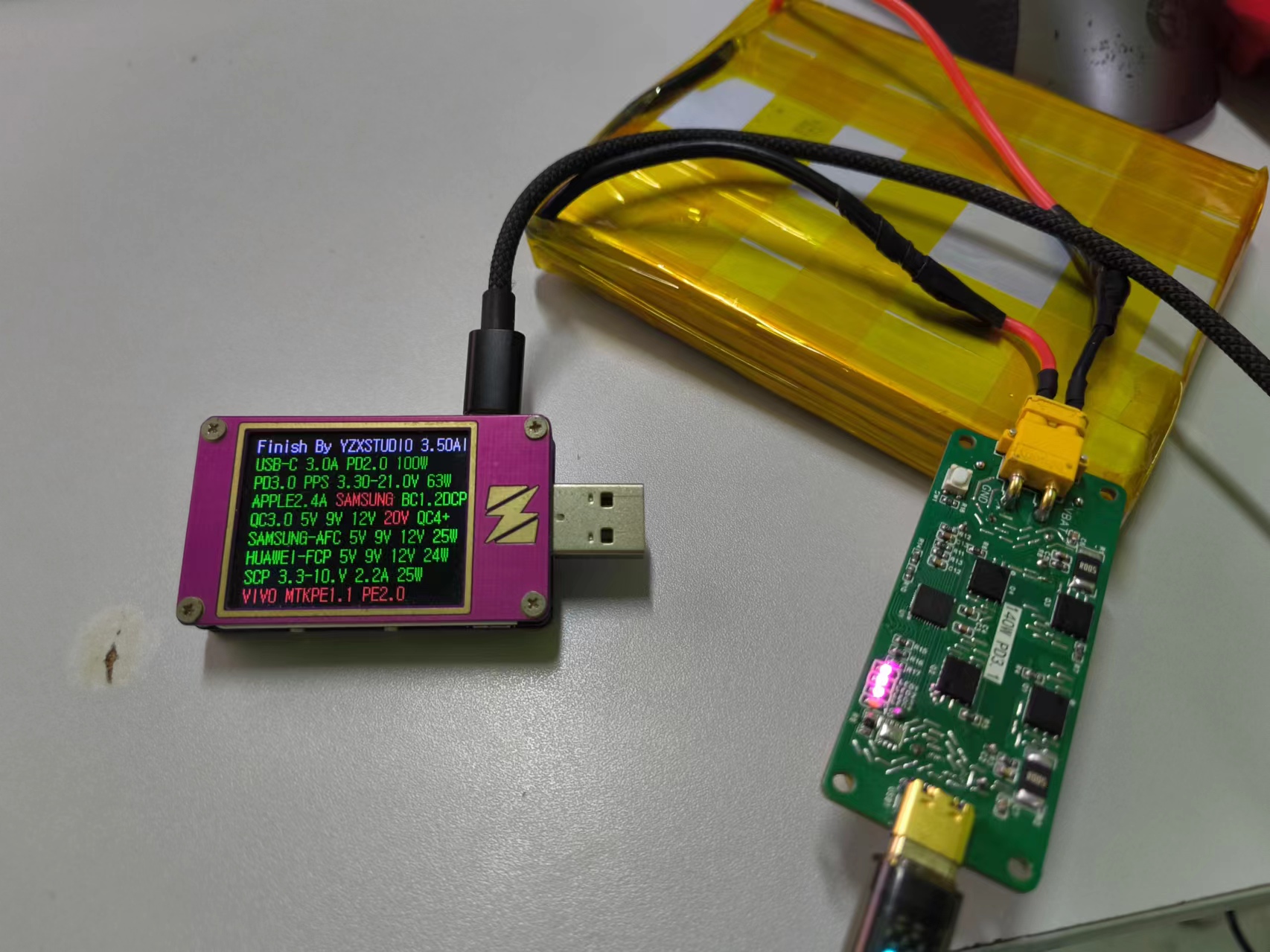

100W CC line discharge protocol (this meter cannot measure high-voltage 28V PD3.1). For
65W charging
, it is recommended to reduce the power and modify the GPIO3 resistor.
