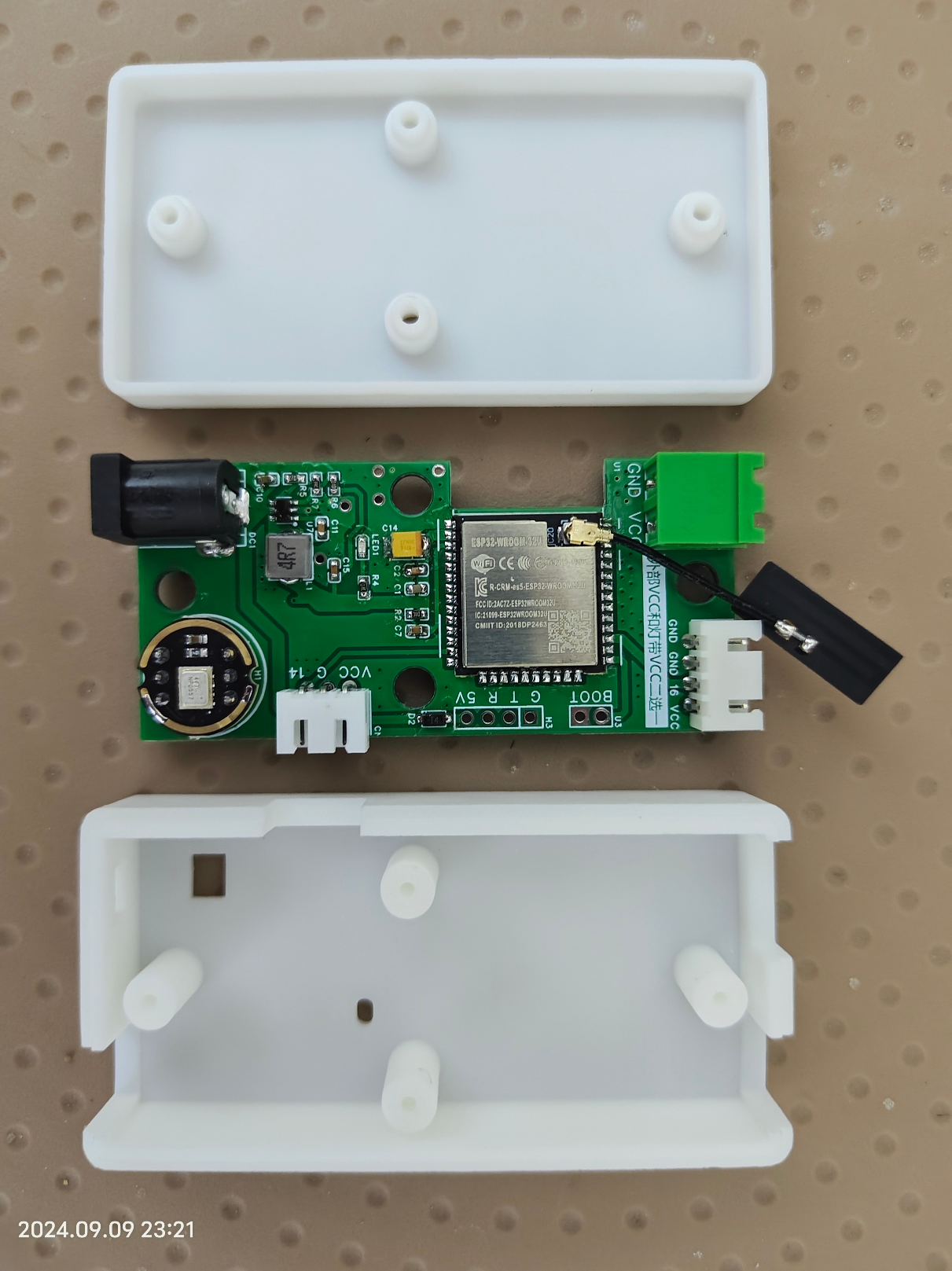

Project Introduction
: This section provides a basic description of the project. Example:
This project is based on ESP32 and INMP441, flashed with the WLD program, and integrated with Home Assistant to achieve automatic switching between music rhythm and ambient lighting.
Project Functionality:
The Blue Night speaker is integrated with Home Assistant. When music is played through Home Assistant, the music rhythm effect is automatically switched, and the WLD music rhythm function is enabled. When no music is playing, the ambient lighting effect is switched, and the WLD music rhythm function is automatically disabled.
Project Parameters:
This design uses the INMP441 module for easy soldering;
a 4-pin interface for easy connection to the WS28xx series;
one spare interface is reserved;
the LED strip has an independent power supply
interface. 3D shell
programming and configuration are available
at https://install.wled.me/
. Select the Audioreactive version
, connect to WiFi, enter the ESP32 IP address, open the WLEED interface
, find MQTT under Config->Sync Interfaces, open and configure the HA MQTT.
Restore my presents (wled_presets_WLED-CL.json) or create
a new automation for Bluetooth speaker volume and lighting control in HA. The attached file contains code; modify it to match your corresponding entity and WLEED MQTT theme.
Important Notes:
Only one of the independent power supply and signal line VCC can be connected. When programming
with M2*10 screws,
if only the serial port is connected and not the power supply, D2 needs to be shorted; otherwise, the voltage will be insufficient.
