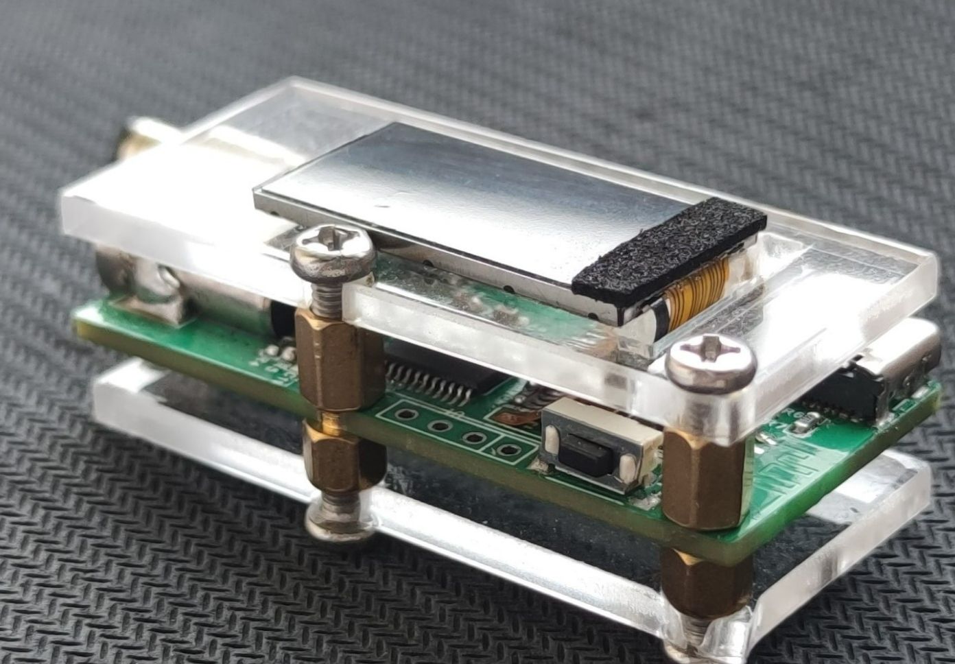

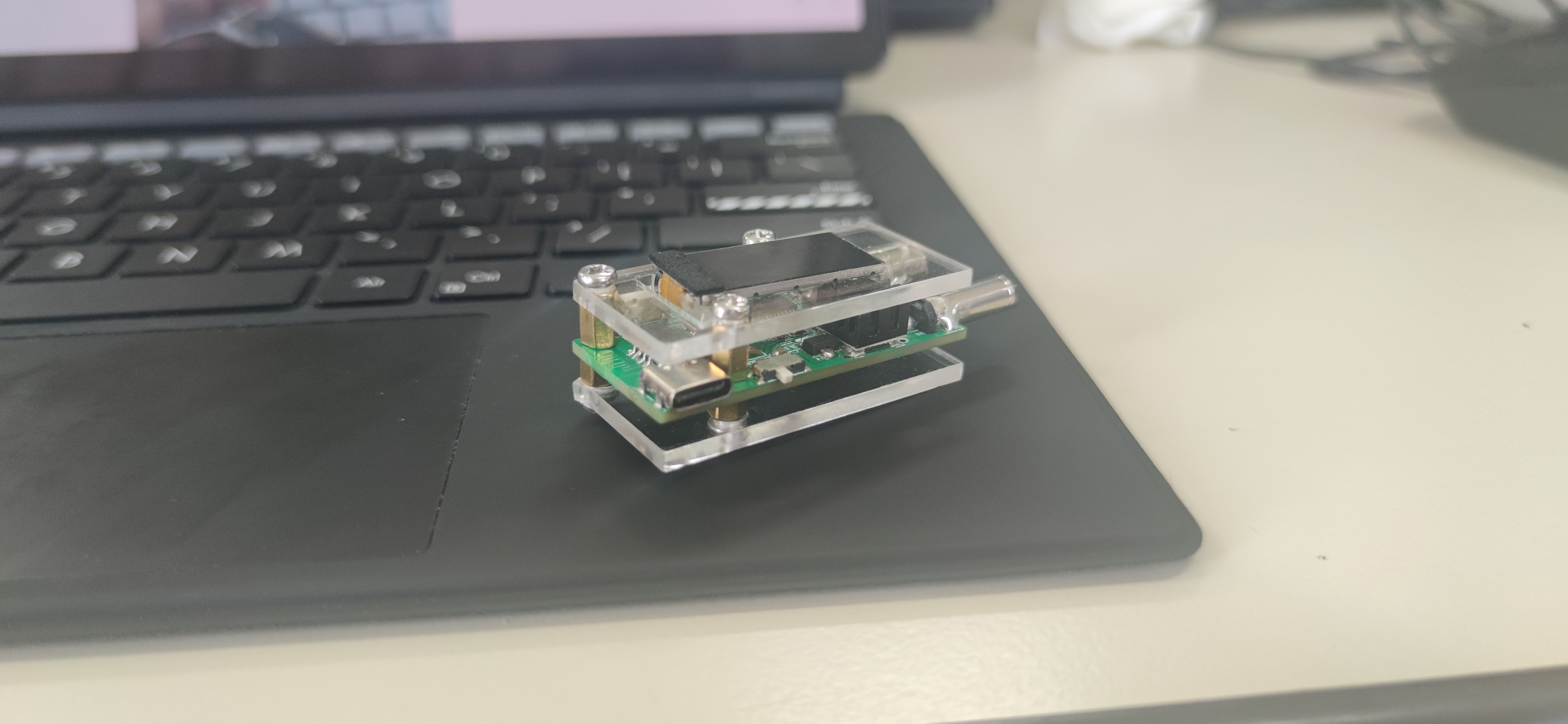

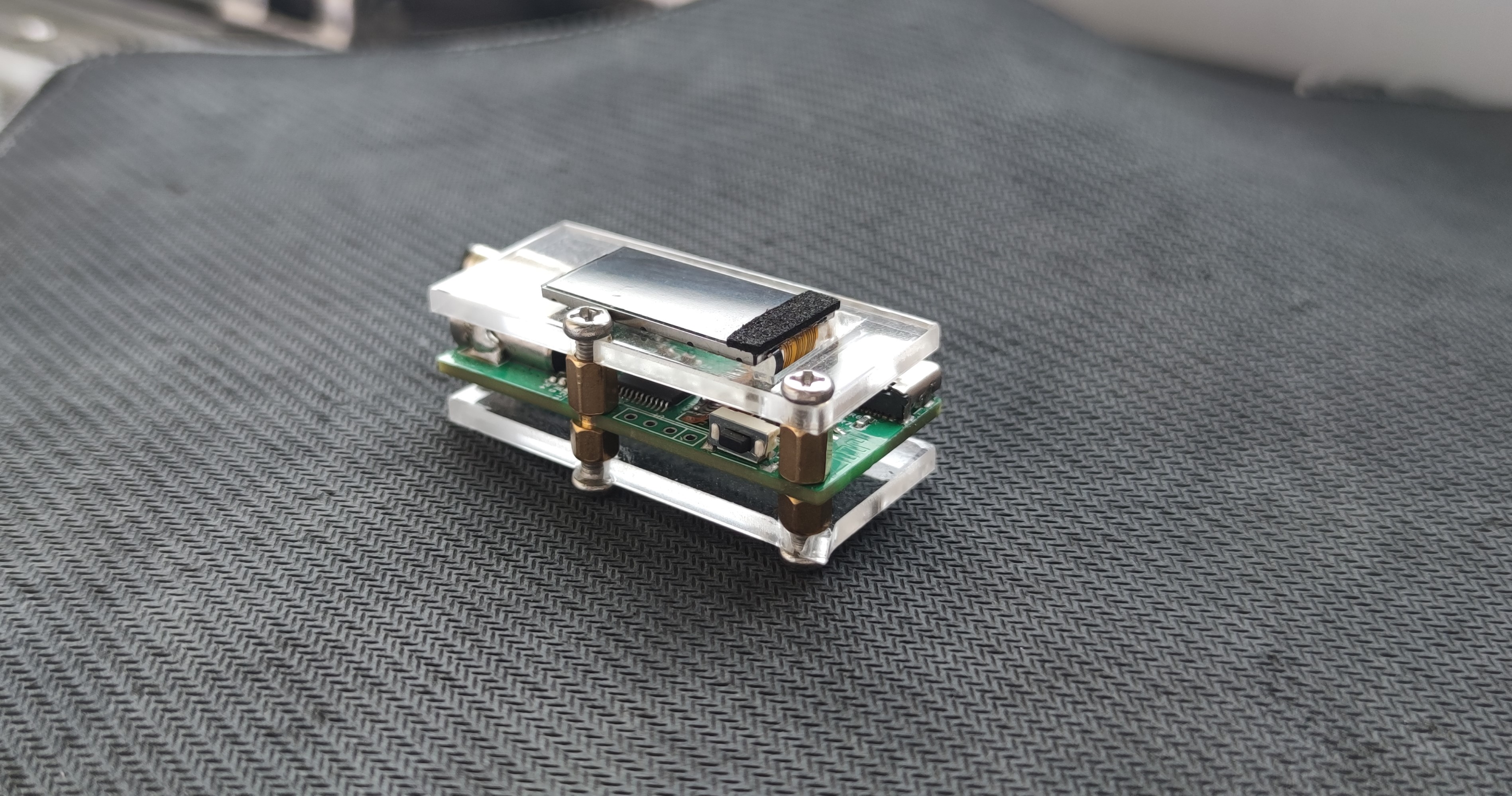

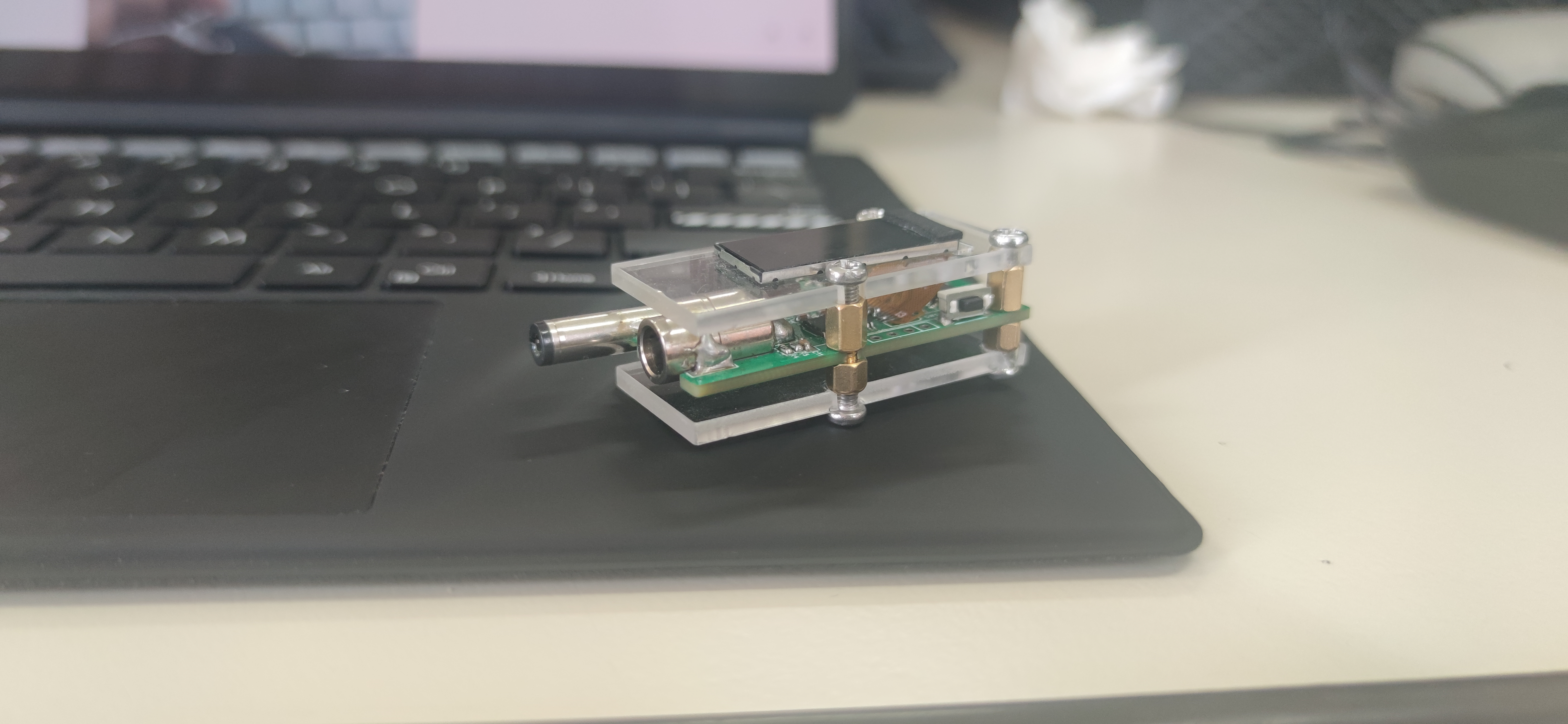

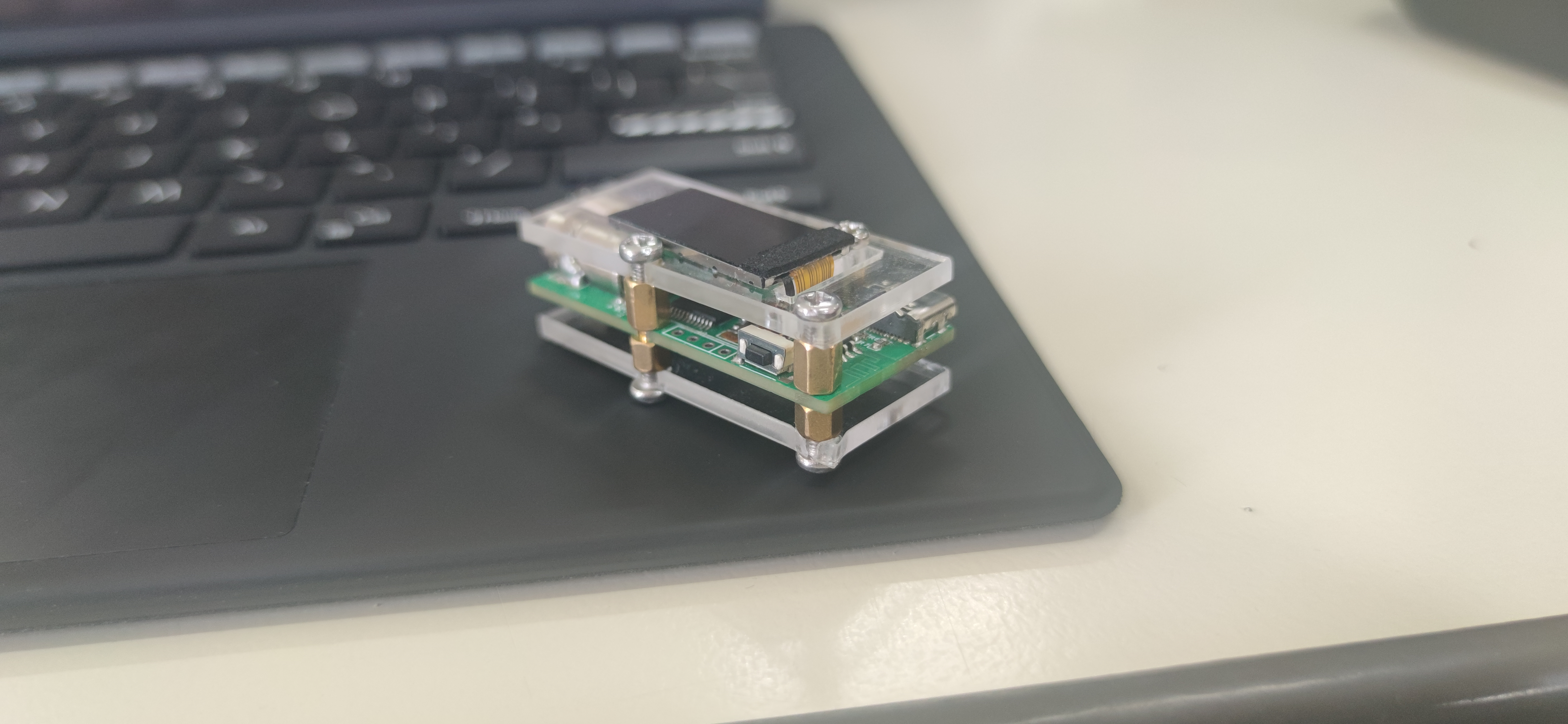

CW32 Digital Voltage and Current Meter
This is a voltage and current meter made using a CW32F003E4 microcontroller. The microcontroller has a main frequency of 48MHz and a very stable 12-bit ADC peripheral, providing the possibility of making a high-precision current and voltage meter. Therefore, two UI interfaces were created: one for current, voltage, and power, and the other for voltage and current curve plotting. The current sampling resistor is 300mΩ, and with the addition of a heatsink, the range can reach 3A. The data processing method is to calculate a linear regression equation between the sampled data and the measured value. The accuracy can reach 0.001A for current ranging from 0-600mA, and the voltage resistor divider ratio is 1:23, with an accuracy of 0.01V.
