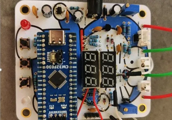

Due to an oversight in drawing the schematic, one segment code from two common-cathode digital tubes was connected together, while the segment codes were separated. This is something that requires special attention. It took a long time to troubleshoot, and I had to use flying wires to solve the problem. There are many references for connecting common cathode and common anode digital tubes; I will only briefly mention them here. Choosing digital tubes to display current and voltage values ​​better meets the needs of learning and debugging, and their cost and performance are both good.
In the project, actual testing showed that a 300Ω value for the current-limiting resistors (R1~R6) resulted in good brightness and non-glaring visibility of the digital tubes.

Figure
1:
Ignoring the flying wires—this is the price of careless schematic drawing!!!
