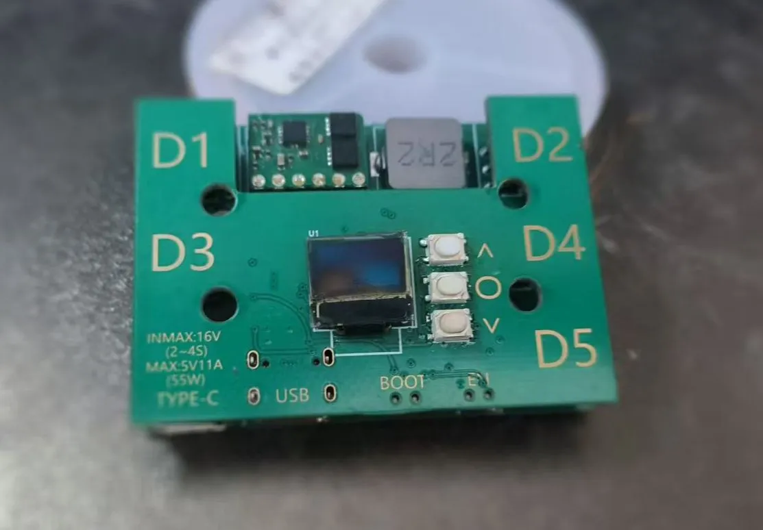

Esp32c3 Servo Drive Board
Project Overview:
This project is a five-channel servo drive board based on the ESP32C3-Mini.
Project Function:
It can simultaneously control five PWM servos.
Project Parameters
: Power Supply
: Input voltage 16V (2-4s battery);
Output voltage adjustable, maximum output current up to 10A;
Output voltage adjustment is possible via resistors on the power board.
Other Onboard Modules:
One I2C gyroscope and accelerometer;
One 16*42 mini OLED screen;
Three buttons with pull-down circuitry.
Core Board: The core board itself has a built-in Type-C interface for downloading;
An I2C interface is located on the back of the board for expansion.
Principle Analysis: (Hardware Description)
This project consists of two circuit boards:
a core board and a power board .
They are connected vertically via headers and pin headers.
A 16V voltage is
stepped down to 5V by the power board, then
back down to 3.3V by the core board via headers and pin headers
to supply the chips. The chips send PWM signals to the power board below
via headers and pin headers on the core board, which then drives five servos. Note: Because chip packaging and soldering are relatively difficult, it is recommended to use a soldering station. There are five 100µF capacitors on the back, which can be soldered or left unsoldered. Assembly Process : Well, there's not much to say; just assemble them after soldering. [ Image of the actual product]
