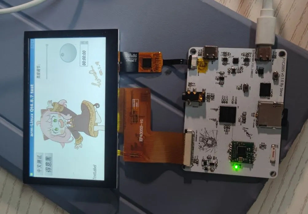

  All hardware has been verified to be usable! The actual PCB diagram is shown below:
  The LCD screen used in this article is a 4.3-inch 800*480 GT911 touch chip LCD screen from "Yoyuan Hong Technology". If you do not want to modify the screen timings of the kernel and uboot, you can directly purchase the same model from Taobao.

5. Test Photos:
MP3 Audio Playback: (using mplayer)
MP4 Video Playback: (mplayer, very laggy)
Qt4.8.7 Test:
WIFI Test: (very slow)
