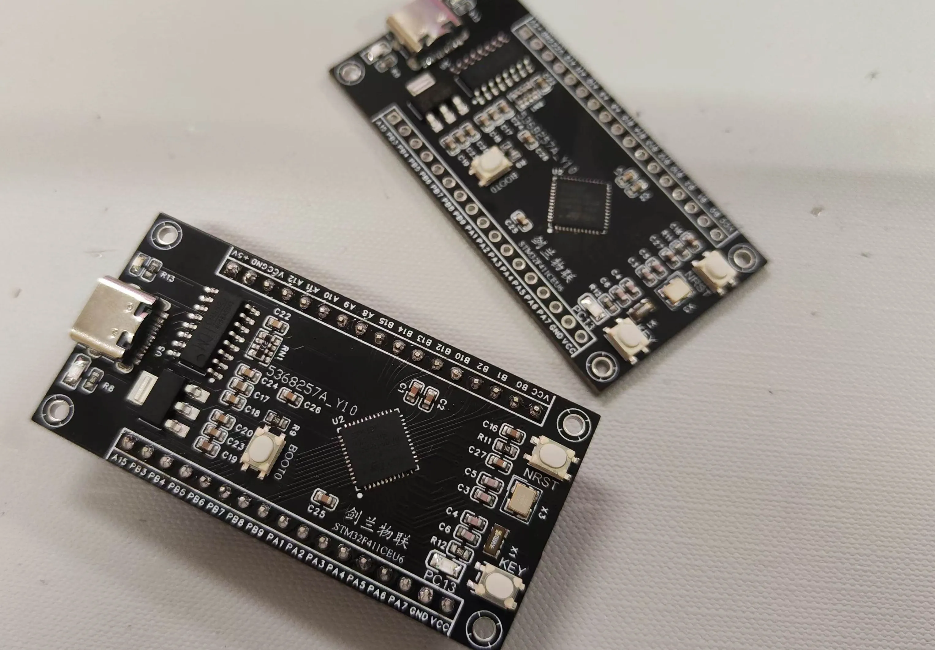

STM32F411CEU6 Minimum System Board with Built-in DAPLINK
Video Link:
[Bilibili Video - Function Demonstration and Introduction] https://www.bilibili.com/video/BV1JRpweWEJr/)
Project Introduction:
This project is a development board based on the STM32F411 microcontroller, with an onboard WCH552GDAPLINK
physical image.
PDF_STM32F411CEU6 Minimal System Board with DAPLINK.zip
Altium_STM32F411CEU6 Minimum System Board with DAPLINK (.zip)
PADS_STM32F411CEU6 comes with a minimum system board for DAPLINK.zip
BOM_STM32F411CEU6 Minimum System Board with Built-in DAPLINK.xlsx
