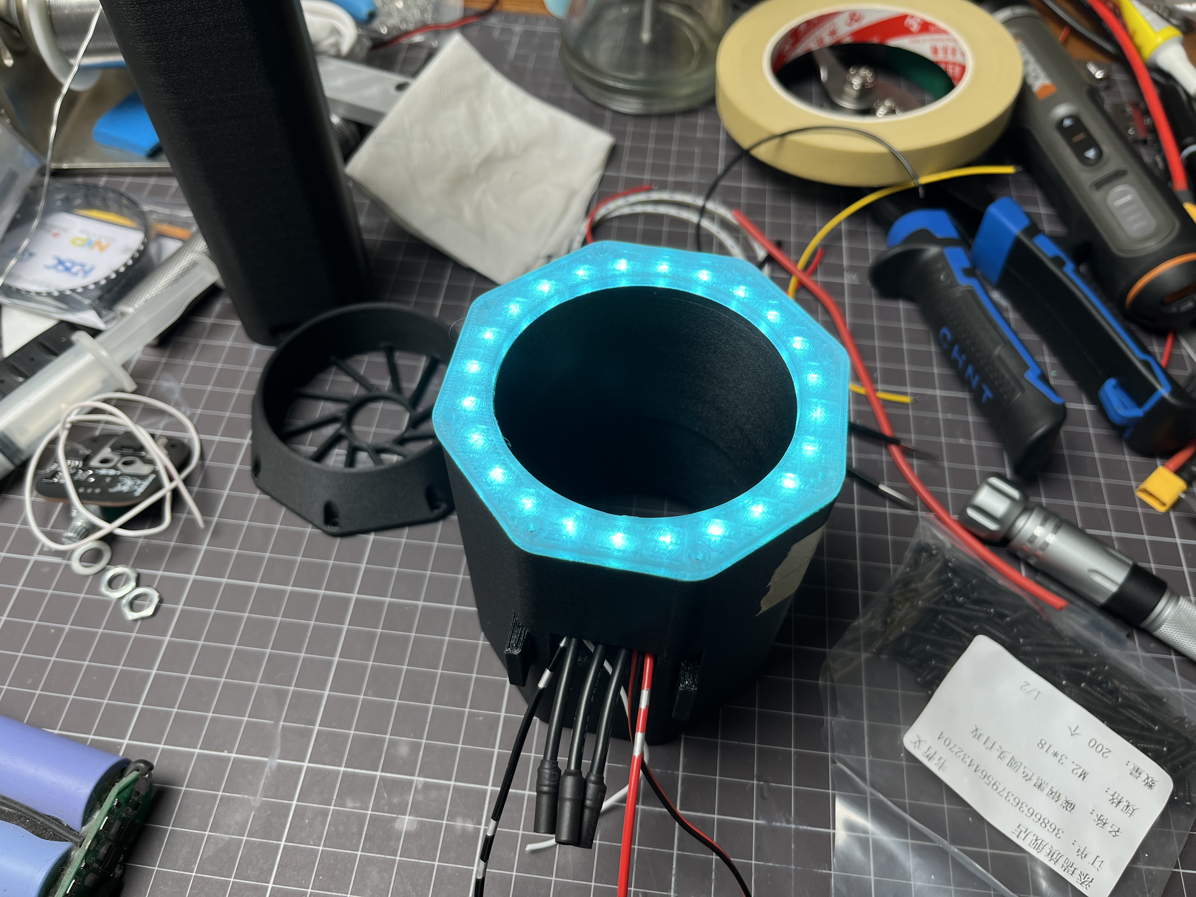

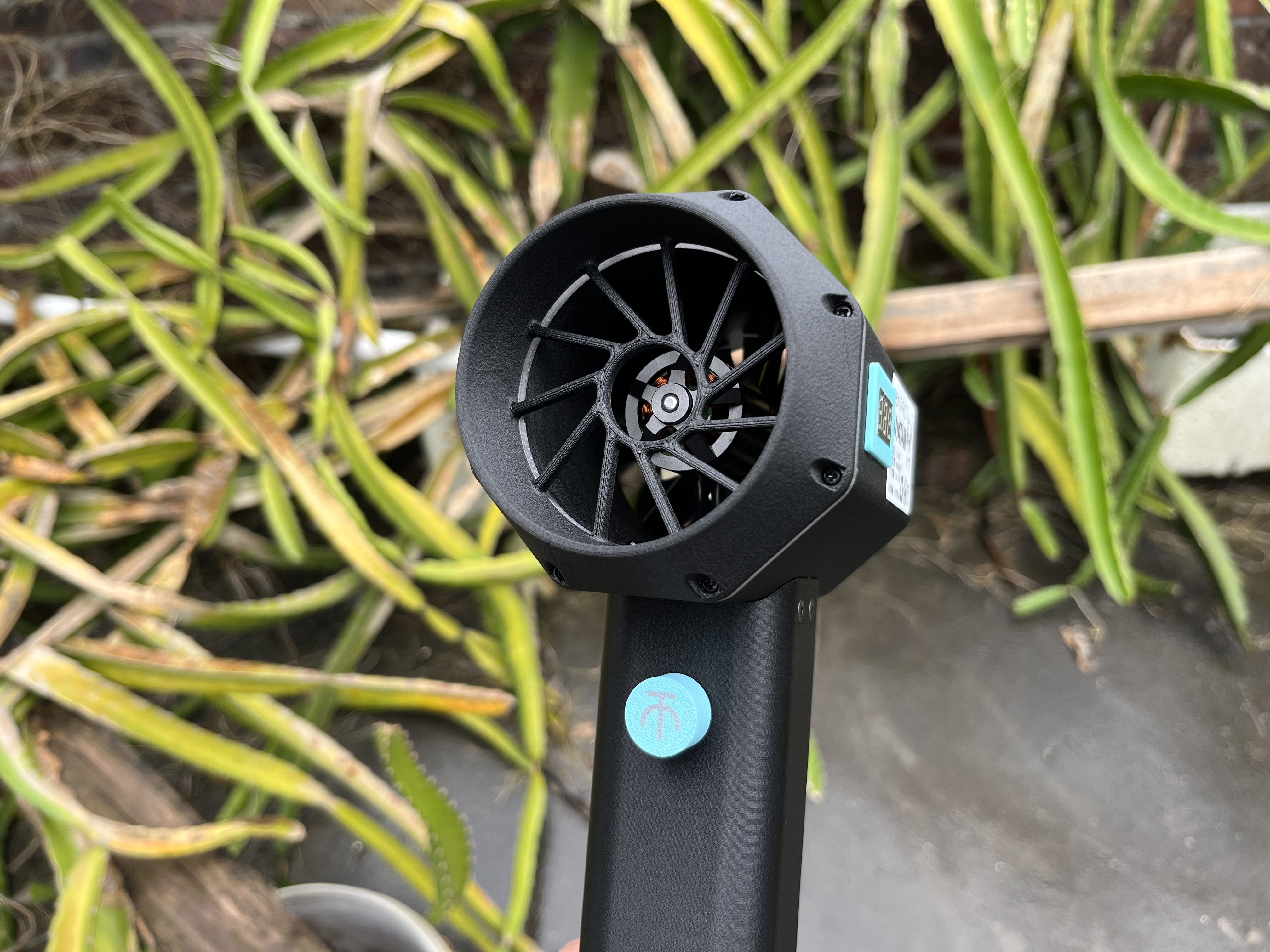

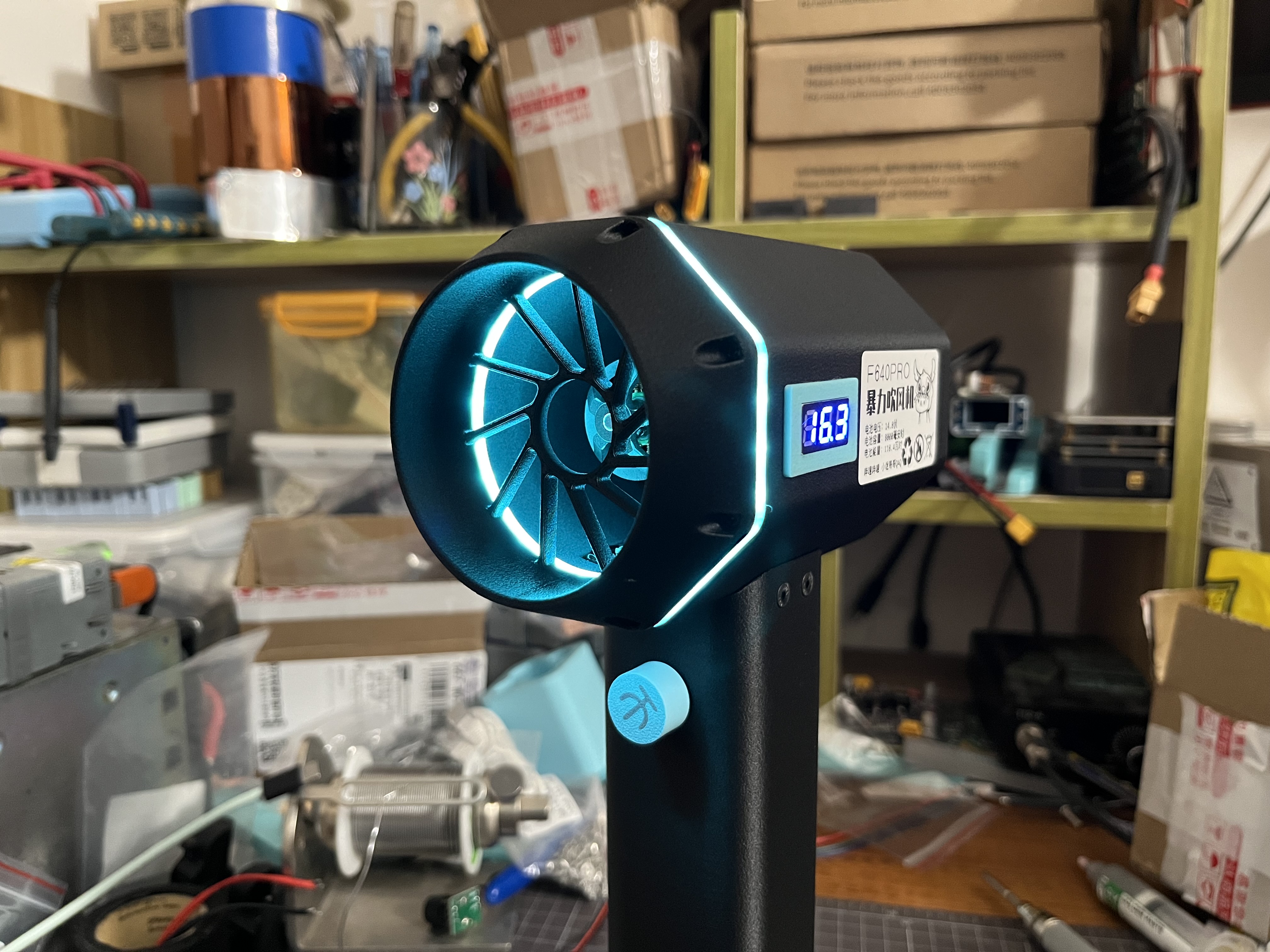

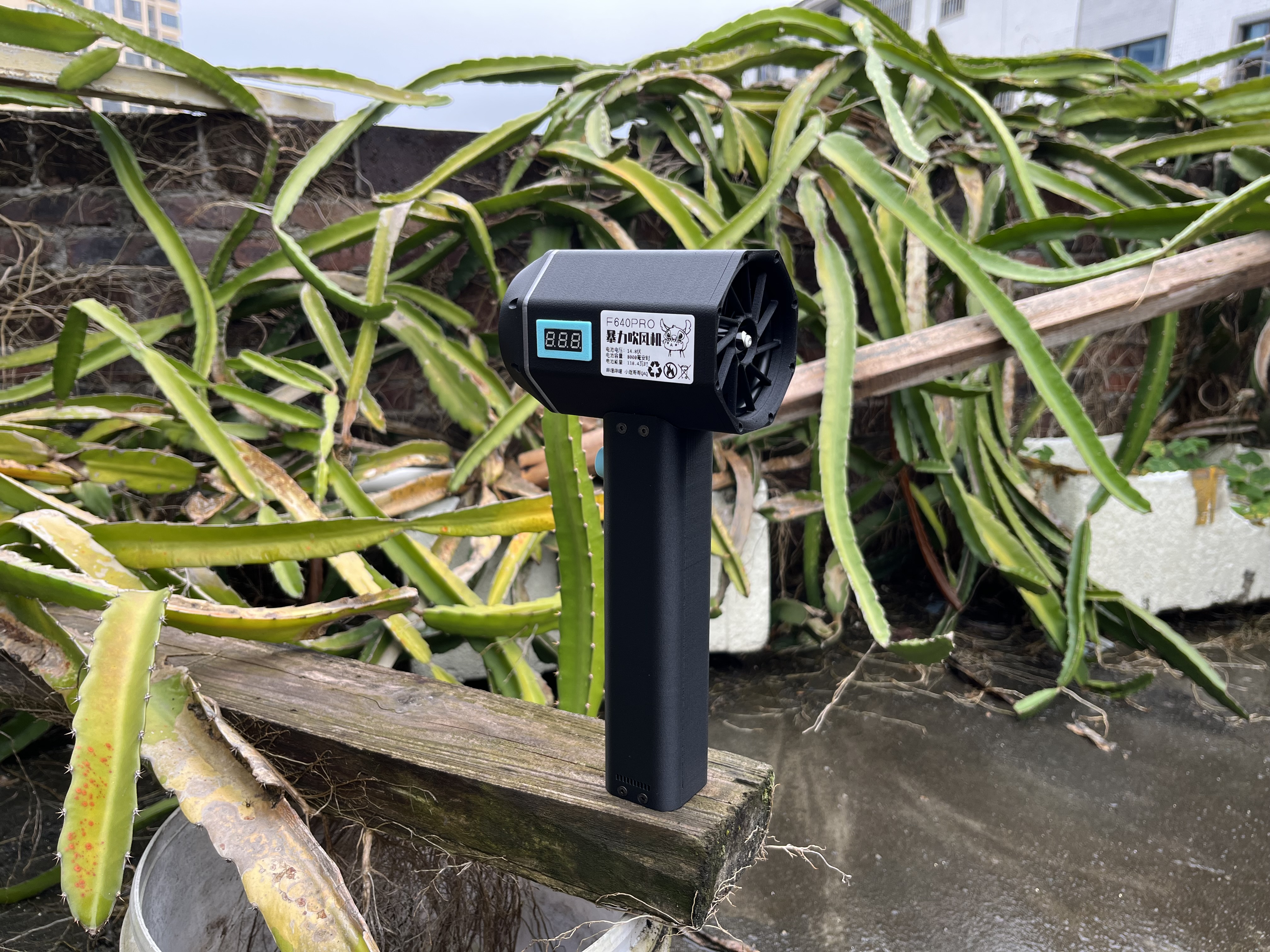

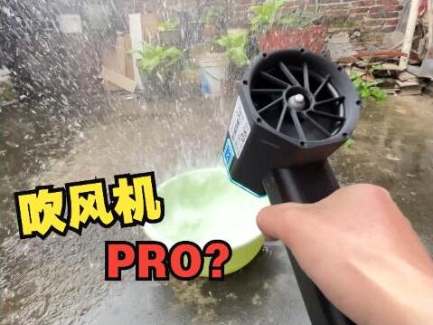

Speed ​​control integrated switch, 4s battery powered, the fan's full load current can reach over 41A,
so a high discharge rate power battery is required,
such as Samsung 40T, Samsung 50S, Lishen LA, Changhong Sanjie 40S, etc.
Appearance appreciation:

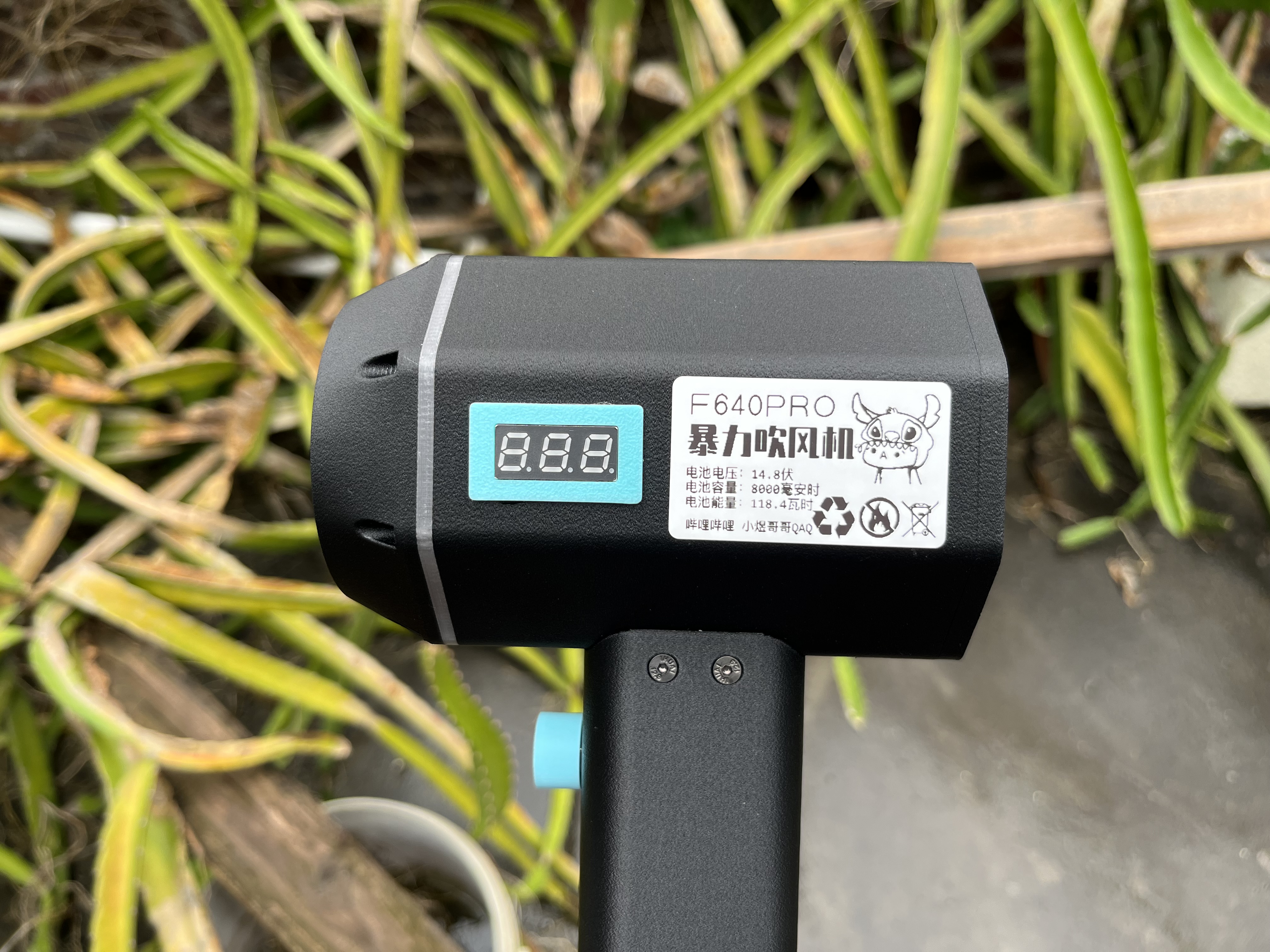

A voltmeter is located on the side, allowing real-time monitoring of the battery voltage.
The ice-blue ambient lighting

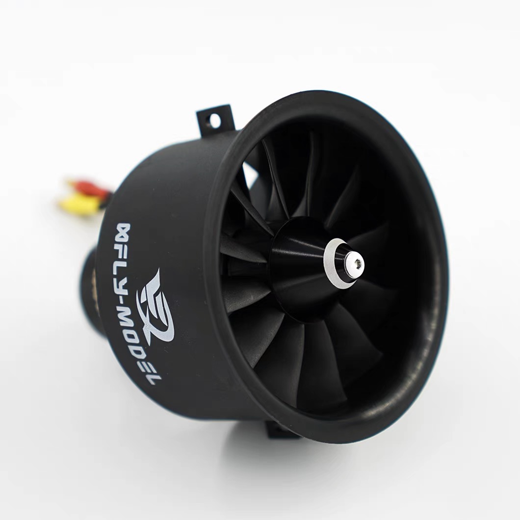

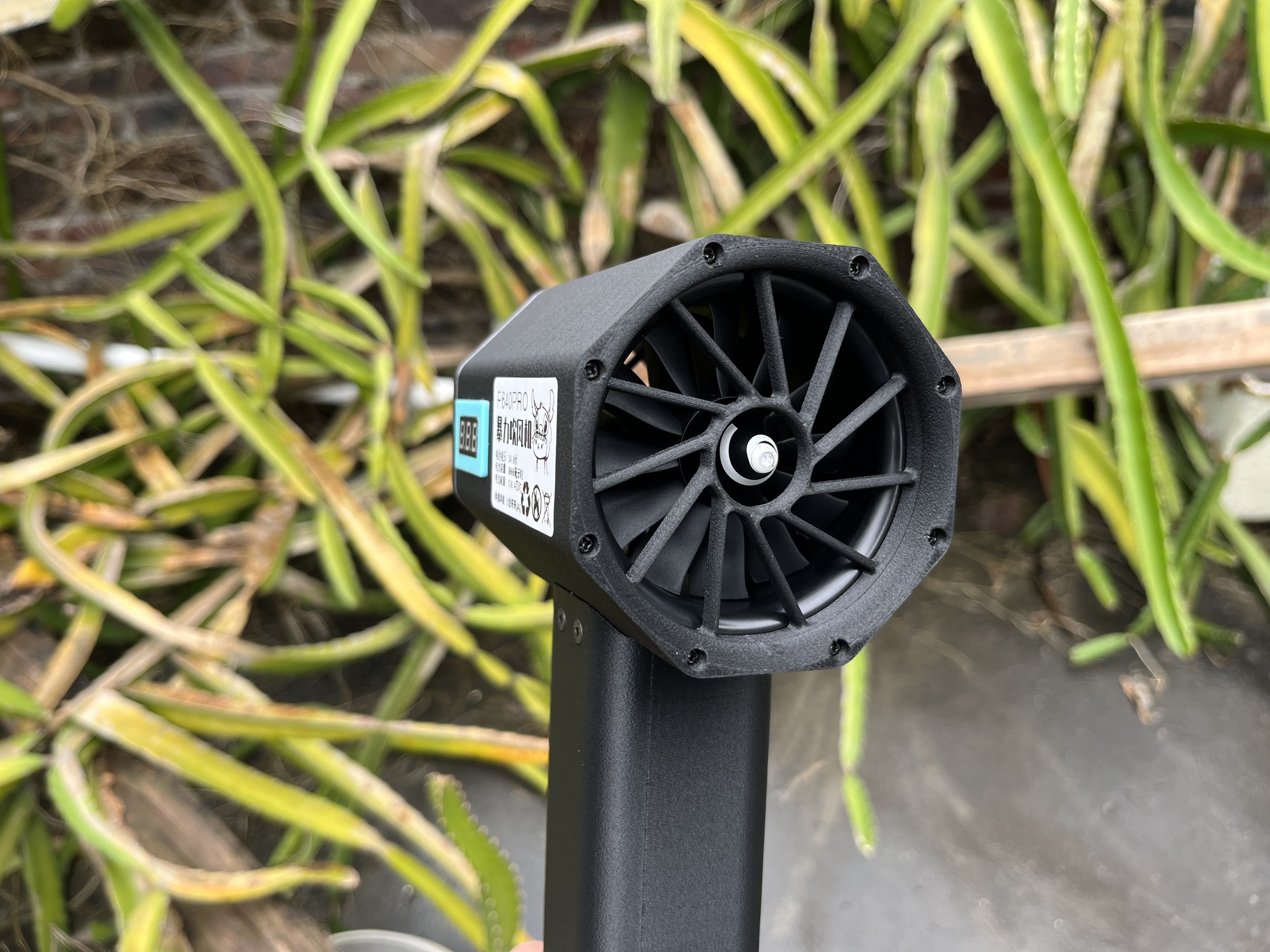

fan system uses a 64mm 12-blade ducted motor from XFly (click the text to go to the purchase link).

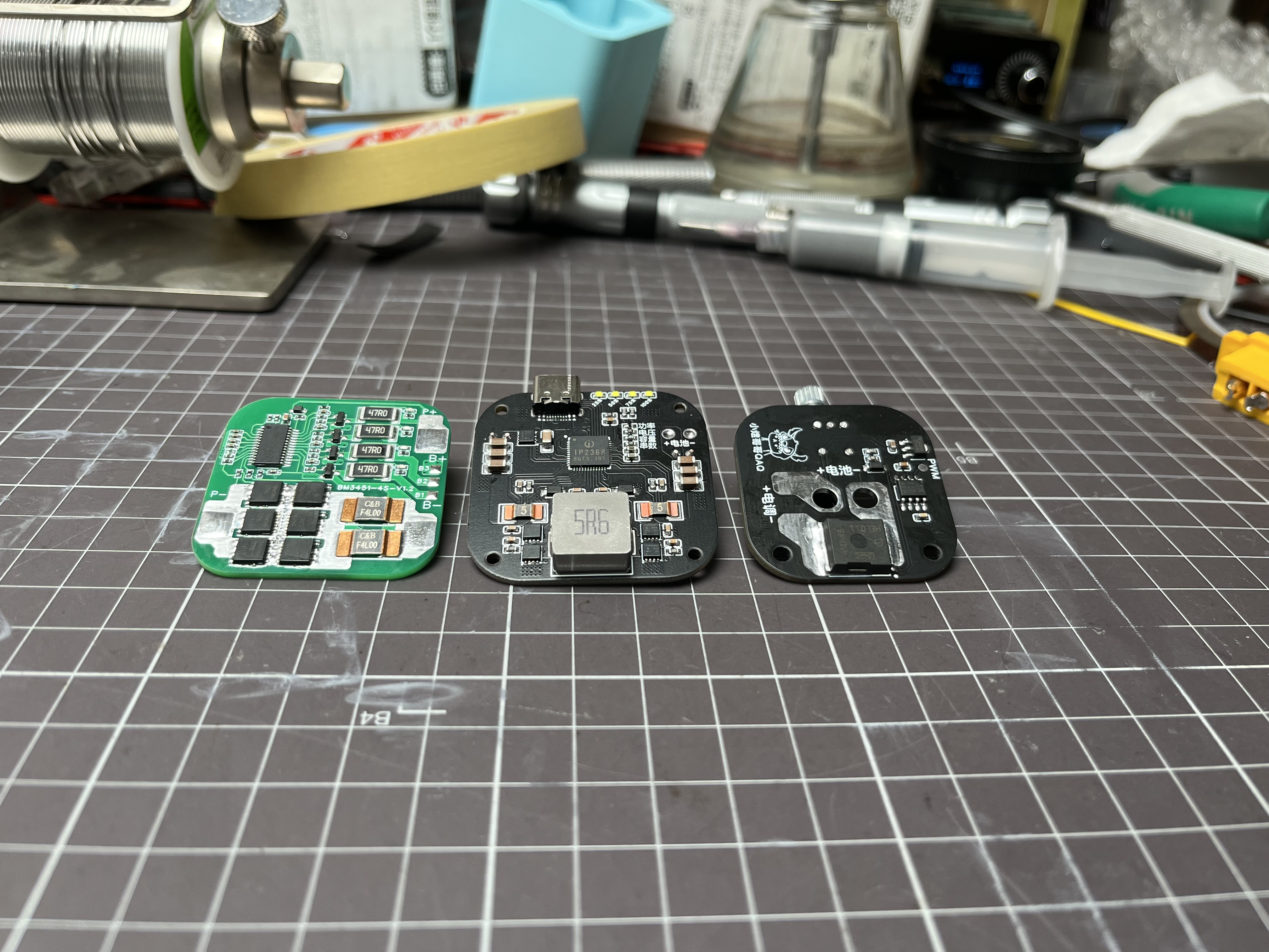

It requires three boards: a lithium battery charging board, a lithium battery protection board, and a brushless ESC speed control board, as well as a 0.28-inch voltmeter.
Charging board: https://oshwhub.com/wzw666/2368mini
Protection board: https://oshwhub.com/wzw666/bm3451pro

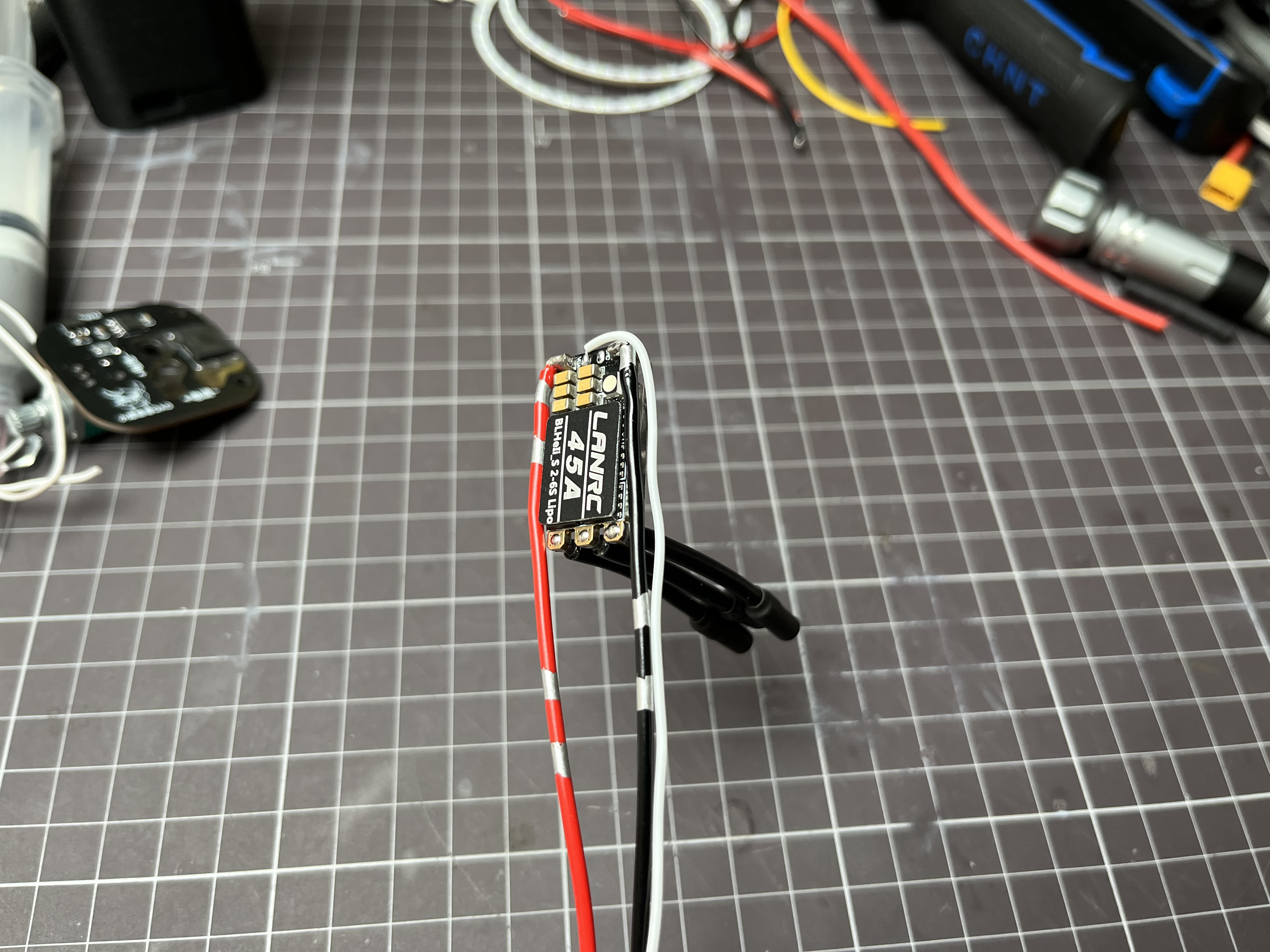

Four-series, two-parallel battery packs; the MOSFETs on the protection board need heatsinks for heat dissipation. This image shows

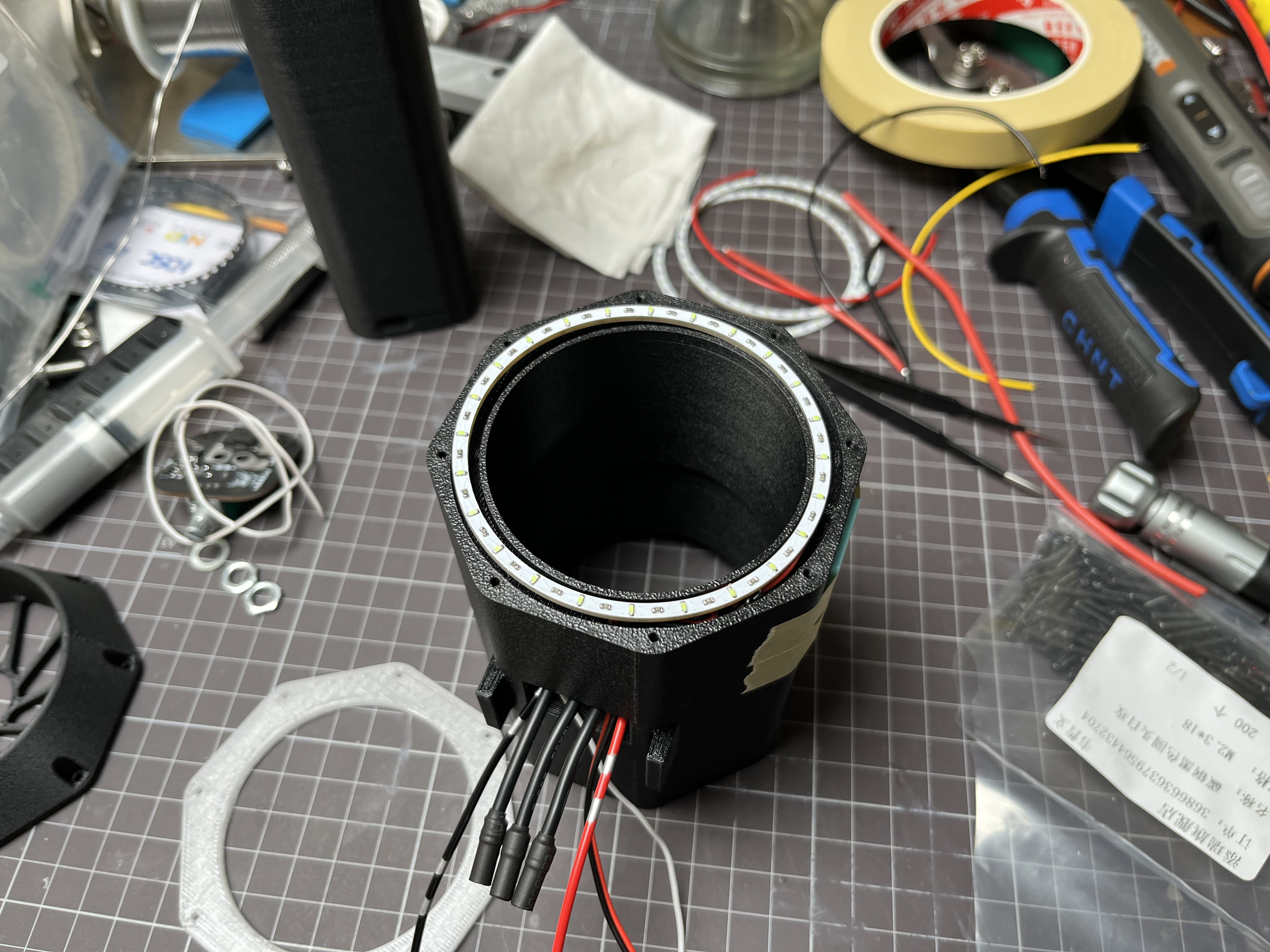

a pre-soldered ESC (LANRC 45A model racing drone single-unit ESC) with
a circular light panel
for illumination.

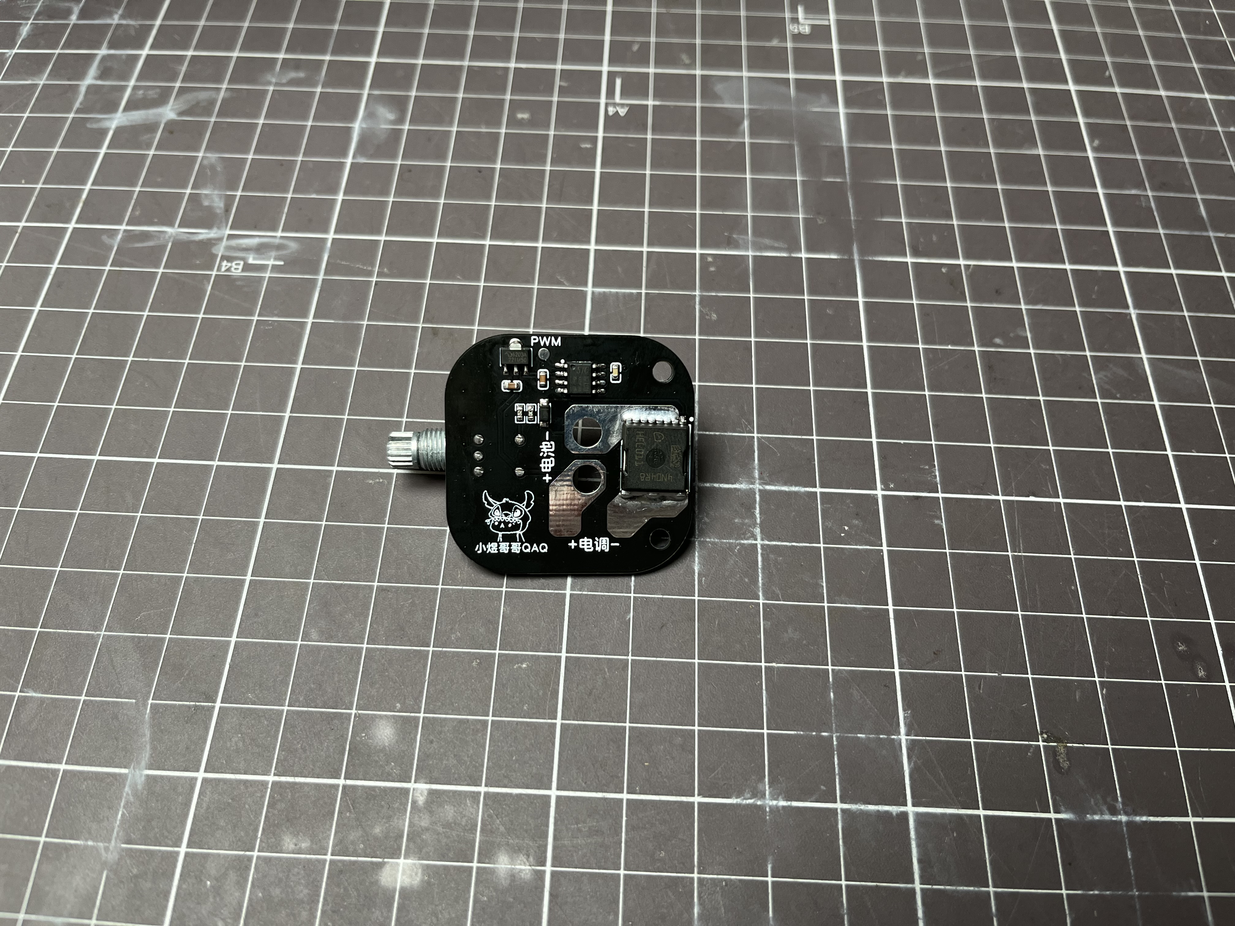

It's a rotary switch integrated brushless ESC PWM signal speed control board,
modified from the 712897A brushless ESC PWM signal generator.
Original project link: https://oshwhub.com/712897a/stc8g1k08a_pwm
Download Options
Note: The IRC frequency must be selected as 12MHz
. There is no automatic reset circuit; after clicking download, the power supply must be disconnected (it is recommended to unplug GND and then reconnect it). Download will only begin after the chip is powered on again.
