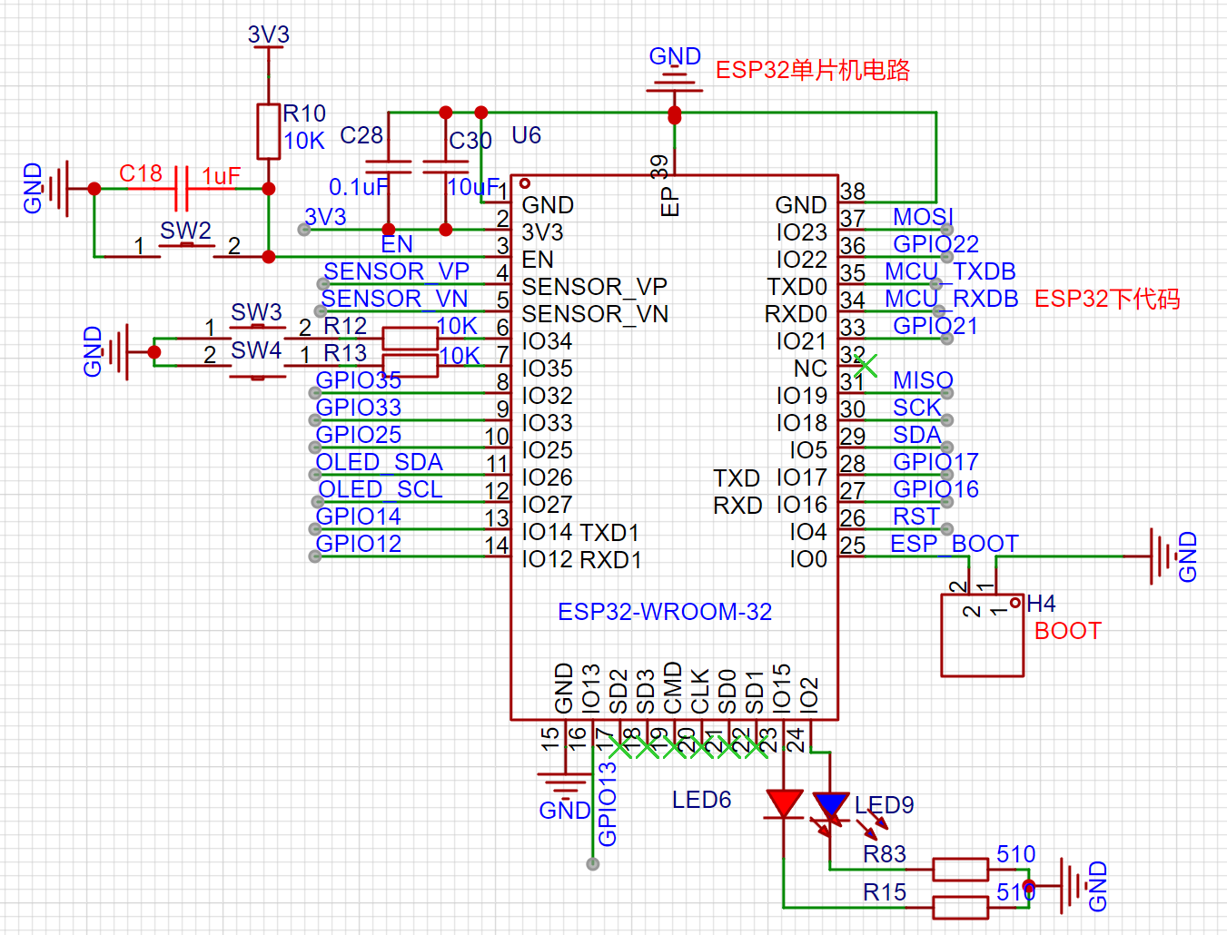

the ESP32 main control circuit
plays a crucial role in the RFID access control ID card design. Specifically, its main functions can be summarized as follows: Core processing and control: As the core processor of the entire system, the ESP32 is responsible for receiving data from the RFID reader, performing necessary processing and analysis, and then controlling the opening and closing status of the access control system based on the processing results. It acts as the "brain" of the access control system, directing the operation of the entire system. Communication bridge: The ESP32 supports multiple communication protocols, such as Wi-Fi and Bluetooth, which allows it to easily exchange data with other devices or systems. In the RFID access control ID card design, the ESP32 can connect to the network via Wi-Fi for remote monitoring and management; simultaneously, it can also communicate with the RFID reader via serial ports, SPI, and other interfaces to ensure accurate data transmission. Data Processing and Storage: The ESP32 boasts powerful data processing capabilities, enabling rapid processing and analysis of data read from RFID cards. Furthermore, it has storage space to store necessary configuration information, user data, etc., for retrieval and verification when needed. Security and Stability: Security and stability are paramount in access control systems. The ESP32 main control circuit ensures the security of data transmission and storage by introducing advanced encryption algorithms and security protocols; simultaneously, its stable hardware design and optimized software algorithms guarantee the stable operation of the access control system.
In summary, the ESP32 main control circuit plays a crucial role in the ESP32 RFID access control ID card design, acting as a core processing and control unit, a communication bridge, data processing and storage, and ensuring security and stability. It is the core and soul of the entire access control system, providing strong support for its intelligence, efficiency, and security.

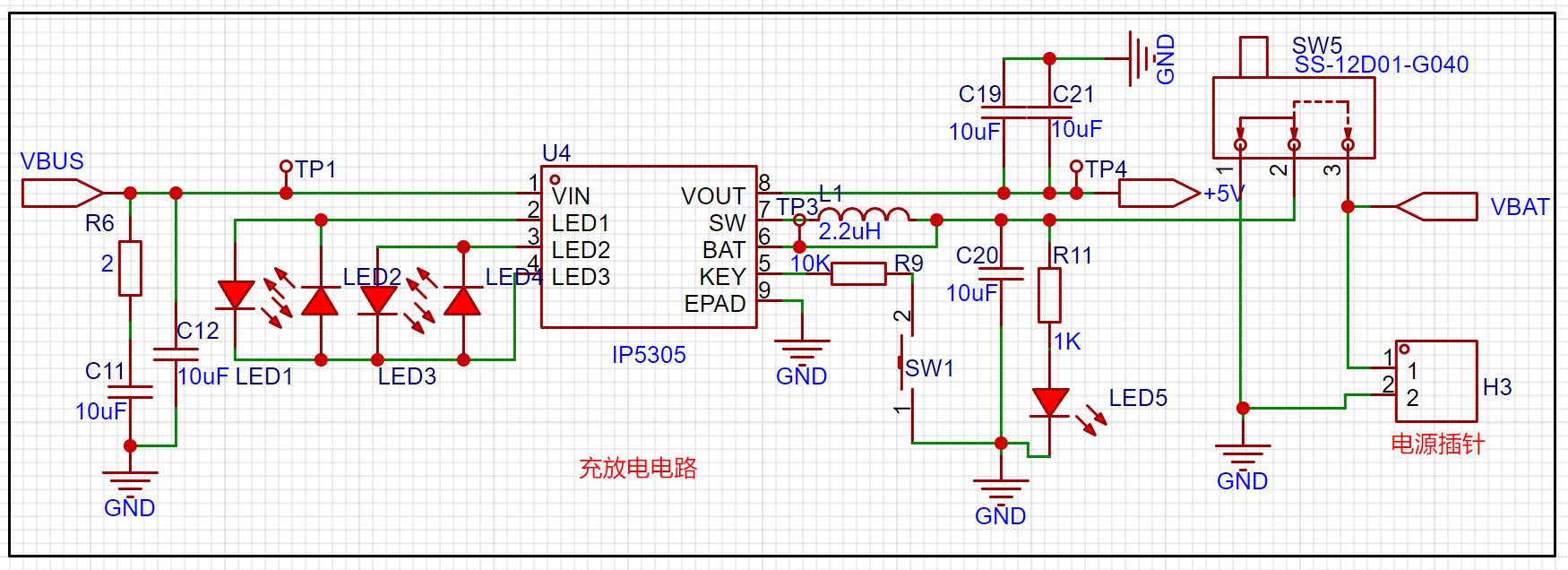

IP5305 Power Bank Power Supply Circuit
: The ESP32 RFID access control ID card design utilizes a power bank-like circuit similar to the IP5305, primarily serving to ensure power supply, manage batteries, and improve system stability.
DC power supply guarantee: The IP5305 power supply circuit provides a stable and reliable power supply for the ESP32 and RFID modules. This is especially important when the access control ID card needs to be in standby mode for extended periods or operate without an external power source. Battery management: The IP5305 may also have battery management functions, such as battery level detection, charging protection, and discharging protection. These functions help ensure safe battery use, extend battery life, and prevent damage to the access control ID card due to overcharging or over-discharging. Improved system stability: A stable power supply is crucial for any electronic device. In RFID access control ID card designs, an unstable power supply may lead to RFID read/write failures, ESP32 processor malfunctions, and other problems. Therefore, the stable power supply of the IP5305 power supply circuit helps improve the stability and reliability of the entire system.

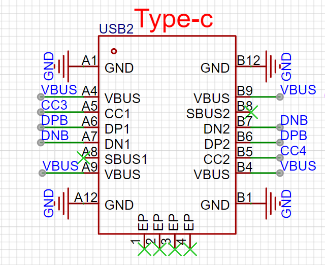

16-pin Type-C circuit:
In ESP32 RFID access control ID card designs, if a 16-pin Type-C circuit is involved, its main functions are likely as follows: Power supply and data transmission: The Type-C interface is a modern connection interface that not only supports convenient reversible insertion but also has powerful data transmission and power supply capabilities. In the ESP32 RFID access control ID card design, the Type-C interface can provide a stable power input for the device and also serve as a data transmission channel, enabling data exchange between the ESP32 and a host computer or other devices. Expansion Functions: Because the Type-C interface has multiple pins, it supports various functional expansions. In RFID access control ID card designs, these pins can be used to connect external devices, such as additional sensors, displays, or other communication modules, thereby expanding the functionality of the access control system. Improved Compatibility: With the widespread adoption of the Type-C interface, more and more devices are starting to use it. Using the Type-C interface in the ESP32 RFID access control ID card design improves the compatibility of the access control system with other devices, facilitating user connection and use. Fast Charging Support: Some Type-C interfaces also support fast charging, meaning that in the ESP32 RFID access control ID card design, if the device has a built-in battery and needs to be charged via the Type-C interface, users can enjoy faster charging speeds, improving device efficiency.

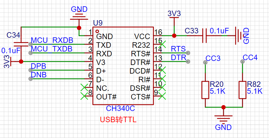

USB to TTL CH340C Circuit :
First, we need to understand the main function of the USB to TTL CH340C circuit. This circuit module primarily converts USB interface signals into TTL level signals for communication with microcontrollers (such as ESP32). Such circuit modules play a crucial role in the design of ESP32-based RFID access control ID cards.
Specifically, the main functions of the USB-to-TTL CH340C circuit in ESP32-based RFID access control ID card designs include: **Communication Bridge:** ESP32 typically needs to communicate with computers or other devices to receive instructions, send data, or perform debugging. While standard interfaces on computers are mostly USB, ESP32's communication interface is a TTL level serial port. The USB-to-TTL CH340C circuit acts as a bridge, converting USB signals from the computer into TTL level signals that the ESP32 can understand, and vice versa. **Debugging Assistance:** During the development of access control ID cards, debugging is frequently required to ensure all functions are working correctly. With the CH340C USB-to-TTL circuit, developers can easily debug the ESP32 via computer using tools such as serial port debugging assistants, monitoring program execution status, and receiving and sending data. Expandability is also crucial; in some applications, access control ID cards may need to communicate with other devices or systems. The CH340C USB-to-TTL circuit provides flexible interface expansion capabilities, allowing connection and data exchange with other devices supporting TTL level communication via serial port. Compatibility and stability are paramount; the CH340C chip, as the core component of this circuit, boasts high compatibility and stability. It supports multiple operating systems and programming environments, enabling developers greater flexibility in development and debugging. Furthermore, its built-in crystal oscillator and robust protection mechanisms ensure accurate data transmission and system stability.
In summary, the USB-to-TTL CH340C circuit plays a crucial role in the RFID access control ID card design of the ESP32. It serves as a key bridge for communication between the computer and the ESP32, and also greatly facilitates the development and debugging of the access control ID card. The

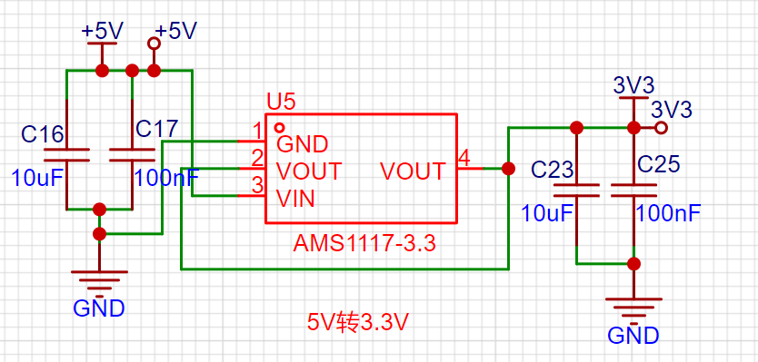

AMS117
is a low-dropout linear regulator (LDO) used to provide a stable voltage output. Its operating principle is shown below:
The AMS117's input is connected to the power supply input, and it can accept relatively high voltages from the power supply, typically between 3V and 12V. This input voltage can have some fluctuation and noise. The AMS117 has an internal reference voltage source (typically 1.2V), which it uses to compare and stabilize the output voltage. This reference voltage source is crucial for ensuring the stability of the output voltage.
Voltage regulator: When the input voltage is stable, the AMS117 controls the output voltage through its internal voltage regulator circuit (typically based on a current source and current mirror design). The output voltage is determined by the AMS117 model number; for example, AMS117-3.3 indicates an output voltage of 3.3V.
Feedback Loop: A voltage divider or resistor network is placed at the output terminal to feed a portion of the output voltage back to the AMS117's feedback pin. The AMS117 regulates its output by comparing the feedback voltage (compared to a 1.2V reference voltage source) with an internal reference voltage.
Stable Output: The AMS117 adjusts its internal current source based on the feedback voltage to maintain a constant output voltage. It can handle changes in input voltage and remains as stable as possible when the output current changes. Protection Functions: The AMS117 typically features thermal shutdown and short-circuit protection to prevent damage from overload or overheating. These protection functions increase its reliability and safety in practical applications. Overall, the AMS117, through its internal feedback mechanism and voltage regulation circuitry, generates a stable, lower output voltage from a higher input voltage for stable operation of electronic devices.

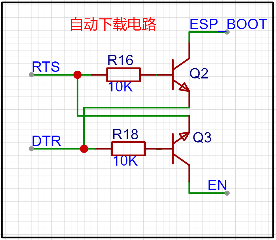

Automatic download circuits,
through specific startup modes (such as download mode) and download tools (such as ESP-IDF, Arduino IDE, etc.), allow developers to easily download compiled code to the ESP32 development board without complex manual settings.
If we understand the "one-click automatic download circuit" as a hardware or software aid used to simplify the code download process during development, its potential role in ESP32 RFID access control ID card design may include: improved development efficiency—by simplifying the code download process, developers can deploy newly written firmware or updated code to the ESP32 development board more quickly, thereby accelerating the development and debugging process of access control ID cards; reduced errors—the automatic download function can reduce errors that may occur during manual setup and configuration, improving the success rate and accuracy of code downloads; and easier integration—in the design and development of access control ID cards, if it is necessary to integrate the ESP32 with other modules or systems, the one-click automatic download circuit can help developers complete integration testing more quickly, verifying whether the communication and collaboration between various modules are normal.
However, it's important to note that these functions primarily apply to the development and debugging phases of the ESP32. In the final product of the access control ID card, these functions are usually integrated into more complex systems and may no longer require a separate download circuit. Furthermore, while the ESP32 supports multiple startup modes and download methods, the "one-click automatic download circuit" is not a standard component of ESP32 or RFID access control ID card design. In practical applications, developers need to choose appropriate download tools and methods based on specific requirements and development environments. In summary, if we understand the "one-click automatic download circuit" as a tool or mechanism used to simplify the code download process during the ESP32 development phase, its potential role in RFID access control ID card design is mainly to improve development efficiency, reduce errors, and facilitate integration. However, in the final product of the access control ID card, these functions may be integrated into more complex systems and may no longer require a separate download circuit. The

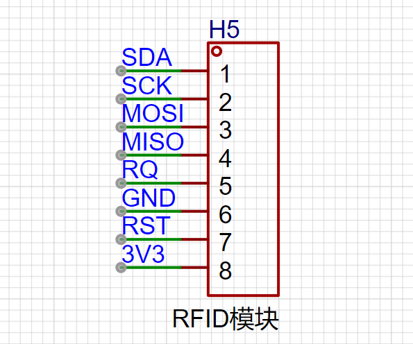

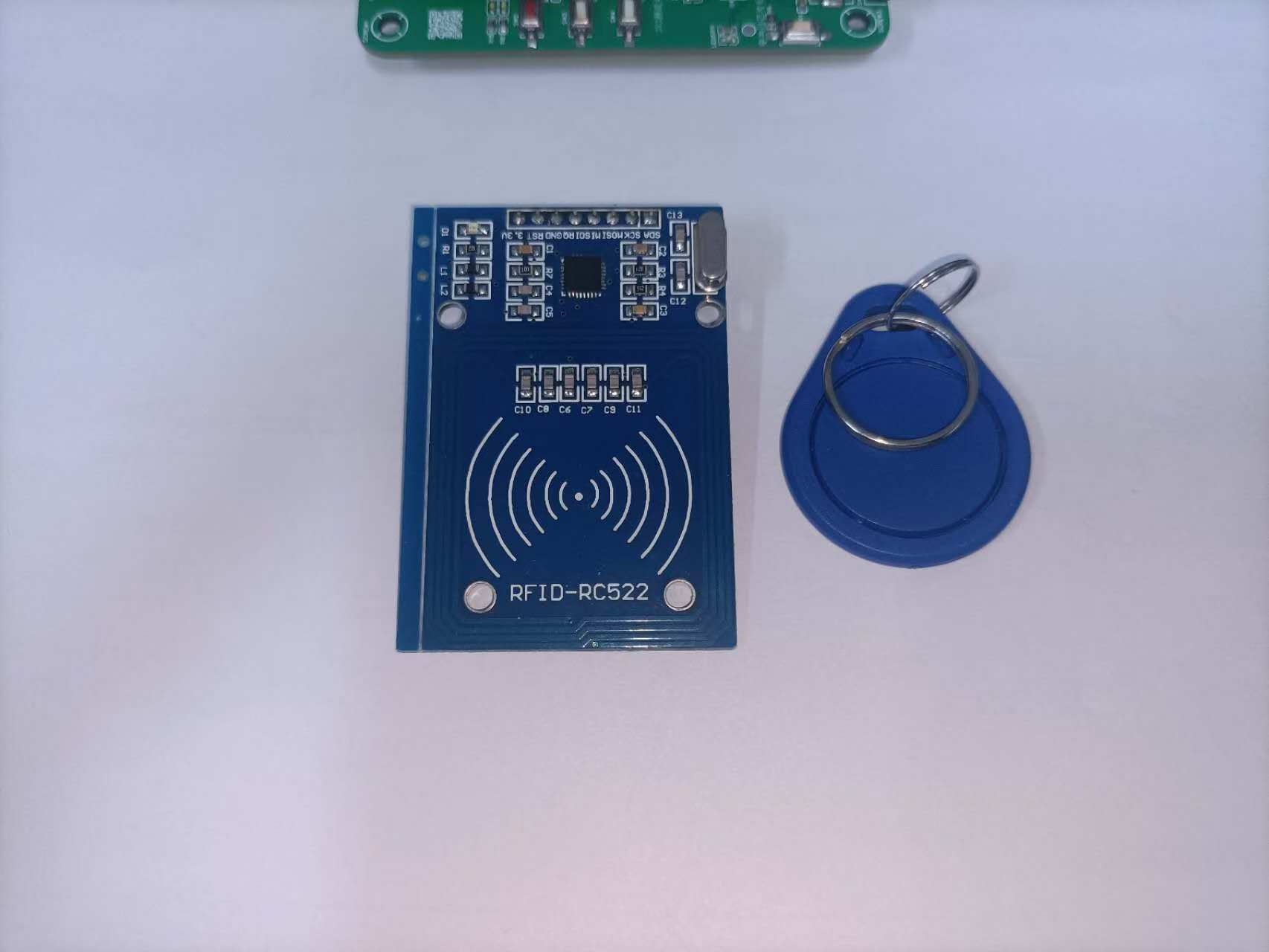

RFID module
plays a crucial role in the ESP32 RFID access control ID card design. The main function of the RFID (Radio Frequency Identification) module is to communicate with RFID tags (also known as RFID cards) via radio waves, thereby enabling control and management of the access control system. The following are the main roles of the RFID module in the ESP32's RFID access control ID card design: Authentication: The RFID module can read the unique identifier (ID) stored within the RFID tag. This ID is crucial for the access control system to identify the user. When a user brings their RFID card close to the RFID reader of the access control system, the RFID module activates the RFID card and reads its ID, then sends this ID to the ESP32 microcontroller for processing. Access Verification: After receiving the ID from the RFID module, the ESP32 microcontroller compares it with a list of legitimate user IDs stored in the system. If a match is found, the user has permission to enter the area, and the ESP32 will further control the electronic lock of the access control system to open; if the match fails, access will be denied, and a warning may be issued via a buzzer or other means. Contactless Identification: A significant advantage of RFID technology is that identification can be performed without establishing mechanical or optical contact. This makes the use of access control systems more convenient and efficient; users only need to bring their RFID card close to the system, eliminating the need for cumbersome operations such as swiping cards or entering passwords. Enhanced Security: RFID access control systems can enhance security through encrypted communication and multi-factor authentication mechanisms. For example, an encrypted communication protocol can be used between the RFID module and the ESP32 microcontroller to ensure that transmitted data is not intercepted or tampered with. Simultaneously, the access control system can be combined with other authentication methods (such as fingerprint recognition, facial recognition, etc.) to improve security. Expanded Functionality: The combination of the RFID module and the ESP32 microcontroller makes the access control system more scalable. For example, the access control system can be connected to a cloud server via the ESP32's Wi-Fi function to achieve remote monitoring and management; sensors and actuators can also be added to further expand the functionality and application scenarios of the access control system.

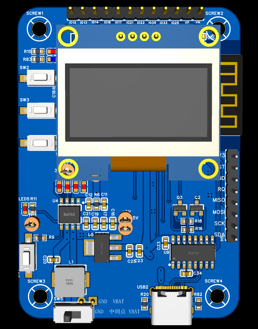

PCB image display,
3D image display,
physical object display
