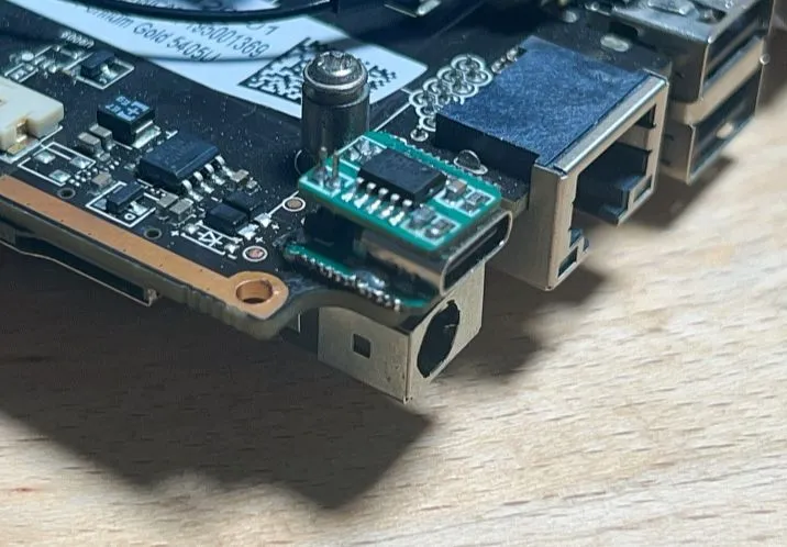

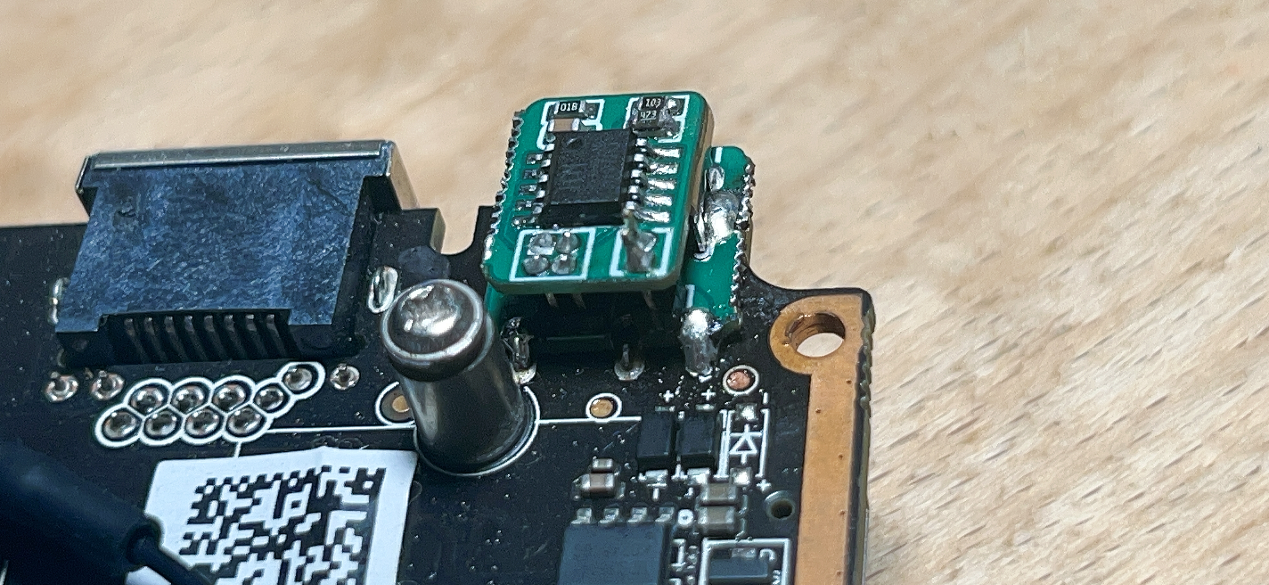

This project is based on the CH224K PD/QC decoy power module. It features non-destructive modification, small size, and compatibility with DC power sockets as shown in the figure.
Note
the use of a stacking method for soldering, employing 1.27 2*2P and 1*2P connections. The soldering technique is important; the bottom pads should be kept as flat as possible. When
prying the board, ensure
it is 1mm thick; thicker boards will be difficult to pry open. Use another board to clamp it from the top and bottom as shown in the figure. Adjust the voltage selection
and the resistance value of resistor R1 in the white solder mask area.
The finished product is shown in the figure.

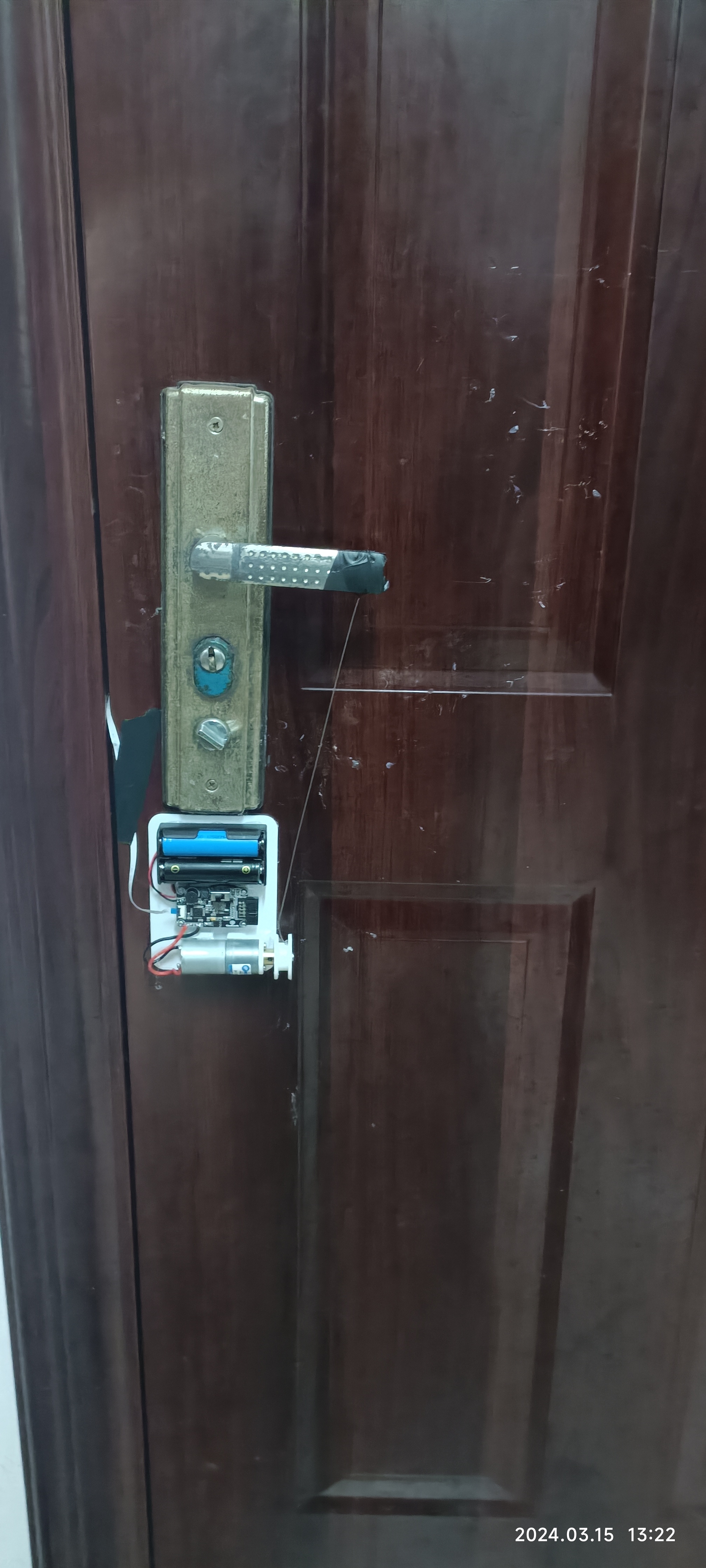

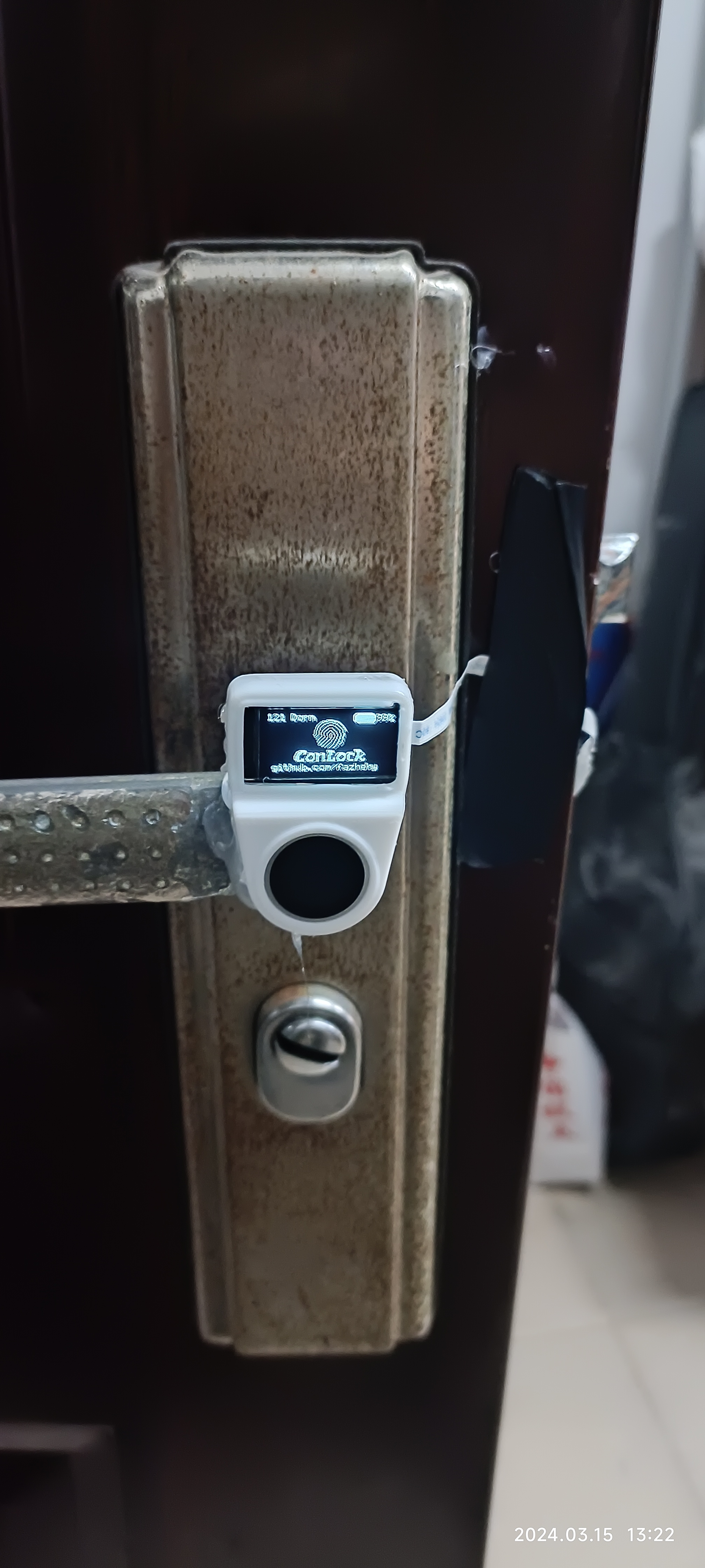

Are you still troubled by frequently forgetting your keys? Are you still often forced to stay under the eaves of the next dormitory room because you forgot your keys? With this project, you can open the door as long as you have your hands, getting rid of those troubles.
The ConLock
DIY dormitory fingerprint lock's overall
structural design
is shown below
. Some structural notes:
The indoor part is attached to the door using 3M adhesive.
The outdoor part is attached to the door handle using hot melt adhesive.
An FPC cable connects the inner and outer boards; the FPC's thinness won't affect opening the door.
Circuit design
PCB layout files and schematic files are included in the project file. Here, I'll only briefly explain some points to note:
Two 18650 chips are used; the +12V in the main board schematic is actually +8V.
The buck circuit uses the MP2315 chip. Yes, that's right. It's the one Professor Sun open-sourced; long live open source!
The motor driver uses the DRV8870, a single-output and inexpensive
chip. The resistor in the secondary board's OLED circuit can be replaced with a 1mΩ resistor.
The TVS on the secondary board is for ESD protection; I don't know if it's actually effective.

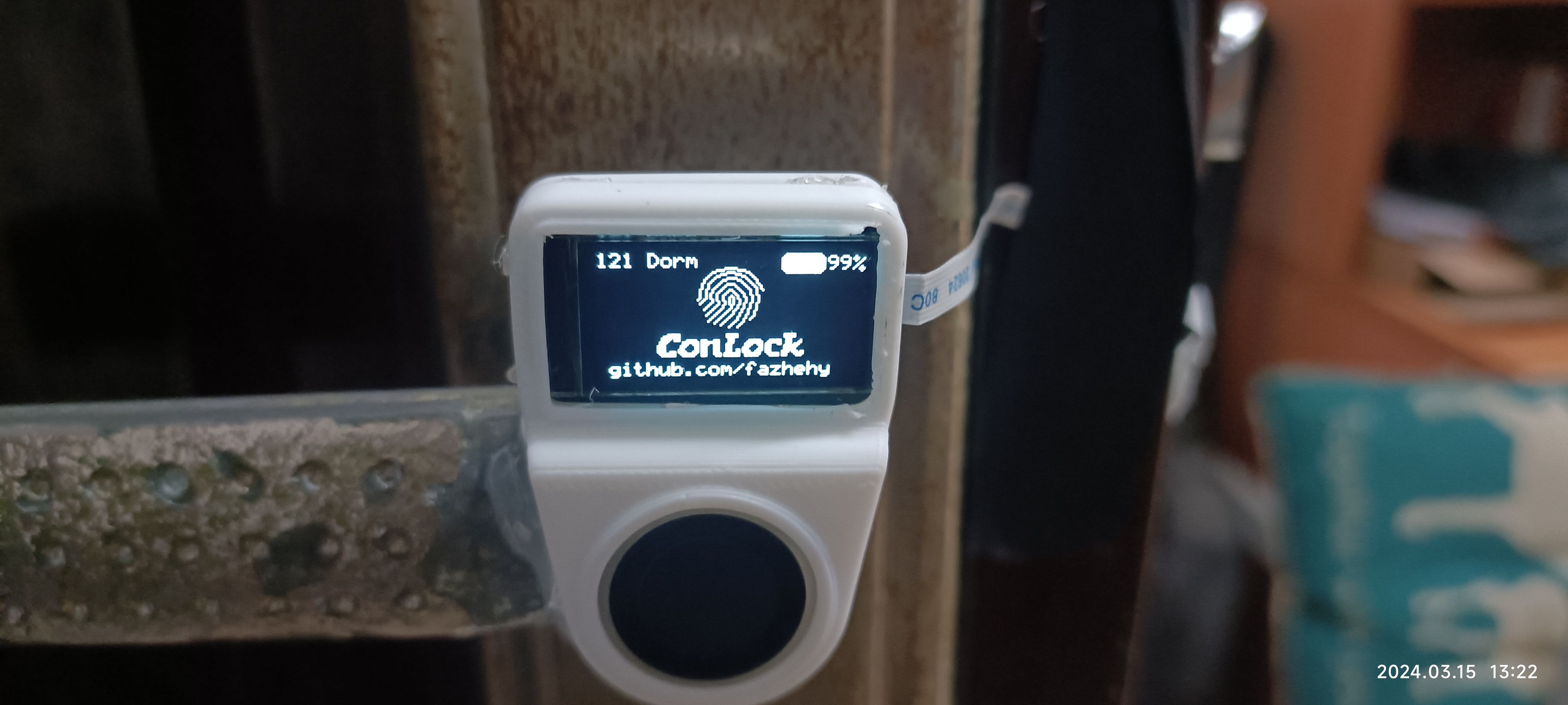

For the software design
, I ported the STM32_OLED open-source library (forgive me for trying to understand those algorithms); the OLED UI was designed using this open-source library. The
UI changes accordingly for successful and failed fingerprint verification, but I won't include images here.
The battery voltage is acquired using an ADC. If the battery voltage drops below 10%, an alarm will sound when the fingerprint is pressed.
The driver library for the FPM383C (fingerprint module) can be implemented according to the documentation.
An administrator is configured; the first and second people to register their fingerprints become the administrator.
The menu UI is based on MorepUI and is very user-friendly; the link is here.
Standby mode is also included.
