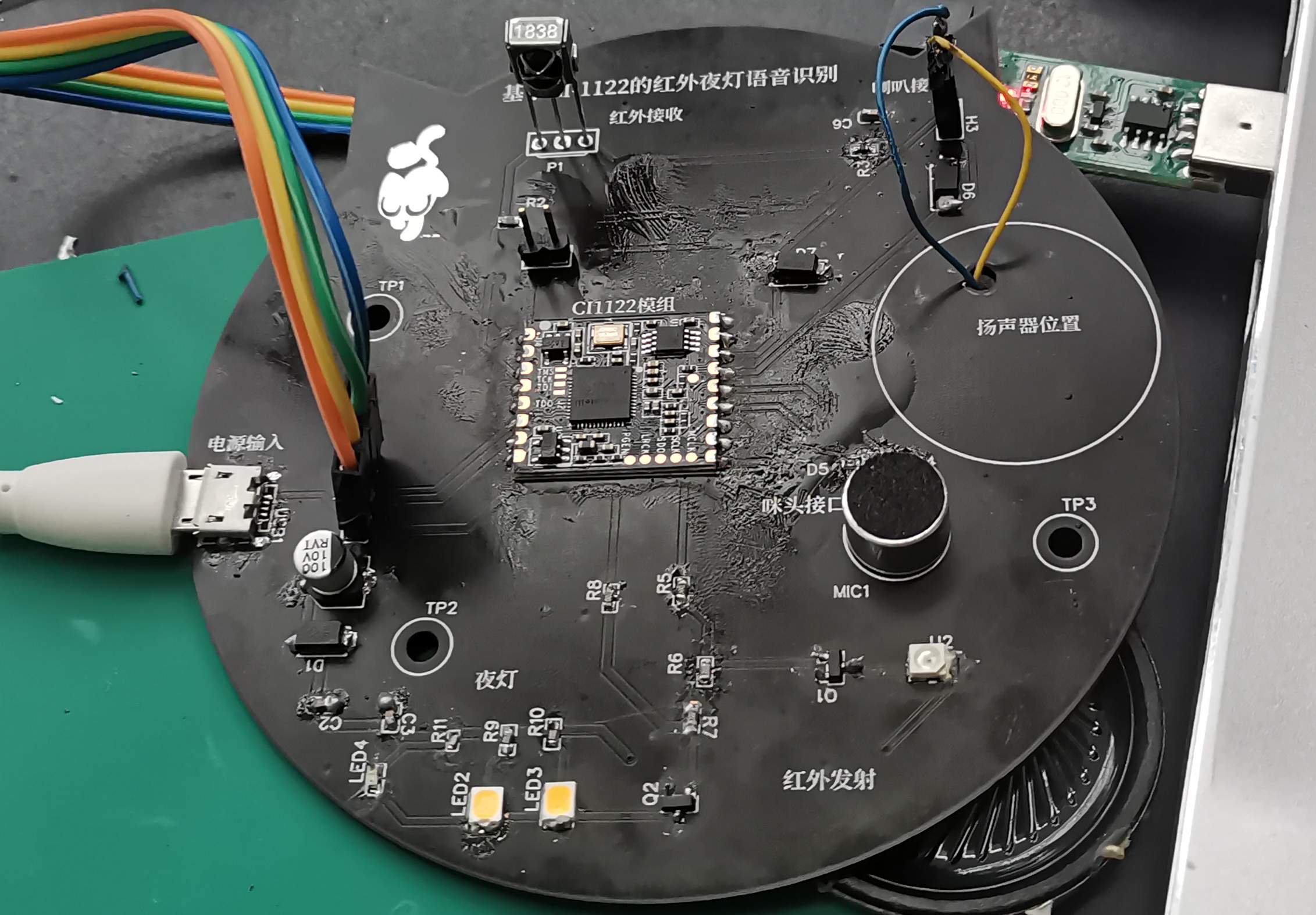

*4. Hardware part
The application circuit is divided into main control chip circuit, power input circuit, night light interface circuit, infrared receiving and transmitting circuit, microphone interface, and speaker interface circuit;
Pay attention to adding protective capacitors and resistors in the 5V voltage network, and use voltage division to make each component work within the appropriate voltage range; pay attention to adding diodes in the microphone and speaker interface circuits to prevent reverse connection.
PCB design pays attention to the placement of components and the integrity of the network. For paths carrying large currents, increase the line width appropriately.

Due to the problem that the firmware cannot be burned, the demonstration cannot be performed temporarily. It will be added after the problem is solved.
