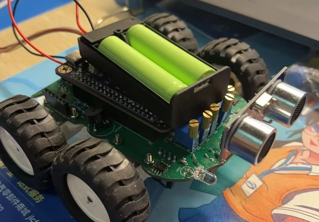

Liangshan School Smart Car
Project Highlights
(1) PCB: The boards used in this project are within 10x10, which can be made for free. Flexible boards are used to connect the battery, which reduces the size of the power supply.
(2) The Liangshanpai Smart Car is equipped with two LED lights in front, one on each side, which can be used to simulate the status of car lights when driving or passing other cars.
(3) The Liangshanpai Smart Car has two independent buttons, namely KEYS and KEYM, which can be used to start and switch between motion modes.
(4) The Liangshanpai Smart Car is equipped with a buzzer, which can be used to sound an alarm when encountering obstacles, and can also use a timer to change its output frequency to play music.
(5) The Liangshanpai Smart Car is equipped with four motor drives and four N20 motors, which can realize PWM output and speed adjustment functions.
(6) The Liangshanpai Smart Car is equipped with five infrared tracking, which can be used to follow the black line, learn the use of comparator circuit, and realize the tracking function.
(7) The Liangshanpai Smart Car is equipped with HCSR04 ultrasonic module interface circuit, which can realize ultrasonic obstacle avoidance function by learning the module principle and the underlying driver code.
(8) The Liangshanpai Smart Car uses the ADC function on the development board to detect the car's battery level, making it convenient for us to charge it in time;
(9) The Liangshanpai Smart Car provides an HC-05 Bluetooth module interface circuit, which can be used with a mobile phone Bluetooth APP to realize the function of wireless remote control of the car;
Car circuit design
1. Power input module;
Two gold fingers are reserved for power supply, which can save space
2. Button indicator: car lights, button module;
3. Buzzer module;
4. ADC voltage acquisition circuit;
5. N20 motor drive circuit;
6. Four-way tracking circuit;
7. HC-SR04 ultrasonic module;
8. HC-05 Bluetooth module;
