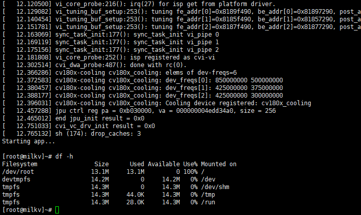

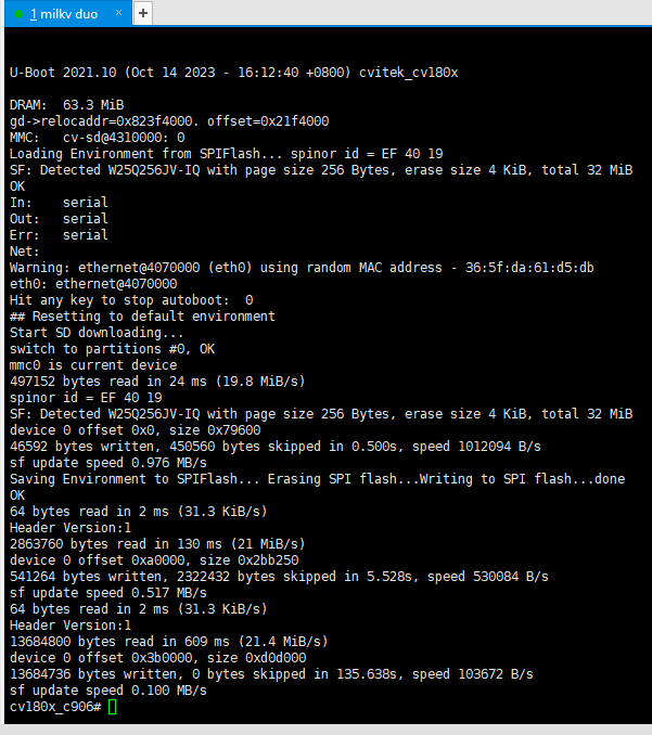

Writing boot, Linux, and rootfs to the NOR FLASH via SD card
shows that it runs normally even without an SD card inserted.

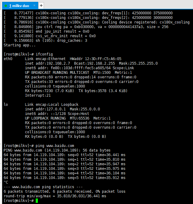

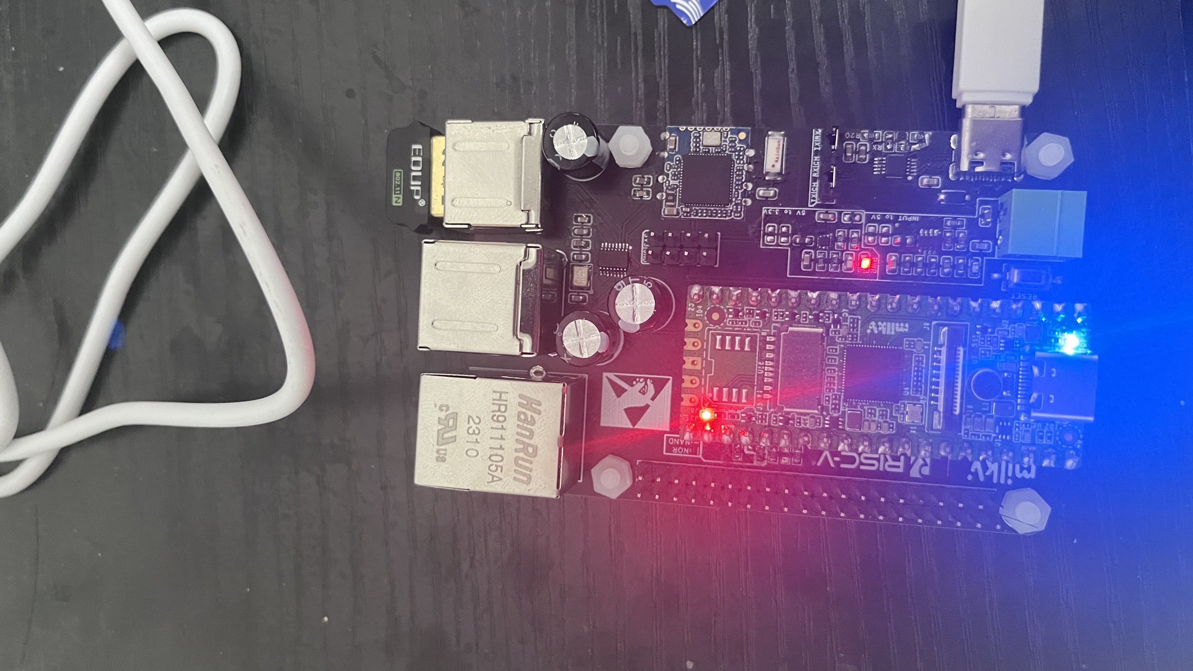

Connecting to the Ethernet
USB hub

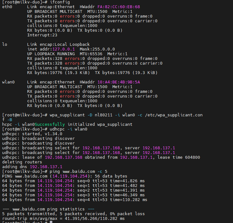

shows that the RTL8723BU is recognized (
Bus 001 Device 004: ID 0bda:b720).
The RTL8723BU uses
Wi-Fi.

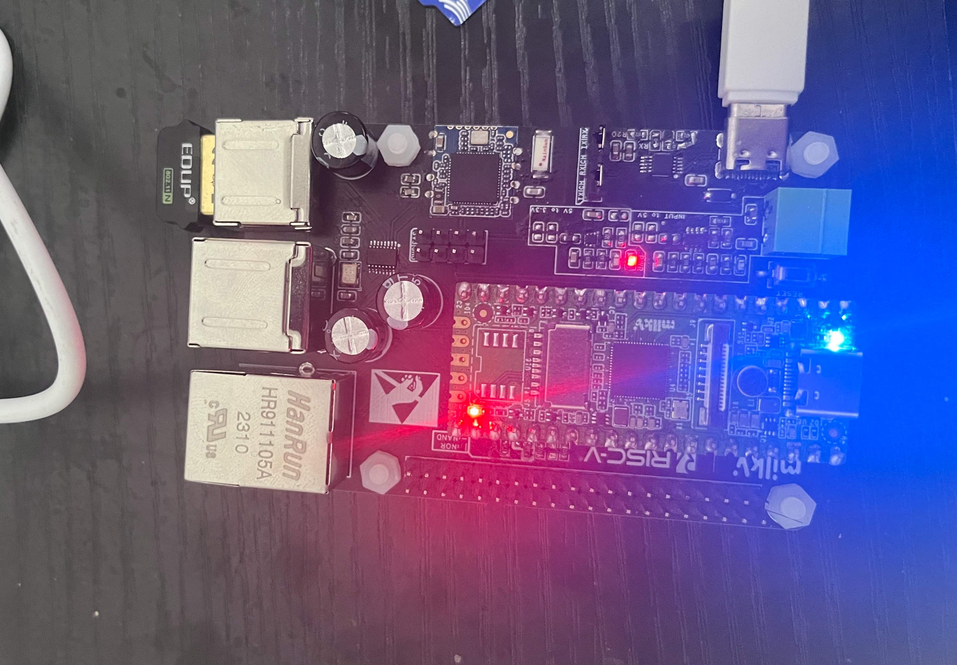

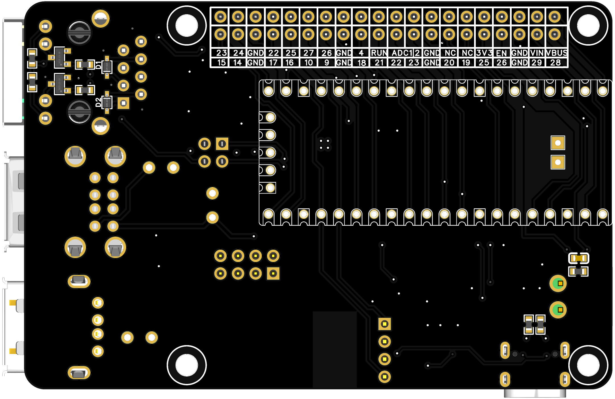

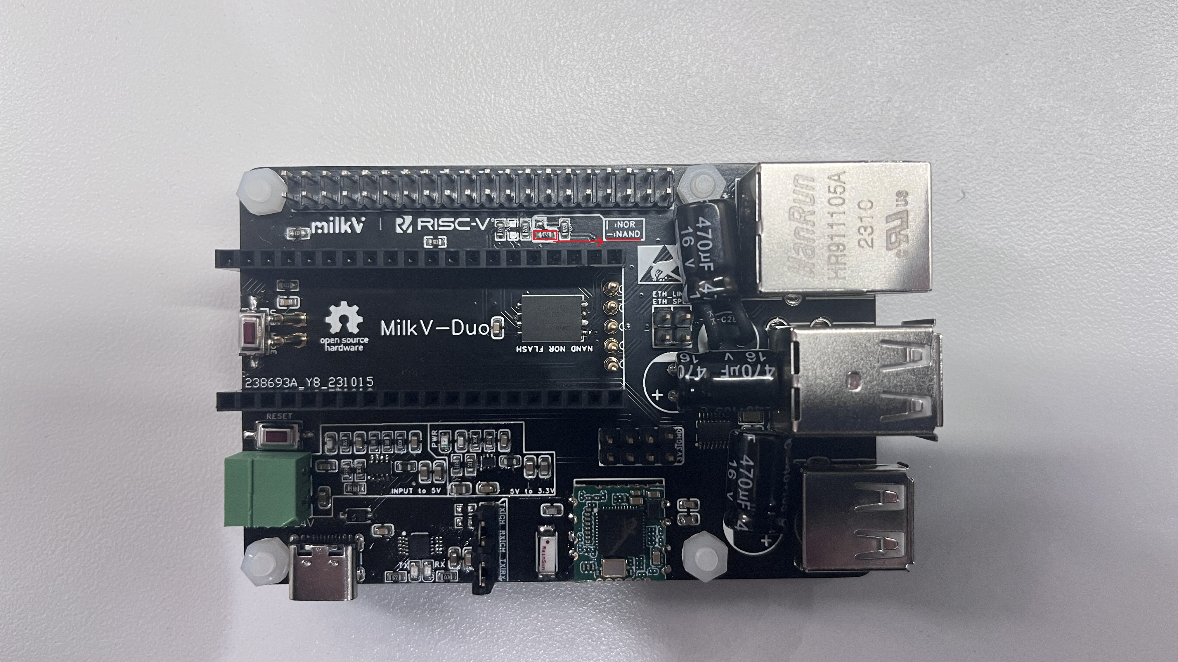

Issues found in the first prototype and improvements in this version:
1.
Q: The 3V3_EN and RUN pins will fail if touched.
A: A default 10KR pull-down resistor has been added; I have personally tested it and touching it again will not affect the board.
2.
Q: ETH cannot communicate when the external network cable is too long.
A: I used pin 4578 of the HR911105A; I don't know if this will improve the situation. Also, the two indicator lights have been brought out and can be disconnected with jumpers.
I have almost completely verified the circuit in the first version and it is correct.

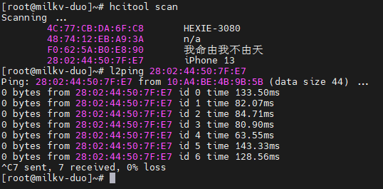

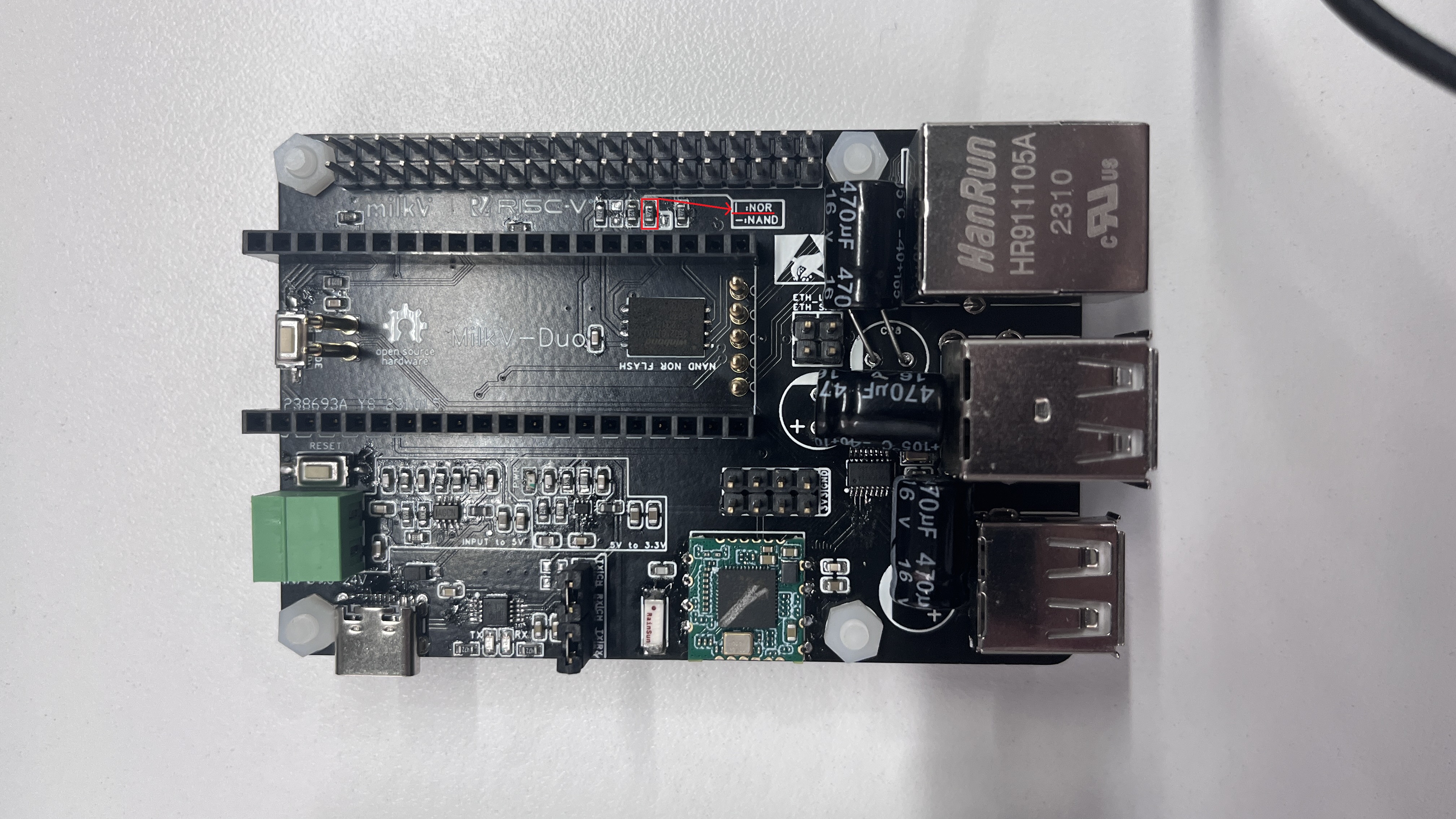

1. The USB hub is recognized after USB setup. Each port has a large-capacity electrolytic capacitor; the official recommendation is 220uF or higher, and a 470uF capacitor is provided for high-current devices.
2. The USB WIFI & BT module uses the inexpensive RTL8726BU, which costs around ten yuan on Taobao. I have tested the drivers, and both WIFI and Bluetooth work normally.
3. Ethernet fails to work over long distances and requires connection to a switch or router, which I suspect is due to an internal PHY driver issue.

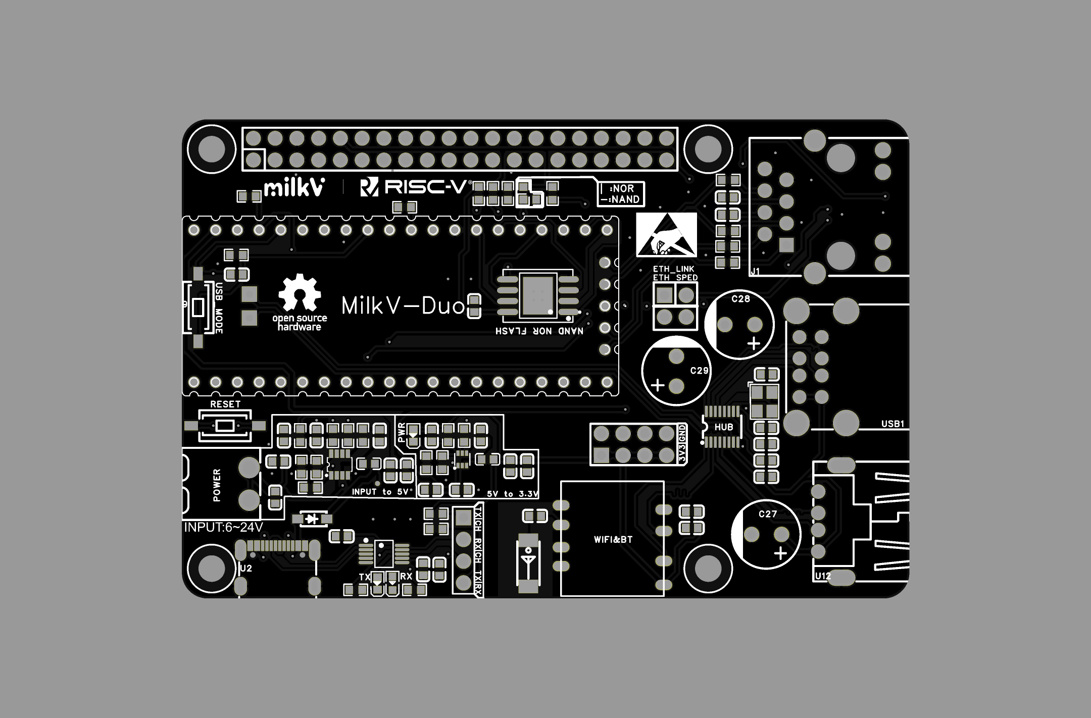

4. Both SPI NOR FLASH (W25Q256JVEIQ) and SPI NAND FLASH (W25N01GVZEIG) have been verified to boot normally.
5. The baseboard design is based on the Raspberry Pi 4B form factor for easy expansion.
6. Power input is a 6-24V wide-range power adapter or a battery box consisting of two 18650 batteries, allowing for long-term standby.
7. The USB ports can be directly connected to the computer to output serial port information. The CH340 printed garbled characters before uboot; adding pull-up resistors may improve the situation, but it's uncertain if it will. The USB-to-serial adapter uses a header jumper cap, allowing it to be disconnected from the MilkV Duo board or connected to any serial port on the MilkV Duo via DuPont wires, or connected to the debug serial port using tools like the CP2102 or FT232.
Additionally, 3.3V and GND headers are brought out for easy connection to other modules for experimentation.
