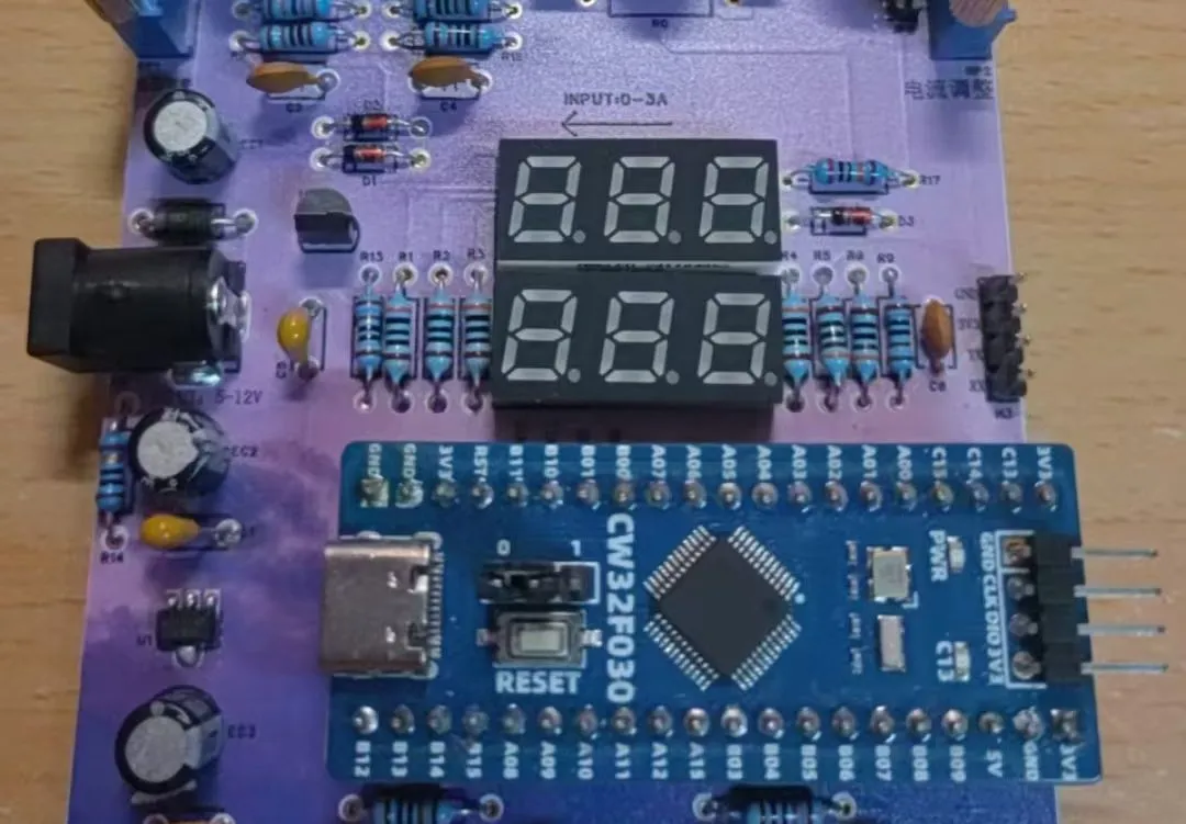

This project uses the CW32F030C8T6 as its core, enabling adjustable voltage and current measurements.
Hardware Design:
1. Power Supply Circuit:

3. Voltage Sampling Circuit Voltage
Divider Resistor Selection
and Design: The maximum value of the measured voltage is 30V for safety reasons (the actual maximum display value can be 99.9V or 100V);
ADC reference voltage is 1.5V in this project, which can be configured through the program;
power consumption, in order to reduce the power consumption of the sampling circuit, the low-side resistor (R7) is usually selected as 10K based on experience;
then the high-side resistance of the voltage divider resistor can be calculated using the above parameters:
Calculate the required voltage division ratio: i.e., ADC reference voltage: Design input voltage, which can be calculated using known parameters as 1.5V/30V=0.05
Calculate the high-side resistance: i.e., low-side resistance/voltage division ratio, which can be calculated using known parameters as 10K/0.05=200K
Select a standard resistor: Select a resistor slightly higher than the calculated value, which is 200K. We usually choose E24 series resistors, so in this project, we choose 220K, which is greater than 200K and closest to it.
If, in actual use, the voltage to be measured is lower than 2/3 of the module's design voltage (66V), the voltage divider resistor can be replaced and the program modified to improve measurement accuracy. The following example illustrates this:
Assuming the measured voltage is no higher than 24V and other parameters remain unchanged,
calculations show 1.5V/24V = 0.0625, 10K/0.0625 = 160K. 160K is a standard E24 resistor and can be directly selected, or a higher value 180K can be chosen with some redundancy.
If, in actual use, the voltage to be measured is higher than the module's 99V design voltage, a different resistor can be selected. To achieve a wider voltage measurement range, you can choose to replace the voltage divider resistor or modify the reference voltage. The following example illustrates this:
Assuming the measured voltage is 160V, we can choose to increase the voltage reference to expand the range.
Given that the voltage division ratio of the selected resistor is 0.0145, we can calculate 160V * 0.0145 = 2.32V using the formula. Therefore, we can choose a 2.5V voltage reference to increase the range (increasing the range will reduce accuracy).
Considering the potential fluctuations in the measured power supply, a 10nF filter capacitor is connected in parallel with the low-side voltage divider resistor in the circuit design to improve measurement stability.
4. Current Sampling Circuit
The sampling current designed for this project is 3A, and the selected sampling resistor (R0) is 100mΩ.
The selection of the sampling resistor mainly needs to consider the following aspects:
the maximum value of the pre-designed measurement current; in this project,
the voltage difference caused by the 3A current sensing resistor is generally not recommended to exceed 0.5V
; the power consumption of the current sensing resistor should be selected based on this parameter. Considering the power consumption (temperature) issue under high current, a 1W packaged metal wire-wound resistor was selected.
The voltage amplification factor across the current sensing resistor: No operational amplifier was used to build the amplification circuit in this project, so the factor is 1.
The current sensing resistor value can then be calculated using the above parameters
. The project does not use an amplifier circuit, therefore a larger sampling resistor is needed to obtain a higher measured voltage for measurement.
Considering that a larger resistor will result in a larger voltage drop and higher power consumption, a larger resistor cannot be selected indiscriminately.
This project uses a 1W package resistor, corresponding to a temperature rise power of 1W.
Based on the above data, a 100mΩ current sensing resistor was selected. According to the formula, 3A * 100mΩ = 300mV, 900mW can be calculated.
To cope with different usage environments, especially high current scenarios, the R0 resistor can be replaced with constantan wire or a shunt. The replacement can be selected according to the actual usage scenario. For safety and educational purposes, this project will not discuss the range exceeding 3A in detail, but the principle is the same.
5. Digital Tube Display Circuit
This project uses two 0.28-inch three-digit common cathode digital tubes as display devices. Compared with a display screen, digital tubes have better recognition in complex environments. According to the actual usage environment requirements, smaller current limiting resistors can be used to achieve higher digital tube brightness. On the other hand, digital tubes have better mechanical properties and are not as easily damaged by external forces as display screens. In industrial applications requiring stability and reliability, this technology is widely adopted. From a development learning perspective, it facilitates more targeted learning of electronic measurement principles and related development.
In this project, after actual testing, the current-limiting resistors (R1~R6) of the digital tube were configured to 300Ω. The corresponding brightness, whether for red or blue digital tubes, exhibited good visibility and a soft, non-glaring brightness.

8. Schematic and PCB Design Considerations:
Pads and Reinforcement.
In PCB design, I often use elongated oval pads for through-hole components to increase the contact area between the solder, soldering iron, and the pad, making soldering easier. Meanwhile, a silkscreen layer is designed as a separator between closely spaced pads. On actual circuit boards, the raised silkscreen layer significantly reduces solder bridging during soldering. This method is widely used in product design to improve production yield.
Figure 27
Solid filler is used to reinforce pads and some traces, preventing scratches and damage to the circuit board and pad detachment during use. In fact, given the excellent quality of JLCPCB PCB materials, this design is unnecessary in double-layer board designs; the author's initial intention was primarily to demonstrate and broaden the user's perspective. Teardrop
tools can be used for reinforcement in double-layer board designs.
The Kelvin connection method for current sampling resistors
Figure 28
eliminates the influence of line resistance and contact resistance on measurement results. In high-precision sampling applications, dedicated four-wire sampling resistors are also available, but this will not be discussed here.
