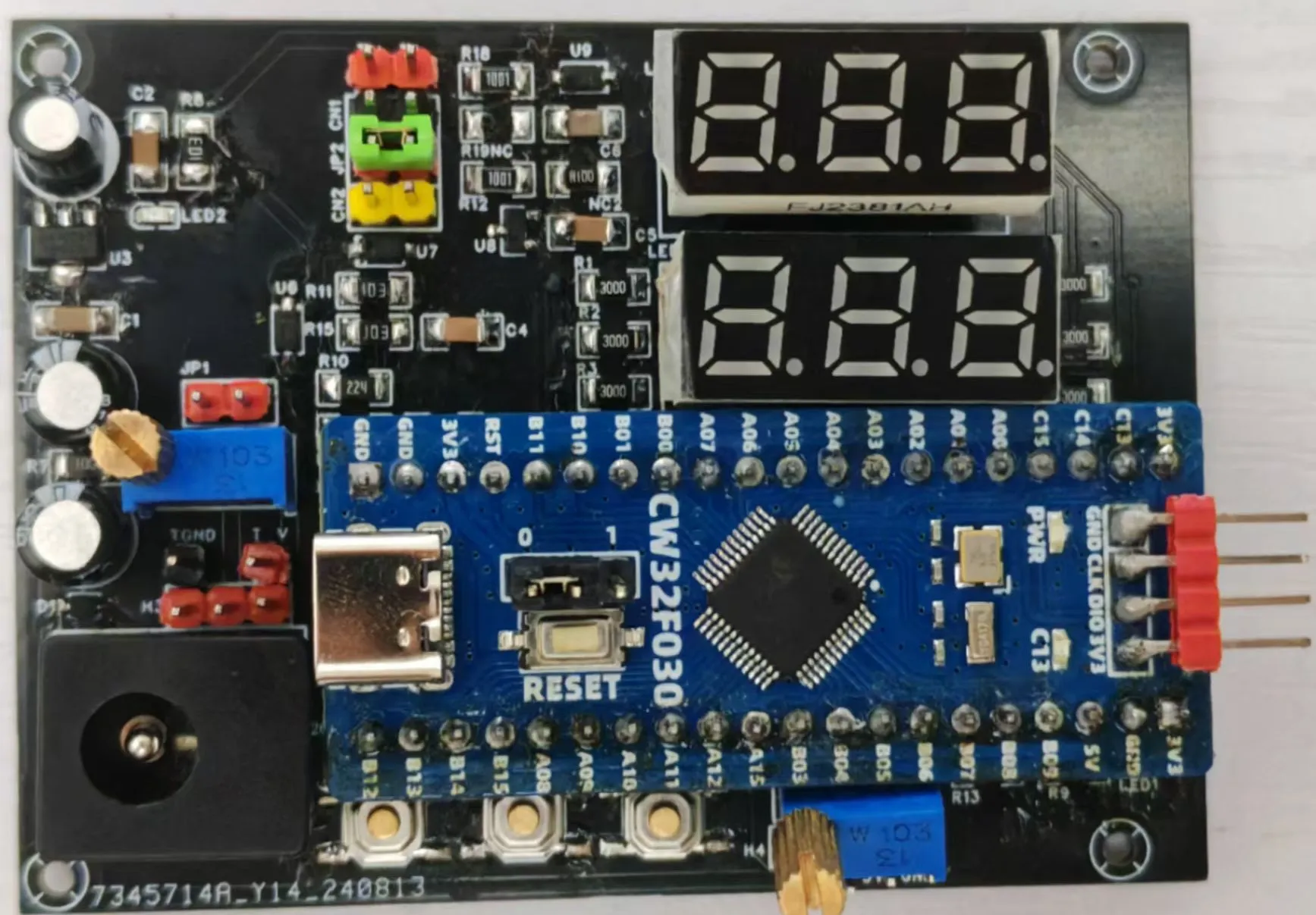

Voltage and current meter based on CW32F030
This design utilizes a CW32F030-based voltmeter and ammeter to measure voltage and current, and provides voltage calibration. The hardware design employs the JLCPCB EDA Professional Edition.

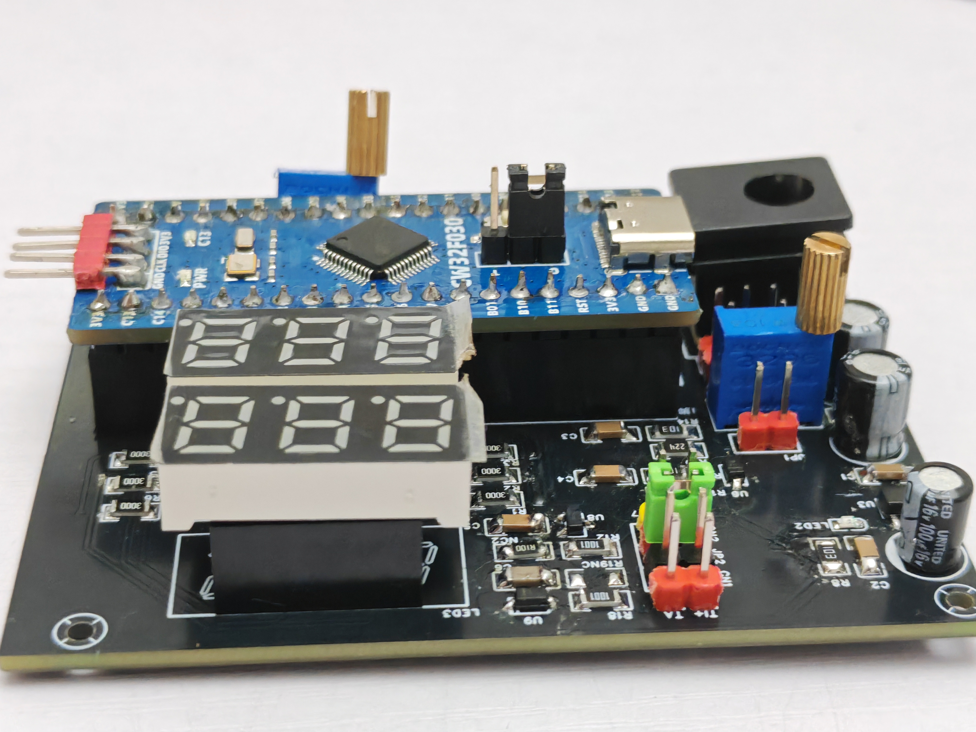

is my first time doing hardware design, so the PCB layout is not very efficient and it's not very convenient to use.
Photos of the finished product are below;
firmware and a demonstration video are attached below.
