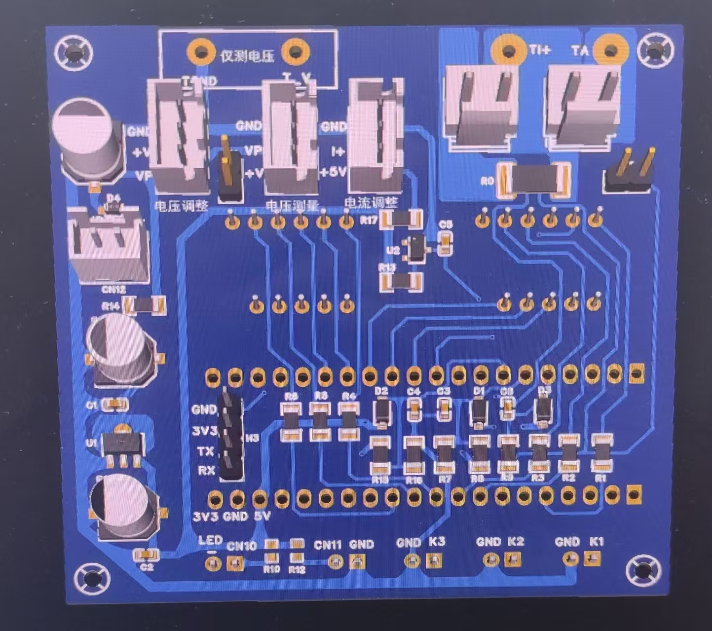

Circuit Design: To minimize the size of the main voltmeter, surface-mount components were used in the circuit board design.

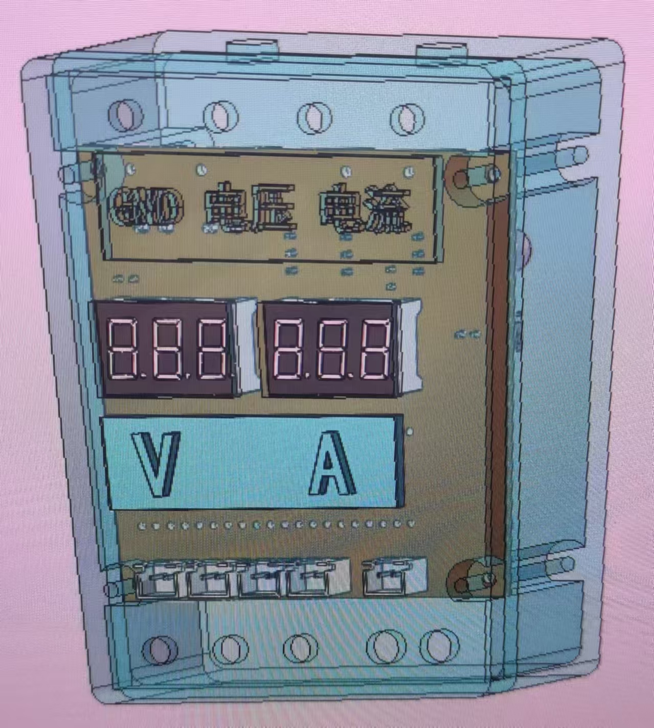

Case Design: The case was designed using SOLIDWORKS software. After assembly and verification, the model was exported as an STL file and printed using a 3D printer.

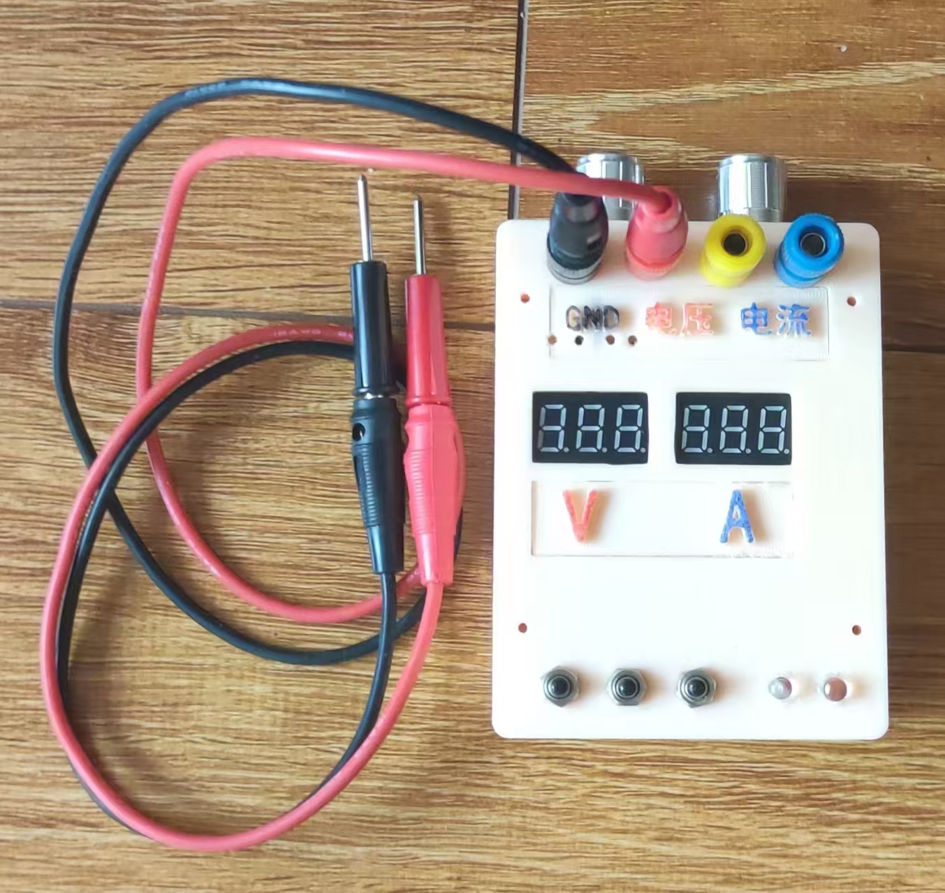

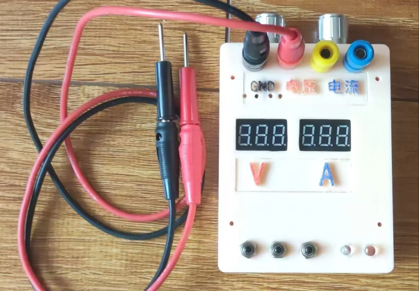

Finished Product Showcase:

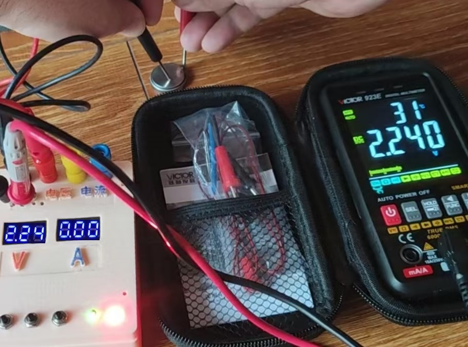

Product Testing: Voltage measurement was demonstrated using a 3V button battery.
