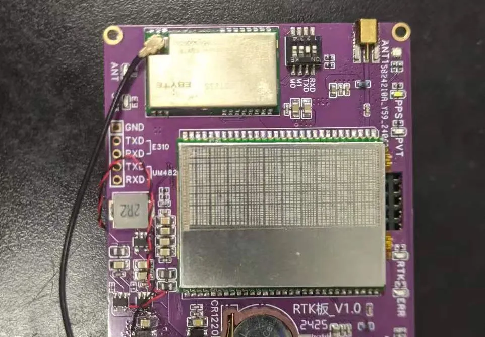

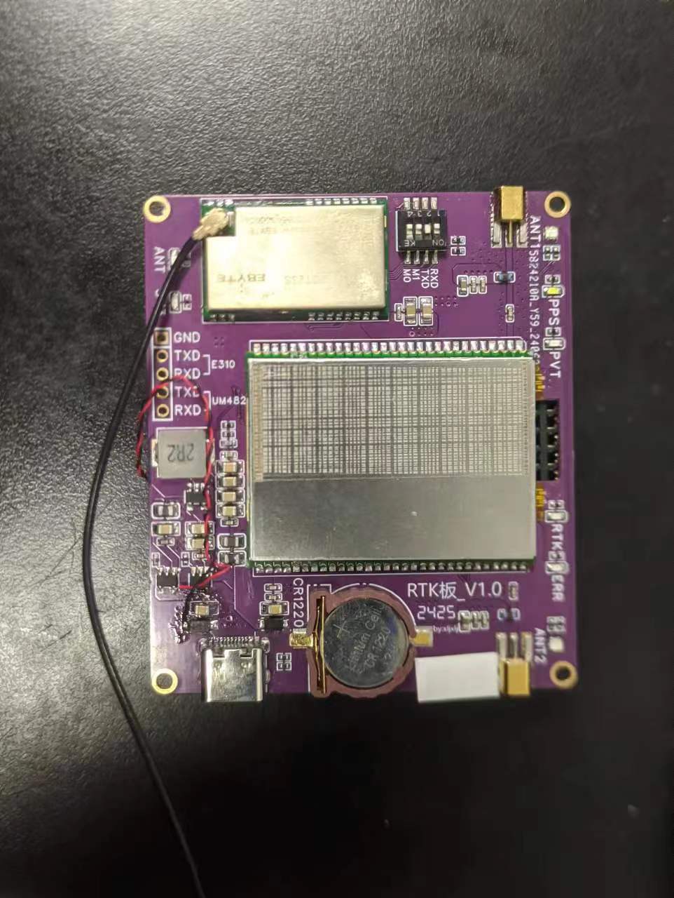

RTK module based on UM482 module
The board I used in the 19th National Undergraduate Intelligent Vehicle Competition
is intended for commercial use. The final selling price should be below 80 RMB (including the entire board with the LORA and UM482 modules). Otherwise, commercial use is prohibited
. Unauthorized reproduction is prohibited, and any reproduction must credit the author and source.
It uses a disassembled UM482 module (retail price on Xianyu is around 50 RMB). The LORA module sample price is below 10 RMB (limited to two per purchase).
It includes a 5V antenna power supply with short-circuit protection. Tested on a disassembled DJI agricultural drone RTK antenna (approximately 25 RMB each on Xianyu). It needs to be disassembled and its connecting wires replaced with MMCX-MMCX connecting wires.
Rough impedance is calculated. The board thickness is 1.0mm.
Due to the short-circuit protection chip and the limited number of MLCCs, the ripple is somewhat large, but it is usable, so I won't modify it.
The structure is a stacked structure; this is one layer of the stack, so wiring may be inconvenient, and I won't modify it.
Attached are collected UM482 data and documents.

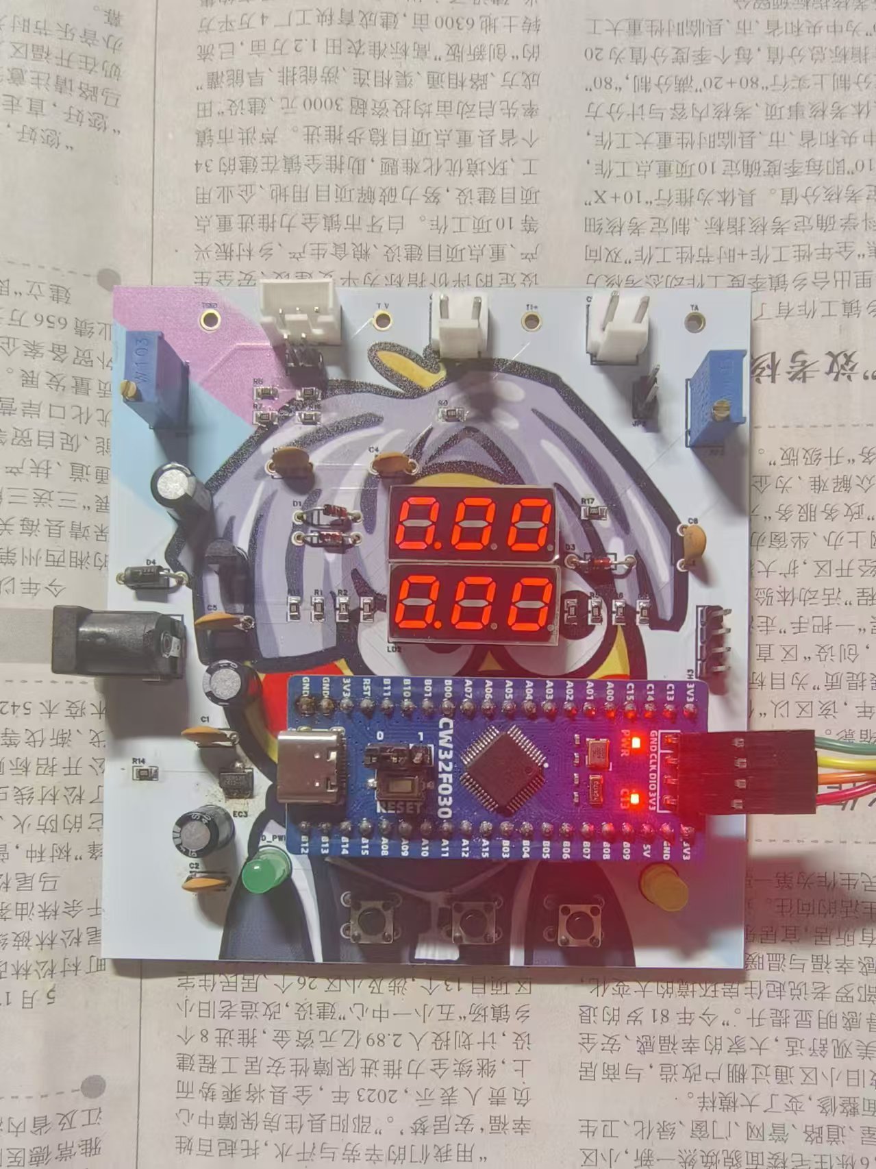

When buying resistors based on the CW32F030C8 voltmeter and ammeter, pay attention to the package. If you buy the wrong package for the current-limiting resistor, you'll have to use jumper wires. The maximum voltage measurement is 30V, and the maximum current measurement is 3A.
I. Design Background
An ADC (Analog-to-Digital Converter) is an indispensable key component in electronic systems. It converts continuous analog signals into digital signals, enabling digital processing and analysis. ADCs play a crucial role in signal conversion, measurement and data acquisition, control system input, and communication and signal processing. Their widespread application promotes the intelligent and precise control of electronic equipment across various industries, and is one of the key factors driving modern technological progress. Digital voltmeters and ammeters combine ADC technology with circuit measurement principles, accurately converting analog voltage and current signals into digital displays for easy reading and analysis by electronic engineers. This device not only improves the accuracy and efficiency of circuit measurements but also helps engineers better understand circuit behavior, serving as a powerful assistant in electronic design and troubleshooting, and playing a vital supporting role in the work of electronic engineers. In product applications, digital voltmeters ensure the accuracy and safety of circuit design, while also providing strong support for product quality control and subsequent maintenance. Learning to design and build a digital voltmeter and ammeter
using a benchtop digital multimeter (Agilent 34401A)
is highly beneficial for improving one's professional skills. This digital voltmeter and ammeter project covers multiple aspects, including microcontroller circuit design and implementation, signal acquisition and processing circuit design, user interface development and optimization, and product appearance design. It integrates knowledge from multiple fields such as electronics, microcontroller programming, circuit design, and industrial design. Considering the learning pace and knowledge absorption capacity of beginners, we have specially launched this introductory-level digital voltmeter and ammeter project, which is very suitable for beginners in electronics and those who want to learn more about microcontroller applications. This project has the following highlights:
it adopts a core board plus expansion board design concept and uses plug-in components, making learning simpler and exploration more in-depth;
the core board uses the domestic Wuhan Xinyuan Semiconductor CW32 as the main controller, while also being compatible with other similar development boards; however, the CW32 has advantages.
The project is highly comprehensive and practical, and after completion, it can be used as a desktop instrument;
the project has abundant learning materials, including circuit design tutorials, PCB design, code programming learning, and training for engineers' debugging skills.

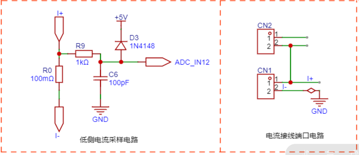

4. Current Sampling Circuit
This project uses a low-side current sampling circuit for current detection. When learning the common ground between the low-side of the sampling circuit and the development board's meter interface, please do not solder R0!!!
The design analysis
for this project involves a sampling current of 3A, and the selected sampling resistor (R0) is 100mΩ. The selection of the sampling resistor mainly needs to consider the following aspects:
the maximum value of the pre-designed measurement current;
the voltage difference caused by the 3A current sensing resistor in this project; and
the power dissipation of the current sensing resistor, which should generally not exceed 0.5V. A suitable package should be selected based on this parameter. Considering the power dissipation (temperature) issue under high current, a 1W metal wire-wound resistor package was chosen
. The voltage amplification factor across the current sensing resistor is also important. Since no operational amplifier is used to build the amplification circuit in this project, the factor is 1.
The current sensing resistor value can then be calculated using the above parameters
. Since no amplifier circuit is used, a larger sampling resistor is needed to obtain a higher measured voltage for measurement.
Considering that a larger resistor would result in a larger voltage drop and higher power consumption, an unlimited selection of a larger resistor is not feasible.
This project uses a 1W package resistor, corresponding to a power consumption of 1W.
Based on the above data, a 100mΩ current sensing resistor was selected. According to the formula, 3A * 100mΩ = 300mV, 900mW can be calculated.
To cope with different operating environments, especially high-current scenarios, the R0 resistor can be replaced with constantan wire or a shunt. The replacement can be selected according to the actual application scenario. For safety and educational purposes, this project will not discuss measurements exceeding 3A in detail, but the principle is the same.

A physical image is shown below.
II. Project Functionality
Supports 0-30V voltage ADC measurement with a display accuracy of 0.1V/0.01V; supports 0-3V precise ADC measurement with a display accuracy of 0.01V;
supports 0-3A current ADC measurement with a display accuracy of 0.01A;
can detect the voltage and current values ​​of the tested circuit in real time ;
can simultaneously detect the voltage and current values ​​of the tested circuit.
III. Hardware Design (Partial)

3. Current Sampling Circuit:
This project uses a low-side current sampling circuit for current detection. The low-side of the sampling circuit shares a common ground with the development board's meter interface. In the current wiring port circuit on the right side of the image, CN2 pins 1 and 2 are connected to TA and TI+ respectively (not shown on the schematic, but present on the PCB).
