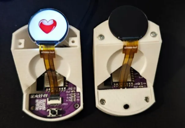

This open-source project is a pair of thinkers that communicate with each other via a private server using the MQTT protocol. When a button is pressed on thinker A, thinker A displays the accumulated count and sends it to the server, which then forwards it to thinker B. Thinker B sends messages in the same way.

: When a button is pressed on thinker A, thinker A displays the accumulated count and sends it to the server, which then forwards it to thinker B. Thinker B sends messages in the same way.

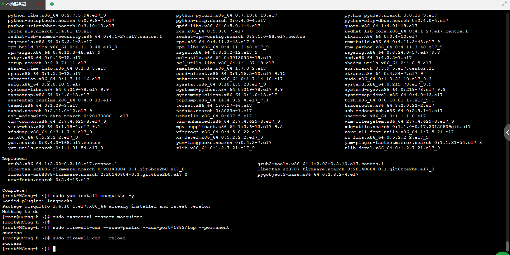

Server MQTT deployment completed.

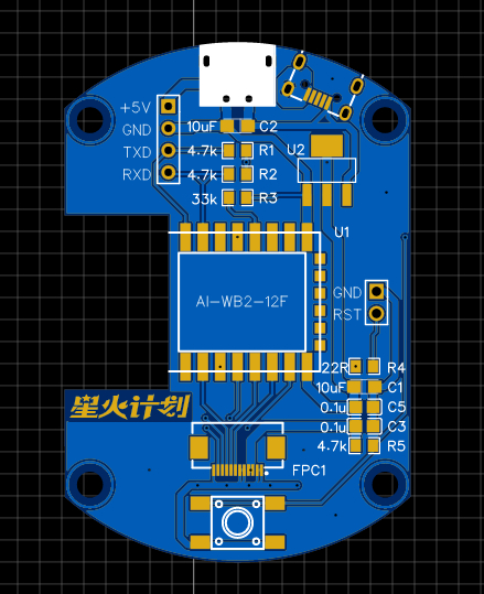

PCB design completed.

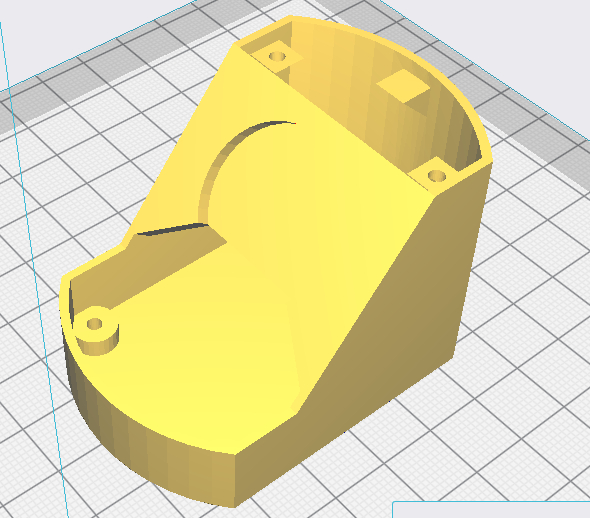

Shell design completed.
