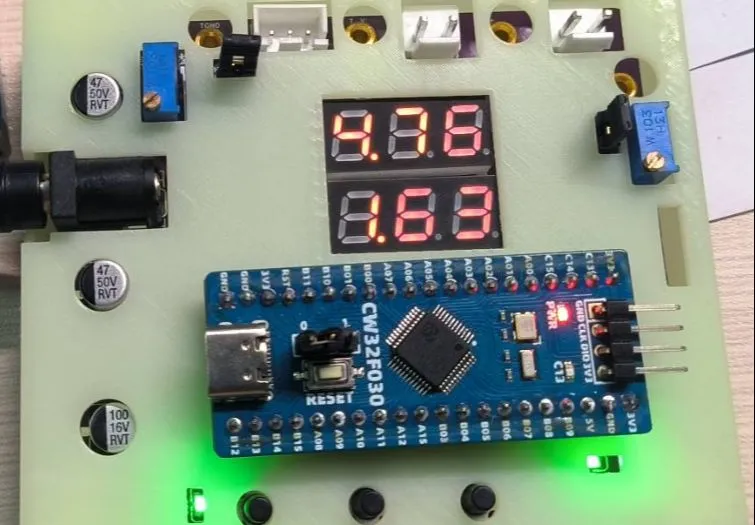

This project uses a CW32F030 voltmeter and ammeter, which has the functions of detecting voltage and current and voltage and current calibration. It replaces the 1206 surface mount resistors.
Project Functionality
Two 0.28-inch common cathode digital tubes are used to display voltage and current respectively. It has a 5 to 12V DC power supply, a 0-30V voltage acquisition range, and a 0-3A current acquisition range. Three buttons are located on the bottom of the development board: the first button is used to start calibration and select calibration parameters, the second button is used to confirm the calibration parameters, and the last button returns to the main display function.

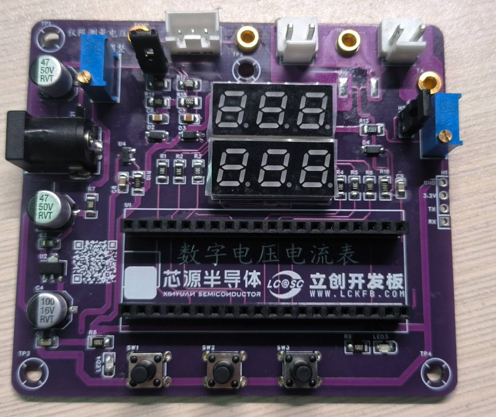

The components labeled T_V and T_GND are the 2mm banana plug interfaces on the development board, used to connect the multimeter probes. The probes of a multimeter or a high-precision benchtop digital multimeter can be inserted to verify the accuracy of the development board's measurements. A 2mm banana-tip multimeter probe can also be inserted to replace the CH1 port for handheld measurements.
The VP pin is the development board's power supply pin and should not be connected when using the DC port. When not using the DC port for power supply and the measured value is greater than 5V but less than 30V, the power supply under test can be connected, or it can be powered independently.
Considering that users may not be able to easily build peripheral circuits for testing and debugging when learning the corresponding circuit measurement principles, and adhering to the principle of ease of development of the development board, auxiliary circuits for simulating voltage measurement, measurement calibration, and measurement calibration are specifically provided. No external voltage is required for CH1. Use the multi-turn adjustable potentiometer (RP1) to divide the development board's power supply voltage and connect it to the +V network through the development board's internal circuitry. Note that H2 needs to be shorted at this time; a jumper cap is sufficient, and a long-handled jumper cap is recommended. Do not short H2 if this function is not used.

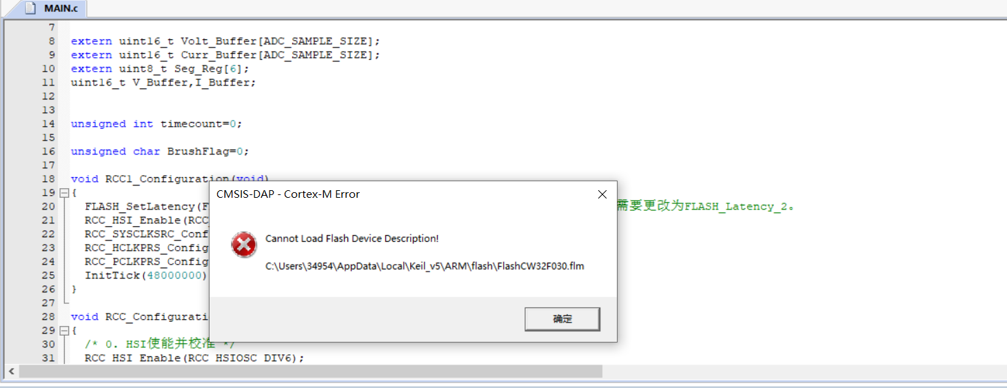

Here I mainly describe some problems I encountered during software flashing:

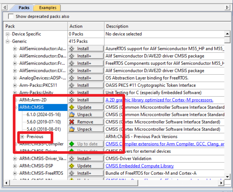

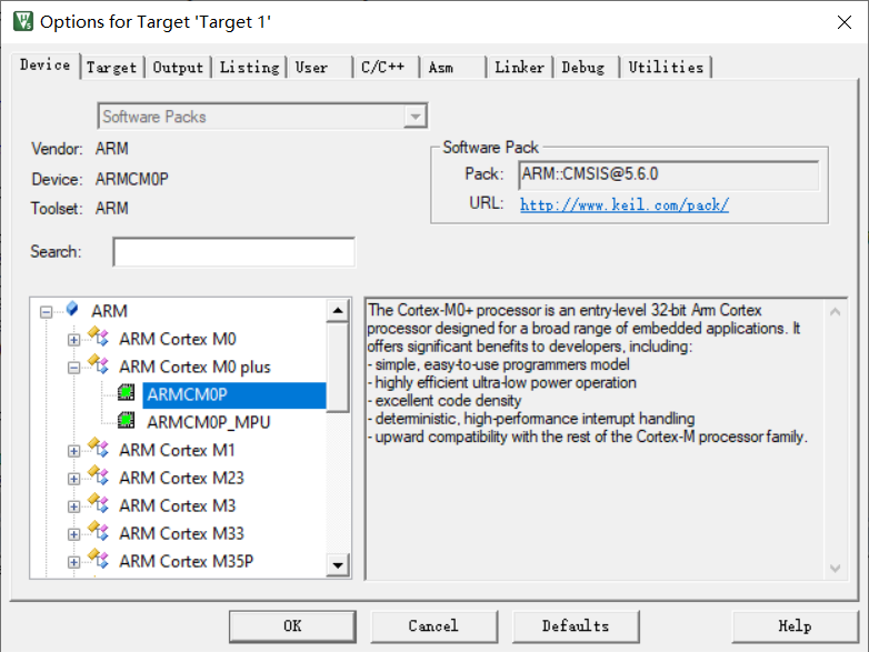

Refer to the official documentation. Set the compiler to
CMSIS version 5. In the settings page below, remove CMSIS version 6.1.0 and install version 5.6. I haven't tried other versions, but versions lower than 5.4 definitely won't work (I don't know why it shows version 5.4 on this screen, but only 5.1.2 is actually installed. Now I've installed version 5.6, which is actually 5.3, and it compiles normally; I don't know why).
Downloading experiments 7, 8, and 9 will result in the error shown in the image below because the default chip selection is incorrect; correct it.
When soldering the sockets, you can first insert the microcontroller into two sockets and solder them together for easier spacing control. I soldered them separately, and finally, inserting the microcontroller required a bit of force; I even had to bend the pins to push it in.

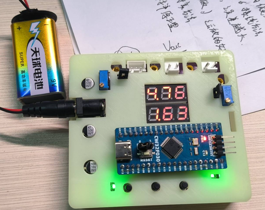

For power supply, you can buy 9V dry batteries and a 9VDC adapter cable from Uxin. The two together will cost about 2.5 yuan. Battery power is definitely more stable than cheap power adapters.
Before safely powering on, use a multimeter in buzzer mode to check for short circuits between VCC and GND. There shouldn't be any major problems.

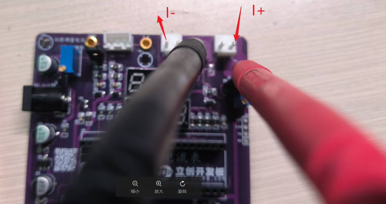

The ammeter connection method is shown in the picture below. You can connect the ammeter in series into the test system
and debug it. Remember to solder the sampling resistor on before actual testing. Remove the two pin headers. For
assembly
