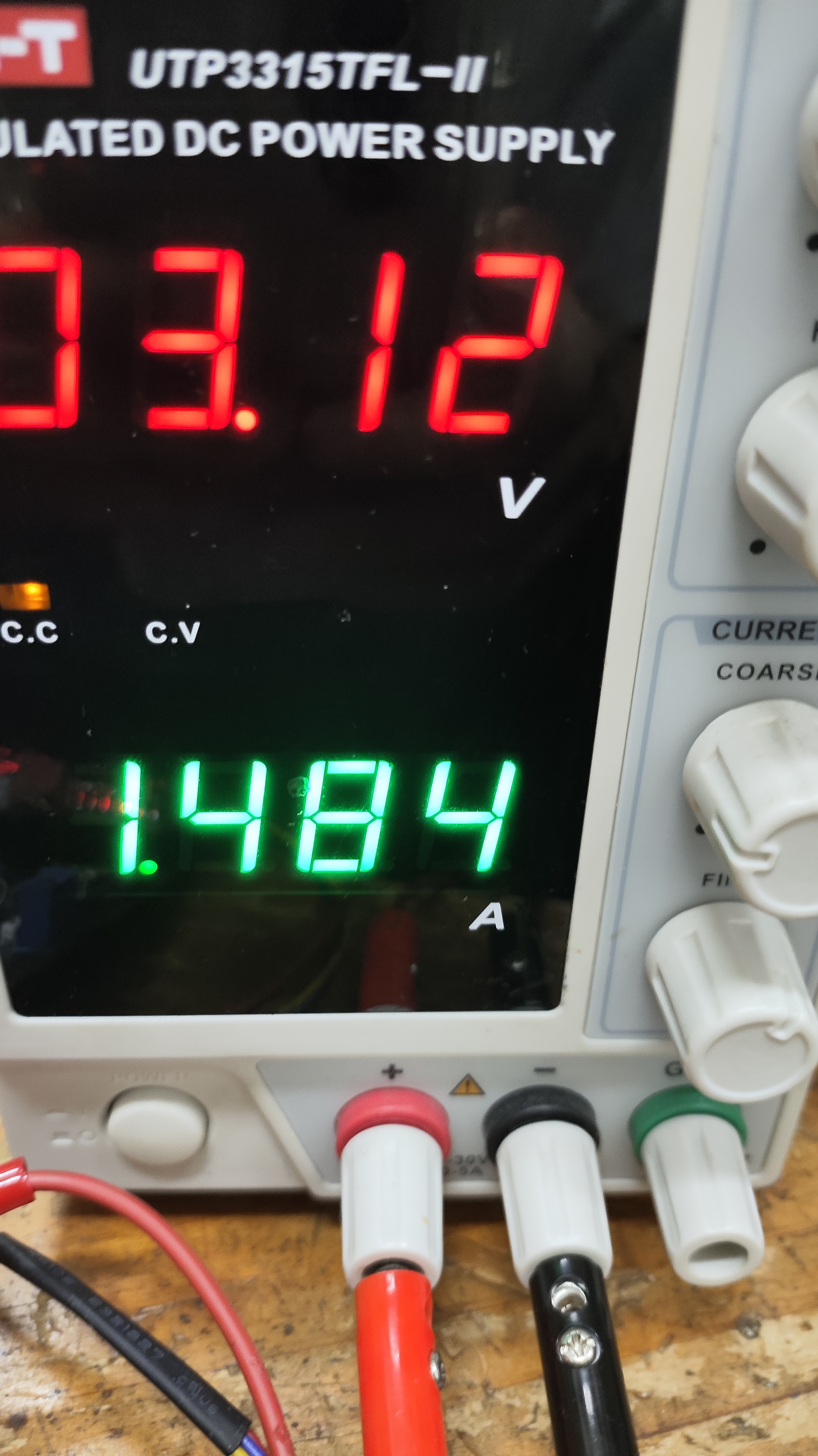

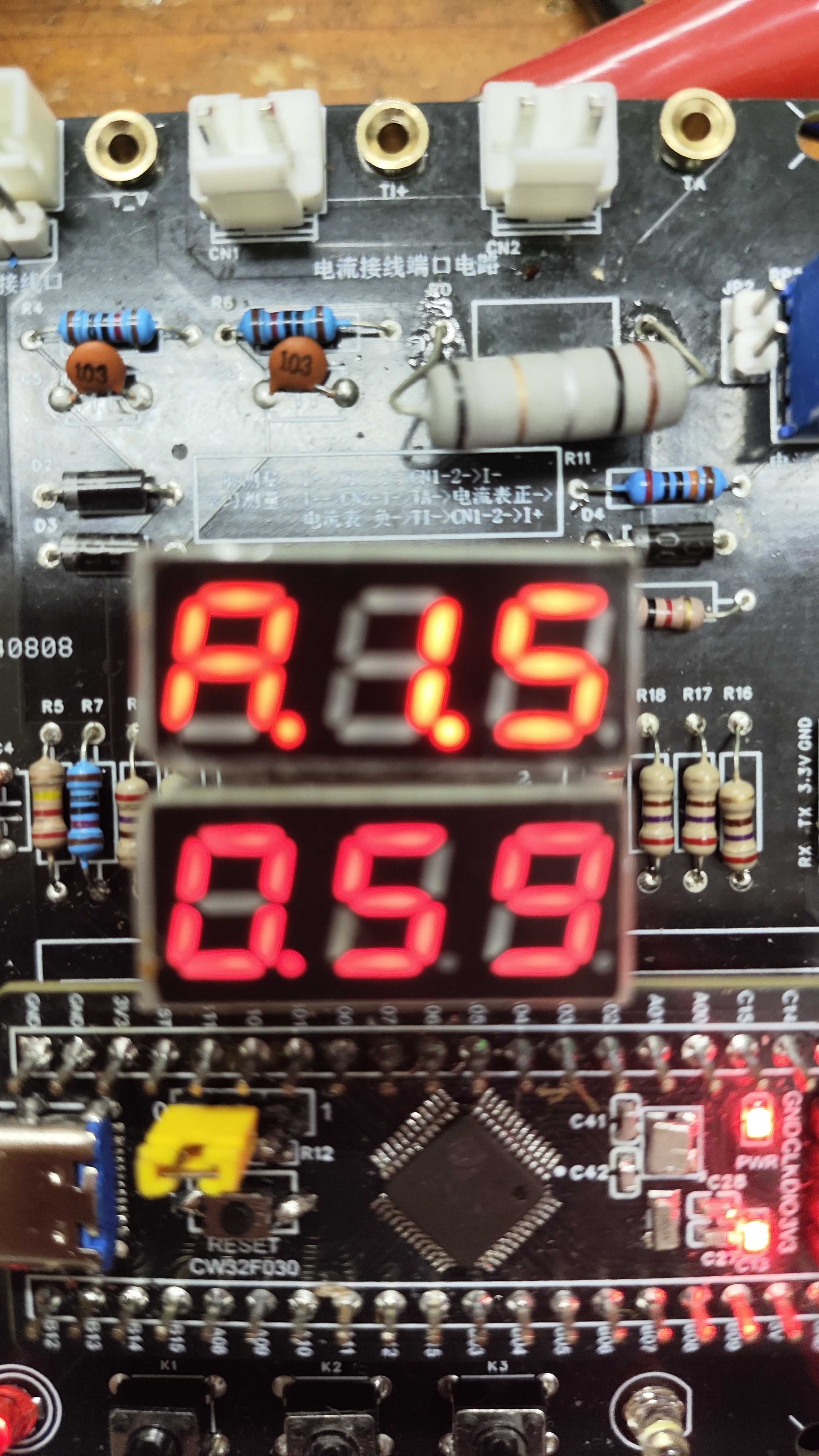

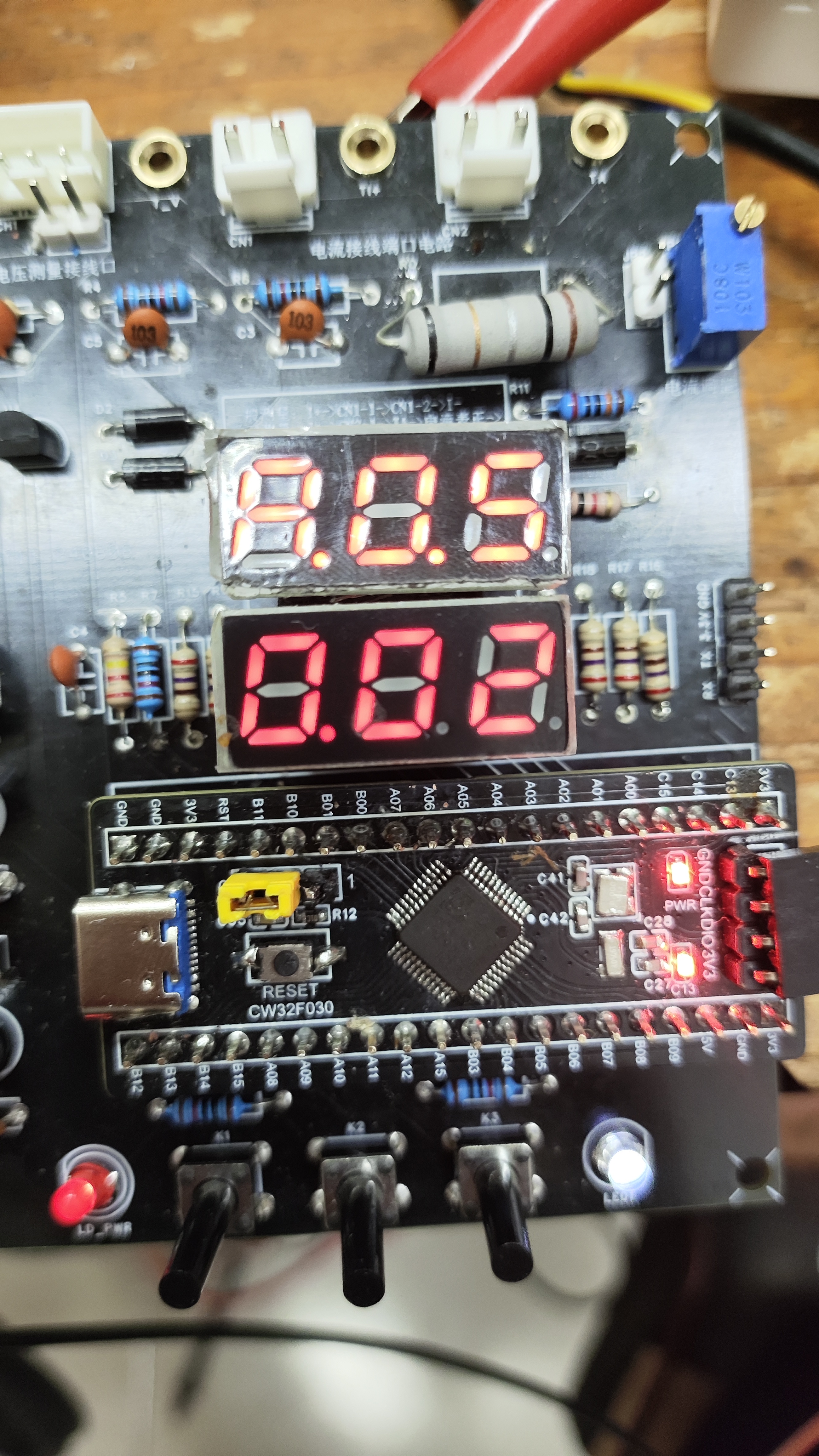

See the diagram for details:
Calibrate 1.5A current ,
Calibrate 0.5A current .

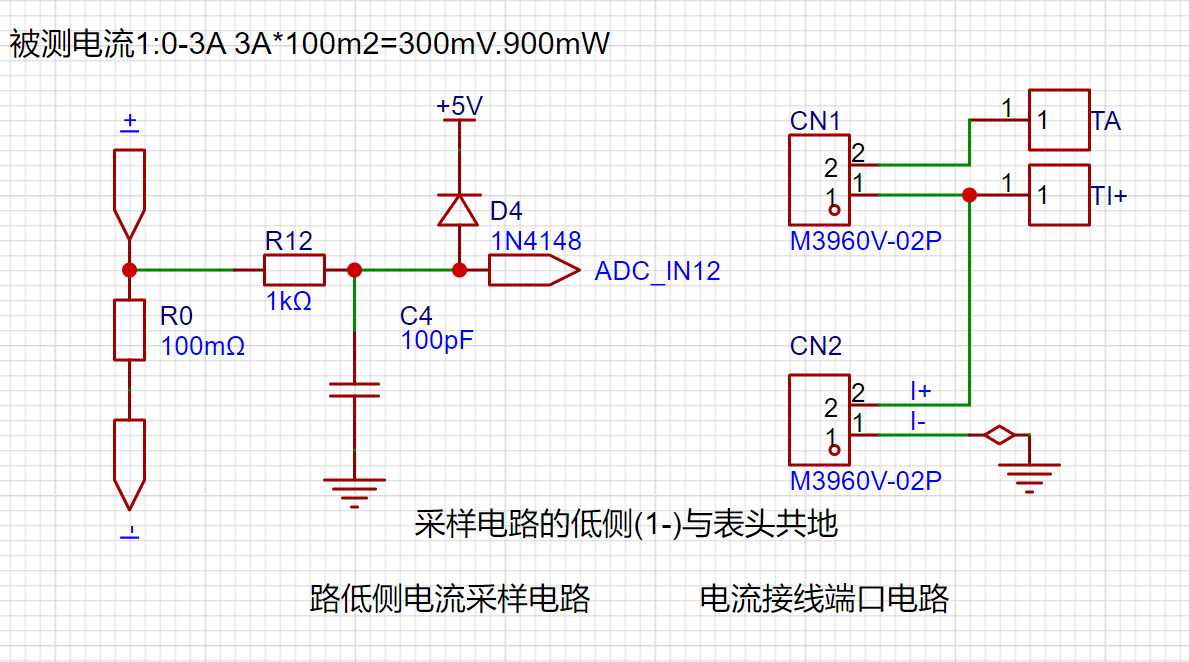

Example Figure 1: Current Detection Circuit:
A 100mΩ current sensing resistor provides voltage to the ADC for calculation.

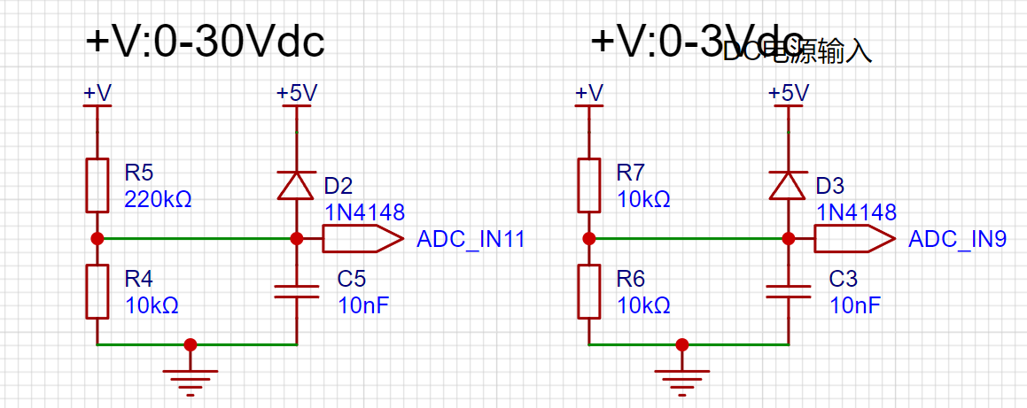

2. Voltage and Current Acquisition Circuit:
Voltage:
The maximum designed voltage to be measured. For safety reasons, this project uses 30V (the actual maximum display value can be 99.9V or 100V);
ADC Reference Voltage: 1.5V in this project. This reference voltage can be configured through the program;
Power Consumption: To reduce the power consumption of the sampling circuit, the low-side resistor (R7) is usually selected as 10K based on experience;
Current:
The maximum designed measured current. In this project, it is
the voltage difference caused by the 3A current sensing resistor. It is generally not recommended to exceed
the power consumption of the current sensing resistor by more than 0.5V. A suitable package should be selected based on this parameter. Considering the power consumption (temperature) problem under high current, a 1W packaged metal wire-wound resistor was selected in this project
. Voltage Amplification Factor on the Current Sensing Resistor: No operational amplifier was used to build the amplification circuit in this project, so the factor is 1.

4.2 Voltage Sampling Circuit
![05761368422a4c9000a5a3c2ae00746.png] Two voltage input ranges are selectable: 0~30V and 0~3V, with the 3V range offering higher accuracy.
Both ranges use two series resistors for voltage division sampling. Since the ADC's internal reference voltage of 1.5V is used (which can be replaced),
the voltage division ratio is 1.5V/30V = 0.05. A 10KΩ resistor is chosen for voltage division sampling, so the total resistance R = 10 / 0.05 = 200KΩ. Therefore, the high-side resistance value = 200 - 10 = 190KΩ. A more common 200KΩ resistor was chosen here. The same logic applies to the 3V range.
4.3 Current Sampling Circuit
![image.png] The sampling current designed for this project is 3A, and the selected sampling resistor (R0) is 100mΩ. According to the formula, 3A * 100mΩ = 300mV, 900mW. See the schematic diagram for other details.

8. Finished Product Demonstration:
Simulated voltage measurement
![image.png]
Simulated current measurement
![image.png]
Recording table
![image.png] The results are quite close.

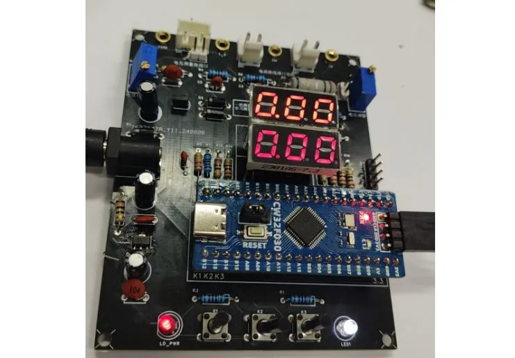

#JLCIC Training Camp# [1712472A] #Voltmeter & Ammeter
This simple digital voltmeter and ammeter uses a CW32 microcontroller as the main controller, a 0.28-inch red LED digital tube for display, two LEDs for voltage and current indication, and three buttons for selecting the measurement value type.
Project Overview:
This project is a simple digital voltage and current meter based on the LCSC CW32F030C8T6 development board, with minor modifications based on official examples.
The project
uses the development board's built-in ADC to acquire data and performs mean filtering. It uses one 0.28-inch red LED digital tube for display, with two LEDs (blue and red) for each value. Blue indicates the current value, and red indicates the voltage value. There are three independent buttons: K1 for current (0-3A), K2 for voltage (0-3V), and K3 for voltage (0-30V).
Project Parameters :
CW32 as the main controller;
one 0.28-inch common cathode digital tube;
two LED indicators;
three buttons. Principle Analysis (Hardware Description):
This project mainly consists of the following parts: digital tube display circuit, voltage and current indicator circuit, DC power input circuit, main control unit, voltage sampling circuit, current sampling circuit, voltage measurement and calibration circuit, and button control circuit. The project primarily uses the sampling circuit to acquire data, and the main controller processes the data and drives the LED digital tube to display the measured values.
[Digital Tube Display Circuit]:
A single 0.28-inch 3-digit common cathode LED digital tube is used for display, saving one tube, but the display accuracy is insufficient.
[Voltage and Current Indication Circuit]:
Two different colored LEDs are used for indication; blue indicates current and red indicates voltage. 3mm LED beads or 0805 packaged surface-mount LEDs can be used.
[Main Control Circuit]:
Many pins of the main control circuit are still unused; we'll utilize them next time.
Software code
is attached
and needs improvement.
A 4mm banana-head female connector is used so that the probes can be directly inserted.
Part of the schematic diagram has been deleted to reduce components.
The casing will be added later; it will look like a finished product. Actual product image.

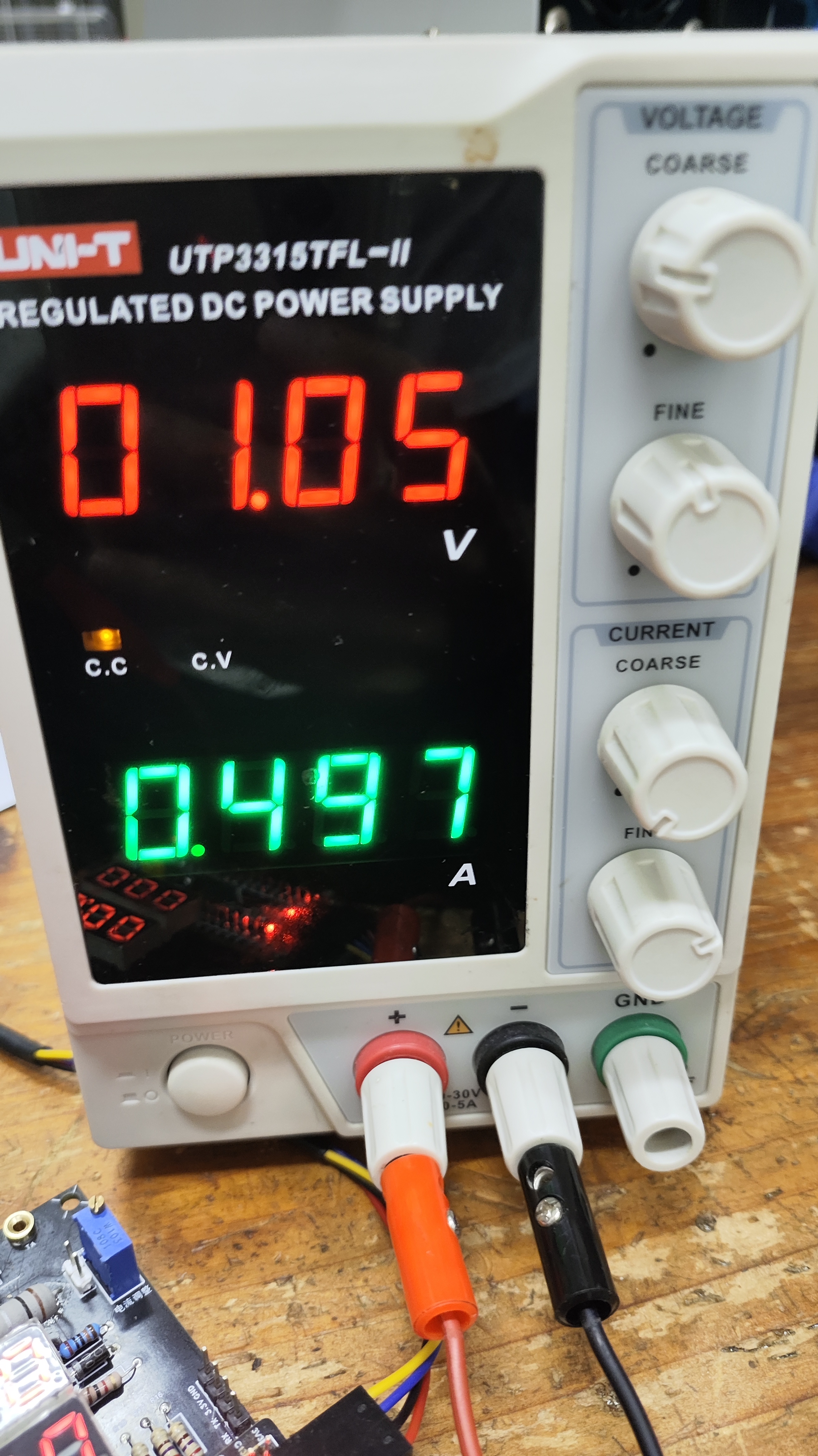

Most other components were replaced with surface-mount components, as all the ones I had were surface-mount. Except for the 100mR sampling resistor, which requires a high-power resistor, 0805 resistors were sufficient for most other components.
The PCB used LCSC's color silkscreen printing (a free coupon from the training camp), which produced excellent results. It didn't fade even with industrial board cleaning fluid, and the colors were very beautiful, with high resolution and precision. For the
banana plug, I used a 4mm plug with an M3 thread, with a height similar to the multi-turn fine-tuning mechanism with a handle. This allowed me to design the casing with the height slightly lower than the fine-tuning height. The hole is slightly higher than the outer casing for easy insertion and removal. (This was my first time designing an outer casing. I found that 1.5mm was too thin and the printed result was distorted. Don't try this at home. The thickness should be at least 2mm.)
To reduce the size, the development board is placed on the reverse side, and the digital display is placed on the front of the development board to save space.
Program Download:
For firmware download, I used DAP_LINK, which is the Liangshanpai-compatible firmware. Just solder a header and it's ready to use. The wiring method is as follows.
Even without the BOOT connection, you can download using the Liangshanpai downloader.
Keil settings are as follows
Software: I modified the LED and KEY I/O ports, as well as the digital tube display code, changing it to common anode. The specific code is as follows:
