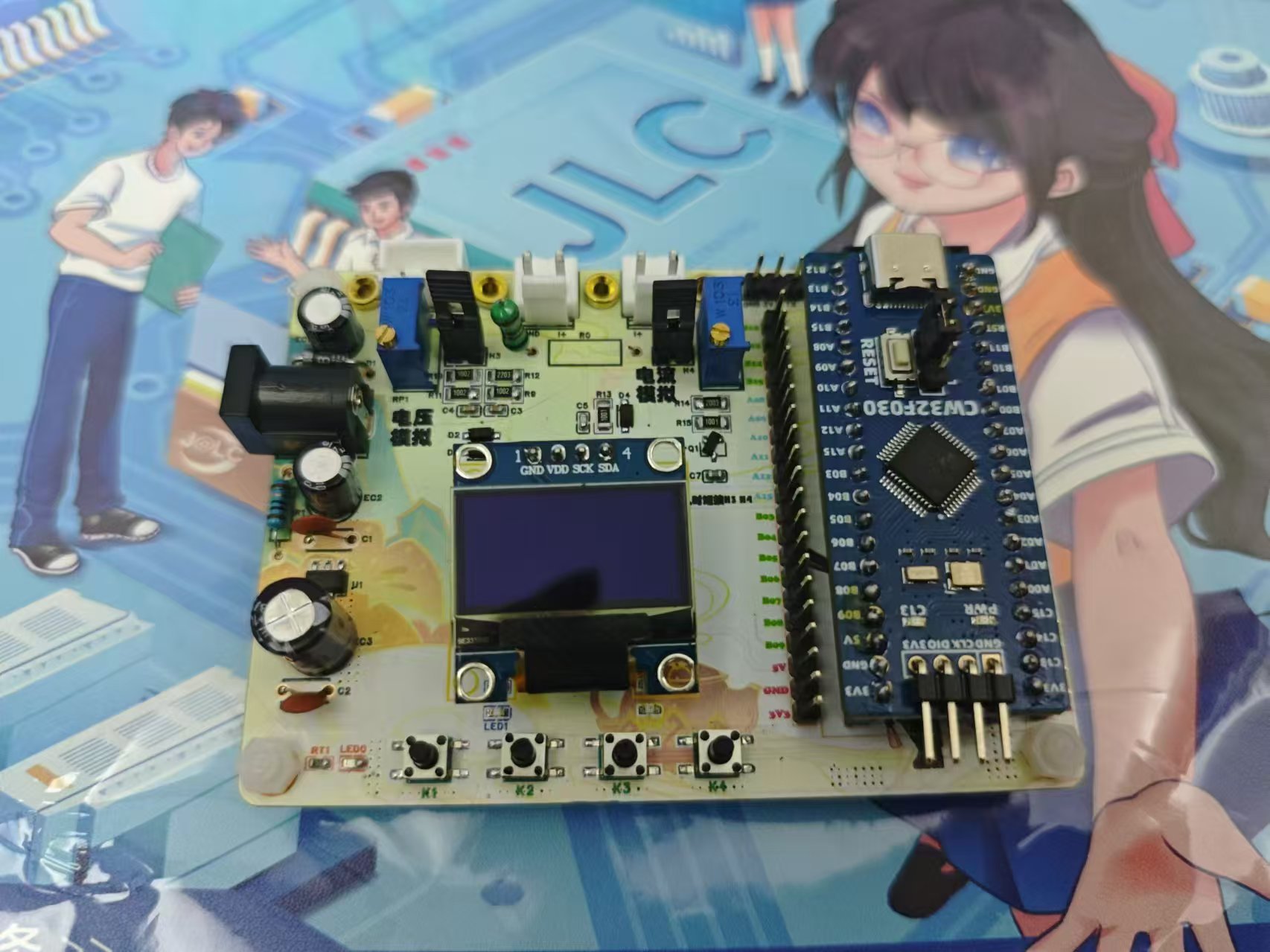

design is based on the LCSC CW32F030C8T6 development board, featuring a digital voltage and current meter. It has four independent buttons with functions for: switching modes, calibration, returning to the main interface (measurement mode), and resetting. It can perform wide-range voltage measurement (0-34.5V) and current measurement (0-3A), with an accuracy of two decimal places. Multi-stage calibration improves measurement accuracy. Two LEDs use different flashing patterns to distinguish the working status and indicate calibration completion. A 0.96-inch OLED screen displays the voltage and current measurement results in real time.
Project Parameters:
This design uses the SE8550K2 LDO chip with a maximum input voltage of up to 40V as the power supply chip. This considers both the high supply voltage and avoids the ripple interference introduced by the DC-DC converter, while also reducing costs.
The LCSC CW32F030C8T6 development board is selected as the control board, which features a wide operating voltage range, strong anti-interference capabilities, and a better ADC—a 12-bit high-speed ADC—along with multiple Vref reference voltages.
This design uses a 0.96-inch OLED display module, showing the current mode at the top and the current voltage and current measurement results or calibration target below.
When the mode is switched or the calibration is completed, a corresponding LED lights up or flashes to remind the user.
A voltage and current analog test circuit is designed for easy learning and debugging.

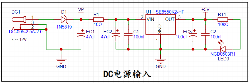

1. Power Supply Circuit
: The DC-005 interface is used as the power input port. The SE8550K2 LDO (low dropout linear regulator) with a maximum input voltage of up to 40V is selected as the power supply, capable of stably outputting 5V voltage.

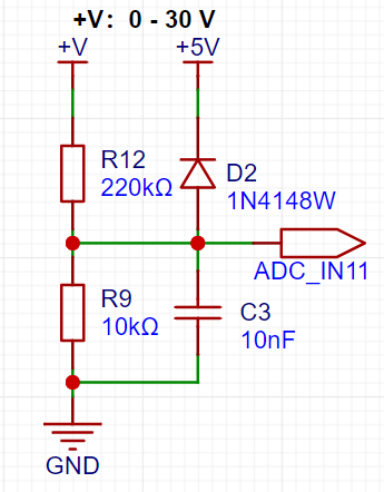

2. Voltage Sampling Circuit:
The voltage divider resistors in this project are designed to be 220K+10K, therefore the voltage division ratio is 22:1 (ADC_IN11). With an ADC reference voltage of 1.5V, the maximum measurable voltage is 34.5V (1.5V * 23).

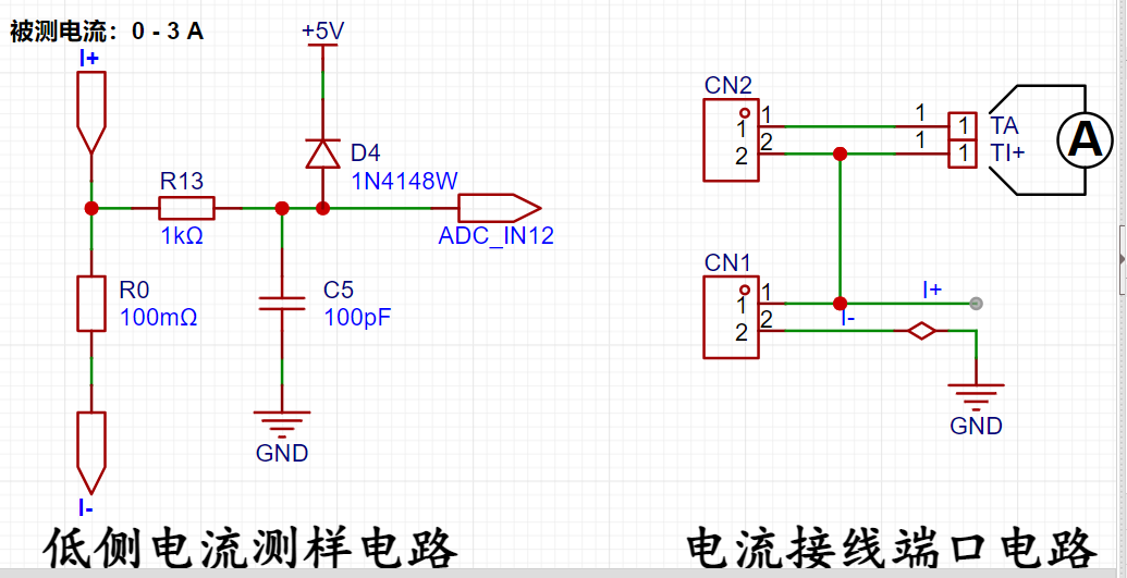

3. Current Sampling Circuit:
This project uses a low-side current sampling circuit for current detection. The low-side of the sampling circuit shares a common ground with the development board's meter interface. The sampling resistor (R0) in the circuit is 100mΩ, and the maximum sampling current is 3A. By measuring the voltage across the sampling resistor (ADC_IN12), the corresponding current is calculated. When the current through the sampling resistor is 10mA, the voltage across the resistor is measured as 1mV.

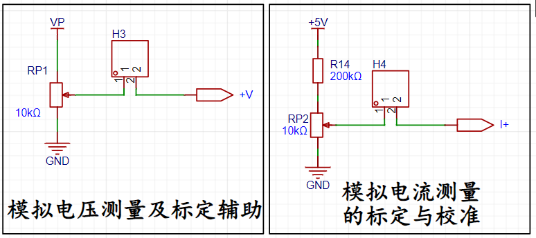

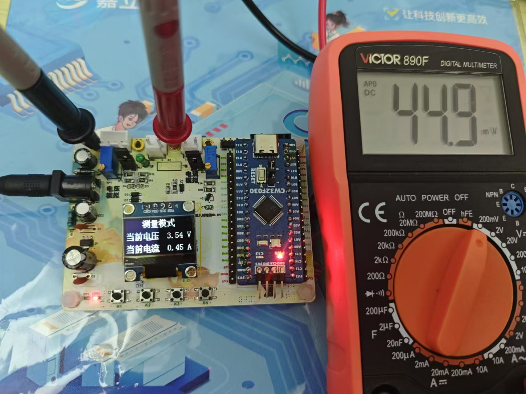

4. Voltage and Current Simulation:
The official example code for this project includes analog measurement and calibration circuits for voltage and current. Since no adjustable power supply is available in this project, all learning, testing, and calibration are performed on analog circuits. Voltage and current measurements are both achieved by collecting the corresponding voltage values ​​and calculating the results using a circuit. Therefore, in the analog circuit, a potentiometer is used to simulate the measurement.

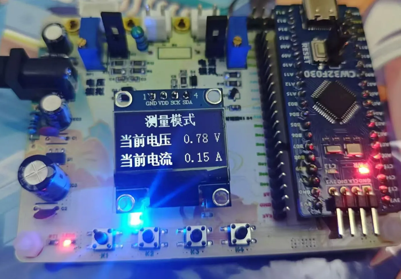

R = 100mr
10ma = mv/R/10=mv/0.1/10 = mv

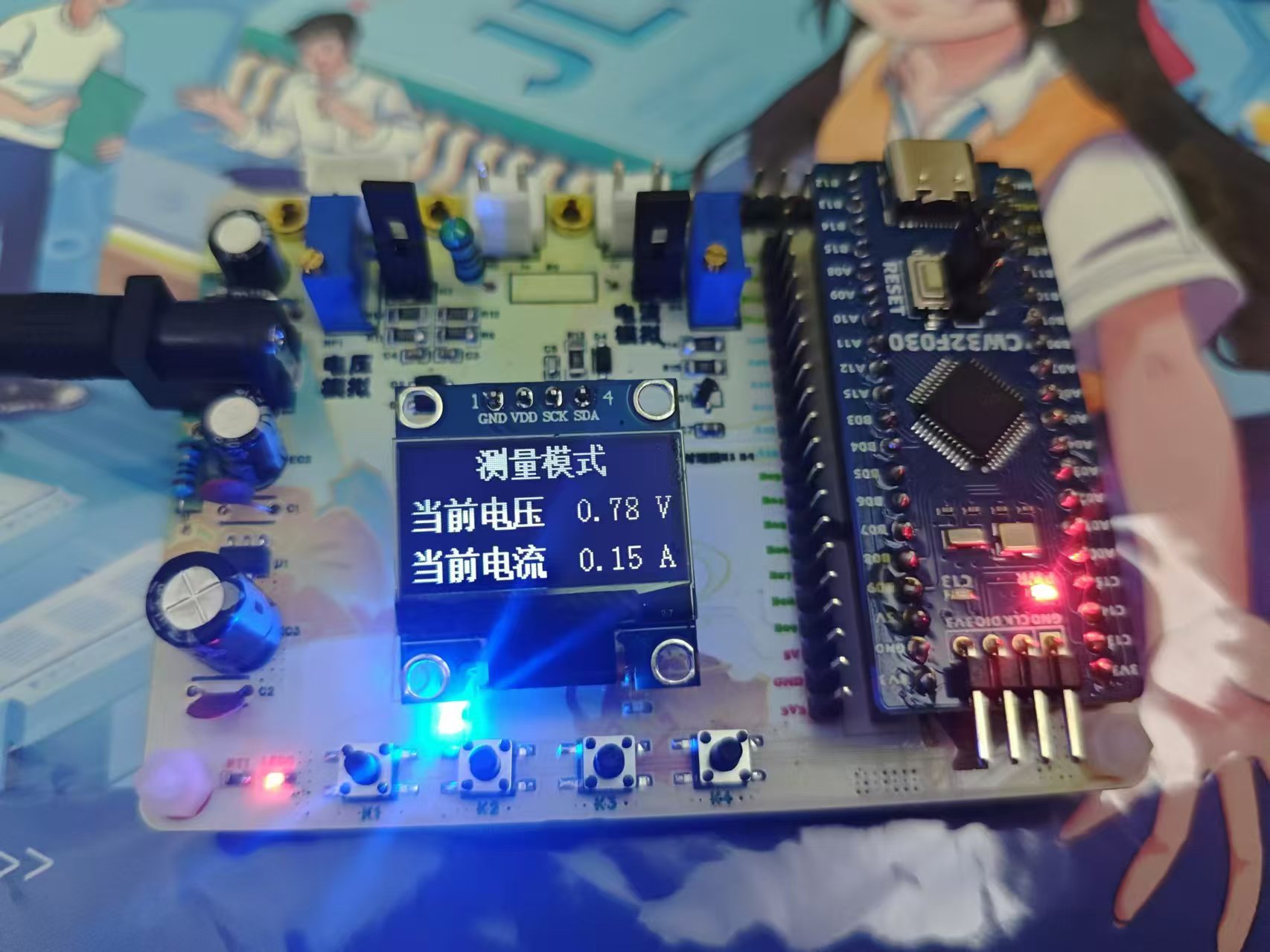

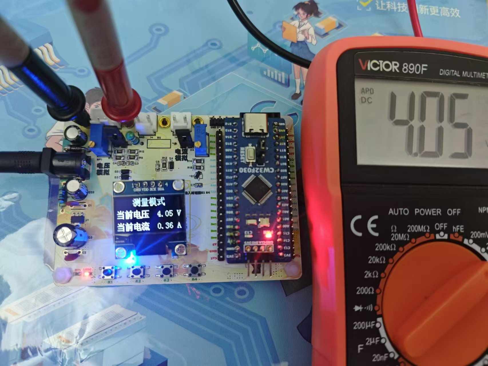

Physical diagram
of voltage and current measurement demonstration.
Voltage simulation measurement.
Current simulation measurement
