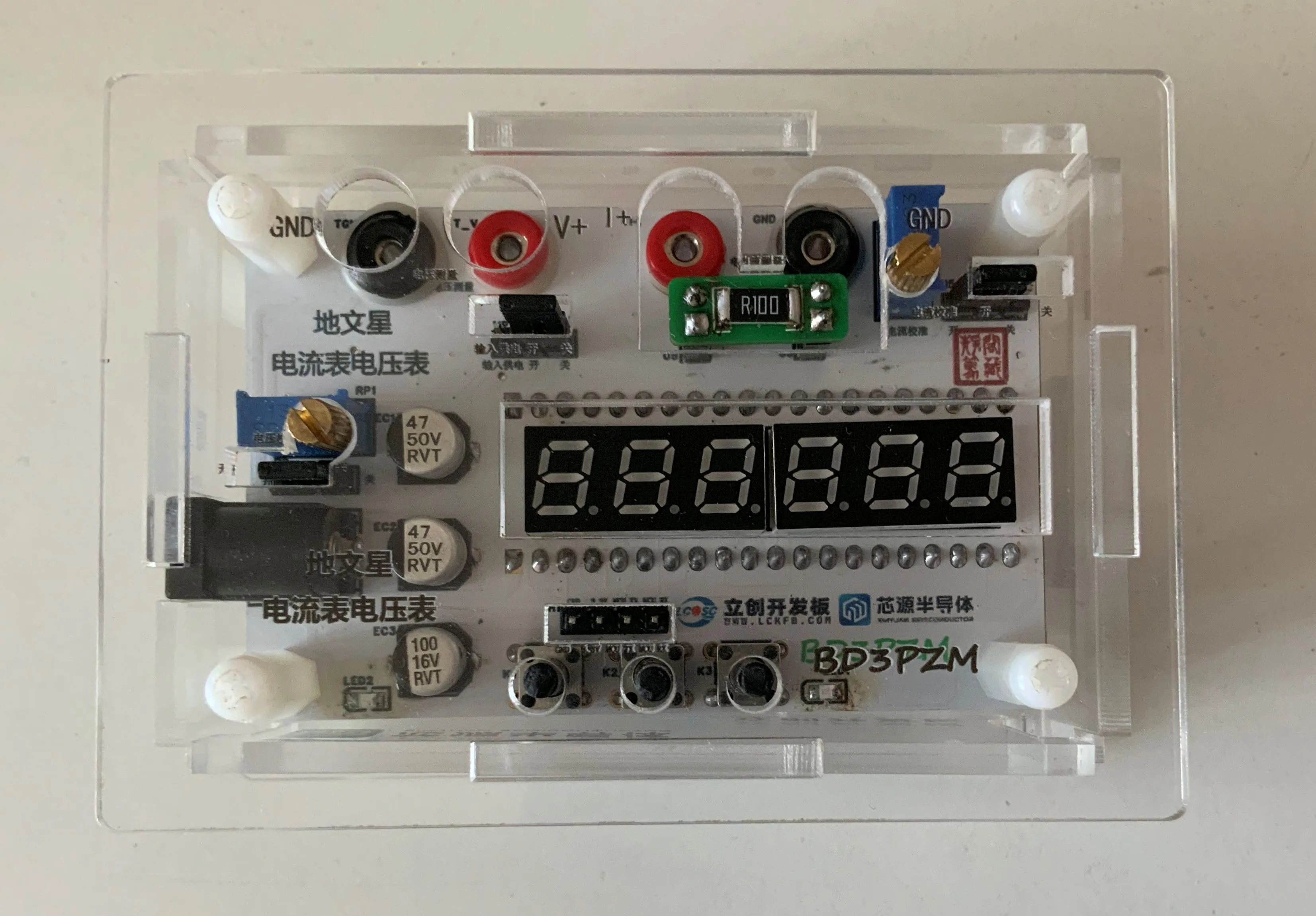

III. Product Diagram and Brief Introduction:
Thanks to JLCPCB's monthly freebie program, five boards were made at once. I must say, JLCPCB's immersion gold and color silkscreen printing processes are truly beautiful.
This is what it looks like after soldering the components. I changed the jumpers on the CW32 development board to single-pole double-throw switches
. This is what it looks like after installing the casing. Due to my lack of experience in designing boards for the first time, the long side of the vertical panel is 6mm shorter. The diagrams in the open-source file have been modified. The acrylic casing for the digital display has a windowed design to reduce glare. This window can be removed if aesthetics and a more cohesive look are desired.
Finally, I would like to thank LCSC Development Board and Sinyuan Semiconductor for organizing this training camp, which allowed me to systematically learn about PCB design and development boards.
