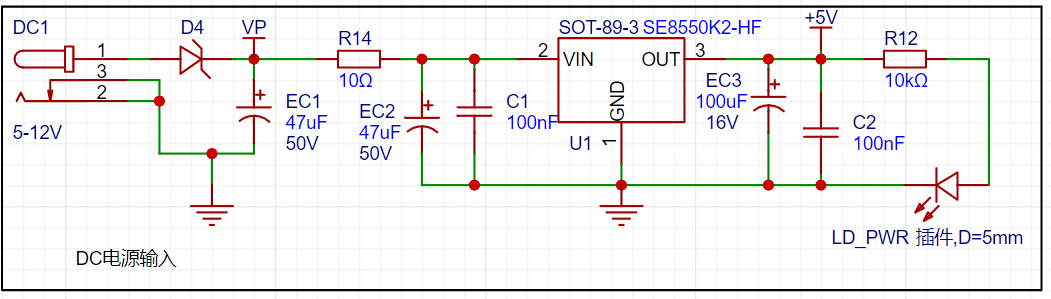

: 3.1 Power Supply Circuit

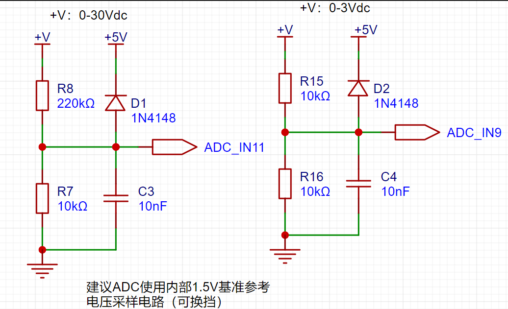

3.3 Voltage Sampling Circuit,

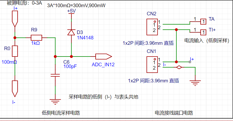

3.4 Current Sampling Circuit,

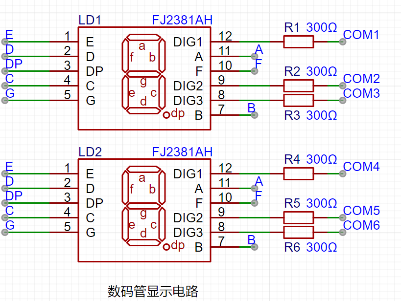

3.5 Digital Tube Circuit,

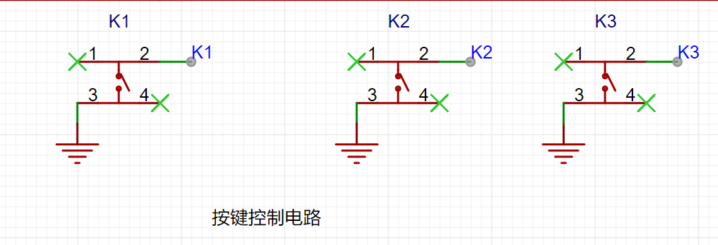

3.6 Keypad

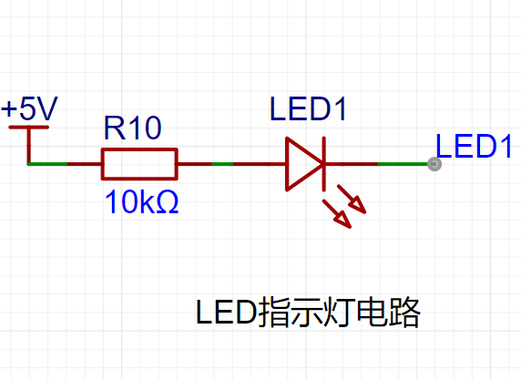

Circuit, 3.7 LED Indicator Circuit, and

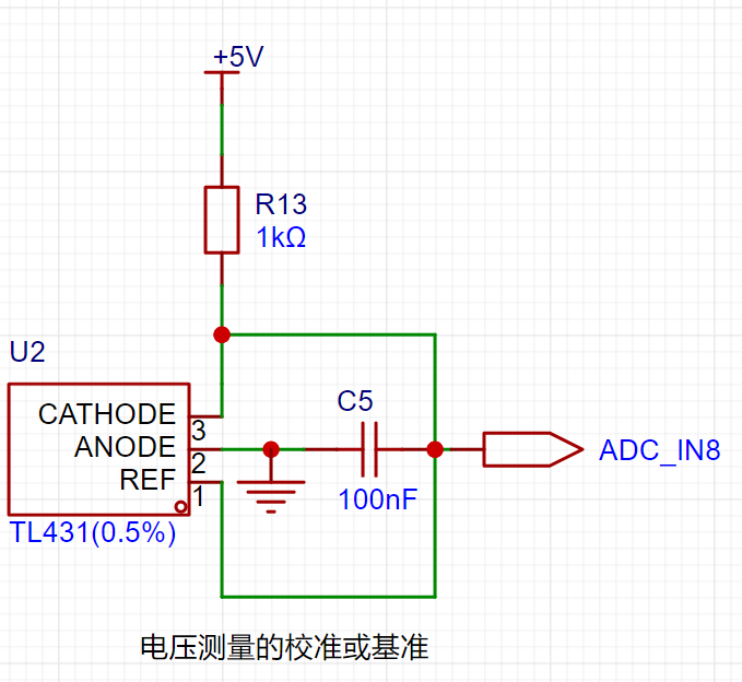

3.8 Voltage Measurement Calibration.

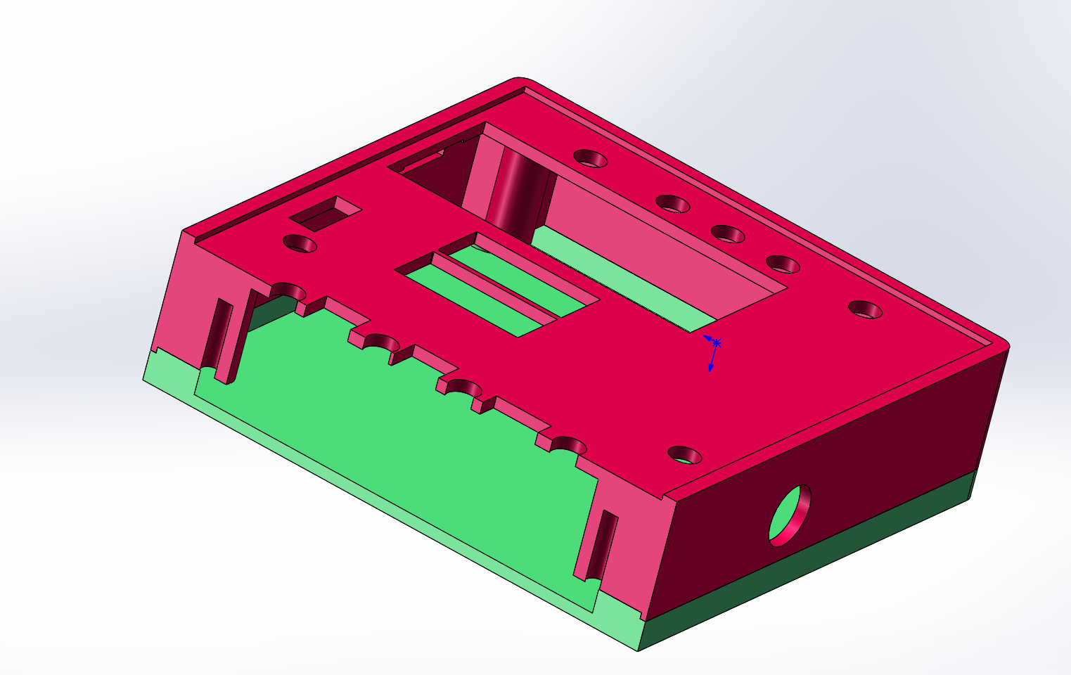

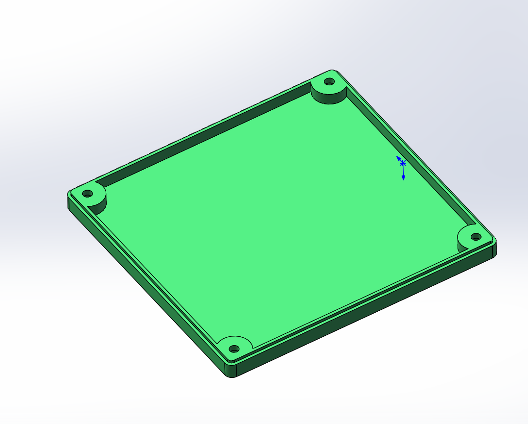

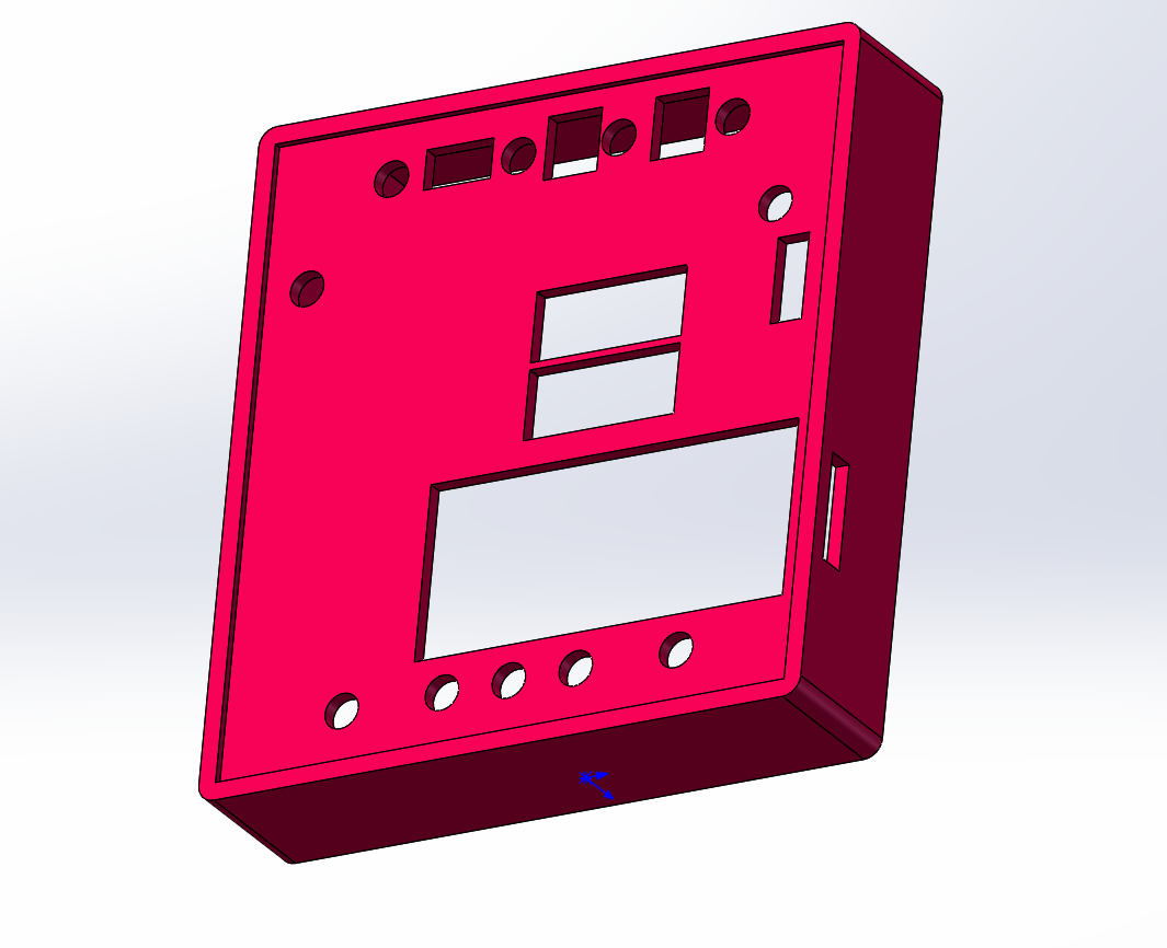

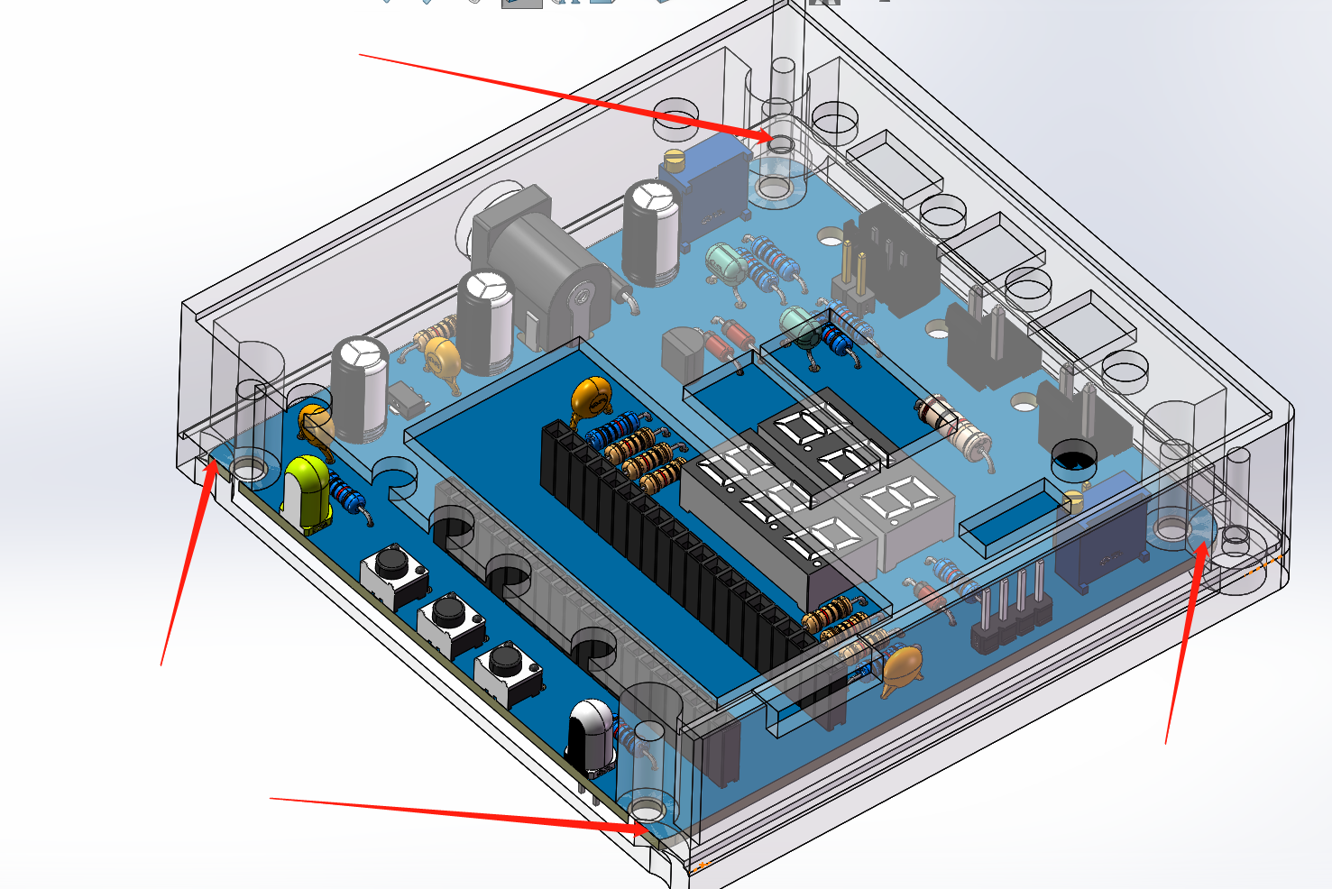

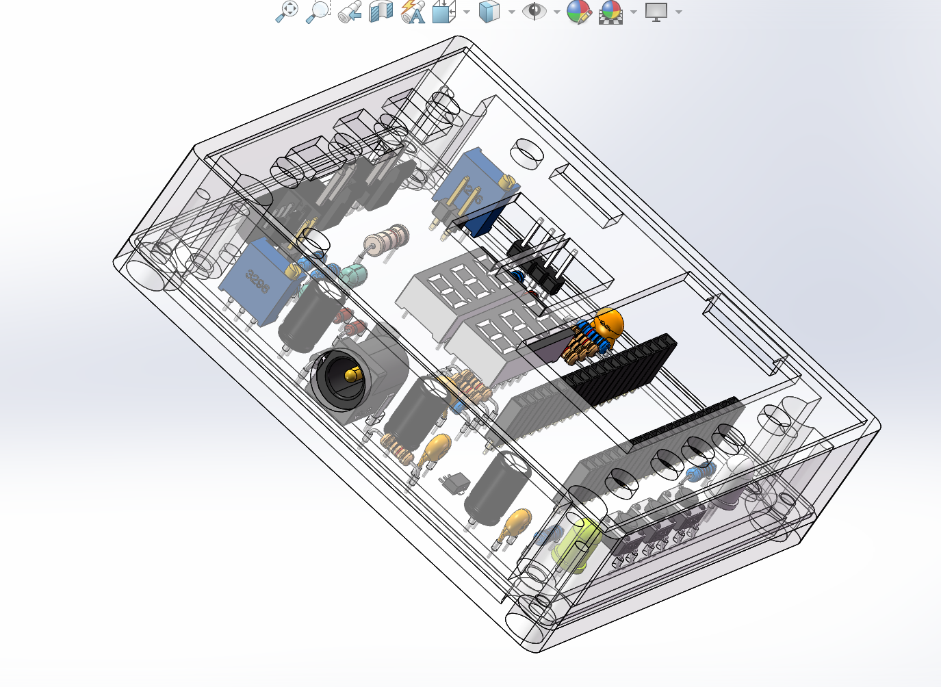

The fifth point concerns the casing design.
The bottom of the casing had some interference after the PCB was installed, making it impossible to install the back cover. However, the upper part did not affect the installation of the panel.
This casing design uses SolidWorks, with the panel embedded in the top cover.
I had considered the button issue when designing the casing. I could have bought an extended button, but I forgot to buy it. The actual product without the extended button was not shown in the picture. Also, I didn't buy the wiring for the measurement connection. I directly soldered some wires as a substitute.

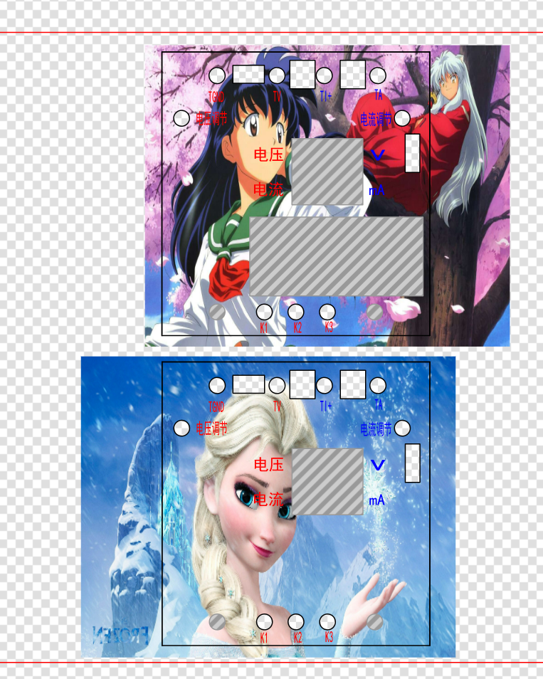

Six: Panel Design.

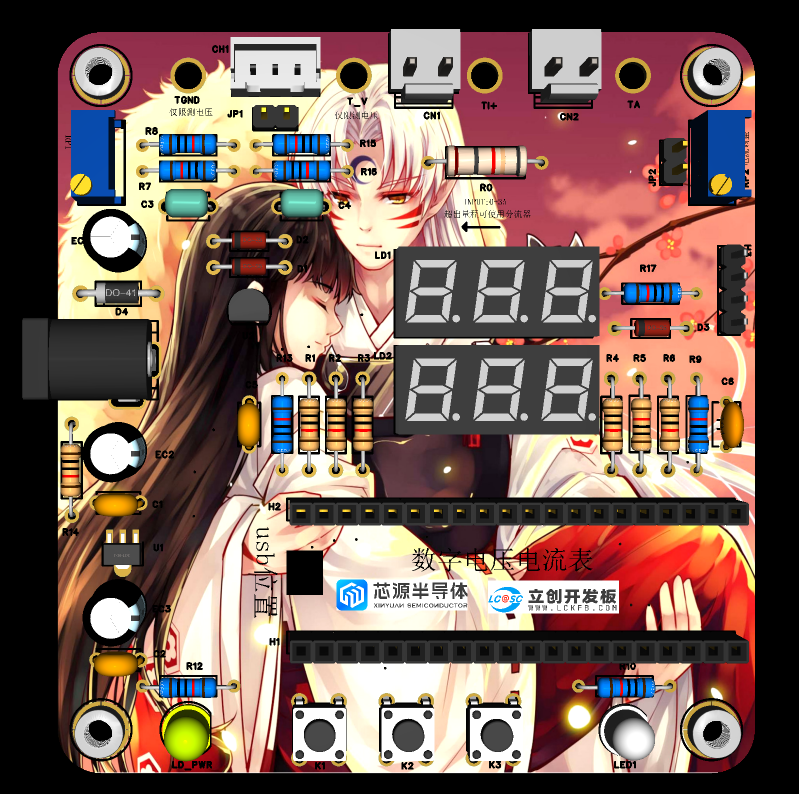

The panel was drawn by exporting the plan view from SolidWorks, importing it into CAD, deleting unnecessary lines, and then importing it into JLCPCB panel design software. There were many mistakes and detours along the way, but I finally completed the panel design by referring to JLCPCB tutorials.

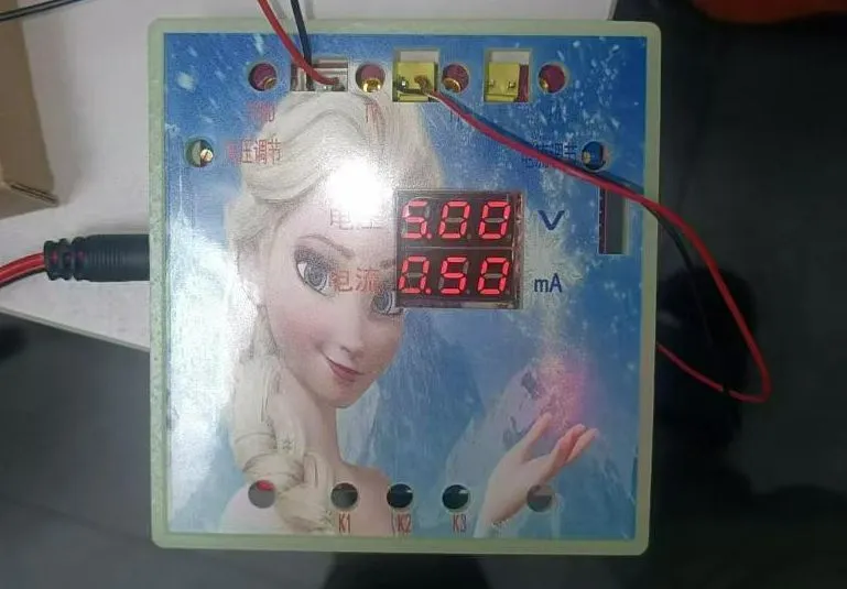

Considering that the development board might protrude, two panel designs were made. One design has a hole for the development board, and the other does not. There were still some problems during the final installation. I shortened the jumper caps on the development board to install it.
The finished result is very good. Because my child likes Elsa. The final product features Princess Elsa.

PS: Don't print the bottom of the 3D shell. I'll upload it as an attachment. The other designs are fine. Hopefully, this provides a way to coordinate the top and bottom.
