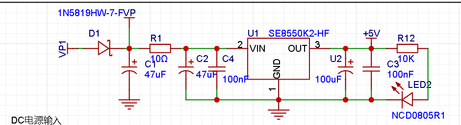

1. LDO (Low Dropout Linear Regulator) Selection This project uses an LDO as the power supply. Considering that most voltmeter products are used in industrial scenarios with 24V or 36V power supplies, the SE8550K2 with a maximum input voltage of up to 40V was selected as the power supply. The main reason for not using a DC-DC step-down circuit to handle the large voltage drop is to avoid introducing DC-DC ripple interference during the design process, and the secondary reason is to reduce project costs.

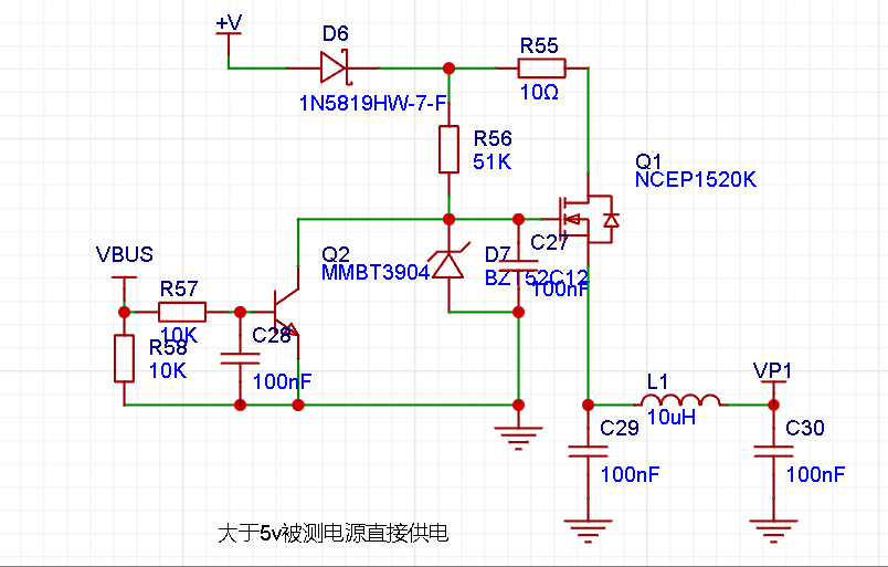

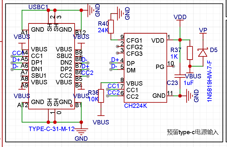

2. Power Input Reserved for TYPE-C Input The measured power supply is greater than 5V and can be directly powered. The TYPE-C has a decoy and can be directly used with QC and PD adapters, eliminating the need to find 12V DC, which is more convenient. A mobile phone charger can be used.
3. Add a wide voltage test and power supply circuit to directly power the measured voltage.

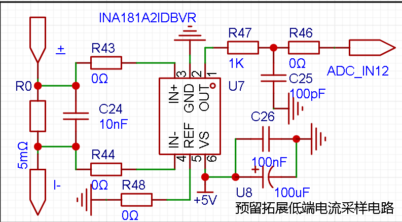

. 5. The measured current uses an INA181A2IDBVR op-amp, and the sampling resistor is 5mR, which can sample a current of 9A. The resistor heat is also acceptable.

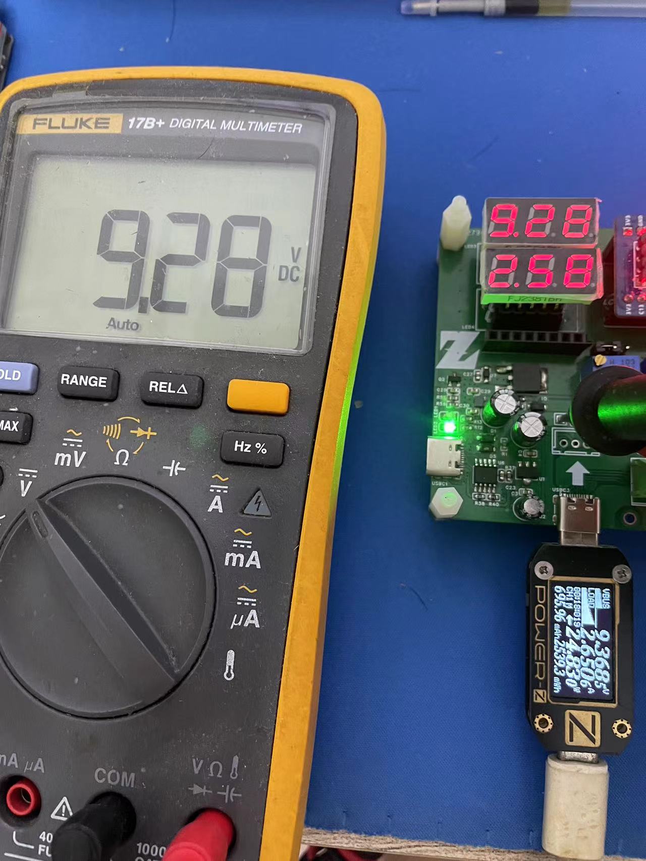

II. Measured voltage: 80V, current: 9A. [Link to video
: https://www.bilibili.com/video/BV1VSWaeAEuK/?buvid=Y547CF5FFD8C67C545E4B9FF51771F4B48A9&from_spmid=dt.dt.video.0&is_story_h5=false&mid=Ju8wUut0t7vUiur7dtYdxQ%3D%3D&p=1&plat_id=116&share_from=ugc&share_medium=iph ] one&share_plat=ios&share_session_id=F25532DB-05E1-4EF4-910E-C939379A2542&share_source=WEIXIN&share_tag=s_i &spmid=united.player-video-detail.0.0×tamp=1724249447&unique_k=rLJIonD&up_id=357535055&share_source=weixin

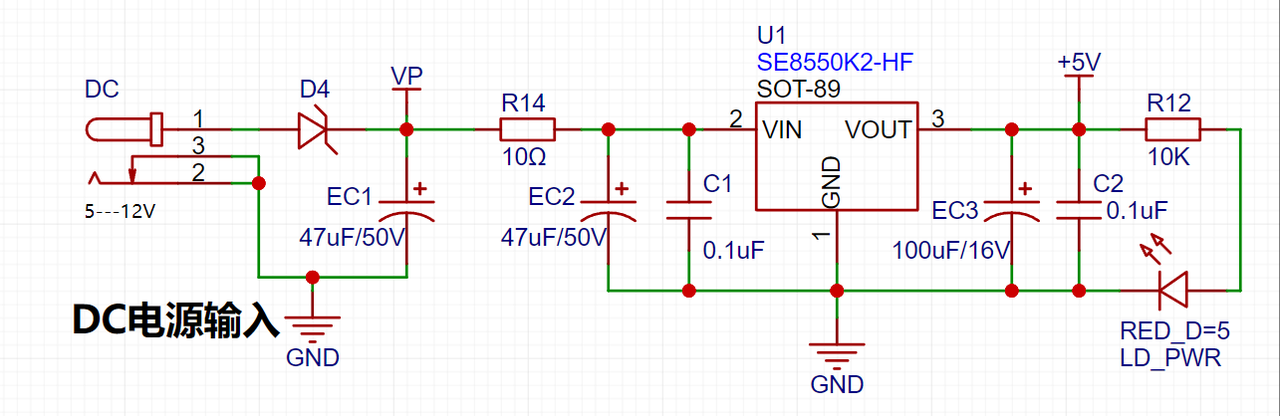

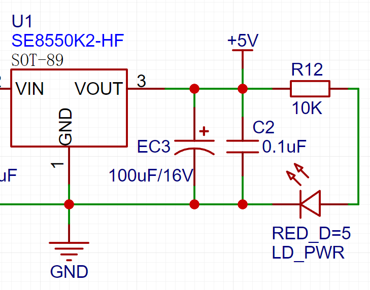

1. Power Supply Circuit
imgLDO (Low Dropout Linear Regulator) Selection

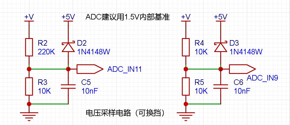

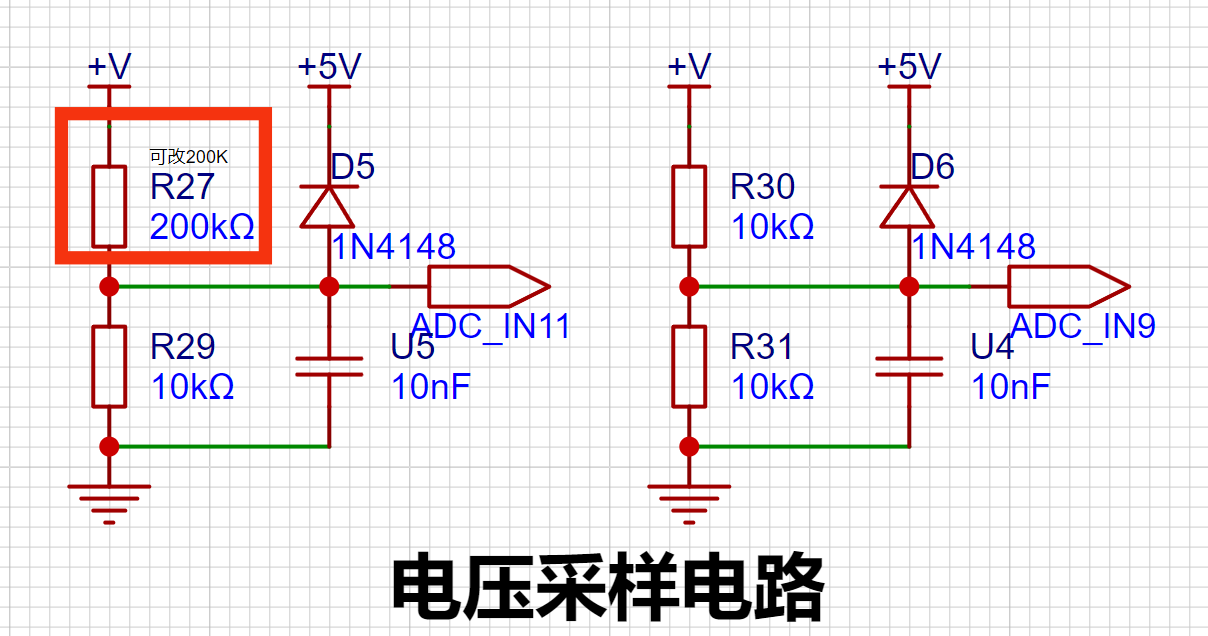

3. Voltage Sampling Circuit:
The voltage divider resistors in this project are designed to be 220K+10K, therefore the voltage division ratio is 22:1 (ADC_IN11).
The voltage divider resistor selection
is designed to measure the maximum voltage. For safety reasons, this project uses 30V (the actual maximum display value can be 99.9V or 100V).
The ADC reference voltage is 1.5V in this project, and this reference voltage can be configured through the program.
To reduce the power consumption of the sampling circuit, the low-side resistor (R7) is usually chosen as 10K based on experience.
Then, the high-side resistance of the voltage divider resistor can be calculated using the above parameters.
The required voltage division ratio is calculated, i.e., the ADC reference voltage. The input voltage is designed; using known parameters, 1.5V/30V = 0.05 can be calculated.
The high-side resistance is calculated as the low-side resistance/voltage division ratio; using known parameters, 10K/0.05 = 200K can be calculated.
A standard resistor is selected: a resistor slightly higher than the calculated value of 200K is chosen. We usually choose E24 series resistors; therefore, in this project, 220K, which is greater than 200K and closest to the calculated value, is selected.
If, in actual use, the voltage to be measured is lower than 2/3 of the module's design voltage (66V), the voltage divider resistor can be replaced and the program modified to improve measurement accuracy. The following example illustrates this:
Assuming the measured voltage is no higher than 24V and other parameters remain unchanged,
calculations show 1.5V/24V = 0.0625, 10K/0.0625 = 160K. 160K is a standard E24 resistor and can be directly selected, or a higher value 180K can be chosen with some redundancy.
If, in actual use, the voltage to be measured is higher than the module's 99V design voltage, a different resistor can be selected. To expand the voltage measurement range, you can choose to replace the voltage divider resistor or modify the reference voltage. The following example illustrates this:
Assuming the measured voltage is 160V, we can choose to increase the voltage reference to expand the range.
Given that the voltage division ratio of the selected resistor is 0.0145, we can calculate 160V * 0.0145 = 2.32V using the formula. Therefore, we can choose a 2.5V voltage reference to expand the range (increasing the range will reduce accuracy).
Considering the potential fluctuations in the measured power supply, a 10nF filter capacitor is connected in parallel with the low-side voltage divider resistor in the circuit design to improve measurement stability.
(Range switching )
In this project, an additional voltage sampling circuit was added. Therefore, we can discuss the significance of range switching for improving measurement accuracy. Multimeters often have multiple range settings to achieve more accurate measurements. By adjusting different ranges, the optimal measurement accuracy of the measured point within the corresponding range can be obtained.
This project requires a combination of hardware and software to implement this function. When we first use the ADC_IN11 channel mentioned earlier to measure voltages below 30V, if the measured voltage is within 0~3V, then we use the ADC_IN9 channel for measurement. At this time, due to the reduced voltage division ratio, the measurement accuracy is greatly improved.
There are many ways to implement range switching; the development board design provides more design possibilities.

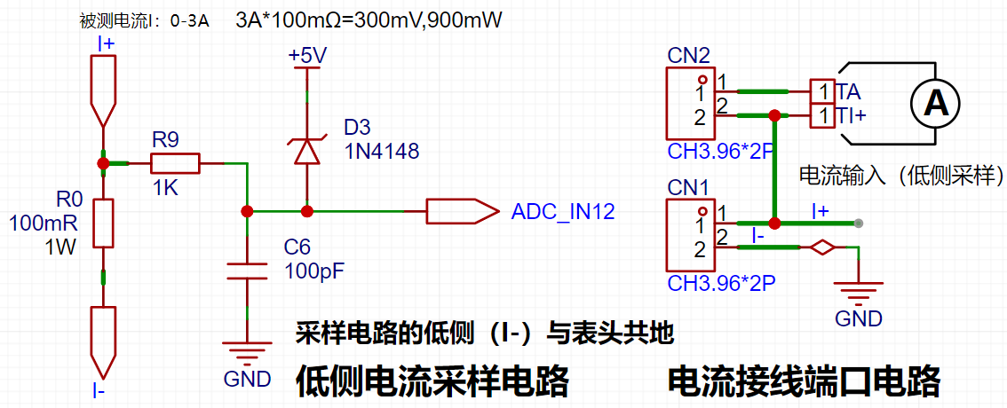

4. Current Sampling Circuit
This project uses a low-side current sampling circuit for current detection. When learning the common ground between the low-side of the sampling circuit and the development board's meter interface

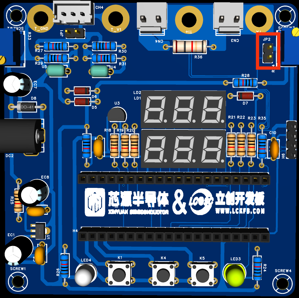

, please do not solder R0!!!
image.pngThe design analysis
for this project involves a sampling current of 3A, and the selected sampling resistor (R0) is 100mΩ.
The selection of the sampling resistor mainly needs to consider the following aspects:
the maximum value of the pre-designed measurement current;
the voltage difference caused by the 3A current sensing resistor in this project; and
the power dissipation of the current sensing resistor, which should generally not exceed 0.5V. A suitable package should be selected based on this parameter. Considering the power dissipation (temperature) issue under high current, a 1W metal wire-wound resistor package was chosen
. The voltage amplification factor across the current sensing resistor is also important. Since no operational amplifier is used to build the amplification circuit in this project, the factor is 1.
The current sensing resistor value can then be calculated using the above parameters
. Since no amplifier circuit is used, a larger sampling resistor is needed to obtain a higher measured voltage for measurement.
Considering that a larger resistor would result in a larger voltage drop and higher power consumption, an unlimited selection of a larger resistor is not feasible.
This project uses a 1W package resistor, corresponding to a power consumption of 1W.
Based on the above data, a 100mΩ current sensing resistor was selected. According to the formula, 3A * 100mΩ = 300mV, 900mW can be calculated.
To cope with different operating environments, especially high-current scenarios, the R0 resistor can be replaced with constantan wire or a shunt. The replacement can be selected according to the actual application scenario. For safety and educational purposes, this project will not discuss measurements exceeding 3A in detail, but the principle is the same.

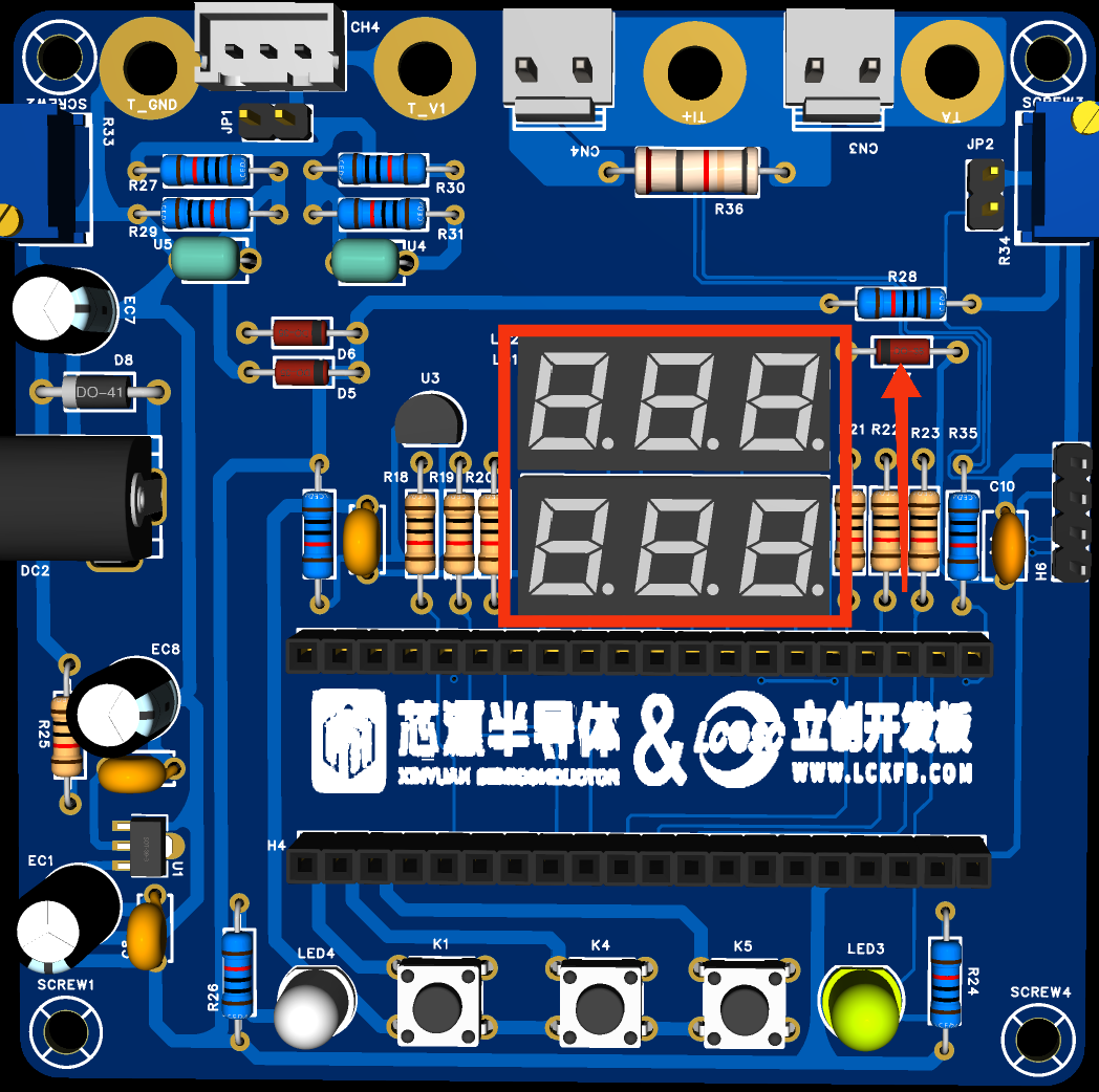

5. Digital Tube Display
This project uses a digital tube as the display unit.

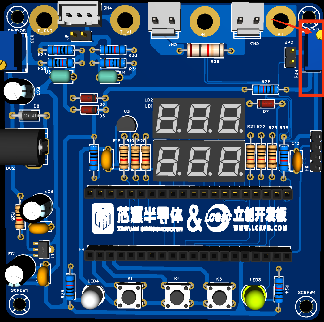

This project uses two 0.28-inch three-digit common-cathode LED displays as the display device. Compared to a display screen, LED displays offer better visibility in complex environments. The brightness of the LED displays can be increased by using smaller current-limiting resistors, depending on the specific needs of the application environment. Furthermore, LED displays have better mechanical properties and are not as easily damaged by external forces as display screens. They are widely used in industrial applications where stability and reliability are crucial. From a development board learning perspective, this makes it easier to learn electronic measurement principles and related development in a targeted manner.
In this project, actual testing showed that the current-limiting resistors (R1~R6) for the LED displays were configured to 300Ω. The corresponding brightness for both red and blue LED displays was good and the brightness was soft and not glaring.
Strictly speaking, the current-limiting resistors should be added to the segments; adding them to the digits would affect the display effect. Our actual design places them in the digits to save a few resistors, but the impact on the display is not significant. Therefore, we add them to the digits for convenience.
The
driving principle of LED displays mainly involves controlling the switching state of each segment of the LED display to display numbers, letters, or symbols. The following is a detailed explanation of the driving principle:
Basic Structure of a Digital Tube:
A digital tube typically consists of seven or eight LED segments (eight segments in this project). Each segment represents a part of the digital tube and can display numbers 0-9, letters AF, etc.
Digital tubes come in two types: common cathode and common anode. The difference lies in whether the common terminal COM (the end connecting all LEDs) is connected to the negative or positive terminal of the power supply.
Driving Methods:
Segment Selection: The desired number or character is displayed by controlling the on/off state of each segment of the digital tube. Each segment corresponds to a control signal; when the control signal is on, the segment lights up, and vice versa. (a, b, c, d, e, f, g, dp)
Bit Selection: The digital tube to be displayed is selected by controlling the bit lines of the digital tube. Bit line control sets the bit line of the digital tube to be displayed to a high level, and the bit lines of other digital tubes to a low level. By continuously switching the state of the bit lines, the display switching between multiple digital tubes can be achieved.
Driving Circuit:
The driving circuit for a digital tube can be implemented using hardware circuits, such as integrated circuits like digital signal processors (DSPs), microcontrollers (MCUs), or shift registers, to generate control signals suitable for the LEDs.
These control signals can be in the form of pulse width modulation (PWM) signals, serial data signals, etc. By controlling the frequency, width, and amplitude of these signals, the brightness of the digital tube can be controlled, thereby displaying the desired numbers or letters.
Software Control:
In addition to hardware driving circuits, the driving of digital tubes can also be implemented through software control. By programming to generate control signals suitable for the digital tubes, more flexible and complex display effects can be achieved, such as scrolling or alternating display of numbers.
Driving Common Cathode and Common Anode Digital Tubes:
For common cathode digital tubes, the common cathode pin is connected to the negative terminal of the power supply, and the control pin is connected to the output pin of the control chip. When a certain number needs to be displayed, the control chip outputs the corresponding encoded signal to the control pin, causing the corresponding LED segment to light up.
For common anode digital tubes, the working principle is similar to that of common cathode digital tubes, except that the common anode pin is connected to the positive terminal of the power supply, and the control pin is connected to the output pin of the control chip.
Encoded Display:
In order for the digital tube to display the corresponding numbers or characters, the segment data port must output the corresponding character encoding. For example, to display the number "0", the character code for a common anode seven-segment display is 11000000B (i.e., C0H), while the character code for a common cathode seven-segment display is 00111111B (i.e., 3FH). The specific code depends on the actual seven-segment display.
Dynamic and Static Display:
Seven-segment displays can use either static or dynamic display methods. In static display, each of the eight segments of each seven-segment display is connected to an 8-bit I/O port address. As long as the I/O port outputs a segment code, the corresponding character is displayed and remains unchanged. Dynamic display, on the other hand, lights up each segment of the seven-segment display one by one, achieving simultaneous visual display through rapid switching.
In summary, the driving principle of seven-segment displays is to control the switching state of each segment of the seven-segment display to display numbers, letters, or symbols, and to achieve display switching between multiple seven-segment displays through segment selection and digit selection. Furthermore, the driving of seven-segment displays can be implemented through hardware circuits or software control, and common cathode or common anode seven-segment displays can be selected as needed.
This project actually uses dynamic scanning display to drive the seven-segment display.
Let's calculate the current required for the digital tubes.
This project actually uses dynamic scanning to drive the digital tubes, so at any given time, only a maximum of 8 segments of the digital tubes (or LEDs) can be lit, or in other words, only one digit can be lit. According to the design, the required driving current is approximately 11mA, which is the high-level voltage of the IO port: 3.3V ÷ 300Ω.
At this point, it's important to ensure the selected MCU has sufficient current sinking/pull-up capability.
Analysis of the datasheet shows that the CW32 has no issues. (Some chips do not.)

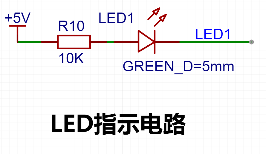

6. LED Indicators:
This project includes an additional power indicator and an I/O operation indicator.
LD_PWR is the power indicator
image.png. Since chip I/O often has a greater current sinking capability than a current pulling capability, LED1 is designed to be active low (on).
To reduce LED current consumption, some LED brightness is sacrificed, and the number of component parameters is reduced; the LED current-limiting resistor is chosen to be 10K.

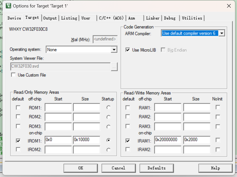

Regarding the code,
this code was tested using the ARM V6 compiler. If you
're used to V6 like me, you can download this directly.

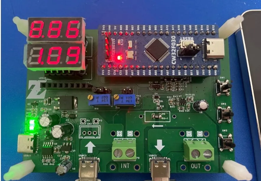

Voltmeter and Ammeter (Training Camp) Replica

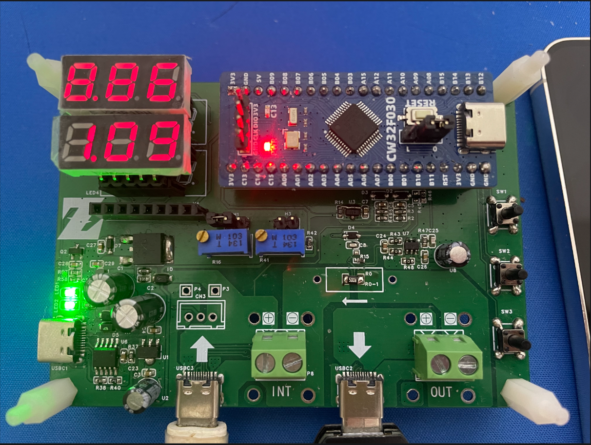

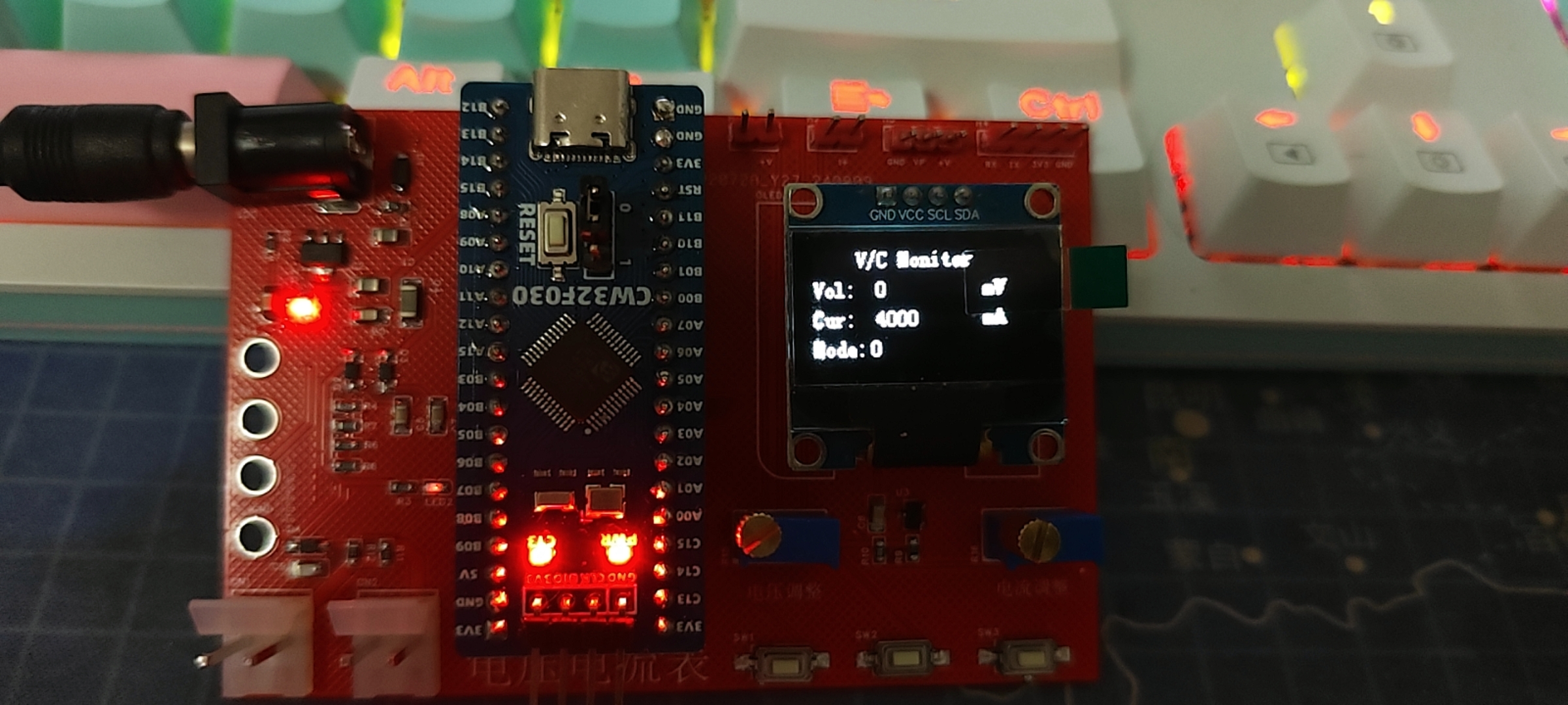

The voltage and current meters made by participants in the LCSC training camp
The voltage and current meter I built in the LCSC training camp was a successful replica overall, but it had many flaws in the details. For example, the 3D-printed shell and circuit board didn't align properly, and I didn't read the documentation carefully beforehand, which caused me some trouble (but the documentation and hardware explanation videos are definitely worth studying).
Hardware-wise:
The project was developed based on the ARM® Cortex®-M0+ 32-bit microcontroller CW32F030 series, which boasts powerful computing capabilities and rich peripheral integration. This series of microcontrollers features 64KB of embedded FLASH and 8KB of SRAM, supports a main frequency of up to 64MHz, and has a wide voltage support range (1.65V to 5.5V), enabling stable operation in harsh environments (-40℃ to 105℃). The microcontroller also integrates various peripherals, such as a 12-bit high-speed ADC (analog-to-digital converter), advanced PWM timers, general-purpose timers, and rich communication interfaces (I2C, UART, and SPI), meeting the needs of various sensor data acquisition and control. The hardware design employs low-power modes (Sleep and DeepSleep) to enable the system to enter a low-power state when not in use, improving overall energy efficiency. In terms of pin configuration, the system supports up to 39 I/O interfaces, all configurable as interrupt inputs, flexibly adapting to various peripheral control needs. Furthermore, the internally integrated CRC hardware calculation unit can efficiently verify the integrity of data transmission, enhancing system reliability.
Software-wise
, based on the CW32F030 series microcontroller, it adopts a standard embedded development framework, with a focus on modularity and scalability in program design. For the bootloader, the system supports firmware upgrades and flashing via the UART interface, facilitating subsequent functional expansion and maintenance. The software architecture follows interrupt priority management, utilizing a nested vector interrupt controller (NVIC) to ensure efficient and non-blocking processing of multiple interrupt sources. Additionally, through a direct memory access (DMA) controller, the system can achieve high-speed data transfer between peripherals and memory without CPU intervention, significantly improving system response speed and performance. To ensure data security and consistency, the program employs hardware-supported CRC check technology during data processing, further enhancing communication reliability. The software also implements sampling and processing of multi-channel ADCs, and combines RTC clock to realize timed data acquisition and recording functions, providing a solid foundation for real-time monitoring and control of key parameters such as voltage and current.

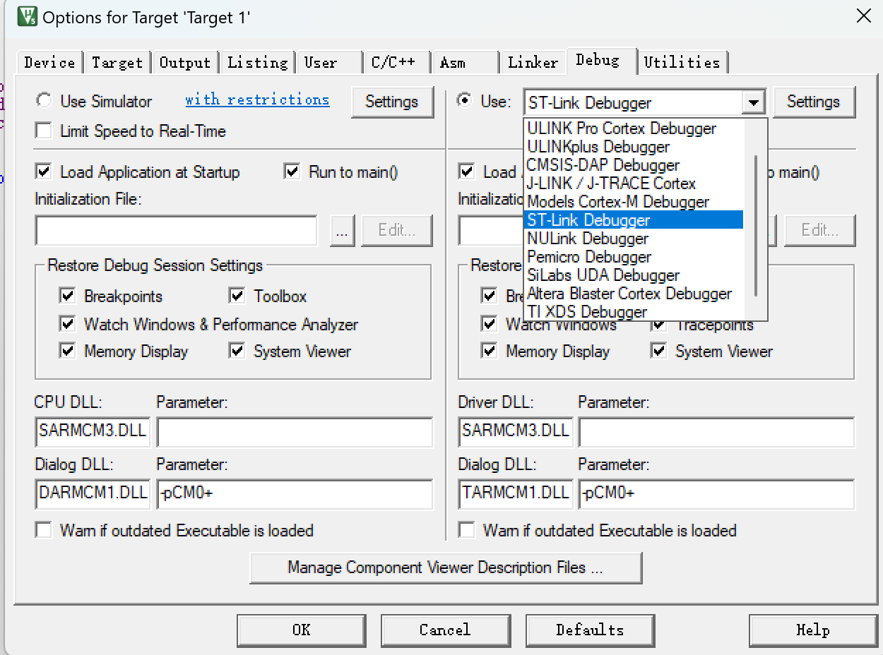

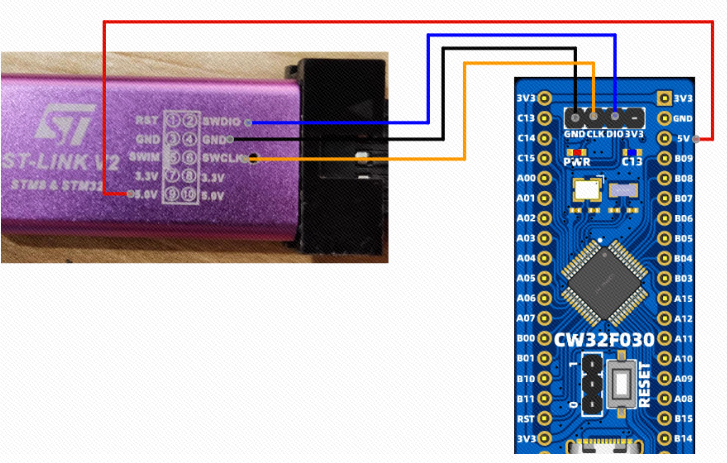

This project uses ST-LINK to connect to the development board.
Software configuration selects the appropriate burning method.

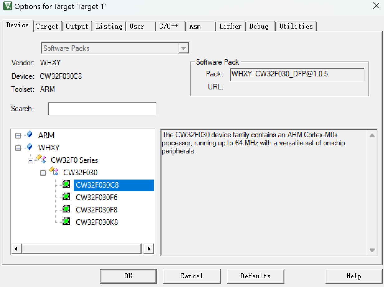

1. Environment:
Keil Community Edition download link: https://www.keil.arm.com/mdk-community/
Activation is only required under the website's guidance; no login is needed (I spent most of the day trying to log in and was still stuck on the login page).
2. Tolerance issue of the banana head :
Please pay close attention when drawing the banana head (the publicly available information may not be accurate; this is a lesson learned the hard way, and it has now been changed).
Note: The tolerance of the banana head in this project is an outer diameter of 7.5mm and a hole diameter of 4mm.
Optimization:
1. Resistor value optimization: The resistance value of R27 (originally 220K) can be changed to 200K for more accurate measurement and to save on components (R28 is also 200K).
Due to different wiring and component placement,
the placement of the digital tube is explained below (LD1 below, LD2 above).
The digital tube display reads from bottom to top.
Note:
JP2 must be shorted (connect the shorting cap).
Since I do not have an adjustable power supply, I can only adjust the potentiometer (R34), which is similar to changing the voltage division ratio to change the voltage value. The multimeter and digital tube change with the potentiometer rotation (verified).
The software needs to be modified (the uploaded version has been modified, original: 220).
If the program cannot be burned, please select the corresponding kernel. All compilation program warnings can be ignored.
If you still cannot download, please refer to the technical document, Software Design - 3.2 Development Environment Setup.
The video demonstration shows a six-digit display current channel for voltage acquisition and display (error is within a controllable range, normal (not yet calibrated - Experiment Nine)). (Starting from Experiment 8, an external adjustable voltage source is required (for measuring current (I-)), which has not yet been verified (the others have been verified - the main body is complete). Does anyone have recommendations?)
I'm a beginner, so please correct me if there are any problems. Thank you in advance. Please be careful when copying this!
I would also appreciate any valuable feedback from experts on my circuit design (it's really important to me). Thank you!
