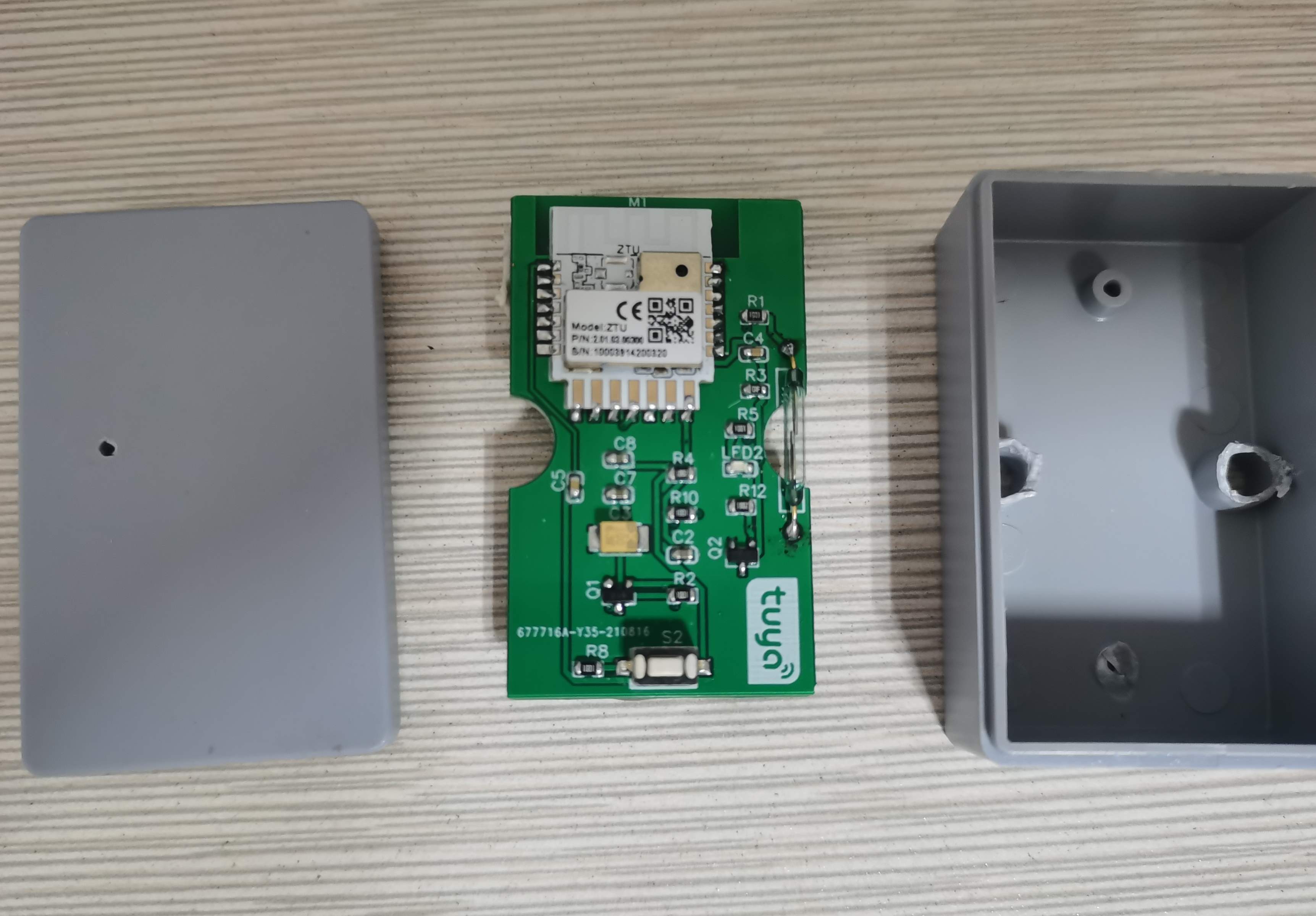

This project uses Tuya’s development-free solution to realize the door sensor design. Hardware only requires common resistors and capacitors + modules. With cheap shell, development cost is zero!
Engineering features:
1. Zigbee uses Tuya ZTU module, which can be freely configured without development;
2. The status indicator light shows the trigger status;
3. Buttons can be used for network distribution.
Note: This access control requires a Tuya smart Zigbee gateway to be used.
Standby status:
CR2032 battery powered, measured monthly power consumption is about 20% ;
Just enough to fit into the shell of a certain treasure:
The opening position is a million points off~
