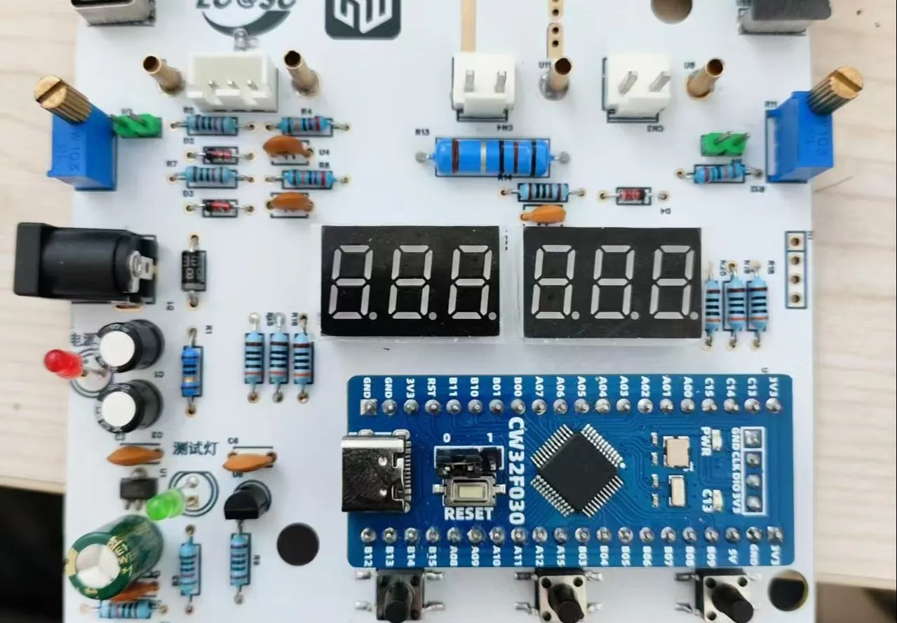

1. Power Supply Circuit
ADC means converting continuous analog signals into digital signals, providing the possibility for digital processing and analysis. ADCs play an important role in signal conversion, measurement and data acquisition, control system input, and communication and signal processing. Their widespread application promotes the intelligent and precise control of electronic equipment in various industries and is one of the key factors driving modern technological progress.
Voltage and current are calculated through ADC sampling.
This project, like the official project, adopts a core board plus expansion board design concept, using plug-in components to simplify learning and deepen exploration.
The core board uses the domestic Wuhan Xinyuan Semiconductor CW32 as the main controller, while also being compatible with other similar development boards; however, the CW32 has advantages.
The project is highly comprehensive and practical, and after completion, it can be used as a desktop instrument.
For the power supply circuit, we use a DC connector, the same as the official one. However, I added terminal blocks and Type-C input/output to measure the voltage and current of the Type-C connector and the terminal blocks. For the
Type-C input/
output terminal blocks and
LDO (Low Dropout Linear Regulator) selection, this project uses an LDO as the power supply. Considering that most voltmeter products are used in industrial scenarios with 24V or 36V power supplies, this project selected the SE8550K2, which has a maximum input voltage of up to 40V. The main reason for not using a DC-DC buck converter to handle the large voltage drop is to avoid introducing DC-DC ripple interference during the design process; a secondary reason is to reduce project costs.

3. Voltage Sampling Circuit:
The voltage divider resistors in this project are designed as 220K+10K, therefore the voltage division ratio is 22:1 (ADC_IN11).
The voltage divider resistor selection
is for the maximum measured voltage; for safety reasons, this project uses 30V (the actual maximum display can be 99.9V or 100V).
The ADC reference voltage is 1.5V in this project, and this reference voltage can be configured through the program.
To reduce the power consumption of the sampling circuit, the low-side resistor (R7) is usually chosen as 10K based on experience.
Then, the high-side resistance of the voltage divider resistor can be calculated using the above parameters.
The required voltage division ratio is calculated, i.e., the ADC reference voltage. The input voltage is designed; using known parameters, 1.5V/30V = 0.05 can be calculated.
The high-side resistance is calculated as the low-side resistance/voltage division ratio; using known parameters, 10K/0.05 = 200K can be calculated.
A standard resistor is selected: a resistor slightly higher than the calculated value of 200K is chosen. We usually choose E24 series resistors; therefore, in this project, 220K, which is greater than 200K and closest to the calculated value, is selected.

4. Current sampling circuit:
The official design specifies a sampling current of 3A, and the selected sampling resistor (R0) is 100mΩ. I directly replaced it with a 2W resistor, which will have a larger measurable range.
5. Digital tube display:
I used a 0.36-inch digital tube that I had already purchased, which is cheaper. 5 for 2 yuan.
