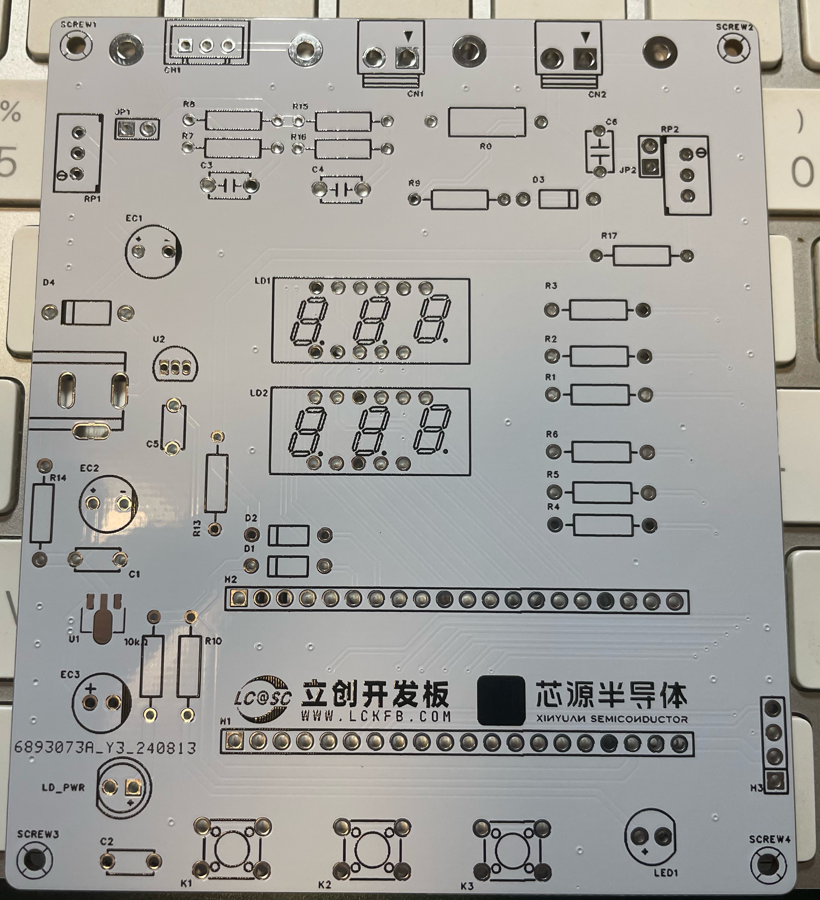

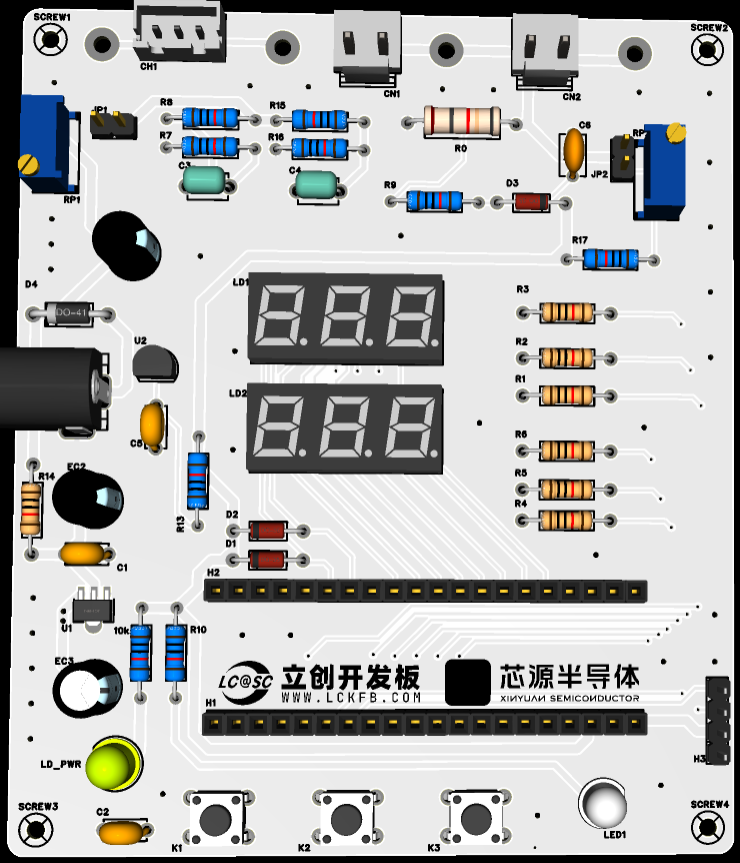

PCB Finished Product 3D Rendering:

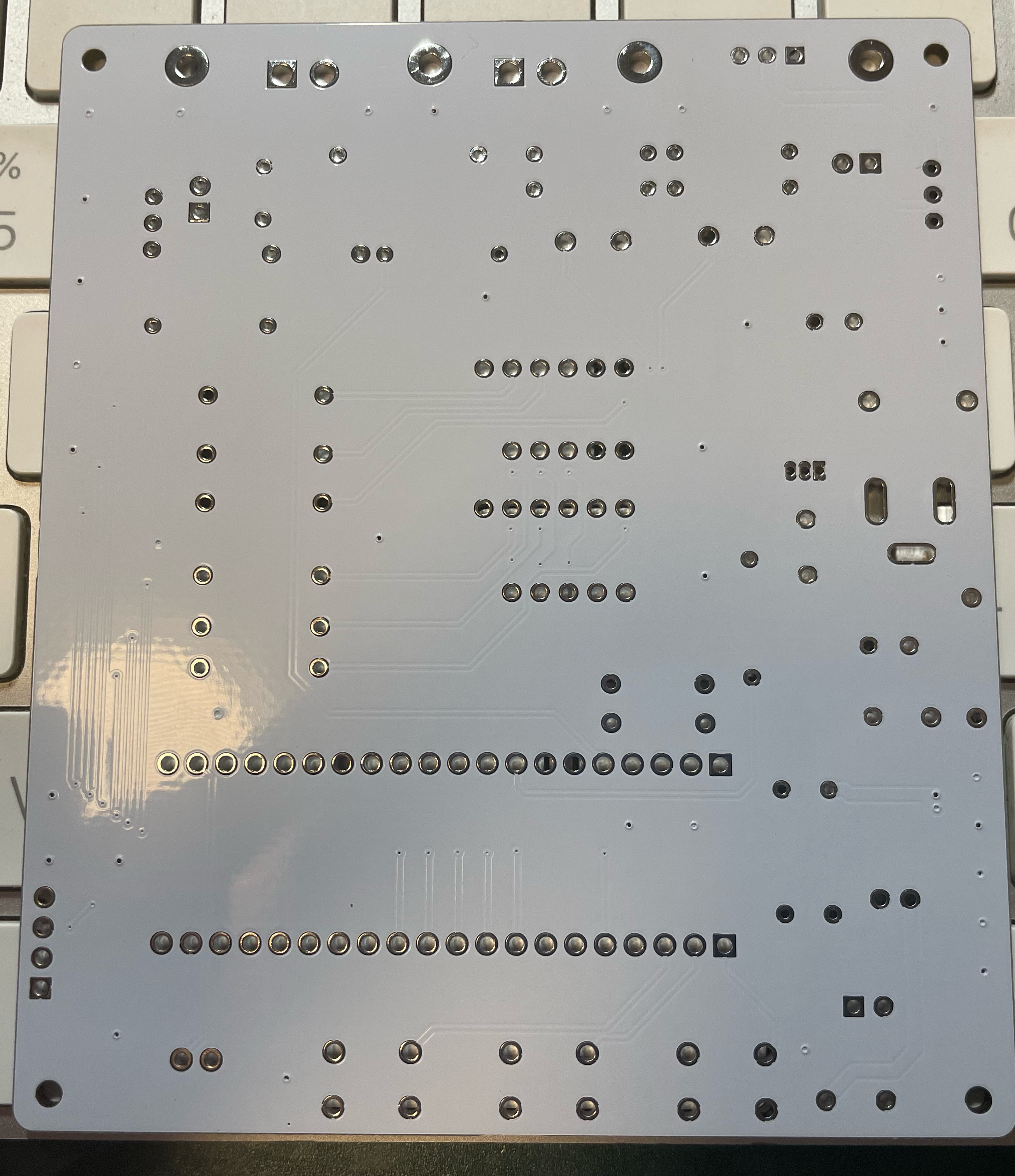

The PCB board just unpacked:

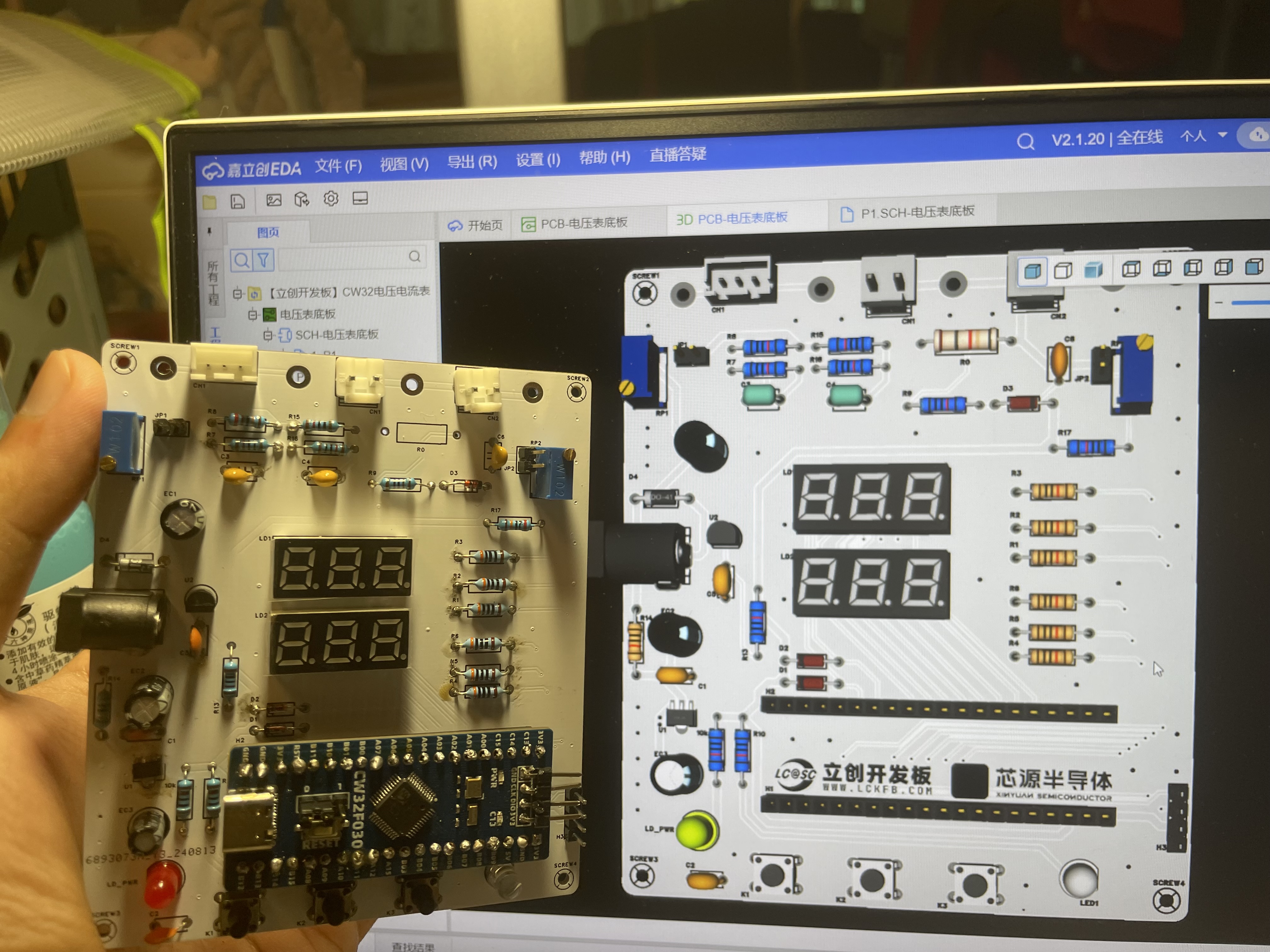

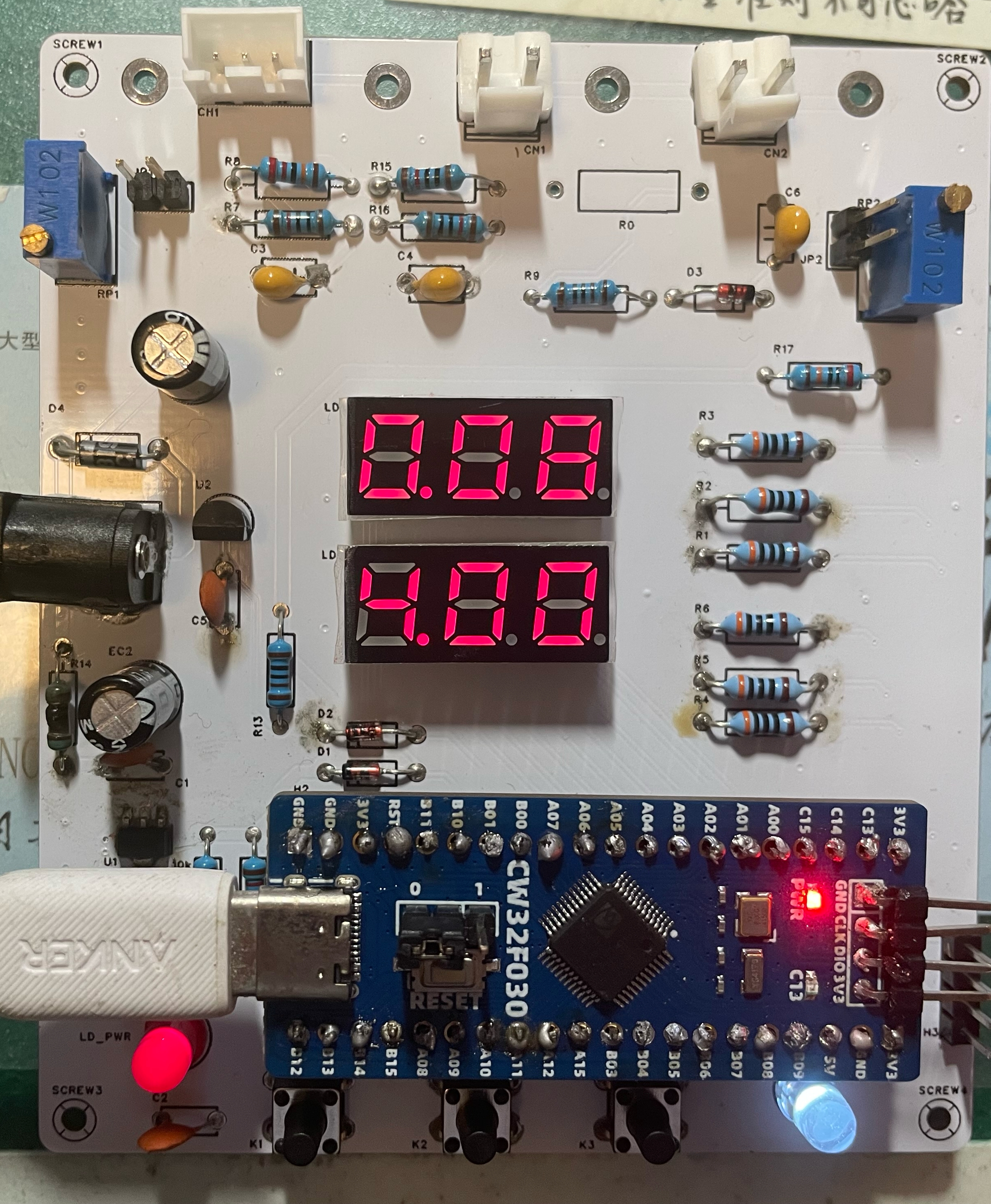

Comparison of the actual product and the 3D rendering after soldering:
As you can see, since almost all components are through-hole, it is quite user-friendly for a soldering novice like me.

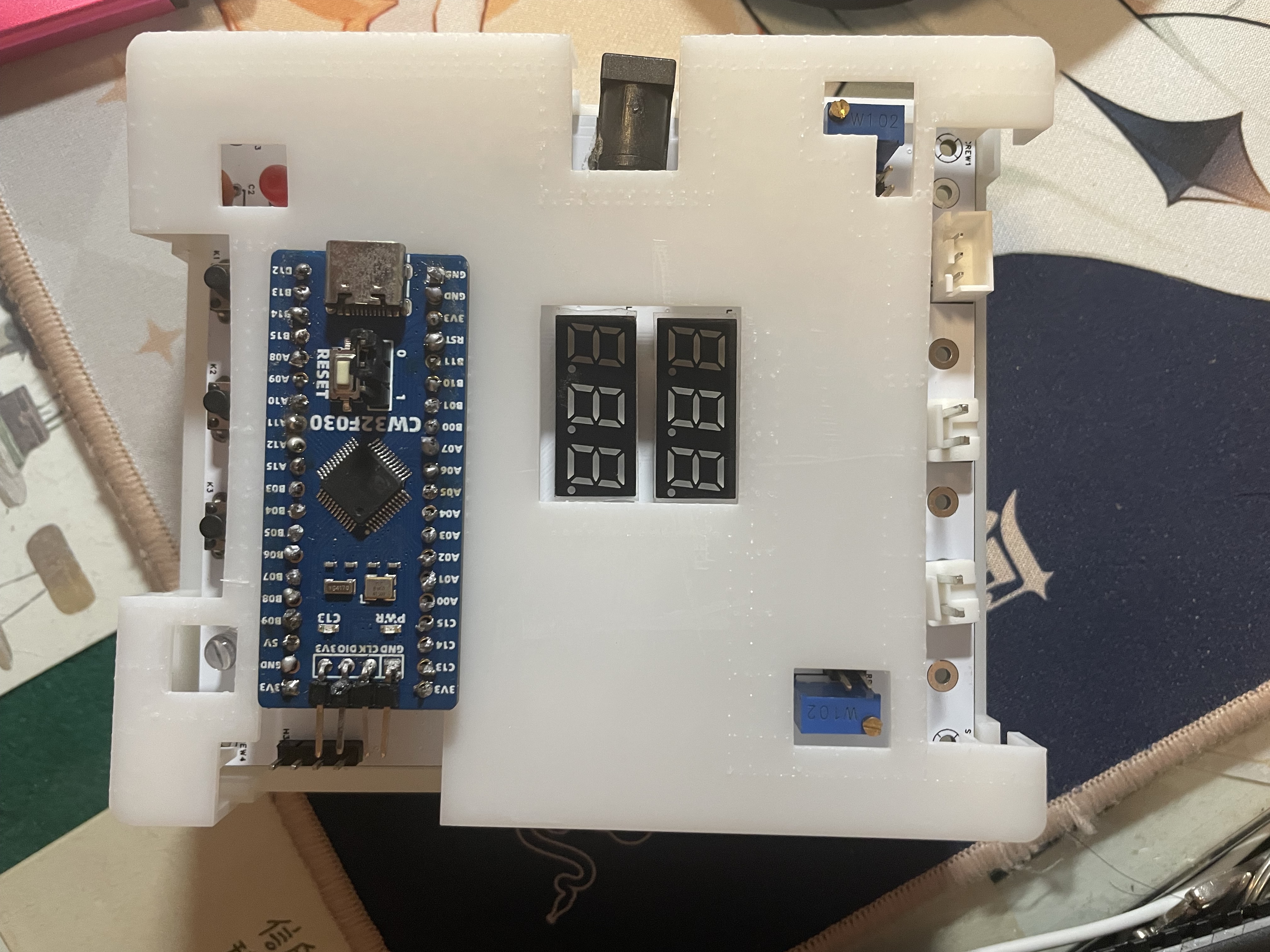

Housing Installation Demonstration:
Some issues can be found in the housing design; excessive holes significantly reduce the housing's strength. This must be considered in future housing designs.

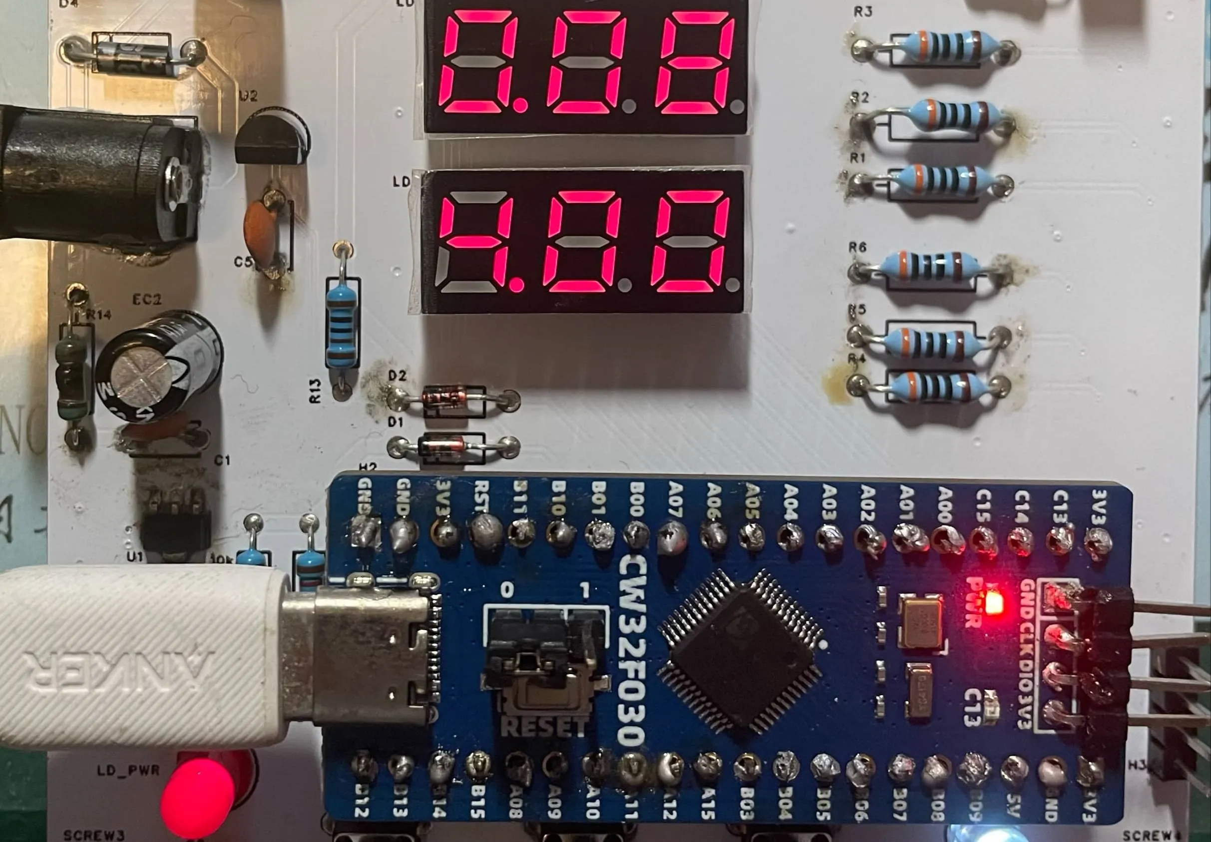

Power-On Demonstration:
Currently, due to being away from the campus, some necessary debugging equipment is lacking. I will further complete and improve these issues after returning to campus.
