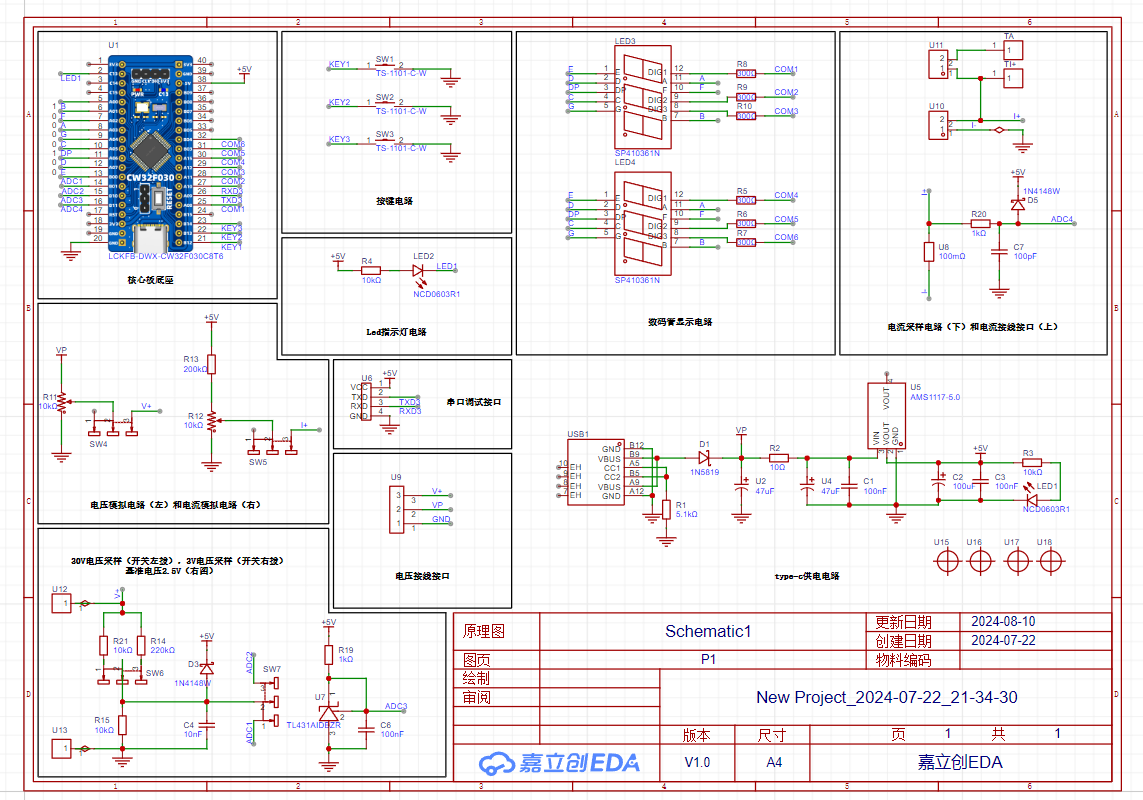

II. Hardware Design

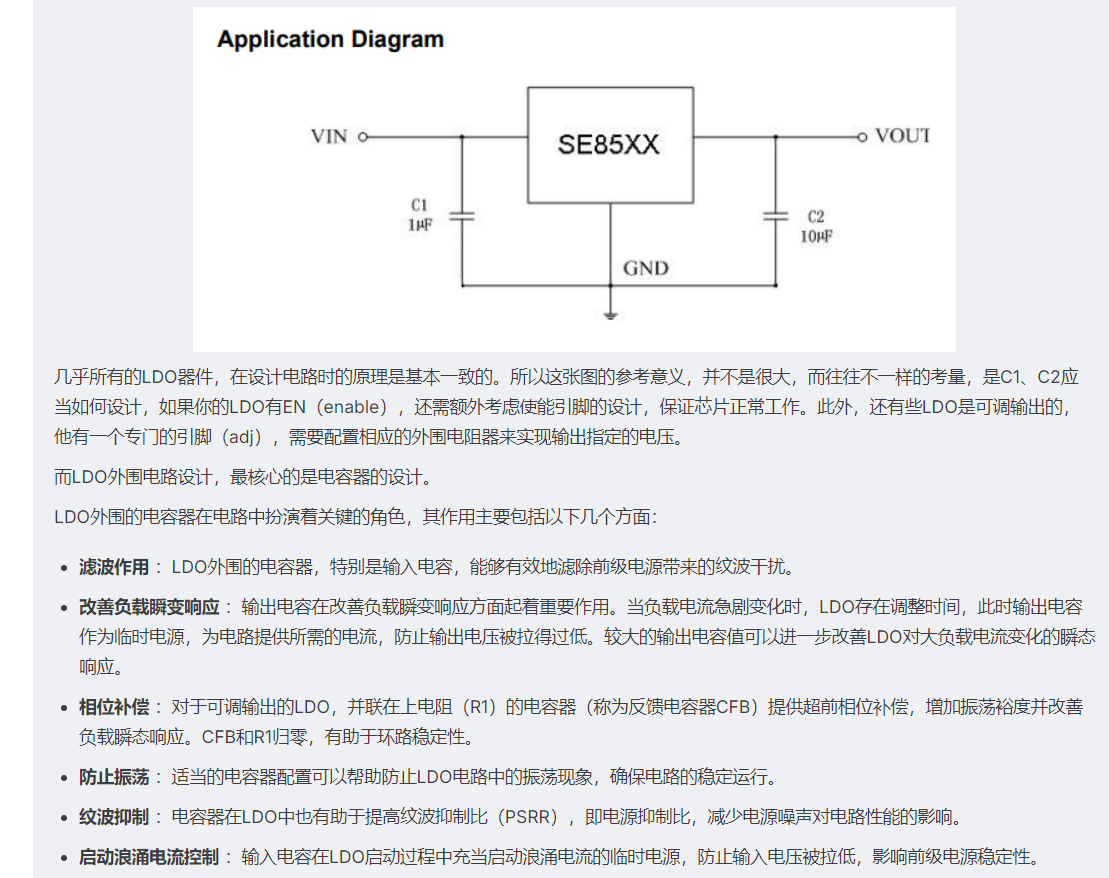

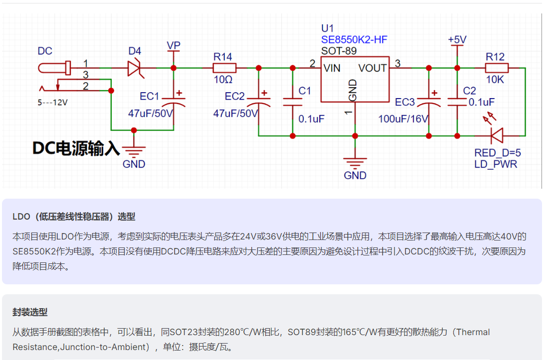

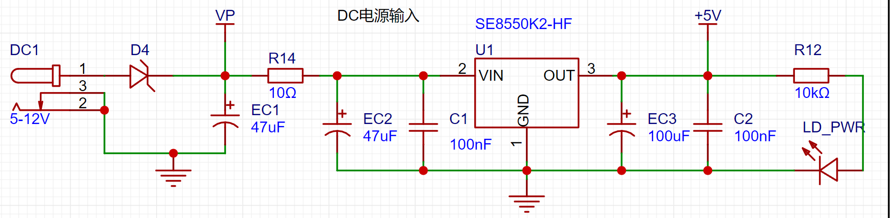

1. Power Supply Circuit
LDO (Low Dropout Linear Regulator) Selection

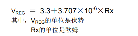

This project uses an LDO as the power supply. Considering that most voltmeter products are used in industrial scenarios with 24V or 36V power supplies, the SE8550K2 with a maximum input voltage of up to 40V was selected as the power supply. The main reason for not using a DC-DC step-down circuit to handle the large voltage drop is to avoid introducing DC-DC ripple interference during the design process, and the secondary reason is to reduce project costs.

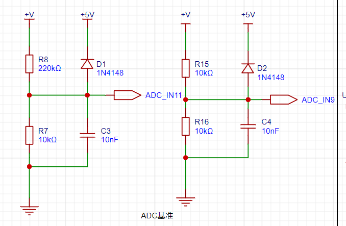

3. Voltage Sampling Circuit:
The voltage divider resistors in this project are designed as 220K + 10K, therefore the voltage division ratio is 22:1 (ADC_IN11).
Voltage Divider Resistor Selection
: 1. The maximum value of the design measurement voltage: For safety reasons, this project uses 30V (the actual maximum display value can be 99.9V or 100V);
2. ADC reference voltage: In this project, it is 1.5V, which can be configured through the program;
3. Power consumption: To reduce the power consumption of the sampling circuit, the low-side resistor (R14) is usually selected as 10K based on experience;
then the high-side resistance of the voltage divider resistor can be calculated using the above parameters:
1. Calculate the required voltage division ratio: i.e., ADC reference voltage: design input voltage. Using known parameters, 1.5V/30V = 0.05
2. Calculate the high-side resistance: i.e., the low-side resistance / voltage divider ratio. Using the known parameters, we can calculate 10K / 0.05 = 200K.
3. Select a standard resistor: Select a resistor with a value slightly higher than the calculated value. The calculated value is 200K. We usually choose E24 series resistors. Therefore, in this project, we choose 220K, which is greater than 200K and the closest.
If, in practical use, the voltage to be measured is lower than 2/3 of the module's design voltage (66V), the voltage divider resistor can be replaced and the program modified to improve measurement accuracy. An example is provided below:
1. Assume the measured voltage is no higher than 24V, and other parameters remain unchanged
. 2. Calculations show 1.5V/24V = 0.0625, 10K/0.0625 = 160K. 160K is a standard E24 resistor and can be directly selected, or a higher value 180K can be chosen with some redundancy.
If, in practical use, the voltage to be measured is higher than the module's 99V design voltage, the voltage divider resistor can be replaced, or the reference voltage can be modified to achieve a larger voltage measurement range. An example is provided below:
1. Assuming the measured voltage is 160V, the solution is to increase the voltage reference to expand the measurement range.
2. Given that the voltage division ratio of the selected resistor is 0.0145, we can calculate 160V * 0.0145 = 2.32V using the formula. Therefore, we can choose a 2.5V voltage reference to expand the measurement range (expanding the measurement range will reduce accuracy).
Considering the potential fluctuations in the measured power supply, a 10nF filter capacitor was connected in parallel with the low-side voltage divider resistor in the circuit design to improve measurement stability.

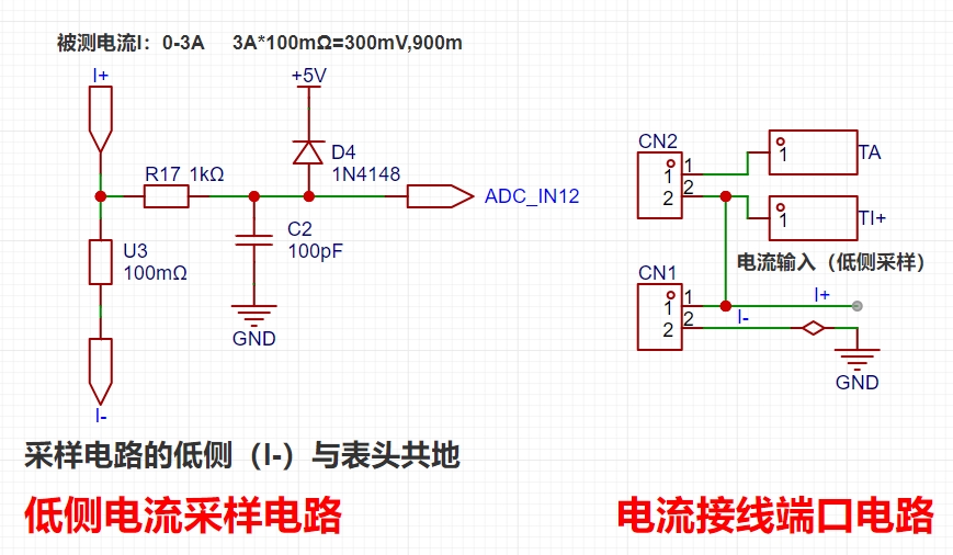

4. Current Sampling Circuit
This project uses a low-side current sampling circuit for current detection. When learning the low-side of the sampling circuit and the development board's meter interface
, please do not solder U3!!!
The design analysis
for this project involves a sampling current of 3A, and the selected sampling resistor (U3) is 100mΩ.
The following aspects should be considered when selecting the sampling resistor:
1. The maximum value of the pre-designed measurement current, which is 3A in this project
. 2. The voltage difference introduced by the current sensing resistor; it is generally not recommended to exceed 0.5V.
3. The power dissipation of the current sensing resistor; a suitable package should be selected based on this parameter. Considering the power dissipation (temperature) issue under high current, a 1W metal wire-wound resistor was selected in this project.
4. The voltage amplification factor across the current sensing resistor: No operational amplifier is used in this project to build an amplification circuit, so the factor is 1.
The current sensing resistor value can then be calculated using the above parameters.
1. Since this project does not use an amplifier circuit, a larger sampling resistor is needed to obtain a higher measured voltage for measurement.
2. Considering that a larger resistor would result in a larger voltage drop and higher power consumption, an unlimited selection of a larger resistor is not advisable .
3. This project uses a 1W package resistor, corresponding to a power consumption of 1W. Based on the
above data, a 100mΩ current-sensing resistor was chosen. According to the formula, 3A * 100mΩ = 300mV, 900mW.
To handle different operating environments, especially high-current scenarios, resistor U3 can be replaced with constantan wire or a shunt. The appropriate alternative can be chosen based on the specific application scenario. For safety and educational purposes, this project will not discuss measurements exceeding 3A, but the principle remains the same.

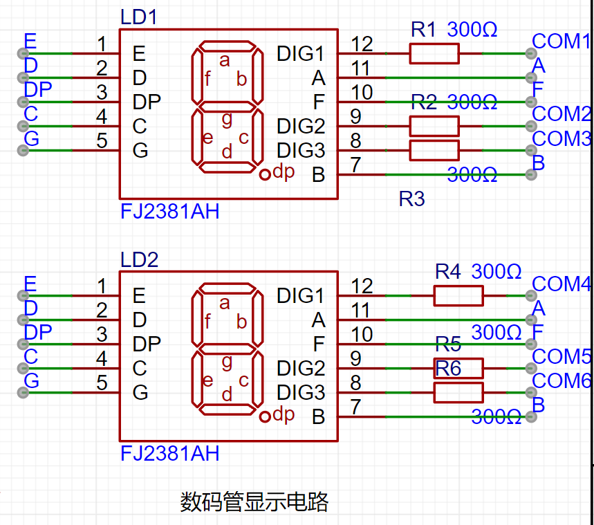

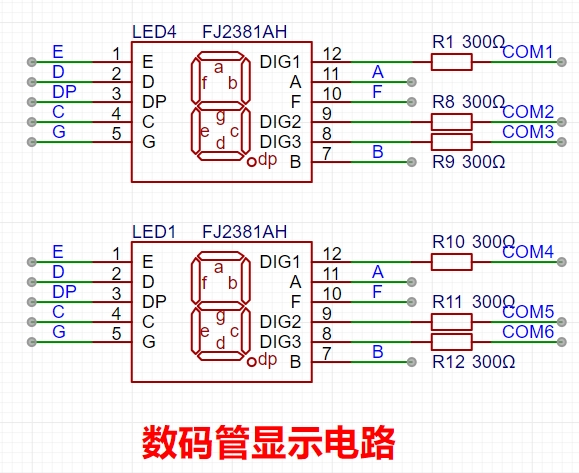

5. Digital Tube Display:
This project uses a digital tube as the display unit.
This project uses two 0.28-inch three-digit common-cathode LED displays as the display device. Compared to a display screen, LED displays offer better visibility in complex environments. The brightness of the LED displays can be increased by using smaller current-limiting resistors, depending on the specific needs of the application environment. Furthermore, LED displays have better mechanical properties and are not as easily damaged by external forces as display screens. They are widely used in industrial applications where stability and reliability are crucial. From a development board learning perspective, this makes it easier to learn electronic measurement principles and related development in a targeted manner.
In this project, actual testing showed that configuring the current-limiting resistors (R1, R8~R12) of the LED displays at 300Ω resulted in good visibility for both red and blue LED displays, with a soft and non-glaring brightness.
Strictly speaking, the current-limiting resistors should be added to the segments; adding them to the digits would affect the display effect. Our design places them in the digits to save a few resistors, but the impact on the display is not significant. Therefore, we add them to the digits for convenience.
The driving principle of LED displays mainly involves controlling the switching state of each segment to display numbers, letters, or symbols. The following is a detailed explanation of the driving principle:

This project actually uses dynamic scanning display to drive the digital tube.
Let's estimate the current required for the digital tube.
This project actually uses dynamic scanning to drive the digital tube, so at any given time, only a maximum of 8 segments of the digital tube (or LEDs) can be lit, or in other words, only one segment can be lit. According to the design, the required driving current is approximately 11mA, which is the high-level voltage of the IO port 3.3V ÷ 300Ω.
At this point, it is important to ensure that the selected MCU has sufficient current sinking/pull-up capability.
Analysis of the datasheet shows that the CW32 has no problem. (Some chips are not suitable.)

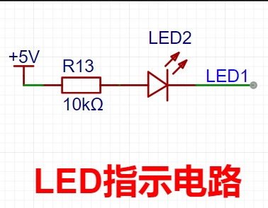

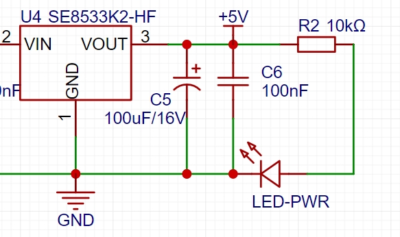

6. LED Indicator
This project additionally designed a power indicator and an IO working indicator.
LED_PWR is the power working indicator .
Since the chip I/O often has a greater current sinking capability than a current pulling capability, LED1 is designed to be active low (on).
To reduce the current consumption of the LED, some LED brightness is sacrificed, the types of component parameters are reduced, and the current limiting resistor for the LED is selected as 10K.

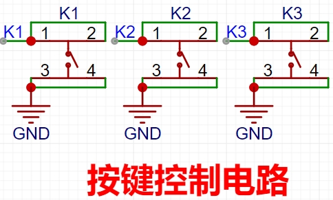

7. Button Circuit Design
There are various ways to design the button control circuit. Thanks to the fact that the CW32's I/O port can be configured with pull-up and pull-down resistors internally, the button control circuit on the outside of the chip does not need to be configured. One end of the button is connected to the MCU's I/O, and the other end is grounded. When the button is pressed, the I/O is pulled low.

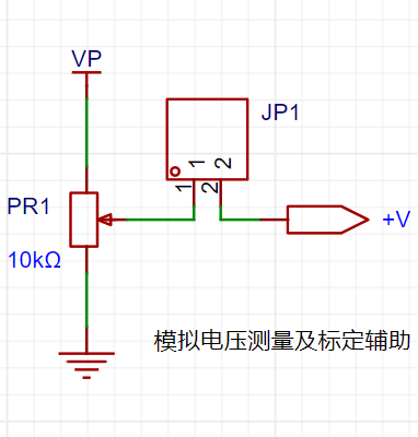

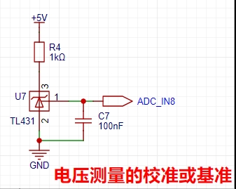

8. TL431 Circuit Design for Voltage Measurement and Calibration
This project adds an extra TL431 circuit to provide a 2.5V reference voltage, which can be used to provide an external voltage reference for the chip to calibrate the AD converter. From a product design perspective, due to the inherent ADC performance advantages of the CW32, this circuit is not necessary. This circuit is designed on the development board to learn the relevant application principles.
The TL431 is a relatively "old" device, very classic, and widely used; it is still found in many electronic products.
Many beginners may be encountering this device for the first time, so we will briefly explain the principles of this product to help everyone better apply the TL431.
TI defines it as a precision programmable reference. On the first page of the references, we can focus on several key characteristics.
Precision: Precision indicates that its output voltage is very accurate. I used a TL431 with ±0.5% accuracy, and the measured voltage on the board at room temperature was 2.495V. Compared to common Zener diodes, the accuracy is vastly different. In application circuit diagrams, the TL431 is internally represented by a Zener diode symbol.
Adjustable output voltage: The adjustable output voltage is between Vref and 36V. In our project, we use the output Vref voltage, which is approximately 2.5V. Therefore, we use 2.5V in the description, which is approximately equal to the actual voltage.
Sinking current capability: This refers to how much current the output voltage pin can provide, which is greatly related to the resistance value (R4) in the application circuit. It should not be less than 1mA. If there is no need for sinking current, do not design the current to be too high, causing unnecessary power consumption.

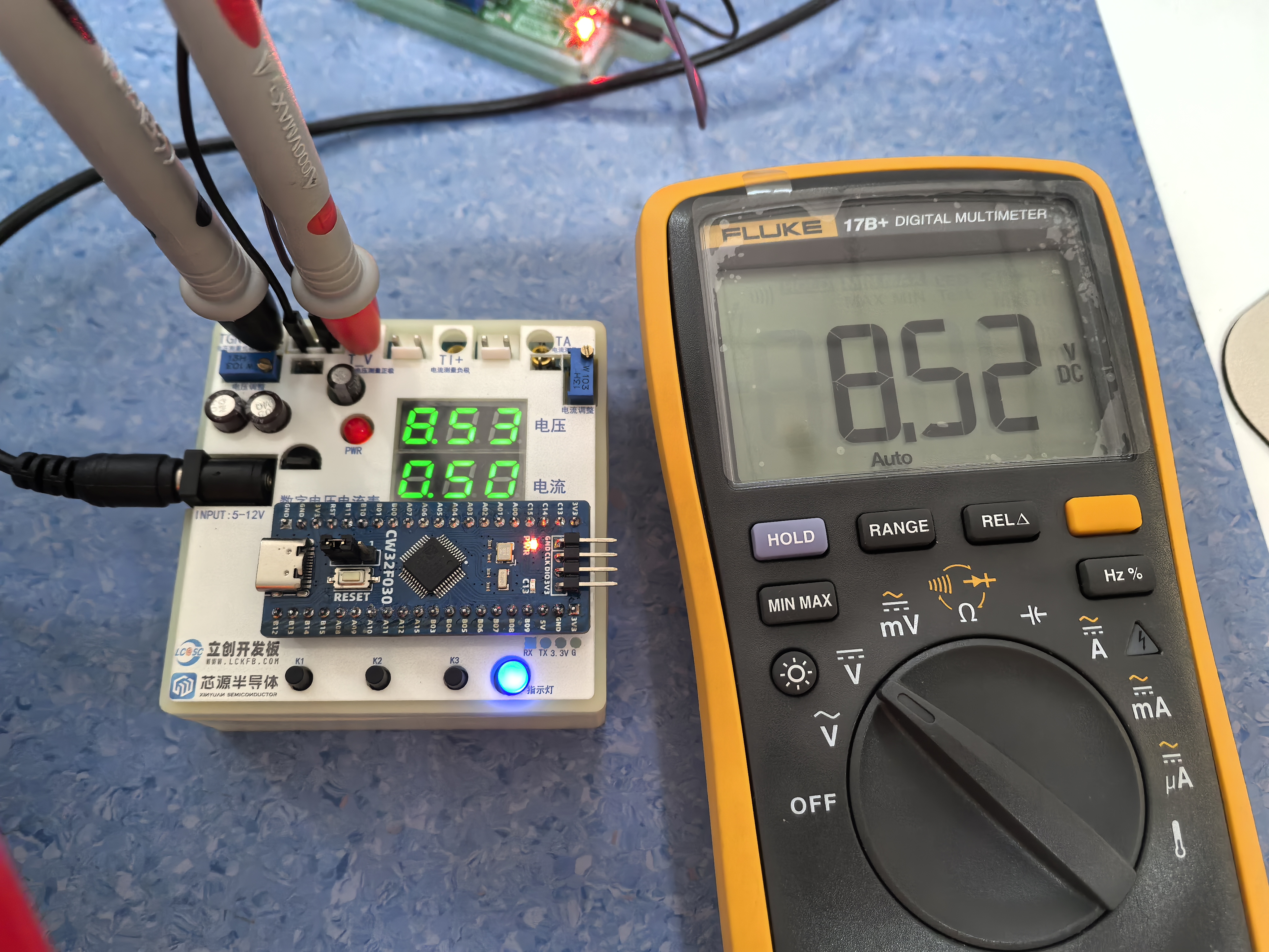

III. Demonstration Video

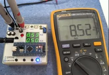

: The video only demonstrates voltage measurement; current was not measured because a matching resistor was unavailable, and I was too lazy to select another one. However, it should be fine...

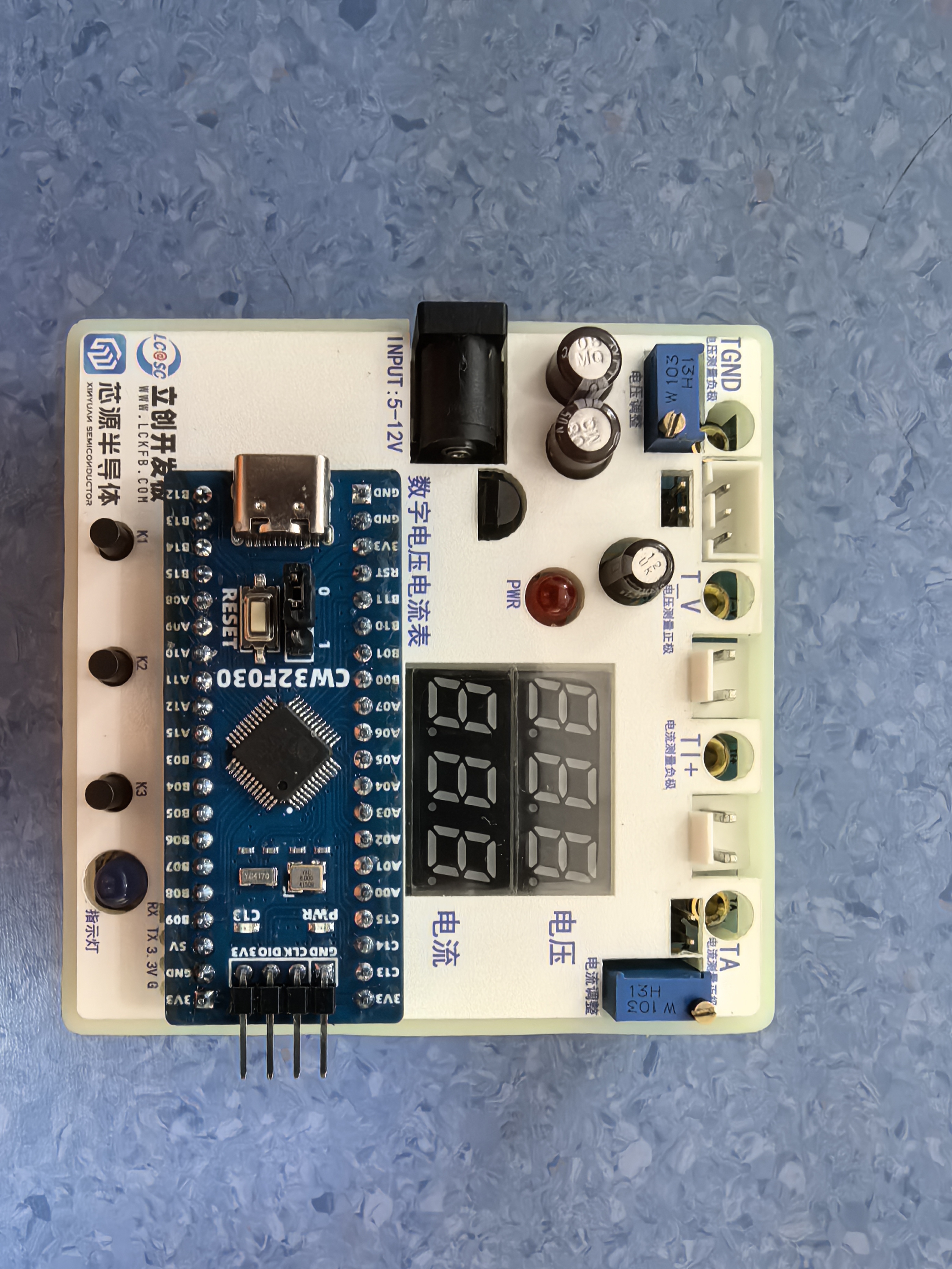

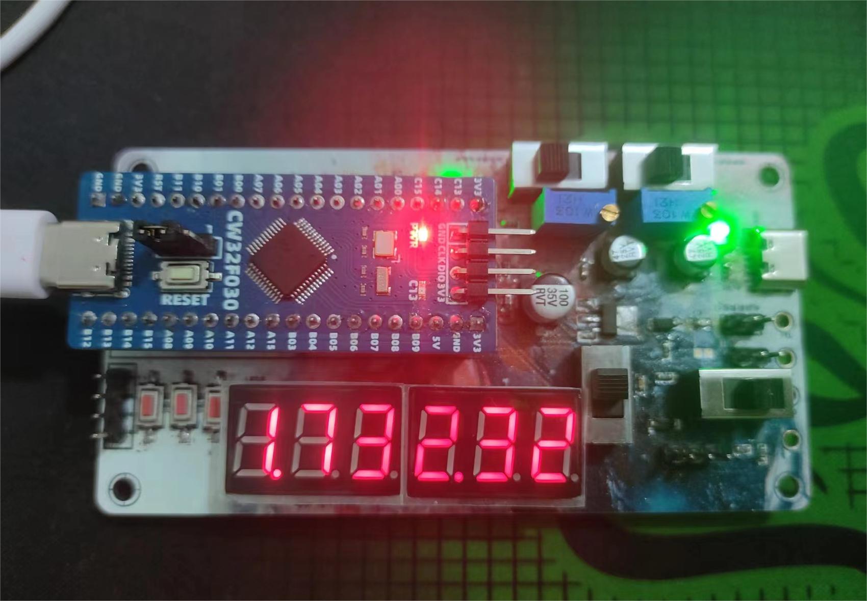

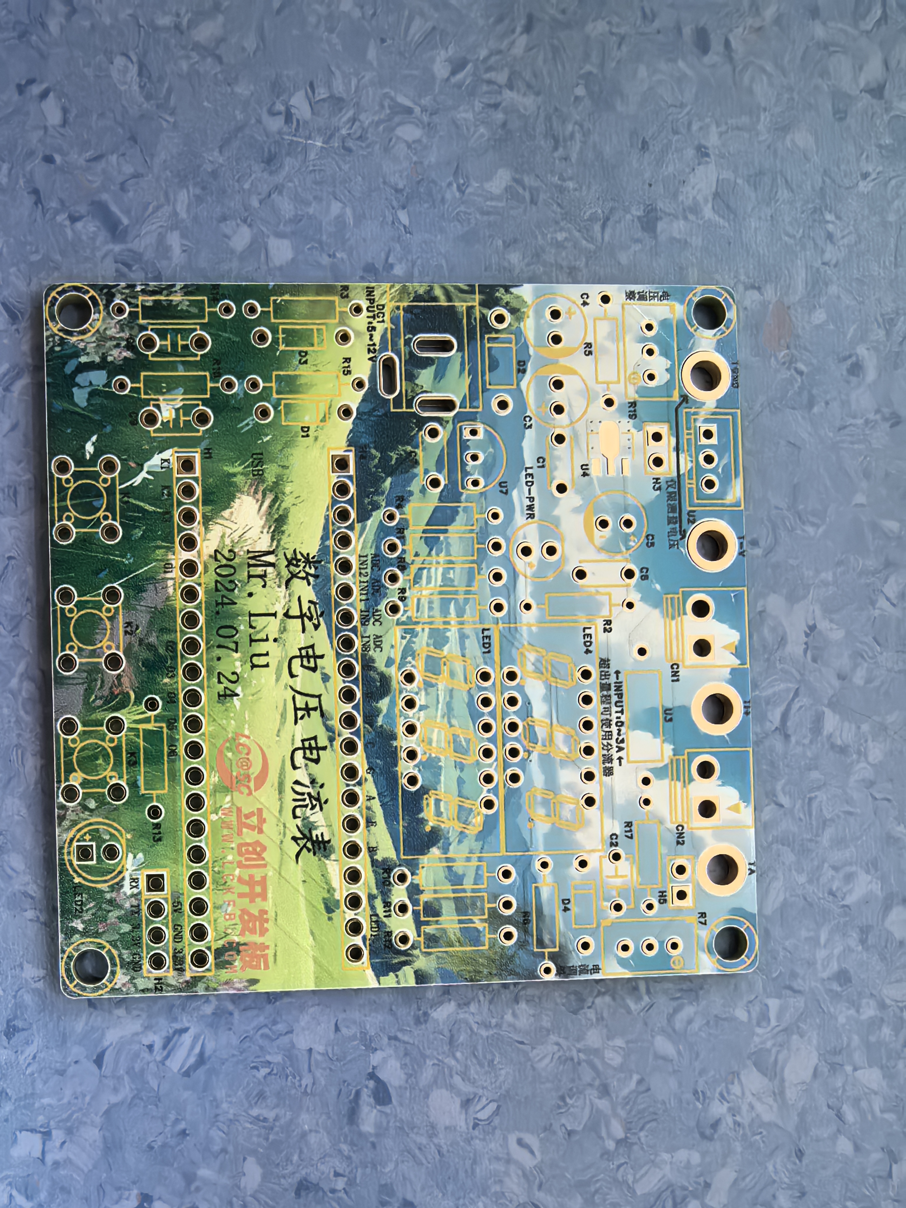

V. Physical Demonstration
11dab27a7eb72d12a9bedaf35391e57f.mp4
Modified Panel_Panel_1_2024-08-20.epanm

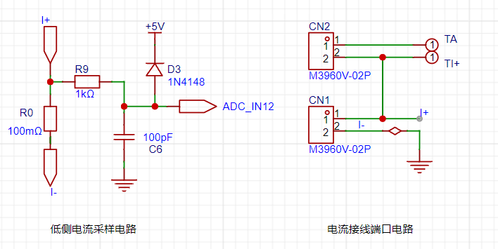

3. Current Sampling Circuit:
The sampling current designed for this project is 3A. The selected sampling resistor (R0) is 100mΩ.
The following aspects need to be considered when selecting the sampling resistor:
. 2. The voltage difference caused by the current sensing resistor; it is generally not recommended to exceed 0.5V
. 3. The power consumption of the current sensing resistor; a suitable package should be selected based on this parameter. This project takes into account 4. The power consumption (temperature) issue at high current, and a 1W metal wire-wound resistor was selected.
5. The voltage amplification factor across the current sensing resistor: No operational amplifier was used to build the amplification circuit in this project, therefore the factor is 1.

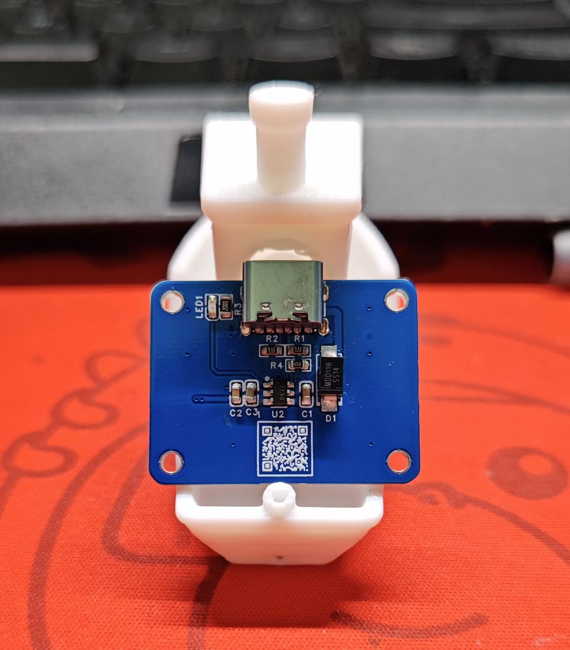

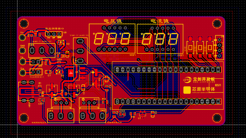

Physical Diagram,
Schematic Diagram
, PCB
Diagram,

Core Hardware Circuit Analysis: LDO
: The above power supply circuit can receive 5-12V DC power. A diode is added to prevent reverse connection of the power supply. Afterwards, the input DC power undergoes multiple filtering (high frequency and low frequency) through capacitors. Then, an LDO linear regulator converts the input 5-12V power supply into a stable 5V output, providing the power foundation for the other circuits.
The VP mentioned above does not pass through a linear regulator, so the voltage at this point is actually equal to the input voltage. Connecting this VP to the top regulator, and using different jumper connections, we can directly read the voltage at this point using only the ADC. This facilitates testing of
the top-adjustment voltage
measurement circuit. The voltage measurement circuit
uses a voltage divider resistor to perform a voltage division (22:1), allowing its ADC to acquire the voltage from 0 to vref. The original voltage can then be obtained through calculation.
Current Measurement Circuit
Design Analysis:
The sampling current designed for this project is 3A, and the selected sampling resistor (R0) is 100mΩ.
The selection of the sampling resistor mainly needs to consider the following aspects:
the maximum value of the pre-designed measurement current, which in this project is a 3A
current sensing resistor. It is generally not recommended to exceed 0.5V.
The power consumption of the current sensing resistor should be selected according to this parameter. Considering the power consumption (temperature) problem under high current, a 1W packaged metal wire-wound resistor was selected in this project
. The voltage amplification factor of the current sensing resistor: No operational amplifier was used to build the amplification circuit in this project, so the factor is 1.
Then, the current sensing resistor value can be calculated using the above parameters. Selection:
Since This project does not use an amplifier circuit, therefore a larger sampling resistor is needed to obtain a higher measured voltage for measurement.
Considering that a larger resistor will result in a larger voltage drop and higher power consumption, an unlimited selection of a larger resistor is not possible.
Based on the above data, a 100mΩ current sensing resistor was selected. According to the formula, 3A * 100mΩ = 300mV, 900mW can be calculated.
To cope with different usage environments, especially high current scenarios, the R0 resistor can be replaced with constantan wire or a shunt. The replacement can be chosen according to the actual usage scenario. For safety and educational purposes, this project will not discuss measurements exceeding 3A, but the principle is the same. The current project uses
a digital tube display circuit
. After reading the ADC data, it is displayed on the digital tube, allowing the user to intuitively see the test results. I accidentally broke a CW32 pad, causing the A segment of the digital tube to malfunction. However, this does not actually affect usage. If a new CW32 is replaced, it will work normally.
One more thing to note is that the pin headers on my CW32 currently need to be soldered upwards. This is because I mistakenly reversed the pin header sockets during circuit board design. Because I accidentally removed the pads controlling segment A of the digital display while removing the pin headers, segment A did not display in the actual demonstration, but the project itself is correct.
Please refer to the project file developed by LCSC; most of my code is copied from it.

CW32 Voltmeter and Ammeter Training Camp Project
1. Project Function Introduction:
This is a voltage and current meter designed based on the LCSC CW32F030C8T6 development board. It can collect and display voltage and current, and has reserved interfaces for measurement using common multimeter connectors.
2. Project Attributes
: This project is a replica
of the LCSC CW32 voltage and current meter training program, with some improvements:
1. Some plug-in components in the training program have been replaced with surface-mount components;
2. The power supply section uses a CH224K for induced power supply (due to initial failure, this part did not work properly and was replaced with a 9V dry cell battery).
3. Open Source License:
GPL 3.0
4. Physical Product Images

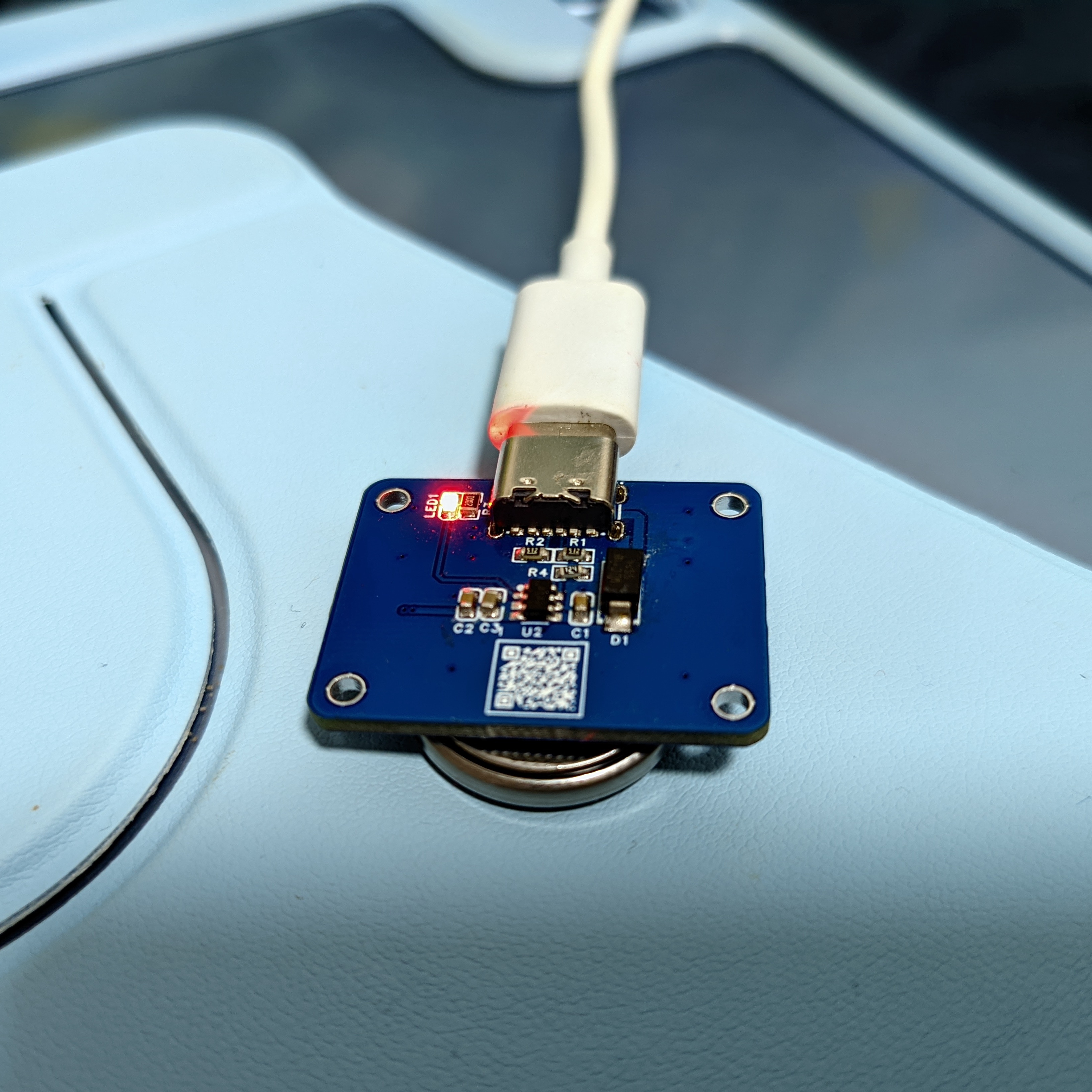

Button battery charger

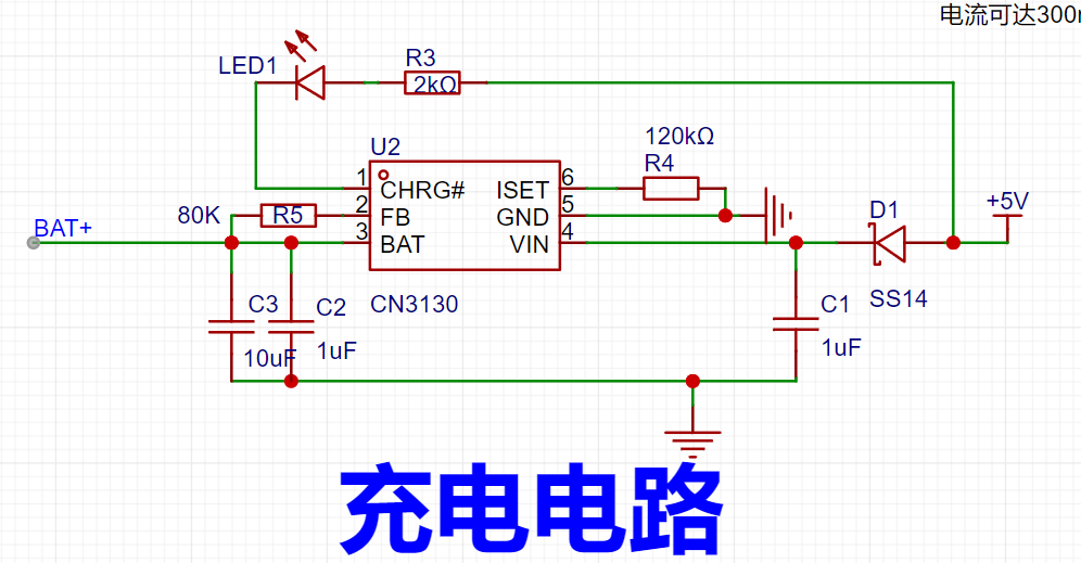

Button battery/solar cell charger designed using CN3130
I. Design Summary This circuit
can charge an LIR2032 (3.6V) and a 4.2V lithium battery. It only requires configuring a resistor. An external solar panel (voltage range 3.9~6V) can be connected to charge the battery. The charging current is configured using a resistor, with a maximum charging current of 300mA.
II. Hardware Circuit Composition
This circuit is very simple, consisting of two parts
: 1. Charging Interface: The CC pin is connected to a 5.1K resistor to ground for easy C-to-C power supply.
2. Charging IC
Voltage Configuration Resistor R5
R5 value: 80K for LIR2032, 240K for 4.2V lithium battery.
0R 3.3V
80K 3.6V
240K 4.2V
Calculation Formula
Current Configuration Resistor R4
1188V/120KΩ = 9.9mA
The minimum charging current is 10mA, therefore R4 is 120KΩ.
The maximum continuous charging current can reach 300mA.
3. Physical Demonstration
III. Precautions:
SS14 does not require soldering short circuit (for reverse polarity protection solar panel) when not using solar charging function. R1 and R2 do not require soldering.
