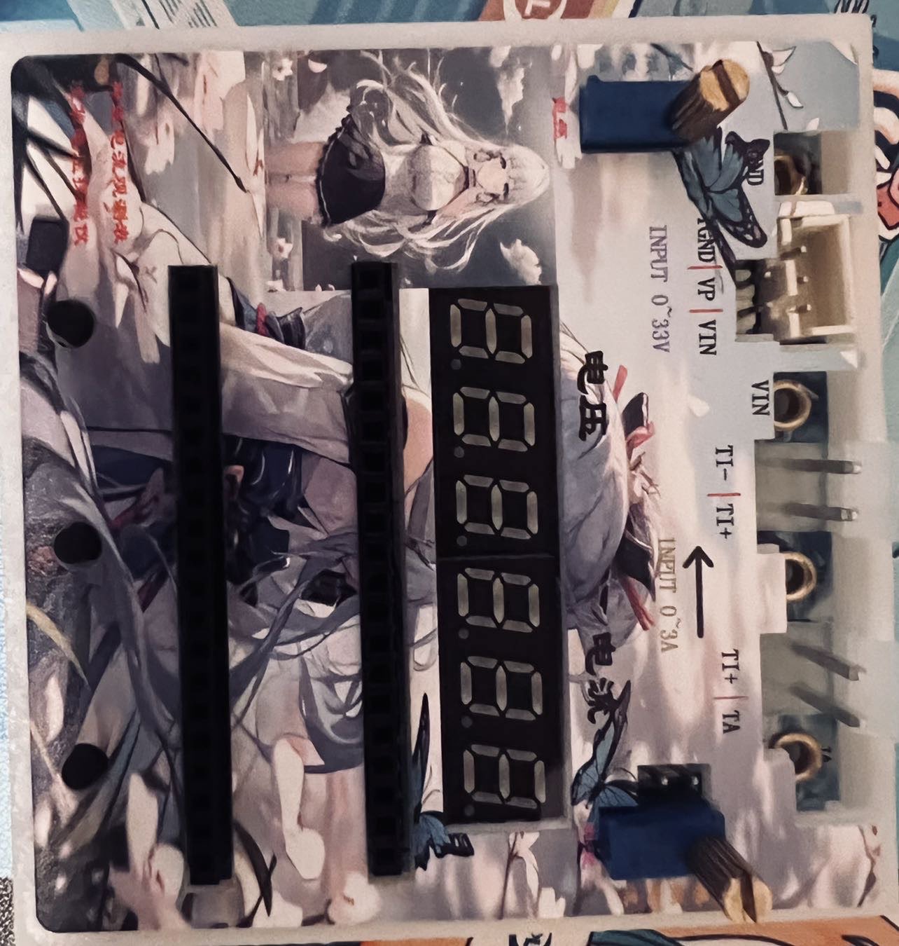

1. Project Function Introduction:
This project adopts a core board plus expansion board design concept, using plug-in components to simplify learning and deepen exploration.
The core board uses the domestic Wuhan Xinyuan Semiconductor CW32 as the main controller, while also being compatible with other similar development boards; however, the CW32 has advantages.
The project is highly comprehensive and practical, and can be used as a desktop instrument after completion.
The project offers abundant learning materials, including circuit design tutorials, PCB design, code programming learning, and training for engineers' debugging skills.

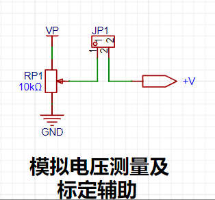

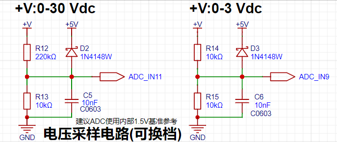

         1. Voltage Sampling Circuit
           This project uses a voltage divider circuit to achieve high voltage acquisition. The design is to acquire a voltage of 100V, and the current configuration acquires a voltage of 0-30V. This project uses a 220K+10K voltage divider resistor, resulting in a voltage division ratio of 22:1 (ADC_IN11).
This project also includes circuits for simulating voltage measurement, measurement calibration, and measurement calibration assistance.

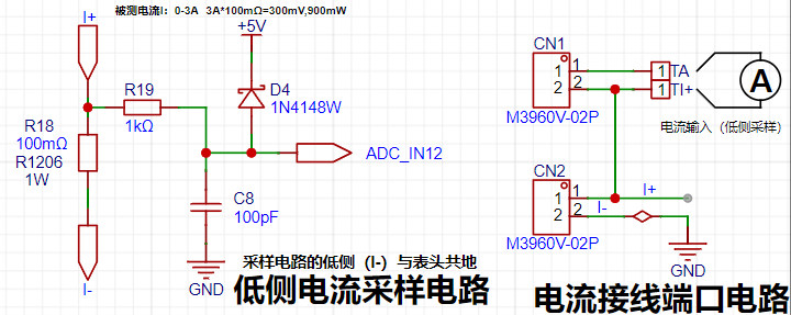

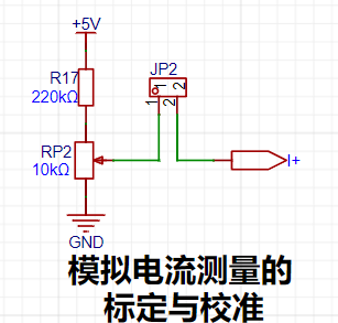

       2. Current Sampling Circuit :
         This project uses a low-side current sampling circuit for current detection. The low-side of the sampling circuit shares a common ground with the development board's meter interface.
The designed sampling current is 3A, and the selected sampling resistor (R0) is 100mΩ.
      The following aspects should be considered when selecting a sampling resistor:
1. The maximum value of the pre-designed measurement current, which is 3A in this project.
2. The voltage difference caused by the current sensing resistor; it is generally not recommended to exceed 0.5V
. 3. The power consumption of the current sensing resistor; a suitable package should be selected based on this parameter. Considering the power consumption (temperature) issue at high current, this project selected a 1W packaged 1206 resistor. However, considering thermal resistance, replicators can replace it with a 3W packaged resistor in a 2512 or 1812 package.
4. Amplification factor of voltage across the current sensing resistor: No operational amplifier was used in this project, so the amplification factor is 1.
     The current sensing resistor value can then be calculated using the above parameters:
1. Since no amplifier circuit was used, a larger sampling resistor was needed to obtain a higher measured voltage for measurement.
2. Considering that a larger resistor would result in a larger voltage drop and higher power consumption, an unlimited selection of a larger resistor was not possible.
3. A 1W package resistor was used in this project, corresponding to a power consumption of 1W.
Based on the above data, a 100mΩ current sensing resistor was selected. According to the formula, 3A * 100mΩ = 300mV, 900mW,
is used for simulating current measurement, measurement calibration, and auxiliary circuitry for measurement calibration.

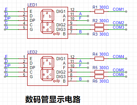

       3. Digital tube display circuit:
This project used two 0.28-inch three-digit common cathode digital tubes as display devices. Compared to a display screen, digital tubes have better visibility in complex environments. A smaller current-limiting resistor can be used to achieve higher brightness based on the actual usage environment. Furthermore, digital tubes have better mechanical properties and are not as easily damaged by external forces as display screens. In industrial and other applications requiring stability and reliability, it is widely used. From a development board learning perspective, it is easier to learn the development related to electronic measurement principles in a more targeted manner.
In this project, after actual testing, the current-limiting resistors (R1~R6) of the digital tube were configured to 300Ω. The corresponding brightness of both red and blue digital tubes has good recognition and the brightness is soft and not dazzling.
      3. TL431 circuit design for voltage measurement calibration
This project adds an extra TL431 circuit to provide a 2.5V reference voltage, which can be used to provide an external voltage reference for the chip to calibrate the AD. From a product design perspective, due to the inherent ADC performance advantages of the CW32, this circuit is not necessary.

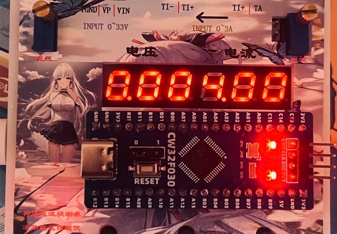

The software part was designed by JLCPCB and Wuhan Xinyuan Semiconductor. The official tutorial documents have been written in detail, so I will not go into too much detail here. I will describe some key points here, such as the function of the three buttons on the board and how to use them.
Calibration operation method of this experiment
This example uses button operation for calibration. The specific operation method is as follows:
Define 5 working modes, and the K1 key is used to switch the display mode. The K2 key sets the parameter value for the corresponding mode and saves it to FLASH. The K3 key returns to mode 0.
Mode 0: Displays normal voltage and current values ​​(the upper row of the digital tube displays the voltage value *.V or .*V automatically, the lower row displays the current value _.**A).
Mode 1: 5V voltage calibration setting. The upper row of the digital tube displays 5.05. The lower row displays the current voltage value _.V or ._V. In this mode, the multimeter should be set to 5.00V when measuring the measured bit. Pressing the K2 key calibrates the current value to 5V.
Mode 2: 15V voltage calibration setting. The upper row of the digital tube displays 5.15. The lower row displays the current voltage value _.V or ._V. In this mode, the multimeter should be set to 15.0V when measuring the measured bit. Pressing the K2 key calibrates the current value to 15V.
Mode 3: 0.5A current calibration setting. The top row of the digital display shows A.0.5. The bottom row shows the current current value _.**A. Pressing the K2 key sets the current value to 0.5A.
Mode 4: Current 1.5A calibration setting. The top row of the digital display shows A.1.5. The bottom row shows the current current value *.**A. Pressing the K2 key sets the current value to 1.5A.

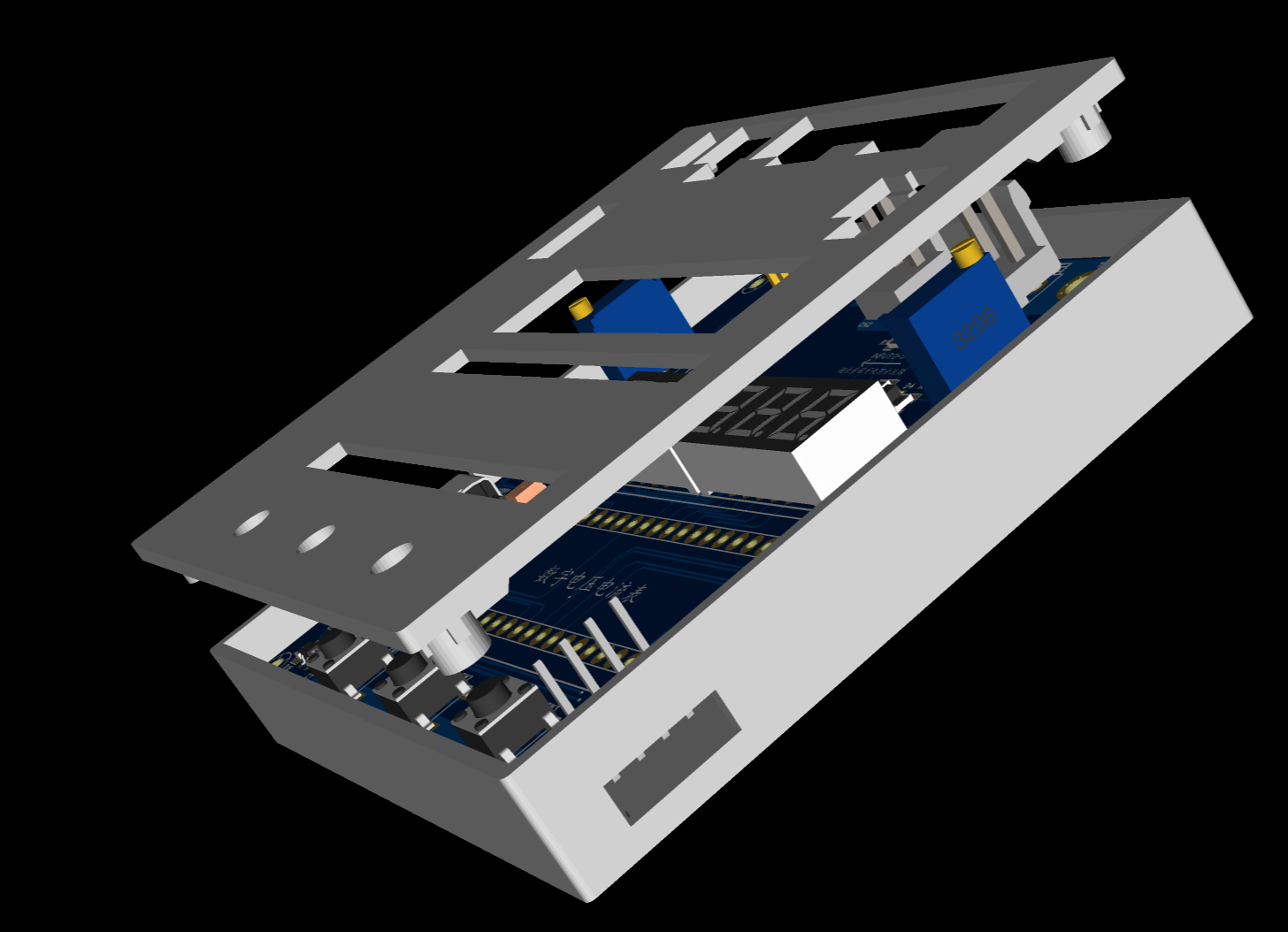

5. Attention! This design used JLCPCB color screen printing. You can choose which screen printing method to export. I also designed a 3D casing for this project, which can be printed independently. With a casing, a JLCPCB panel is essential, and yes, I designed a cute panel as well.
6. When ordering JLCPCB acrylic panels, be sure to click "Confirm Production." You MUST click "Confirm Production," otherwise a defective product will be printed. Panel properties can be selected by yourself.
