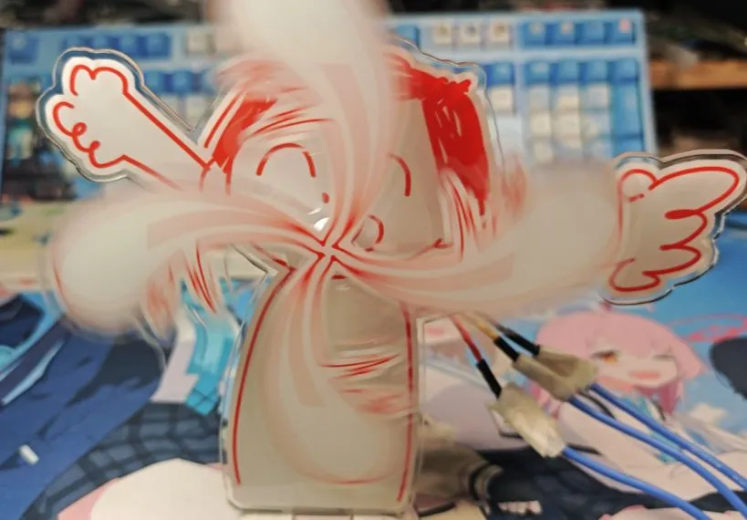

1. Introduction:
In the sweltering summer, let Sensei bring you coolness!
Using a TC1508A as the DC brushed motor driver and a Hezhou AIR001 as the MCU main controller, the 3.3V version uses an LP3219 as the DCDC small fan, which can also be used as an acrylic standee.

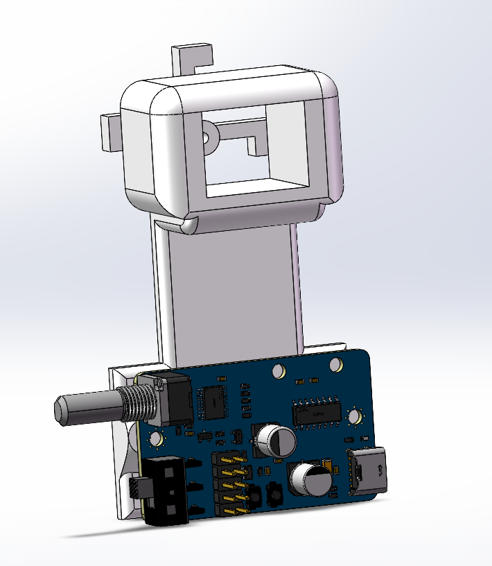

The 5V version diagram is shown below. The
3.3V version diagram is shown below.

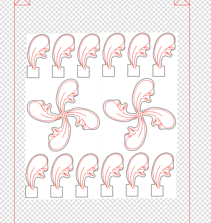

2. Acrylic Standee

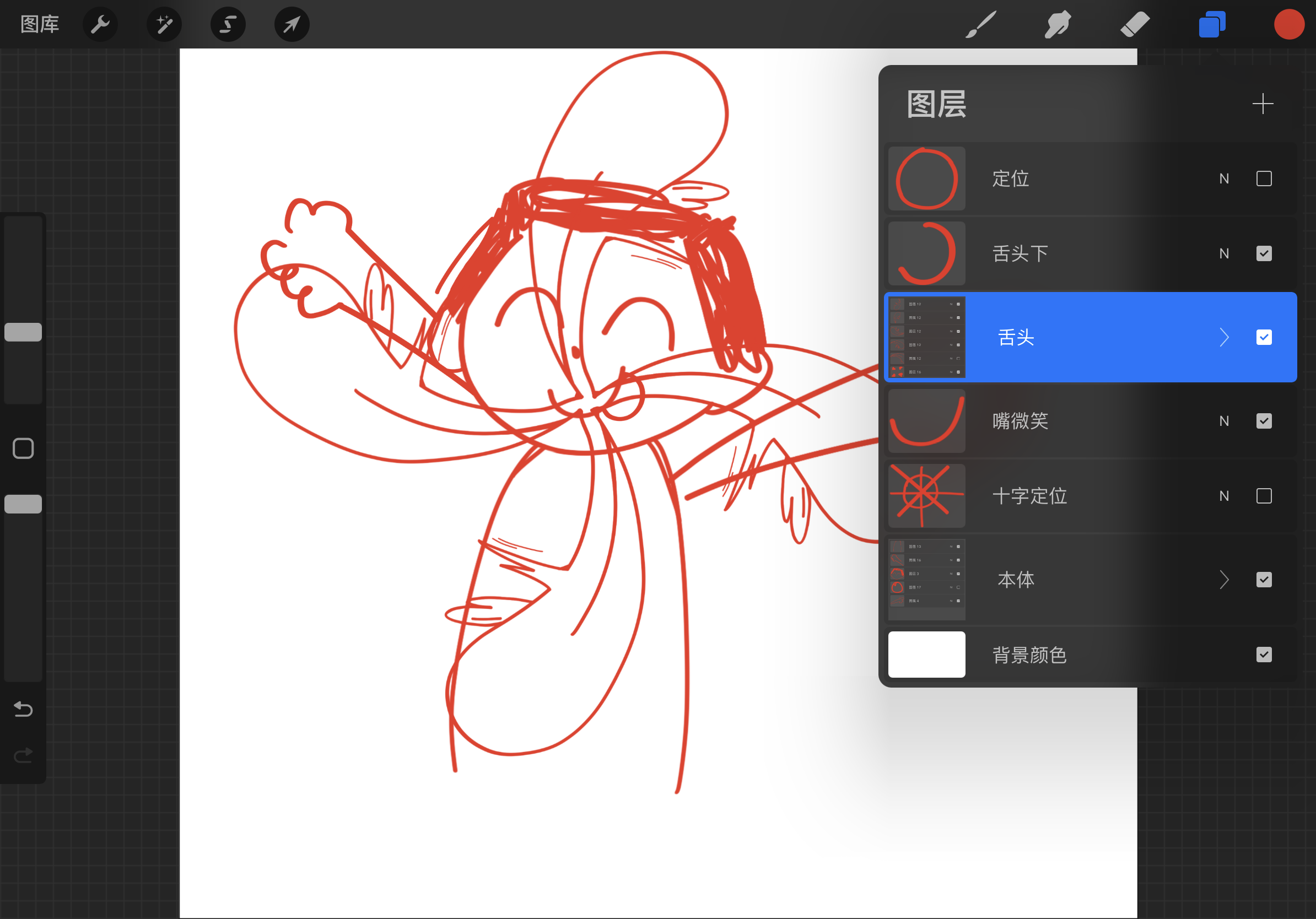

Illustration: Sensei's illustrations are drawn by myself, and the copyright belongs to me.
Self-drawn:
The illustration files can be found in the group files in the discussion group 189480376.
It can be used for personal use, learning, gifts, or freebies. Please do not use it for commercial purposes! 1.
Print the body 20x16cm
and the tongue 16x16cm. Coated paper is recommended for printing.
The panel can be printed with PC, but I haven't done it yet, so I don't know how well it will look.
2. Align the structure
directly with the opening and then glue it on.

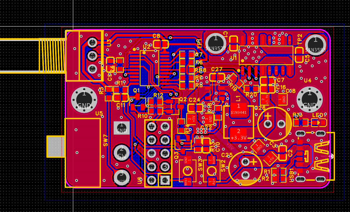

3. The circuit
is very simple; you can look it up yourself. I won't go into details.
The motor drive generates a lot of heat, so I suggest adding a heatsink. Don't use low-temperature solder .

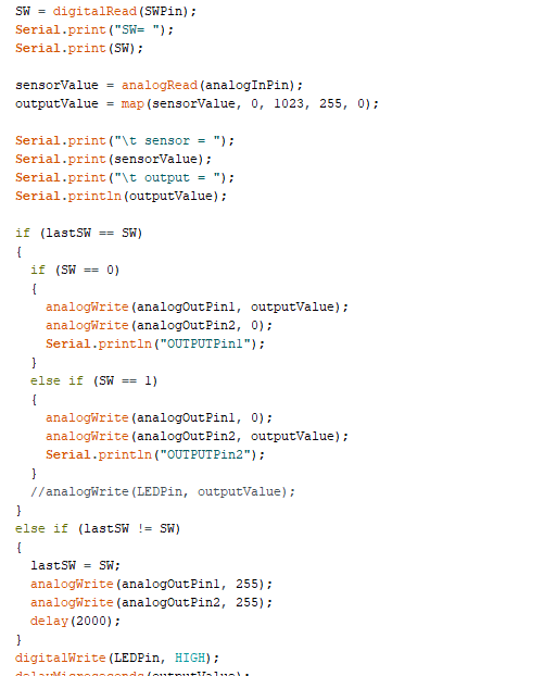

4. The code
is updated based on AnalogInOutSerial.
Install the AIR001 ARDUINO development board environment.
The startup sound is simple; although there's no buzzer, you can use a motor as a buzzer. Give it a PWM signal that's not strong enough to make it turn, and it will vibrate and make a sound.
Then, it checks if the potentiometer is off; if not, it emits an alarm sound.
The rest is a simple loop that reads the potentiometer ADC and outputs the PWM; I won't go into details.
