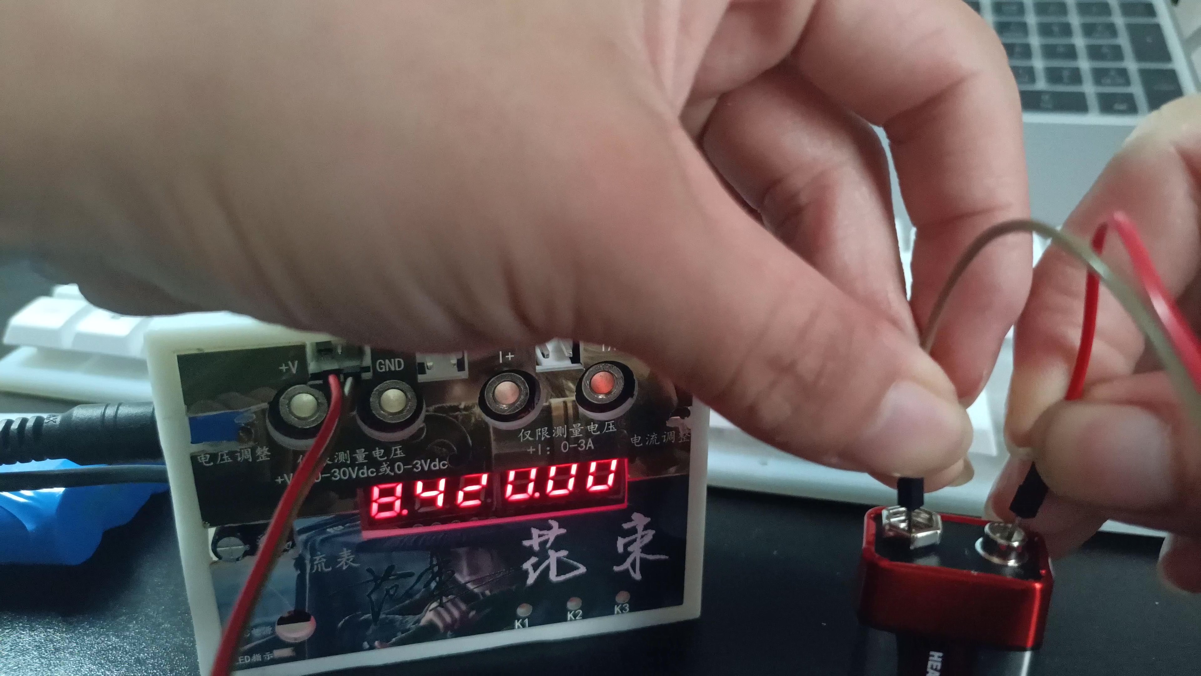

Simultaneous Sampling and Display. Measure a low-powered battery.

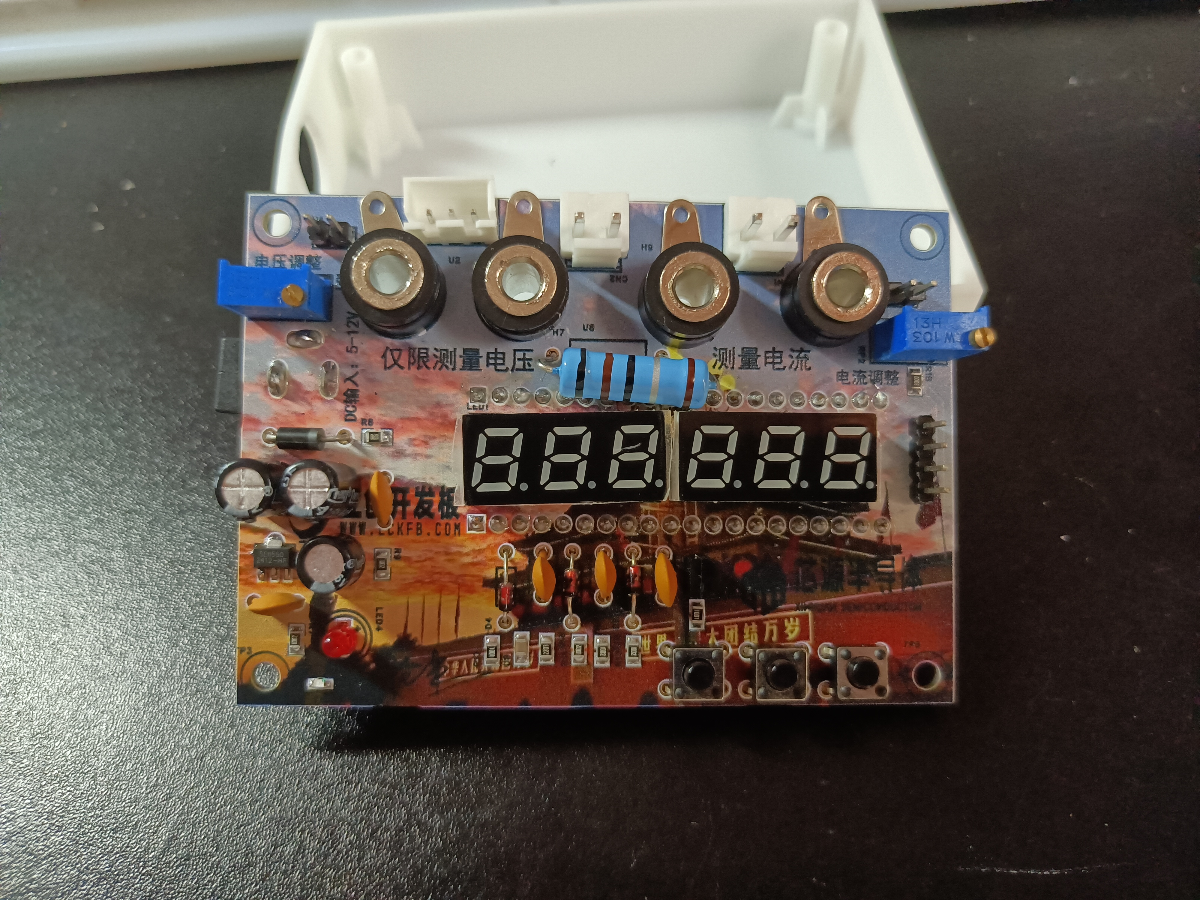

III. Hardware Circuit
Based on the training camp project, the plug-in components are replaced with surface-mount components.

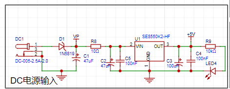

1. LDO (Low Dropout Linear Regulator)
is based on SE8550K2 as the DC power output.

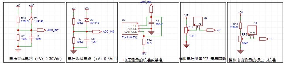

2. Voltage Circuit Sampling Circuit
The project uses a voltage divider circuit to achieve high voltage acquisition. The design can acquire a voltage of 100V, and the current configuration is to acquire a voltage of 0-30V. The project design uses a voltage divider resistor of 220K+10K, so the voltage division ratio is 22:1 (ADC_IN11).

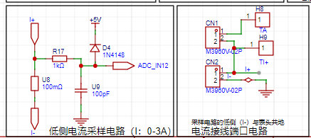

The project uses a low-side current sampling circuit for current detection. The low side of the sampling circuit shares a common ground with the development board's meter interface. The sampling current is 3A, and the selected sampling resistor (R0) is 100mΩ. According to the formula, the voltage and power can be calculated as 3A * 100mΩ = 300mV, 900mW.

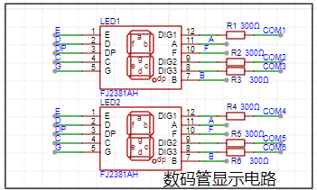

3. The project uses a digital tube as the display unit.

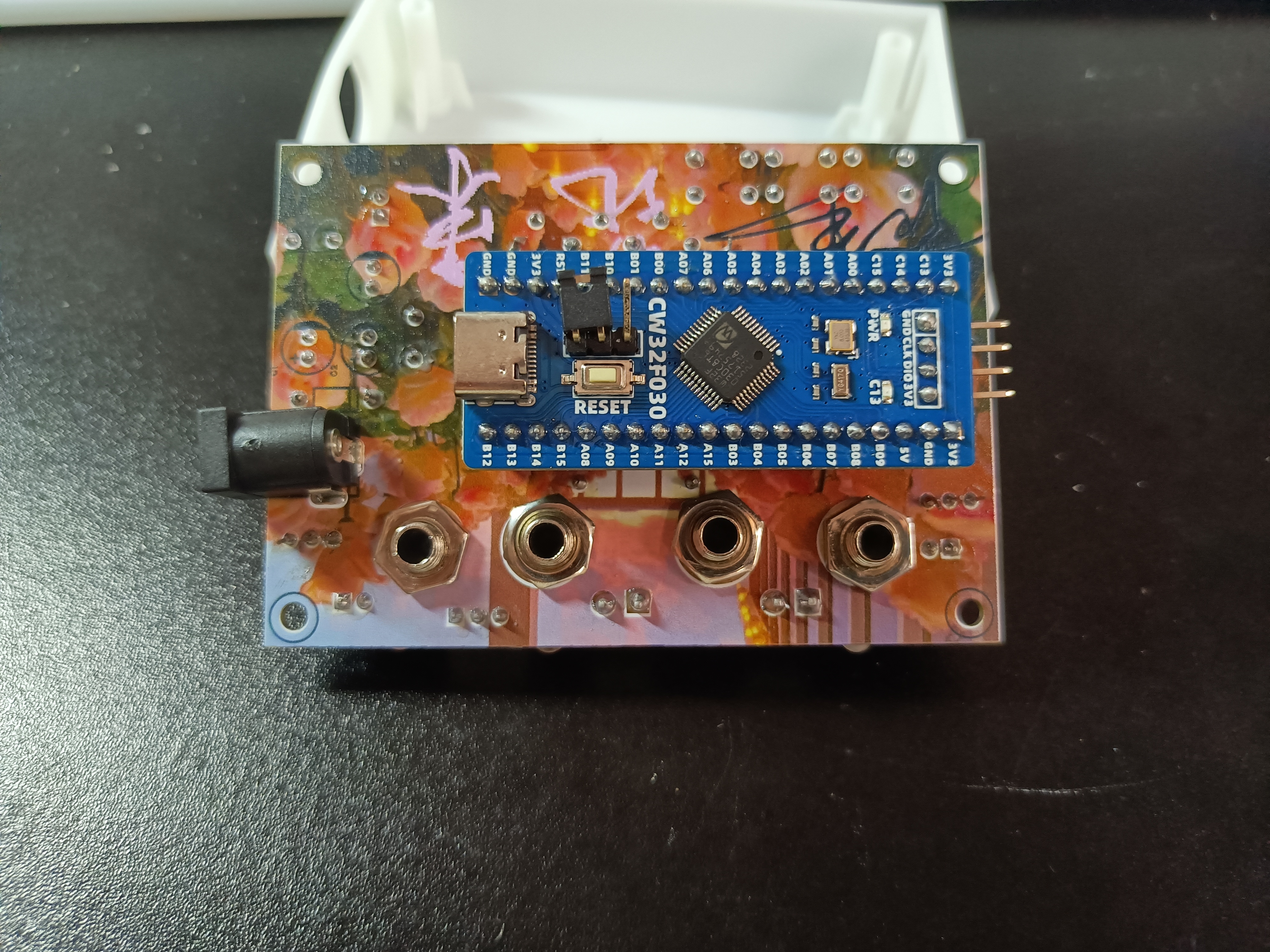

IV. Software Design:
This was my first time working with CW32. I followed a training camp project to design the software, mainly focusing on developing good programming habits.

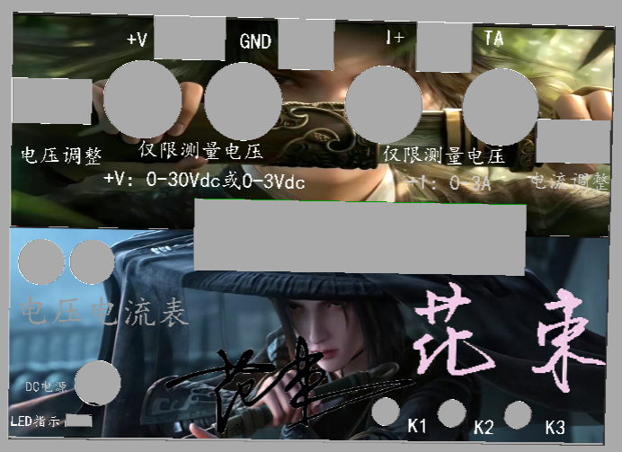

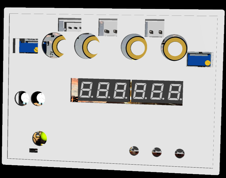

V. Shell and Panel Design:
3D shell design
and panel design.

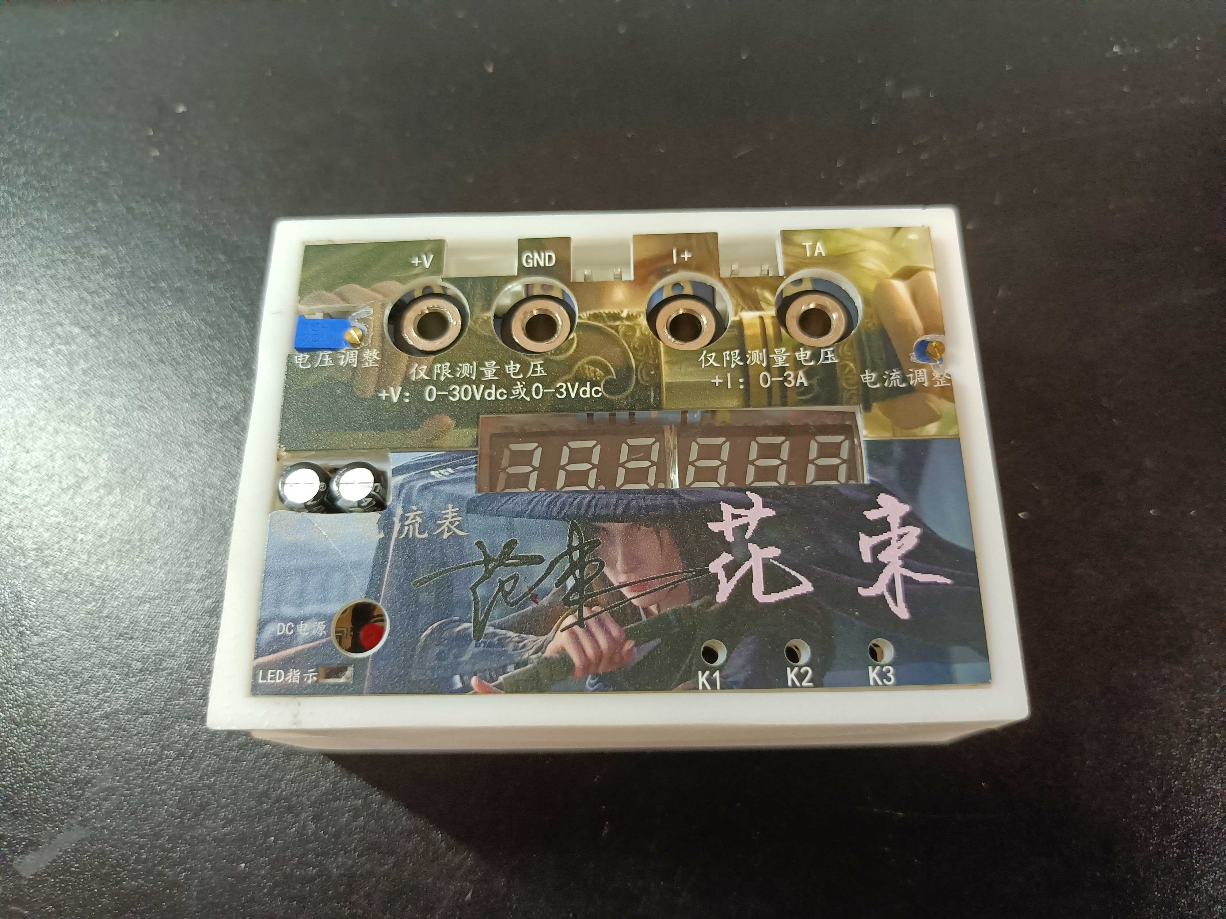

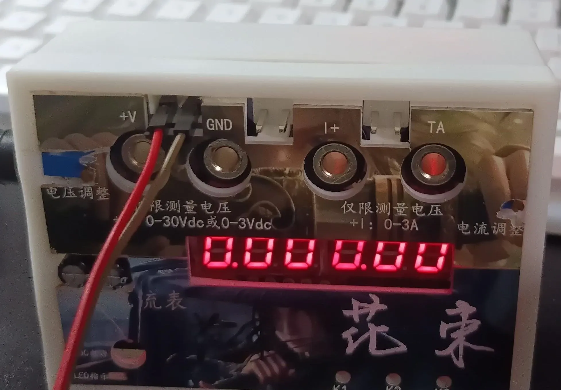

VI. Physical Demonstration
