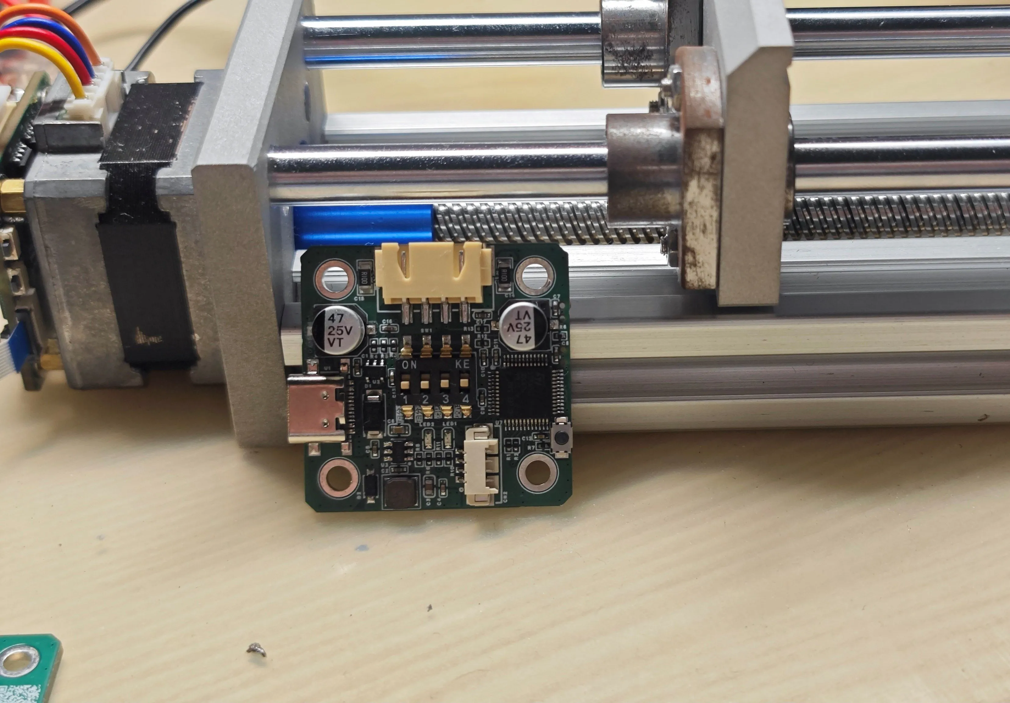

Project Introduction:
This project utilizes CNC sheet metal and some mechanical parts to construct an electric welding vise. The CNC components were prototyped at JLCPCB's 1 Yuan CNC prototyping event. The drive system uses a closed-loop stepper drive, and the motor drive board is compatible with a 35 stepper motor. It can be used in other projects. The plan includes the following functions: closed- loop button setting for
vise position, automatic adjustment of clamping current (to be implemented), long-term automatic sleep mode (to be implemented), external control input (to be implemented), and manual version video demonstration: bilibili. Software open-source address: github. Software part references "Contradictory Aggregator". Hardware open-source address: oshwhub. Hardware part references "HyperStepper" . Bill of Materials : 1. Components required for the circuit board (BOM) are given . 2. Structural part: Item No. Name Quantity Link 1 CNC aluminum plate 3 JLCPCB CNC prototyping 2 2020 aluminum profile 120mm tapped at both ends M6 2 Reference Connection 3 8mm optical shaft 130mm (no burrs at both ends) 2 Reference Connection 4 Double-edged flange linear bearing 8x15x24 2 Reference Connection 5 T8 lead screw 143mm pitch 2 lead 8 1 Reference Connection 6 Miniature flange bearing F688Z (8*18*5) Manual: 2 / Electric: 1 Reference Connection 7 Backlash-free nut T8 lead 8 1 Reference Connection 8 T8 lead screw lead screw nut pitch 2 lead 8 1 (Generally included with the purchase of a lead screw) Reference connection 9 Coupling 5*8 Manual: 0 / Electric: 1 Reference connection 10 M6x14 Screw 4 11 M3*12 *4 (head diameter) Small head screw 10 12 35 Stepper motor Manual: 0 / Electric: 1
