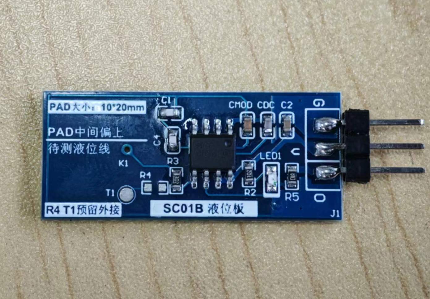

SC01B Liquid Level Detector

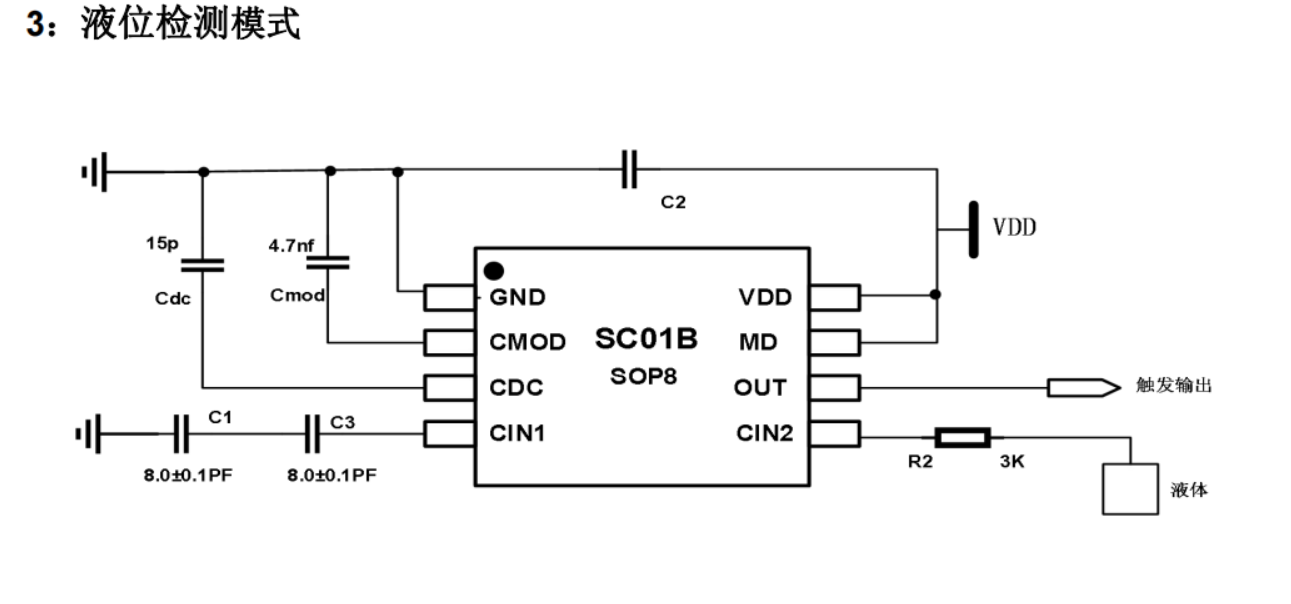

The Xiamen Jingzun SC01B liquid level detection principle: CIN2 channel (collects changes in liquid capacitance) ➖ ​​CIN1 channel capacitance > chip threshold. A value greater than the chip threshold indicates the presence of water; otherwise, no water is detected.
When the chip detects liquid, it outputs a low-level signal, illuminating the LED indicator
. If no liquid is detected, it outputs a high-level signal, turning off the LED indicator.
Sensitivity is adjusted by adjusting capacitors C1 and C4; smaller capacitors result in higher sensitivity, and vice versa.
The default sensitivity is 10pF and 10pF in series, meaning the CIN1 channel capacitor is 5pF.
参考设计图片
