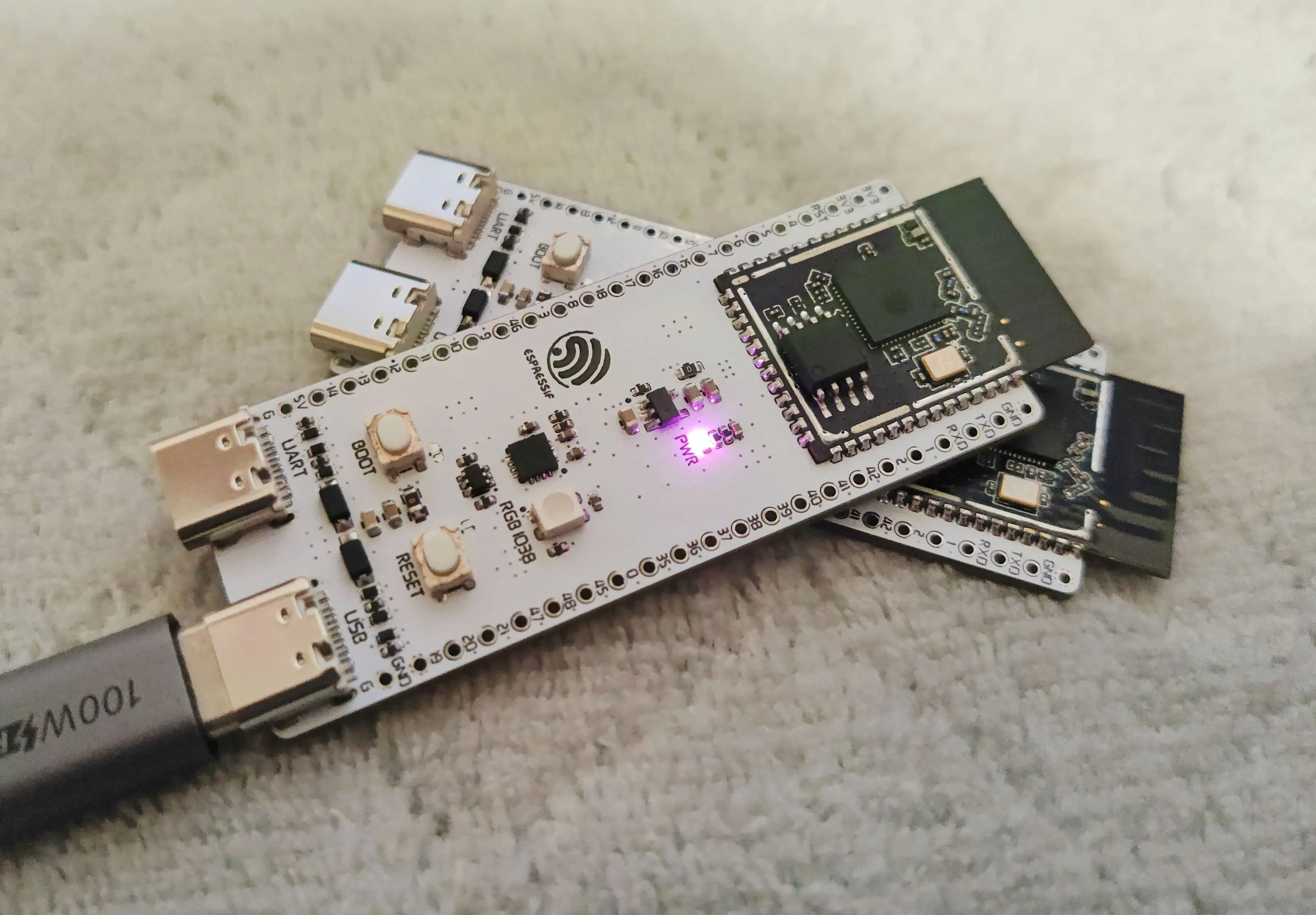

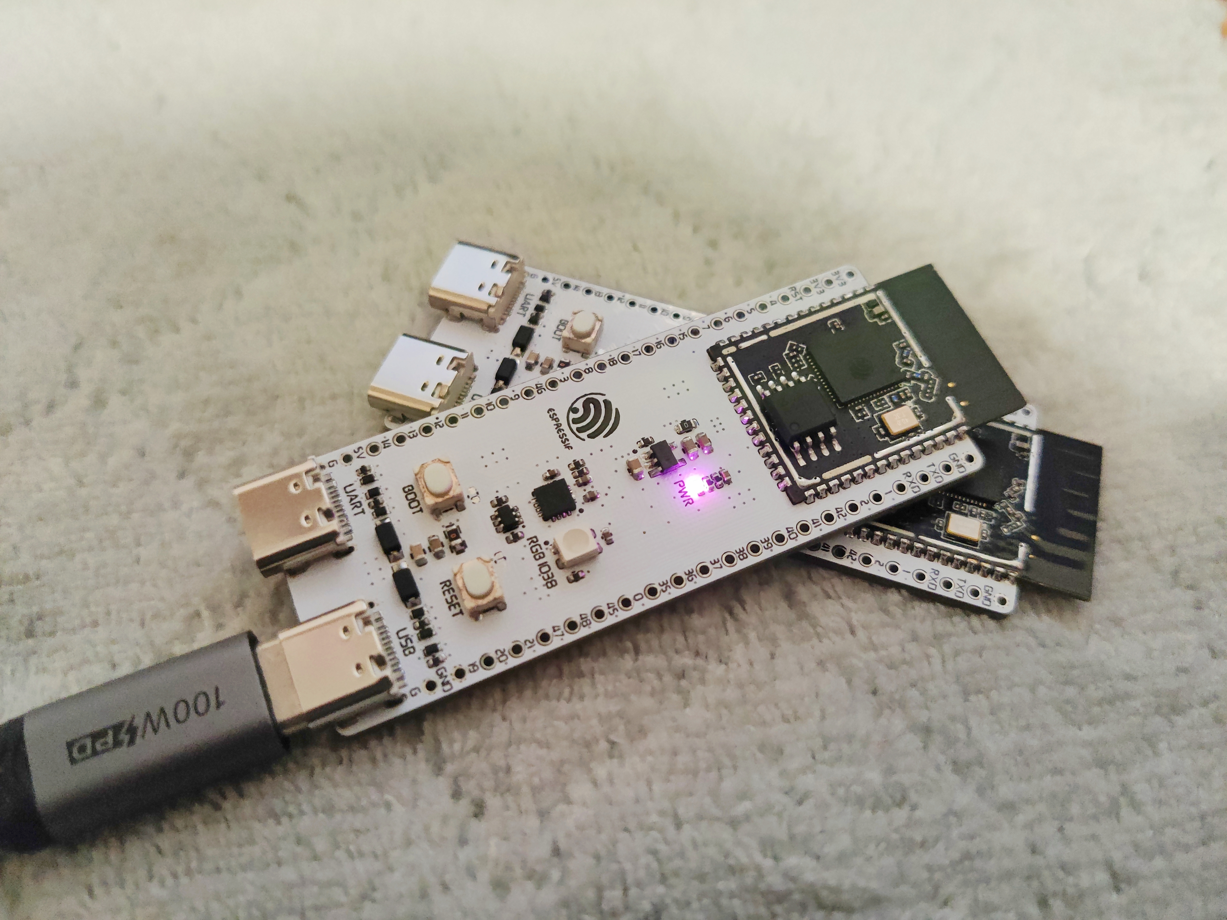

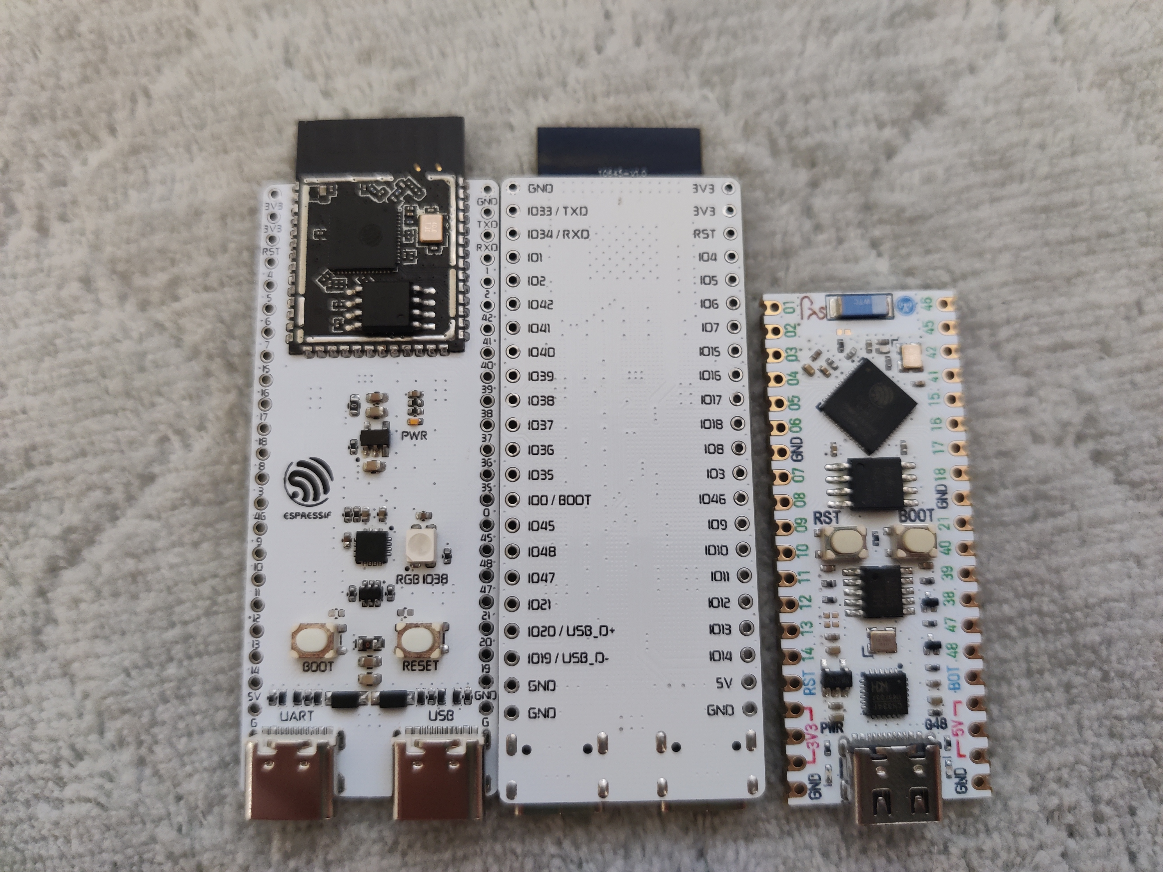

ESP32-S3-DevKitC-1
Refer to the Espressif ESP32-S3-DevKitC-1 development board introduction:
https://docs.espressif.com/projects/esp-idf/zh_CN/stable/esp32s3/hw-reference/esp32s3/user-guide-devkitc-1.html

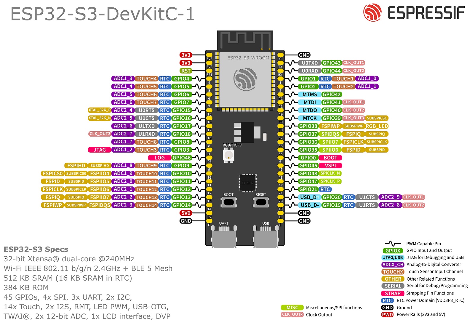

![ESP32-S3_DevKitC-1_pinlayout_v1.1.jpg]

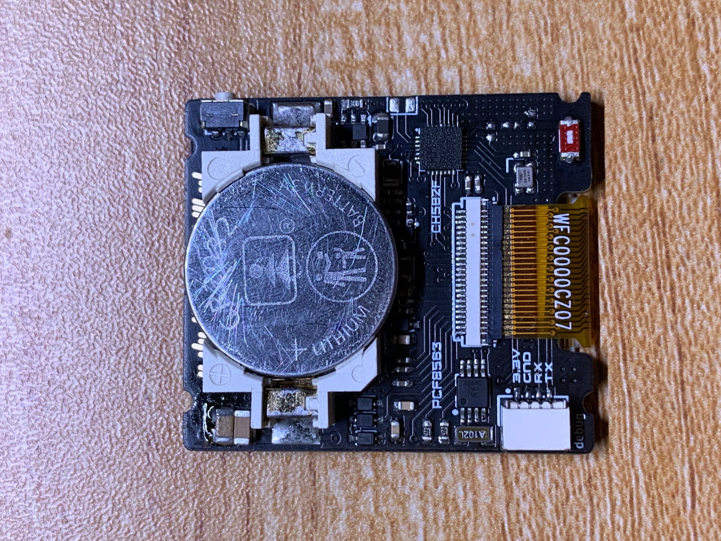

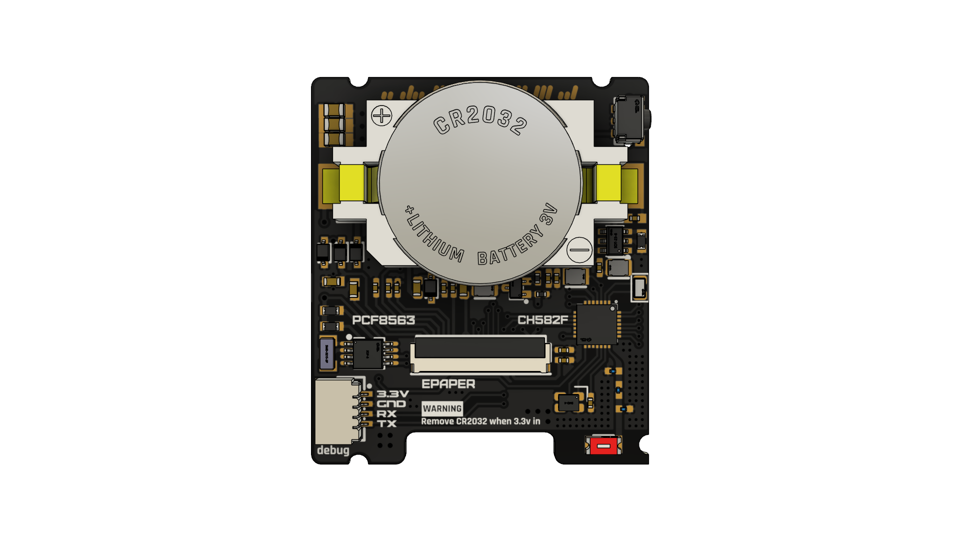

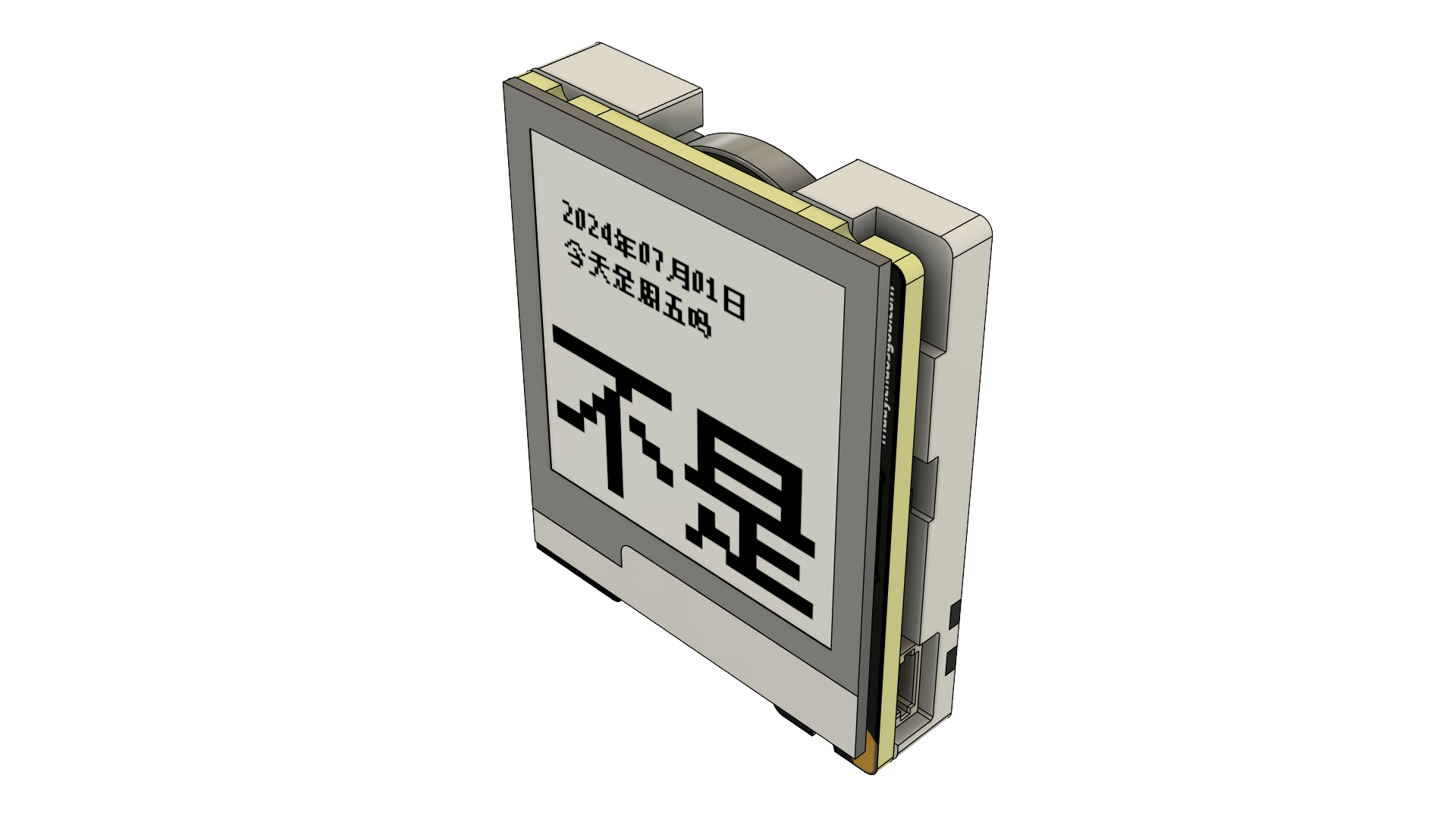

This is a device that uses CH582F as the main controller, an e-ink screen as the display medium, and is powered by a CR2032 button battery.
Essentially a calendar, but with the addition of Friday detection, it becomes a Friday detector.
Inspired by the iOS widget of the Jike App.

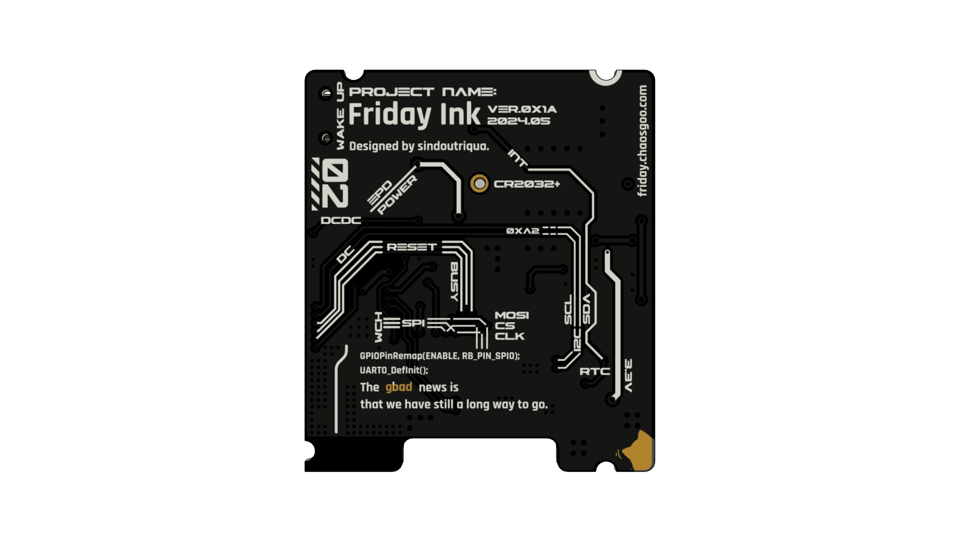

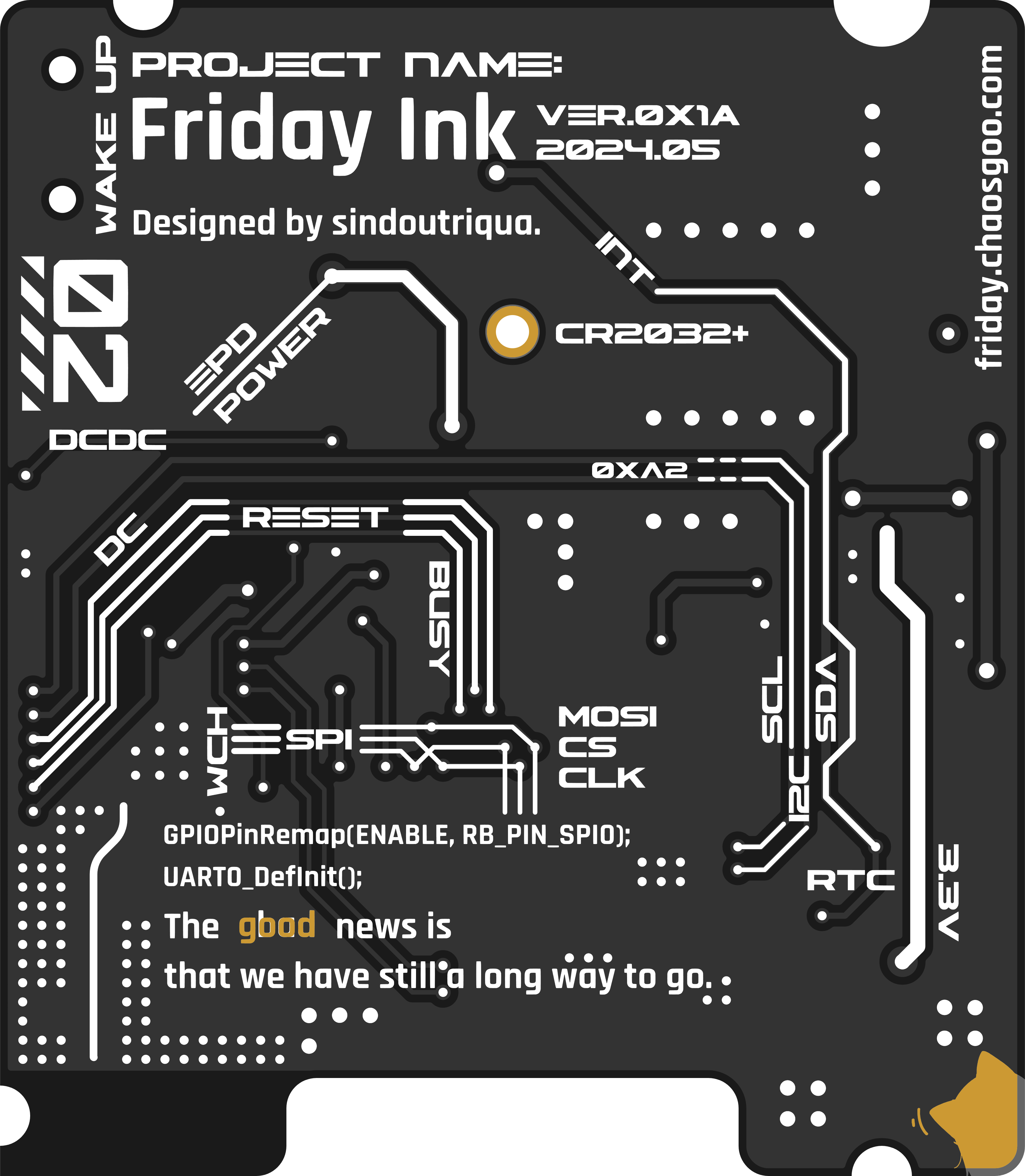

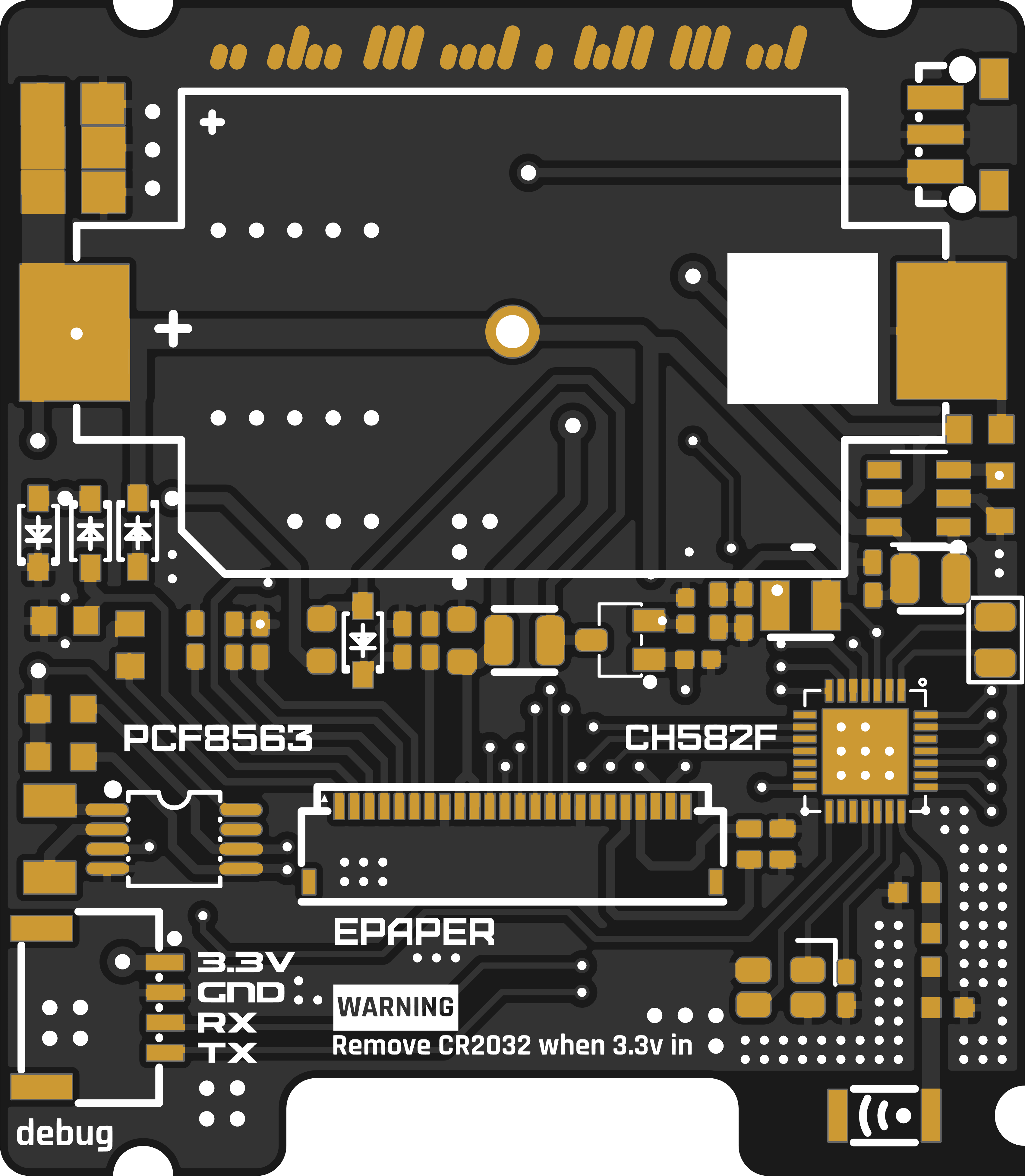

PCB Preview
Top
Bottom
Basic Parameters
Hardware Parameters
Main Controller CH582F 32KB RAM + 448KB Flash
Clock Chip PCF8563T
Screen 1.54-inch e-ink screen SSD1607
DC-DC Chip SGM6603-3.3YN6G
Power Supply CR2032 Battery
Note:
When using the SSD1607 screen driver IC, an SGM6603 needs to be soldered, as the SGM6603 is needed to completely disconnect the e-ink screen power supply.
I picked up this screen from Xianyu (a second-hand marketplace). After buying it, I found that it had the same silkscreen as a 9.9 RMB Hezhou e-ink screen, and the driver IC was also the same.
In actual use, the power consumption in sleep mode never decreased. So, in a fit of anger, I added a DC-DC converter to manage the power supply of the e-ink screen. This effectively reduced its sleep current from 70μA to 3μA.
When using the SSD1681 screen driver IC, there's no need to solder the SGM6603. In this case, a 0-ohm resistor is used to short-circuit pins 5 and 6 of the SGM6603, and there's no need to solder the 4.7μH inductor below the SGM6603.
This is currently the black and white dual-color e-ink screen sold by Zhongjingyuan. The display effect is much better than the one I bought on Xianyu. Although the resolution is the same (200x200), the effect is clearer and the contrast is better. The downside is that it's more expensive than the one I bought for 5 yuan on Xianyu.
Because it can sleep normally, a DC-DC converter is no longer needed, and the power consumption is slightly better than the SSD1607 version.
Dimensions:
34mm × 39mm × 8mm.
Power consumption information:
Sleep state ≈ 3μA;
Refresh 10~20mA, immediately enters sleep mode after refresh.

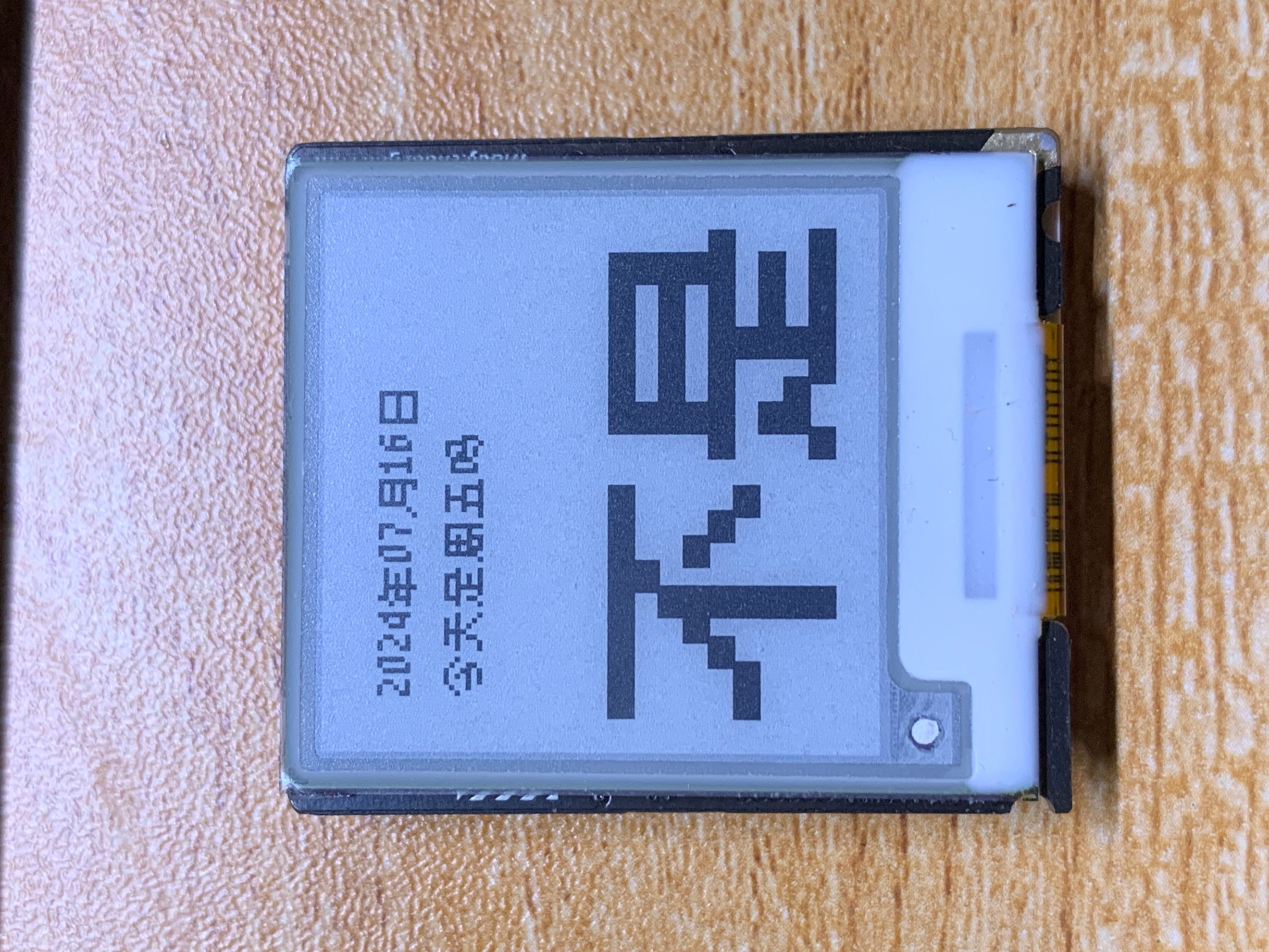

Calibration instructions:
Press and hold the button during power-on. Enter time synchronization mode, and release the button after seeing the image below.
The device will then search for nearby Bluetooth broadcasts. It will automatically restart when a time broadcast matching the agreed-upon format is found.

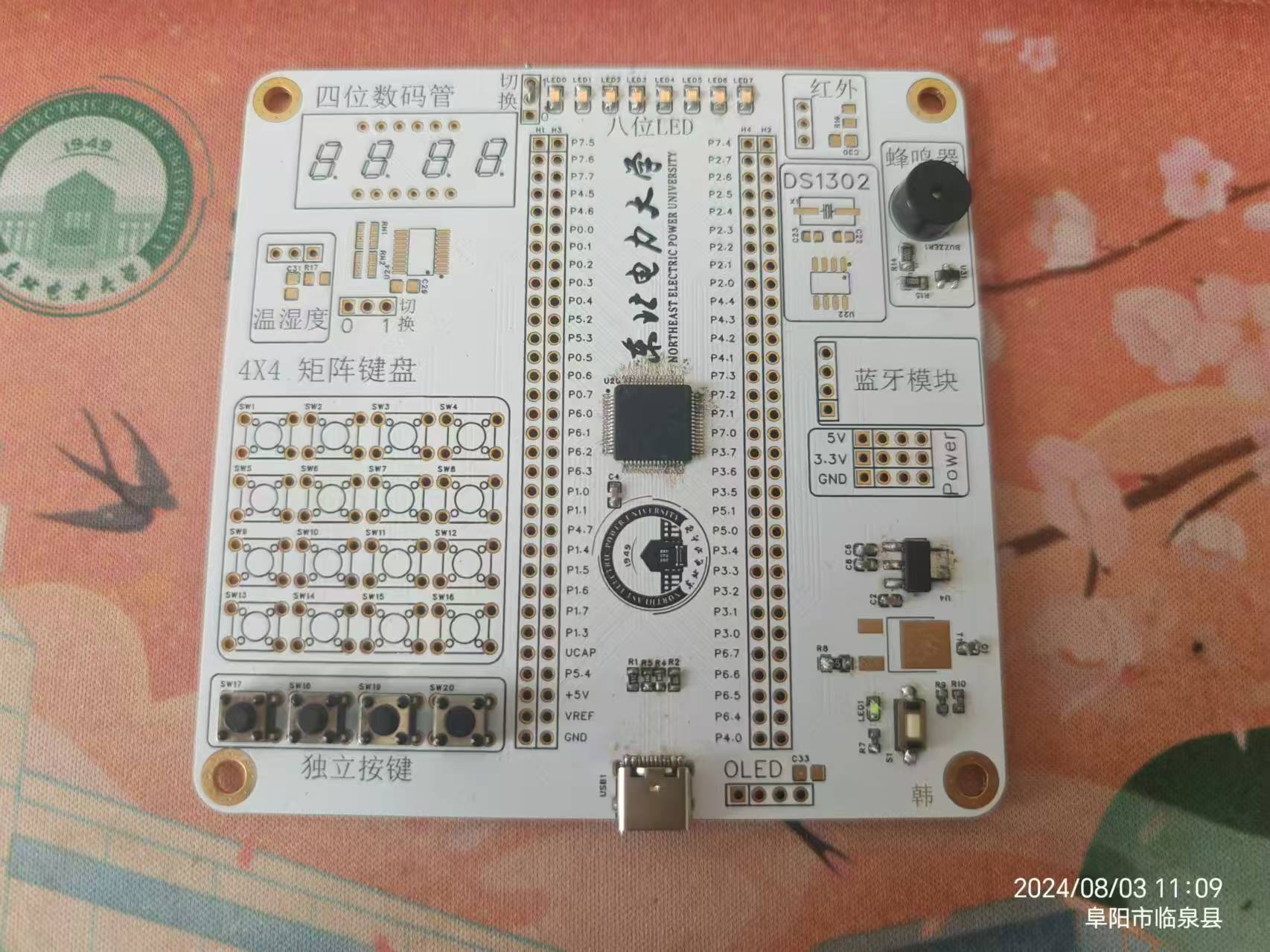

The STC32 development board only has individual buttons and LED running lights soldered on. Testing showed all functions work correctly. It references the official STC "Dragon Slayer" development board. Having recently learned the classic 51 microcontroller, I added matrix buttons, temperature and humidity control, DS1302 clock, infrared, digital tube display, and Bluetooth functionality, referencing the Puzhong 51 development board.
The power supply section has 5V and 3.3V, with all pins brought out .

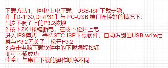

For program upload,
simply connect to the computer via USB and use the official STCsip software to download the program, as shown in the image below.

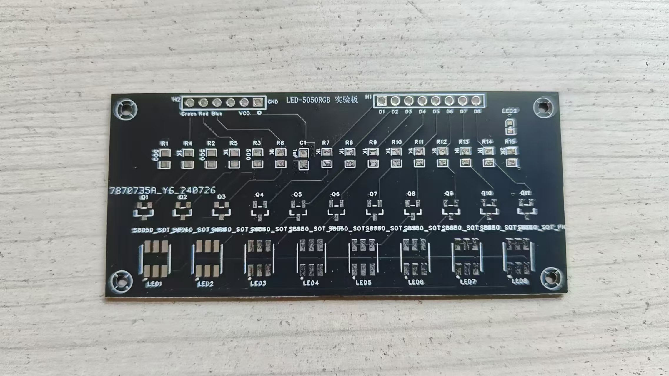

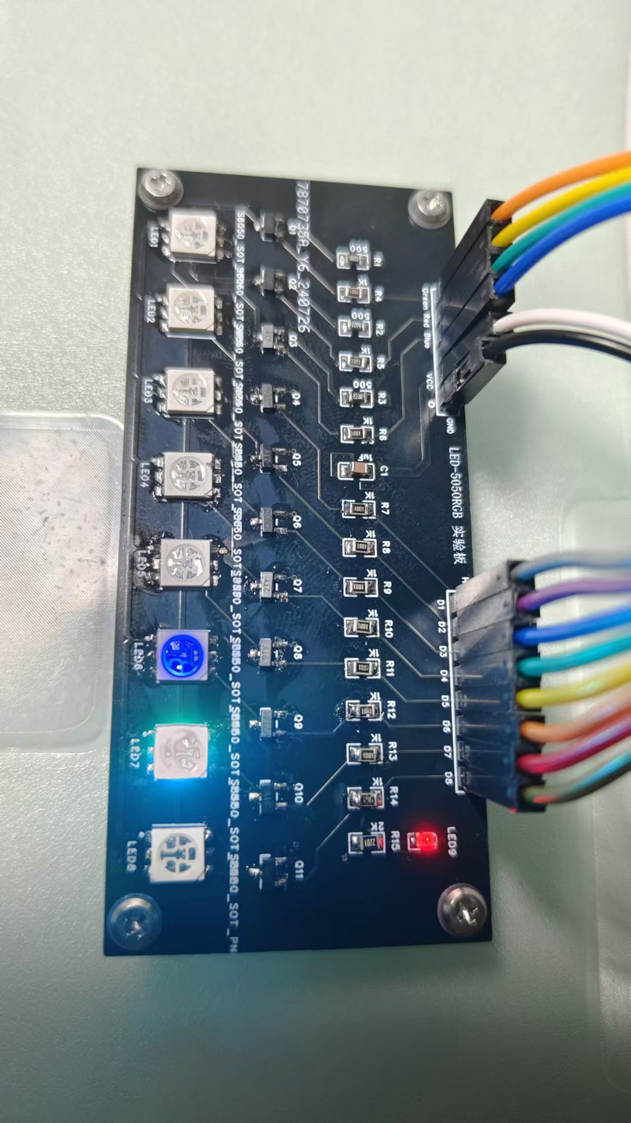

This project utilizes 5050RGB tri-color LEDs and auxiliary components to achieve a colorful running light function. It can be used for microcontroller learning, offering diverse color combinations and allowing for various color displays by utilizing the brightness ratios of the three colors.
Due to the limited I/O driving capabilities of the microcontroller, transistors are used for driving.
Circuit board images,
finished product images
